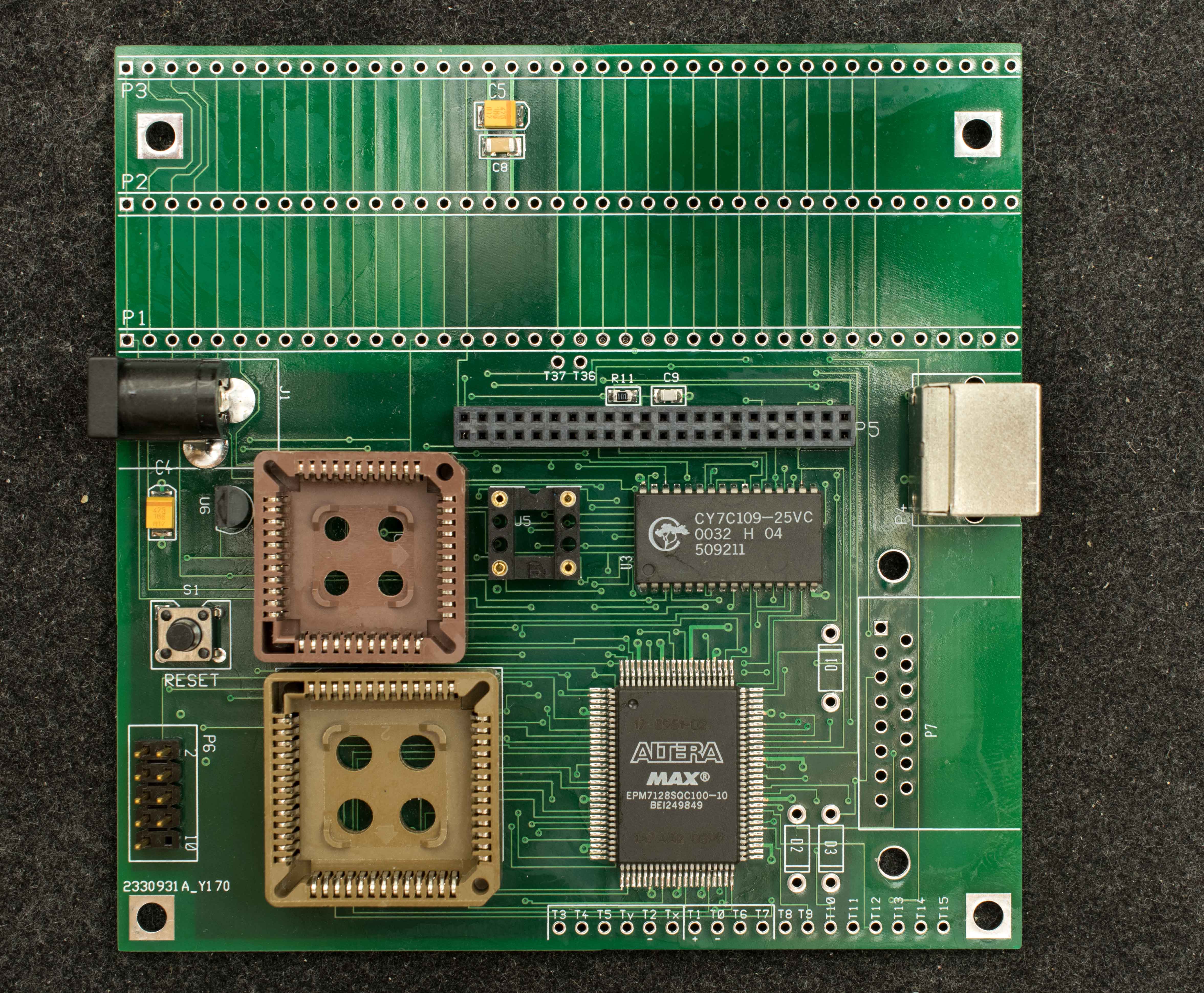

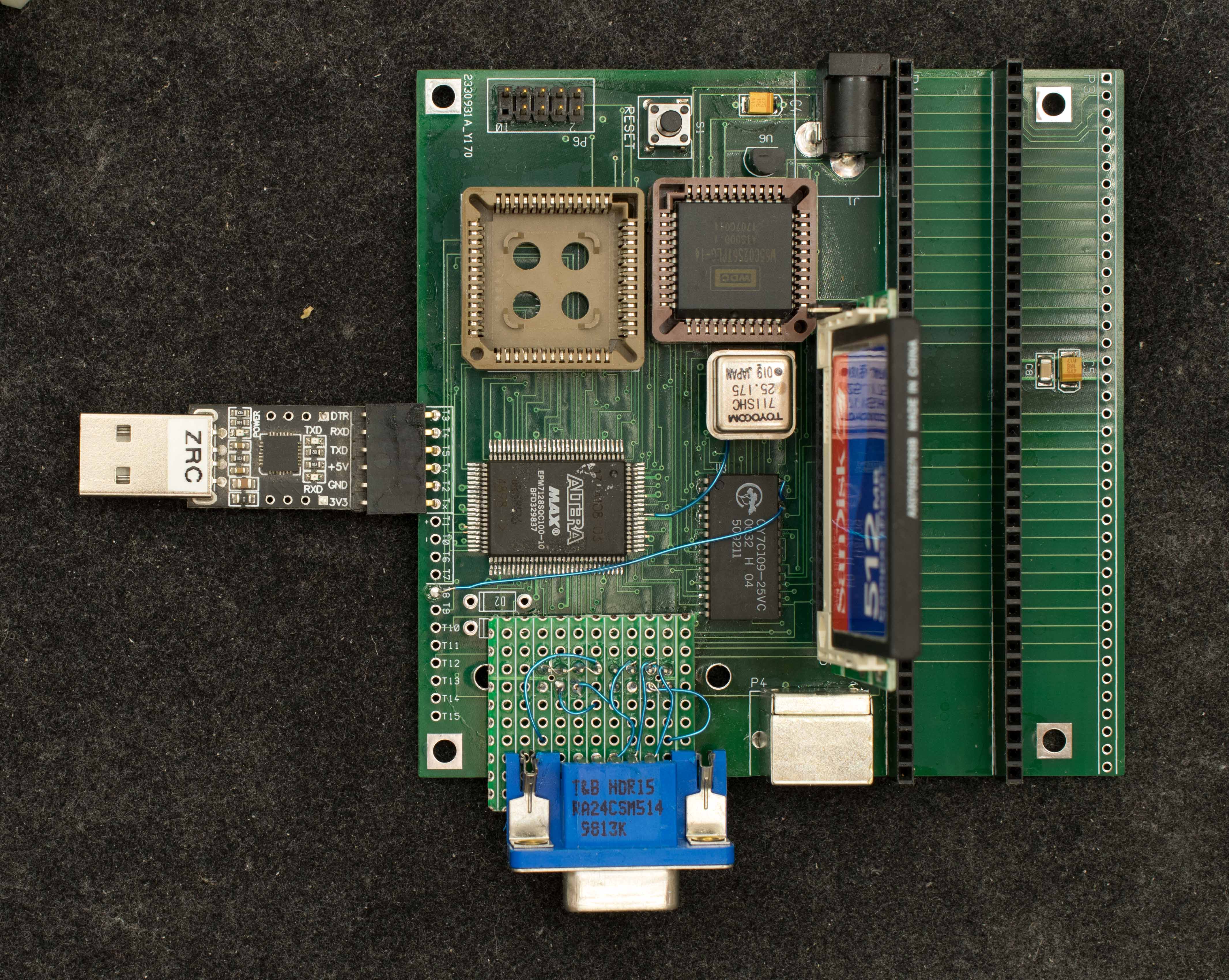

Here is a new SBC project. It is a standalone 6502 computer with its own VGA and PS2 keyboard. The 6502 is overclocked to 25.175MHz with 128K system RAM, and 4K dual port video RAM supporting monochrome text display with 64 columns and 48 rows. It has 44-pin IDE for CF disk and a simple bit-bang serial port. It is designed to run DOS/65, the CP/M clone for 6502. It also has 3 RC6502 expansion slots.
Photo of board under construction and schematic.
Already found a problem, the VGA connector should be HD15, not DB15! Another library mistake!

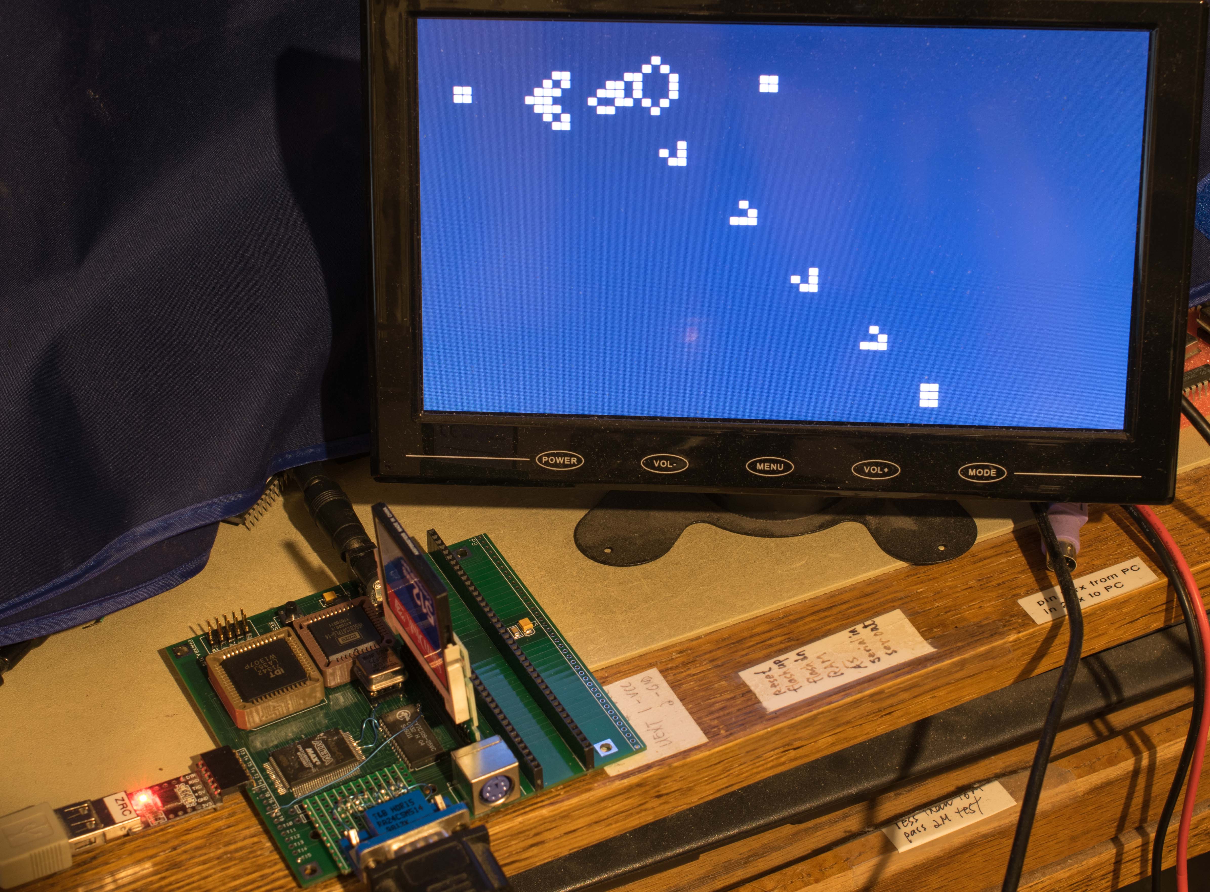

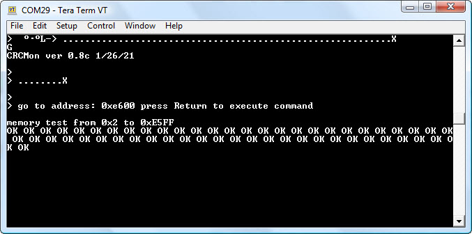

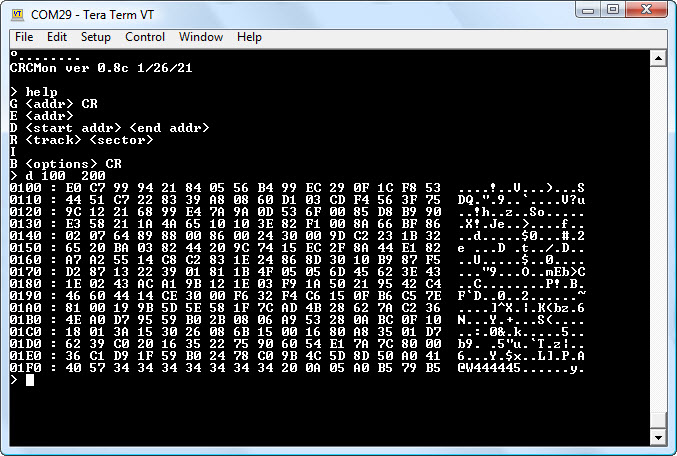

Thinking about how to bring up 65ALL. Since I have just concluded the testing of a overclock design with similar hardware consisted of RAM, CPLD, 6502, and CF, it seems logical to port that design to 65ALL to check out the pc board minus the video and PS2 interfaces. So that's what I did; minus the VGA and PS2 interface, the design is mostly the same except CPLD pin assignments are different. It is a matter of reassigning pins and recompiling and program the CPLD. Now I have a bootable 65ALL. It can load the monitor and run memory diagnostically successfully. However, the compact flash interface is not working--it hangs when I try to display CF disk contents. Well, at least I have a working monitor that can load and run diagnostic so this is good progress with minimum amount of works.

An update: I figured out why CF is not working—its setup and access times are based on 14.7Mhz clock. It needs more delay with 25Mhz clock. So now with more delay added, I can bootstrap from the CF disk.
The RAM design is not optimal for 25Mhz access; I should have permanently enabled RAM’s chip select and use 6502’s clock to qualify RAM’s write enable. However, the current design seems to work with 25nS RAM at room temperature and 5V, so I’ll proceed with current sub-optimal RAM design.
The challenge now is fitting the VGA logic and PS2 logic in remaining CPLD resources.

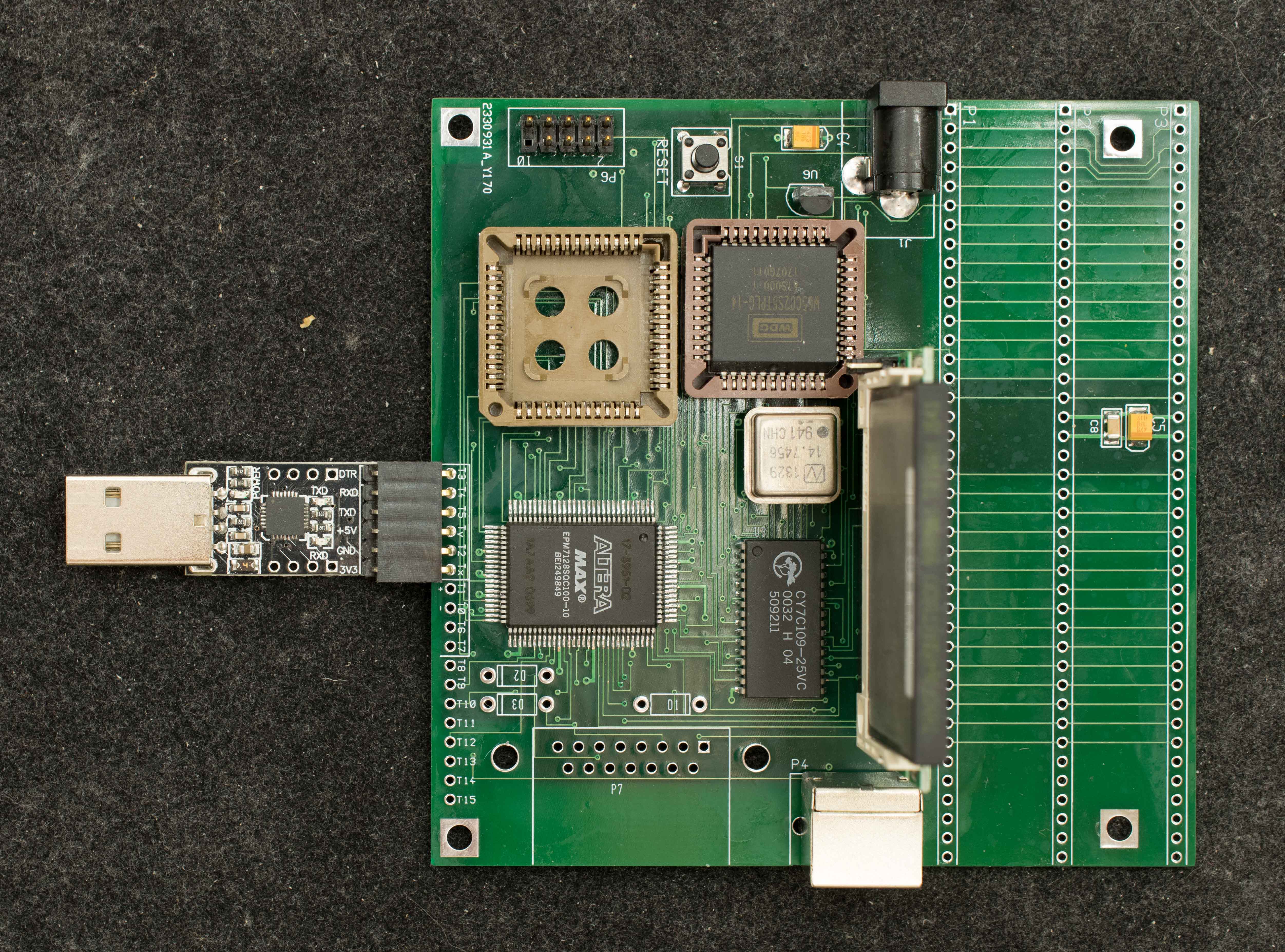

The first 65ALL is working fine at 25.175MHz without VGA and PS2 functions. I built up second board to make sure it can also overclocked to 25.175MHz. I cut and jumper RAM's chip select and write enable such that chip select is always enabled to give it longer access time. I also build an adaptor board to correct the VGA connection mistake. This second board will be the reference hardware for adding VGA and PS2 capabilities. I do have the VGA and PS2 functions added to the CPLD, but the big problem is 170 macrocells are needed while EPM7128 only has 128 macrocell! Now I need to do serious design trade-off and optimization. During software development I need a good serial port to load program at 115200, so I'll keep the serial port for now but either have a primitive PS2 function or getting data from serial port instead of PS2. Then later I can have better PS2 function but a primitive bit-bang serial port.

I needed more cuts and jumpers to free up CPLD resources, but I managed to retain the serial port and CF functions but squeeze in the text VGA function (still no PS2 function). Now I can bootstrap using serial port and then load & run application programs. This is Game of Life running on the VGA monitor.
Next step is bootstrapping from CF disk. I only has 32-bytes of ROM space to fit the CF bootstrap routine. This is where the discussion about "smallest CF card bootstrap ROM" becomes very useful. This is definitely a challenging problem.
Once it can bootstrap from CF disk, then porting DOS/65 to it should be possible.
The big problem further ahead is how to have PS2 function to achieve the goal of a standalone 6502 SBC, yet retain some form of serial port function. The serial port is primarily for file transfer between my PC and 65ALL while developing programs on my PC. It could be bit-bang serial at 38400 or even 9600 (yuck!). I can always plug in a serial port expansion board such as the quad-serial based on OX16C954, but that's throwing in the towel and giving up the goal of a single-board standalone 6502. Well, one step at a time...

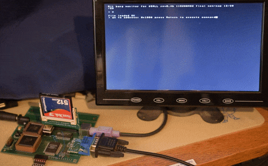

I've received new batch of boards and will be working on other projects, so I'll summarized what has been accomplished on 65ALL for now.
CF bootstrap is working. The code is 32 bytes, 29 bytes plus 6 bytes for NMI, reset, interrupt vectors. I know 29+6 is not 32, but I've overlapped the NMI and low byte of reset vector with JUMP $C020 instruction (opcode $4C20C0) because I've ran out of code space. The interrupt vector is $0200; the reset vector is $FFC0 and the NMI vector is $204C. Ideally I should tune the JUMP instruction to JUMP $C002 (opcode 4C02C0) which will place NMI vector at $024C, but the resource utilization is so tight, it won't compile. This is the CF bootstrap code in CPLD:

The CF bootstrap waits for CF disk to be ready, write "READ command", and reads the contents of Master Boot Record to memory from $C020 to $C0FF and then jumps into $C020. I'm short on code space but need to initialize regX for the "STA $c000,x" instruction so I used "LDX #$20" and STX CFstat to initialize regX to $20.
The program in Master Boot Record copies 8 sectors (4K) from CF disk to $B000-$BFFF and jumps into $B400. This is the program resides in Master Boot Record:

So it boots from CF and runs the monitor. Power consumption is 300mA @5V. "The devil is in the detail", there are lots of loose ends to clean up, most important one is an updated PC board.

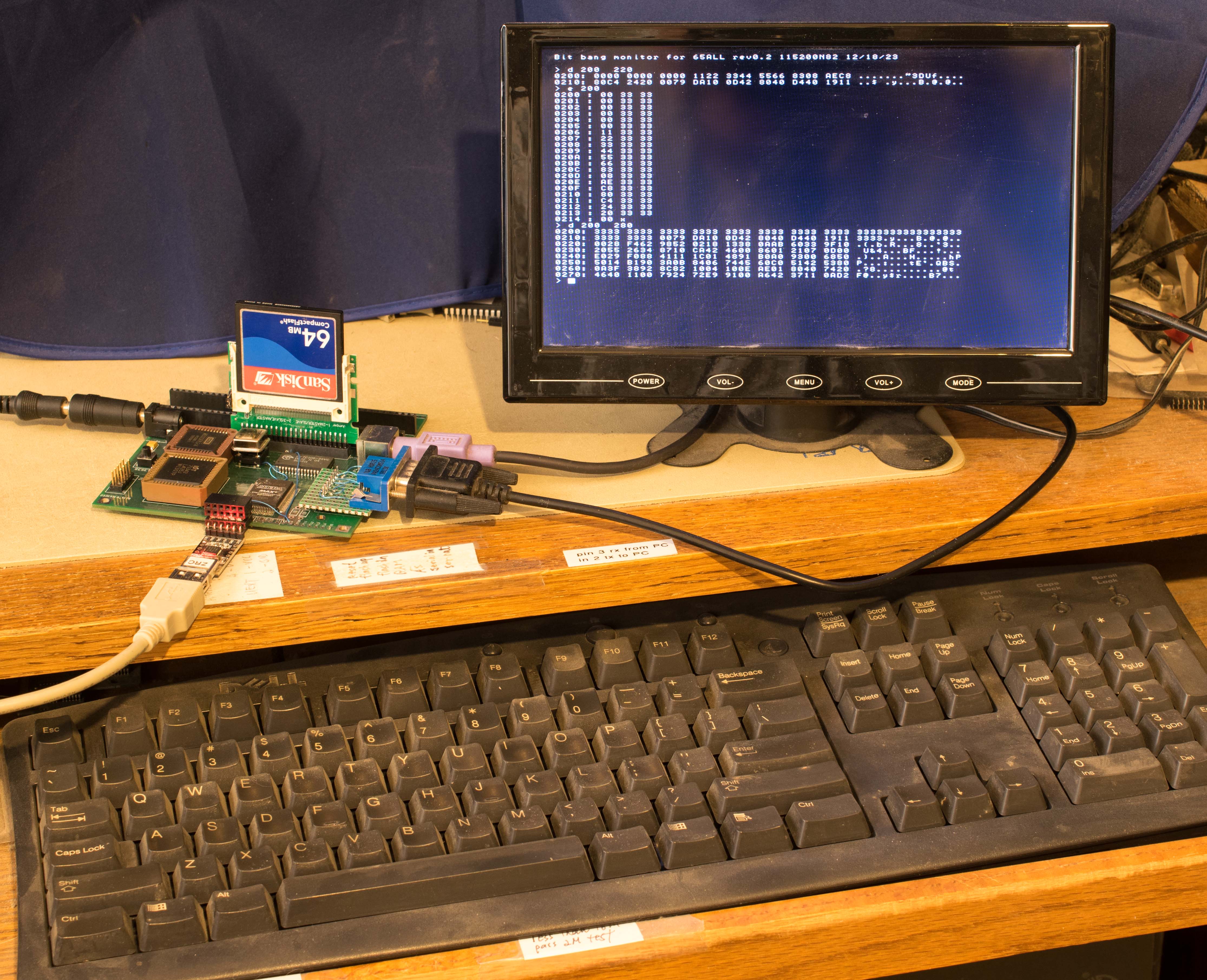

Monitor for 65ALL is up and running. It can receive input from either the PS2 keyboard or TeraTerm terminal emulator and output to both VGA monitor and TeraTerm. It is now a standalone computer but it still needs serial connection to workstation for to update system software as well as download application software.
The VGA controller has no hardware scrolling capability but the 64x48 video texts are directly addressable and video text can be written any time without "snow effect" so scrolling is done in software with 25MHz 6502. In fact, when display a screen full of data, the display bottleneck is actually the bit-bang serial transmit. Gordon in his "Project-28" has mentioned a "CTRL-O" command to toggle on/off the bit-bang transmit. That's a good idea, I'm implement that command for 65ALL as well.
Currently 65ALL is running without interrupt. I still have some spare resource in CPLD to generate 60Hz interrupt from vertical sync. Since the interrupt is in sync with vertical sync, in theory I know exactly which pixel of the VGA screen is being painted. I wonder if I can do something interesting with that?
