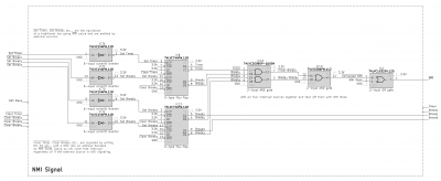

This is a quick post (mostly for gfoot) kind of documenting how I want to deal with NMIs. It hasn't been spun into hardware yet and so may have issues I haven't seen.
The main goal is to be able to stop interrupts completely as I have a couple of operations that MUST be atomic*.

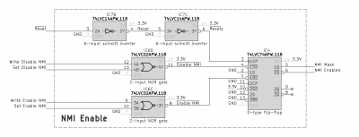

At its simplest the normal '816 going /NMI is run into the circuit below that captures it in a flip flop before ORing the flip-flops output with a positive mask. If the mask (called NMI Mask) is set then /NMI is held high and no interrupt occurs. If it's not set then /NMI can go low (depending on the state of the flip-flop).
However there are four NMI sources and so four flip-flops; all of those outputs must be ANDed together. If I reduced it to two sources then I'd be able to remove at least two ICs. But. This is for the fun of it so I'm happy to go overboard. I have a fairly standard schematic layout where inputs are laid out on the left and outputs are on the right. Signals that are only used internally to are not shown on the borders.
The NMI mask can be set both programmatically or by bringing the Set Disable NMI signal high. It can also be cleared programmatically or by bringing the Set Enable NMI signal high**. Write Enable NMI and Write Disable NMI are decoded from (some) address and bits 4 and 5 of the databus. A one in bit 5 disables NMIs and a one in bit 4 enables NMIs. Zeros are ignored because writes to that address also control clearing of individual interrupts (hopefully that will become clearer further down.
Lastly the state of NMIs can be read from that (same) address - called /NMI State - in data bits 0..3 and once an NMI is serviced it can be cleared by writing to those same bits. When reading if NMIs are enabled then a one is set in bit 4. /WD and /RD are the fairly standard active low write and read signals derived from PHI2 and RWB.
The complete schematic is attached below and physical board will be a 32pin 22mm wide DIP***.
It may be better, if they are the usual level sensitive ones, to not use the flipflops. That way the ongoing state of your NMI output indicates whether the same, or another, device is still waiting to be serviced. So long as your ISR masks NMI while it runs and unmask it after servicing the interrupt, you'll get a second NMI at that point if something is still pending.
If the interrupts are edge-based though then it's a different story. But I've not seen any devices like that.

Where do the interrupts come from - are they from devices that expect an edge sensitive response, or are they the usual active-low ones? If the latter then with schemes like this I think there's a danger that the device's interrupt line does not clear e.g. due to a second interrupt while you're servicing the first one...
The thinking I had when I designed the above board is that I would have four sources of NMI:
1) A timer - to invoke the preemptive supervisor.
2) A signal from the second '816 indicating that it needs attention.
3) A memory access address based break point.
4) A push button for testing.
(All of which are edge signaled)
Expert knowledge.
It's something we humans are really bad at weighting appropriately; something I know is true for myself. BDD has written about NMIs on this forum* and why only one source is a good idea (or more practical). And I have to weight that against my own "but it's so cool to have four NMIs!" thinking. He's right and I'd imagine he has hit all manner of strange corner cases, things I haven't the experience to dream of.
Looking at the complexity in both hardware and software needed to replicate what IRQs are doing already makes it just not worth it. It was a fun learning experience but... nope. Looking at my NMI sources:
1) A timer - this is required
2) Another '816 - it can use an IRQ or be polled from kern[a]l mode. The NMI would ultimately have only set a flag saying that there is a message in the pipe that needs processing.
3) An address break point - most break points I intend to set by using BRK instruction trickery. Do I really need a break point on a non-opcode address? It would be cool but. No.
4) A button - this was just for testing multiple sources on NMI anyway.
With only a timer remaining I don't need to mask out NMIs. It's a software bug if one NMI can't be completely serviced before another occurs. That's not something I need to build hardware around.
So now that I've taken everyone down the garden path I'm rolling the idea back. Hopefully it's triggered thoughts in others; and I'll do another post below on why multiple NMIs cause software issues.
I think this is really important - a lot of extra ideas pop up in hardware discussions, and it's worth considering what they are coping with - and whether or not they need to. Almost always in the land of hobby 6502, we're not dealing with malicious input, only dealing with programming mistakes. A reset is almost always a reasonable way to keep going, if indeed there's any need for anything. The stakes are, in hobby land, very low indeed.
