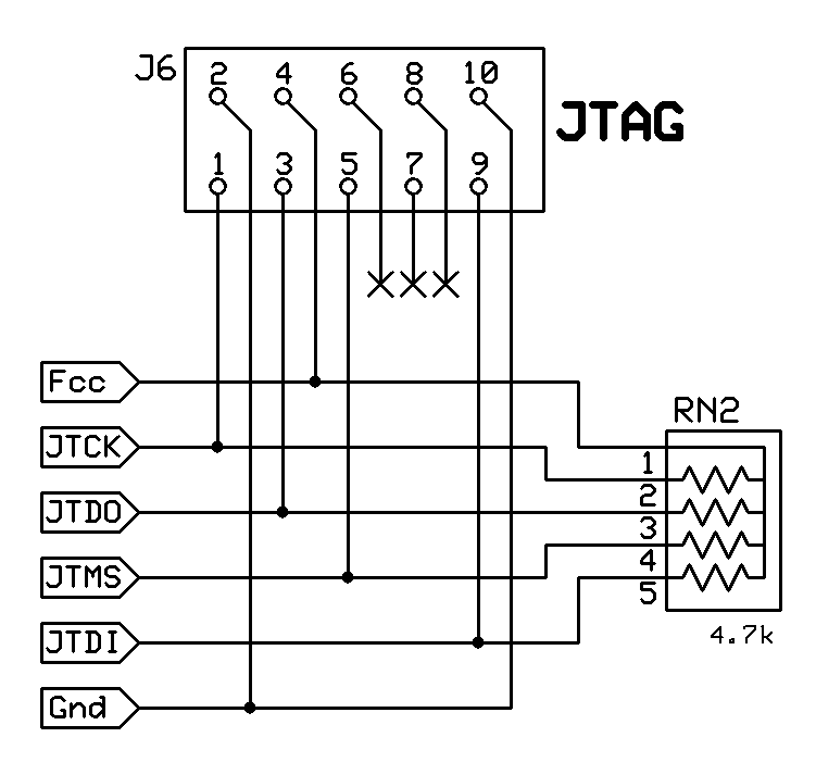

Also, don't forget my offer if you decide to go with an Atmel CPLD instead. You even replied to it. :D Or, you can readily implement a standard JTAG port on your unit. All it takes is a 10 pin header and a small bussed resistor network (or four discrete resistors). Here's the schematic for the JTAP port on POC V2:
File comment: POC V2 JTAG Port
The symbol Fcc is a fused source of 5 volts DC.
Wait...do you mean implementing a JTAG port on my design using a SMD CPLD or implementing a JTAG to try and program the ATF750C?
I don't think that CPLD works with JTAG header/protocol does it?
It doesn't and technically speaking, the ATF750 is not really a CPLD, more like an augmented 22V10 GAL. I was thinking in terms of the ATF150x CPLD series, which has JTAG functionality. The ATF1504AS is probably the smallest member of the ATF150x series that you would want to use, and comes in PLCC44 or TQFP44 packages. As programmed for POC V2, only about 50 percent of the 1504's available logic resources are in use, and that includes basic glue logic, a "hardware management unit" (memory mapping and $00E000-$00FFFF RAM write protection), four bits of bank address latching, generation of an inverted reset signal, generation of qualified /RD and /WD signals, wait-stating, and I/O device selection. I did, however, max out pin usage. :(
