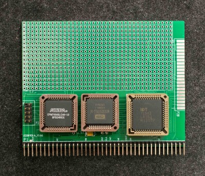

Gordon's recent posts about W65C134 reminds me of my dual-port RAM based multi-6502 design. It is not so much a design than a sandbox to play and add more features. The basic idea is two 6502 sharing a 4K dual port RAM. The main 6502 processor set aside 4K RAM space for the dual port RAM, but the coprocessor only has 4K for program and data. an under-utilized CPLD provides the glue logic between these two processors. There are plenty of logic left in the CPLD to add more features, whatever those may be.
At reset the coprocessor is in reset waiting main processor to write to a magic location to release the reset. The 4K dual port RAM is mapped to both coprocessor's top 4K (reset, interrupt, NMI vectors) as well as the bottom 4K (zero page, stack). The main processor first writes reset vector, interrupt vectors to top of 4K and whatever application program; write to a magic location to release the reset; and communicate to coprocessor via dual port RAM and interrupts.
The board is not standalone; it is meant to plug into a RC6502 style connector as shown in the picture.
I don't have a specific application in mind, but I'm encouraged by what Gordon is able to do with W65C134. I thought a video coprocessor to drive BadApple may be interesting; it can also bit-bang SPI, serial, I2C, PS2,so on.

PostPosted: Sun Nov 26, 2023 6:53 pm
Posts: 3363
Looks like a dangerous amount of fun, Bill! A sandbox like that is one big Solution Looking For A Problem! :P

PostPosted: Sun Nov 26, 2023 7:12 pm
Posts: 746
facny concept, but DPRAM is usually pretty slow which would limit not only the Co-Processor's clock speed but also the overall bandwidth through it, plus they can be expensive if you're unlucky.
while it would make logic a bit more complicated, you could get away with using regular SRAM and some extra stuff to have an external Processor access it when the Co-Processor is paused.
the W24512AK-10 for example is a single 64kB 10ns SRAM chip that could be mapped to the whole 65C02's Address space, making decoding logic very very simple which could allow the CPU to run at insane speeds.
if you're using a CPLD you have more than enough room for logic that gives the main system some control, like sending an NMI to the Co-Processor, resetting it, or pausing it (ie pulling BE+RDY low) to allow access to it's memory through some tri-state buffers.
then you could also do some very minimal communication in the other direction, for example when the Co-Processor writes to address $0000 it sends an interrupt to the main system.
the whole thing could be done in 6 ICs (plus a clock), making for a very compact little card.
i did toy around with this exact idea before, with a 65816 based system that has slots for multiple of those "compute cards" that would each take up 1 bank in the 65816's memory space and some extra logic to capture every card's interrupt signal and stuff like that.

Oh good, lots of interesting ideas already.
"Big Solution Looking For A Problem" is exactly correct. I have to confess that this is not my first dual-port-ram-coprocessor design. There is one for Z80 for about 4 years now that looks the same. 6502.org has many innovative members and I am hopeful many interesting ideas will come. This particular dual port RAM (IDT7134) has several semaphore flags that I don't know how to use. NMI, IRQ, and RDY (perhaps I should include BE as well?) can be generated from main processor to coprocessor. I'm intrigued by the notion of programmable RDY that allows coprocessor to run programmable number of cycles. The CPLD is intentionally under-utilized to allow experimentation. I use this dual port RAM as video buffer for 25MHz Z80 and 6502, so I know it is fast enough to handle inter-processor communication up to 25MHz 6502.
IDT7134 is one of my "essential" IC that is used in many designs. It is inexpensive, $2 each in quantity, and I keep it stocked up at 50 pcs level. I hardly ever sell them so they are for my own tinkering; in fact, I need to order more.
