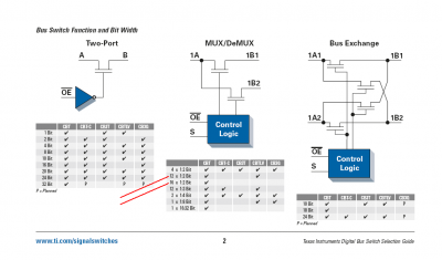

On the subject of a single RAM receiving its address alternately from two different CPUs, it might be worth considering using a FET-based bus switch as mux. There's a major advantage in regard to speed, because the usual notion of propagation delay (as with a conventional mux) doesn't apply. Instead, the signal path through the switch behaves very much as a resistor, on the order of 10 ohms or less. Based on the capacitance of the load (in this case the address inputs of the RAM), you do end up with an RC delay, but it'll be almost negligible -- just a fraction of a ns! :shock:
I'm attaching a screen shot from a 2004 TI selection guide. Various logic families are represented, and I find the "Mux/Demux" and "Bus Exchange" offerings especially intriguing... 8)
