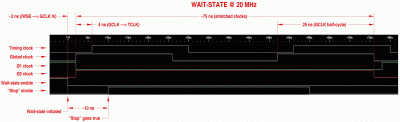

The test rig has been built and tested.  For some completely unfathomable reason, it functions exactly as intended.  :shock:  First, here is a photo I took of the unit after hooking it up to the logic analyzer:
File comment: Test Rig Connected to Logic Analyzer
When the push button at the left end of the unit is pressed, a 1 µsec pulse will be generated to start the wait-state cycle.  I shamelessly “borrowed” the pulse-generator circuit from Garth’s clock page on his website.  :P  For the record, the observed pulse duration is 1.036 µsecs.  :D
The observant will notice that I haven’t installed the output clamping diodes.  For some reason, I thought I had some BAT85s in my parts pile, but that wasn’t the case.  All I had were some SD103s, which with a 10ns TRR, aren’t fast enough.  I’ll get some BAT85s with the next parts order and will subsequently post before-and-after photos of what the clock outputs look like on the scope.
I did scope the clock outputs to verify amplitude and waveform.  There’s a tad bit of ringing, which is to be expected with the extremely fast edges emitted by 74AC devices.  The ringing is more pronounced on the upstream side of the resistor network that drives the outputs, which tells me series resistance is helping.  It’ll be interesting to see what the clamping diodes do.
Meanwhile, I ran some logic analyzer tests to see if theory and practice were approximately the same.  See here for the test rig’s schematic.  Signals being observed in the tests are:
  • Global clock, aka GCLK.  All timing is referenced to GCLK, which runs at the same speed as the oscillator and is never stretched.
    Something worth noting: in this circuit, clock symmetry is exactly the same as the oscillator’s.  Typically, 100 PPM can oscillators have a duty cycle rating that ranges from 47-53 to 53-47.  A system clocked by an asymmetric oscillator and running close to the limits of the MPU can fall victim to difficult-to-diagnose timing violations.  I’ll talk a bit more about this later on.
  • Timing clock, aka TCLKTCLK is the clock source for the 74AC109 timing flip-flop that controls stretching, and is derived from GCLK.  As I surmised that there might be some benefit to having TCLK slightly lag GCLK, I rigged up a jumper block on the board so I could directly drive TCLK from GCLK, or add some lag to TCLK by inserting one or two gates into the signal path.
  • Ø1 & Ø2Ø1 and Ø2 are stretched whenever a wait-state is needed.  In a 65C02 system, Ø1 is unlikely to be needed, but would be useful with a 65C816 to gate the bank latch and data bus transceiver.
  • Wait-state enable, aka /WSE.  In the test rig, /WSE is driven by a Schmitt inverter that is part of the pulse generator circuit.  In a practical application, the glue logic would drive this signal low when a wait-state is required.
  • Stop, aka STP.  This signal is the /Q output of the AC109 timing flop—STP is actually high-true.  I sampled it with the logic analyzer to gain a feel for how long it would take the flop to “wake up” after /WSE was asserted.
Before continuing, I must note that the logic analyzer has a 2ns resolution, which means some timing results need to be taken with a grain of salt, especially at the higher clock rates.  In an effort to make things look as realistic as possible, I set the logic analyzer’s notion of where a logic transition occurs at VCC × 0.5, VCC being 5 volts (measured voltage at the input connector was 5.03).  The set logic transition point definitely affects how the logic analyzer fudges some timing numbers.
Here are the test results.

File comment: Running @ 20 MHz, 1 Wait-State
Above is a run at 20 MHz, with the rig configured to generate one wait-state.  There is plenty of timing head room available.  The lag between GCLK and TCLK is clearly visible.

Some notes:
  • In all of the above runs, TCLK is configured to maximally lag GCLK—there are two gate delays between the latter and the former.  However, the total lag is small, as it turns out the OR gates through which TCLK is derived are substantially faster than the data sheet lets on.  Obviously, that lag could vary with different parts, and definitely would be greater at a lower VCC, but I suspect modern iterations of 74AC logic have gotten substantially faster with improved wafer fabricating processes.
  • Observed clock symmetry varied from one oscillator to another.  However, that observation needs to be considered against fudging effects by the logic analyzer.  Fudging is especially noticeable when an interval being observed is not evenly divisible by 2.  At maximum resolution, the logic analyzer will round things to the nearest 2 ns, which may cause symmetric signals to appear asymmetric.  For example, the clock phase period at 40 MHz is 12.5 ns.  The limits of the logic analyzer’s resolution would represent that as 12 ns, causing the 40 MHz clock to “look funny.”
  • As the AC109 timing flop is clocked at the same frequency as GCLK and the unstretched Ø1 and Ø2 clocks, gating the flop’s /K input by /WSE is not nearly as timing-critical as is the case with the circuit I presented much earlier in this topic.  In that circuit, the reference clock is the oscillator, which runs at twice the speed of GCLK, making the available timing window a lot smaller.  In this circuit, as long as /WSE goes low at least TSU nanosecs (~5 ns minimum with a 74AC109 at 5 volts) before the rise of TCLK, the circuit should be reliable.
