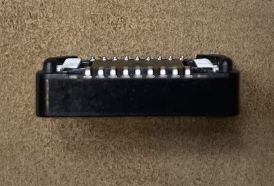

BillO wrote:
Do you have side/angle shots that show how far the contacts extend below the bottom of the socket base?
I guess it's about the same as the stand-off height.
Hope these pics are helpful. The leads do extend down very slightly, so that should help with either manual soldering or a reflow oven/hot plate.
Who makes the socket?

The socket is a 3M product:
P/N 8432-21A1-RK-TP
Mouser, DigiKey and others stock it.
