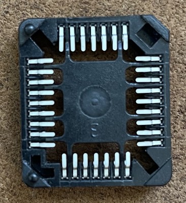

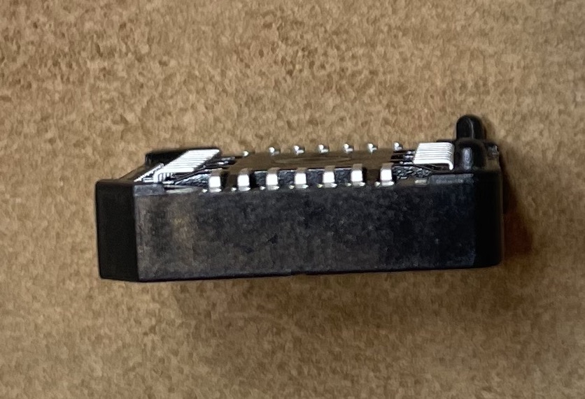

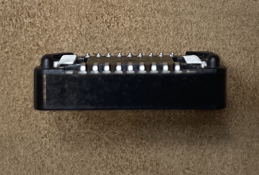

BillO wrote:
Do you have side/angle shots that show how far the contacts extend below the bottom of the socket base?
I guess it's about the same as the stand-off height.
Hope these pics are helpful. The leads do extend down very slightly, so that should help with either manual soldering or a reflow oven/hot plate.
PostPosted: Sun Aug 07, 2022 3:33 am
Posts: 1007
PostPosted: Sun Aug 07, 2022 4:20 am
Posts: 8509
Who makes the socket?
PostPosted: Sun Aug 07, 2022 1:55 pm
Posts: 1385
The socket is a 3M product:
P/N 8432-21A1-RK-TP
Mouser, DigiKey and others stock it.

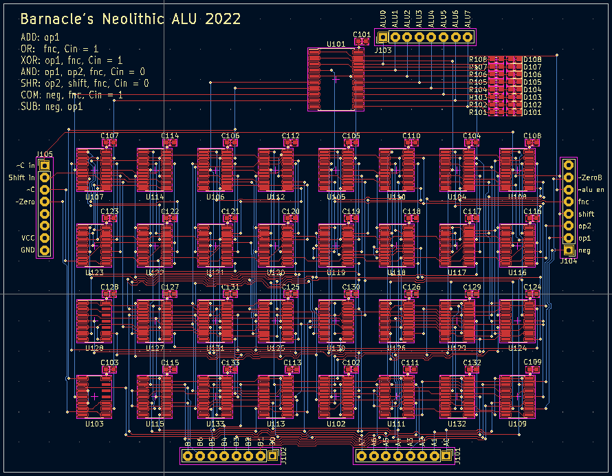

It's only recently - in spite of pushing fifty years of building stuff - that I've had to consider EMI regulations (a video amplifier in a metal case in an apparatus room, or a robot three miles underground, doesn't really care if it doesn't interfere with itself). But most recently I've had the joy of having to meet international regs for EMI and I can state that it *is* possible to run a processor at 32MHz on a two layer board and still meet the specs.
Most of the emitted radiation - up to 3.5GHz IIRC - is not from the board itself but from things fastened to the board: external LEDs and opto-sensors, leads to strain gauges and switches and motors etc. For confidentiality reasons I can't go into detail but a ground pour on the component side and a power pour on the other side, a number of chip inductors in series with external connections, and attention to decoupling. One thing to bear in mind is that with some processors - e.g. the STM32L range and no doubt others - the drive speed of the output pin can be controlled. There is no sense in setting it faster than you need to.
Other, faster, parts require a four layer board to keep the emissions under control and where possible, use of spread-spectrum clock signals which 'smear' the noise wider in frequency bit lower in amplitude.
For my 'play' boards I don't really care about the radiated emissions but I do try and keep good practice - though I'm sure there are as many definitions of that as there are engineers. I prefer to use double sided boards with ground on the component side and Vcc on the other; traces go left right on one side and up down on the other (which means there is a # mesh of power across the board) and I insist on chips facing the same way if at all possible - pin 1 is top left or top right depending how it fits.
Here's a recent example, with the fill planes turned off (or it becomes even more incomprehensible) to show the idea:
