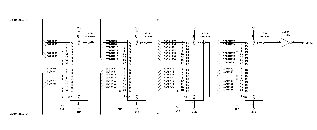

- Last issue... I'm getting no interrupts out of TOD. 4 chained 74HC688 compare the value in the TOD registers with the value in the ALARM registers.
I don't see how could this fail, so probably, a bad solder somewhere.
A good reflow on all the comparators, and problem solved.
