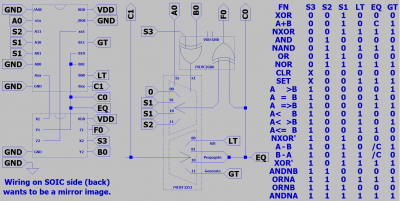

Regarding CBT3253, there are variants with separate /OE behavior.
The spec sheet internal drawing from a few posts back shows AND.
Both styles of /OE are correct, just be aware when you order.
Or design so unified or separate behaviors won't matter.

PostPosted: Sun Sep 24, 2023 3:53 pm
Joined: Fri Sep 22, 2023 9:42 am
Posts: 34
Squonk wrote:
Hi Neil,
This looks interesting - but to be honest, it's worth it just for the signal names... converse nonimplification? I need one of those :D
In logic, a converse nonimplification is a logical connective.
But yes, not all the logical combinations are equally useful :)
Illogical Gibberish only nonimplifies Gibberish. Anyone with sense should refuse.
Oddballs are less confusing as magnitude comparisons: A>B, A=>B, A<B, A<=B
Converse gibberish, ORNB, ANDNA don't suggest utility, while magnitude does.
But don't want to conflate bitwise logic names with magnitude chain controls.
Why I left mine ORNA whatever, till I figure something better...
There are control line savings by combining the middle Karnaugh columns.
Oddballs and identities lost, but easily restored or faked by other means.
A smaller table of controls without obvious order, hard to memorize...
A carry chain jammed high can also invert logic. Allows S0 to be grounded.
