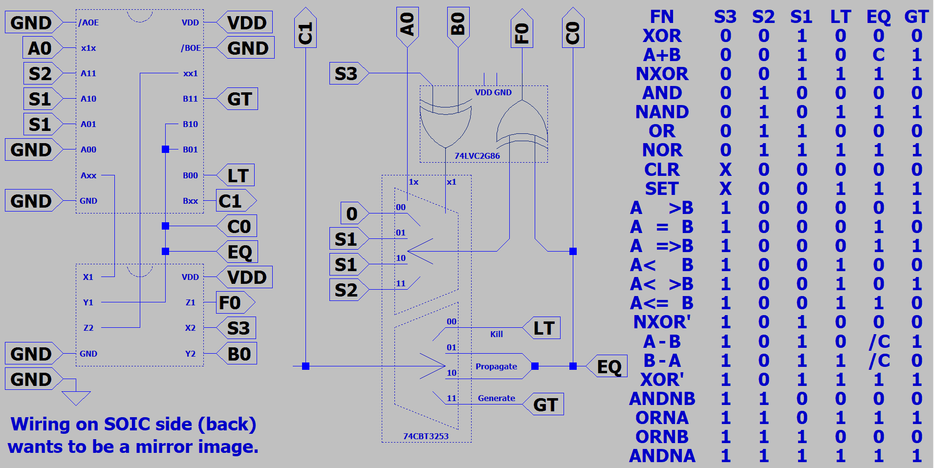

Fast Discrete FET-Switch ALU

Re: Fast Discrete FET-Switch ALU
El more or less:
Pull down to GND is a much less resistive RC.
Pull up is slower, but only delay to logic true counts.
Initial rise to 0.9V is quite fast. Time to full scale doesn't matter.
We might imagine AUC and CBT have similar balance of R vs C.
But the fanout of XOR gates, open replacement branches, and
other necessary sphagetti are drops in a much larger bucket for
CBT than AUC.
CBT than AUC.

This looks interesting - but to be honest, it's worth it just for the signal names... converse nonimplification? I need one of those

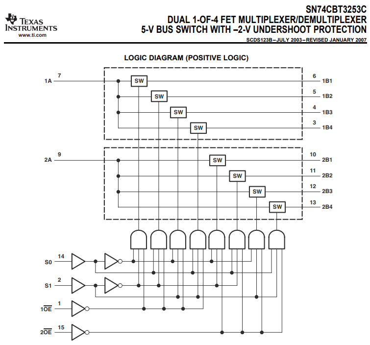

Regarding CBT3253, there are variants with separate /OE behavior.
The spec sheet internal drawing from a few posts back shows AND.
Both styles of /OE are correct, just be aware when you order.
Or design so unified or separate behaviors won't matter. /OE confusion goes all the way back to 74153...
I think TI and Phillips were initially different,
then each made a variant to clone the other.
Should also give attention to select pin logic thresholds.
Some 0.9V for 1.8V logic compatibility regardless VDD.
I did not confirm threshold behavior when VDD=7V.
Was happy enough no smoke escaped...

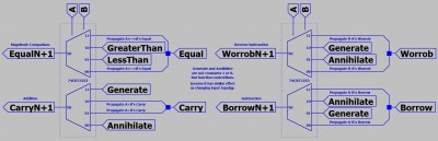

Squonk wrote:
Hi Neil,In logic, a converse nonimplification is a logical connective.
But yes, not all the logical combinations are equally useful
Oddballs are less confusing as magnitude comparisons: A>B, A=>B, A<B, A<=B
Converse gibberish, ORNB, ANDNA don't suggest utility, while magnitude does.
But don't want to conflate bitwise logic names with magnitude chain controls.
Why I left mine ORNA whatever, till I figure something better...
There are control line savings by combining the middle Karnaugh columns.
Oddballs and identities lost, but easily restored or faked by other means.
A smaller table of controls without obvious order, hard to memorize... A carry chain jammed high can also invert logic. Allows S0 to be grounded.
Ken KD5ZXG
- Posts: 34
- Joined: 22 Sep 2023
I switch between carry, borrow, and magnitude a lot. Same as inverse B, don't let it throw you.
Can distort Karnaugh map in twin MUX4 though. That feature abused above to restore oddballs.
