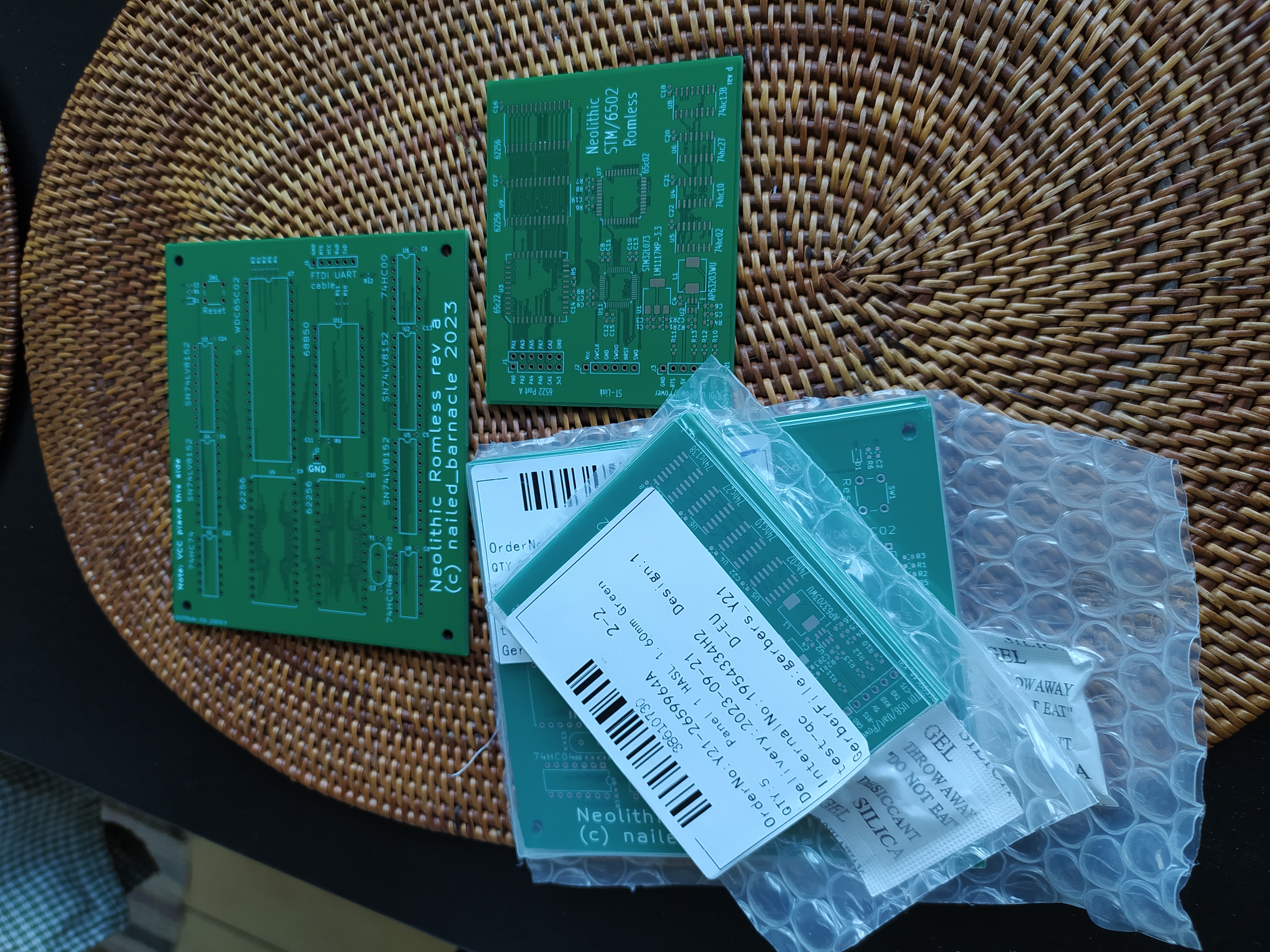

The circuit boards came back for both Neolithic Romless designs, along with a solder stencil for the STM-powered board. Hopefully I get some time to build at least one of them... I bought a new house yesterday so there may be some liftin' and carryin' to be done :mrgreen:

 Post subject: Re: Neolithic Romless
PostPosted: Thu Sep 28, 2023 5:02 pm
Starting with all your 6502 paraphernalia, of course! :P And congratulations, BTW!
(Regarding the new PCB's, I mean! 8) Oh, and the new house, too, I guess... :wink: )
