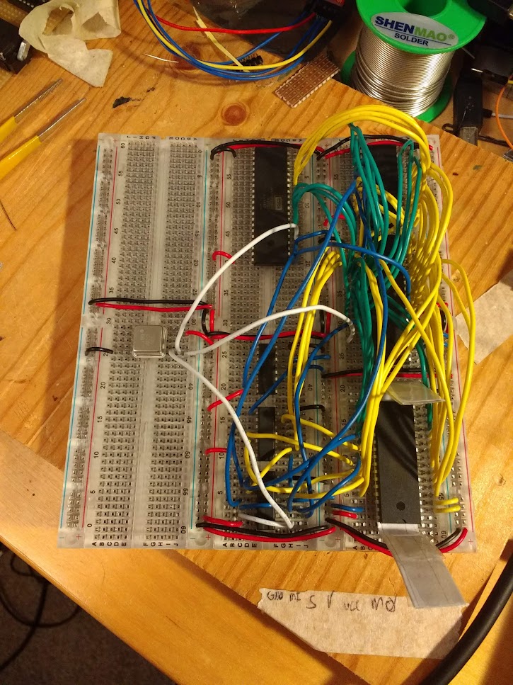

PostPosted: Thu Aug 17, 2023 8:00 pm
Joined: Mon Mar 06, 2023 9:26 am
Posts: 88
Location: UK
Day 2: address wiring is finished!
I ended up swapping A10 and A11 on the RAM, because it made the wiring easier and doesn't affect operation at all. Next is data bus, then a few days of waiting around for parts to arrive.

PostPosted: Thu Aug 17, 2023 8:49 pm
Posts: 88
Location: UK
Decided to flip the VIA round because all the IO pins were on the side closest to the processor and the control/address/data lines were closest to the edge of the board. This way, the wiring is neater and it's easier to rig stuff on another board to the IO pins.

PostPosted: Thu Aug 17, 2023 8:56 pm
Posts: 88
Location: UK
Also, I've just noticed that the data pins are in the same place on the 6502 and 6522. Not sure when this would be useful, but it's interesting

PostPosted: Fri Aug 18, 2023 7:37 am
Posts: 731
Anytime you're dropping a data bus onto a PCB layout... parallel pins really are the easiest to manage. (It's unfortunate that the data and signal pins on a DIP 6502 don't map onto a JEDEC memory (eeprom/ram) chip, but we can't have everything in life.)

PostPosted: Fri Aug 18, 2023 11:39 pm
Posts: 1003
Good observation. You can mix up address and data lines on RAM 'till the cows come home. It's sometimes a handy thing for efficiently laying out PCBs.
Not so much with ROM unless you are willing to shuffle the code around too.
