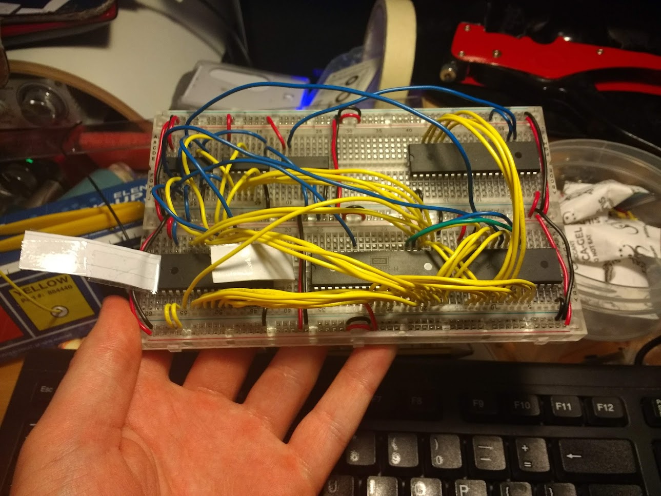

Day 2: address wiring is finished!
I ended up swapping A10 and A11 on the RAM, because it made the wiring easier and doesn't affect operation at all. Next is data bus, then a few days of waiting around for parts to arrive.
Good observation. You can mix up address and data lines on RAM 'till the cows come home. It's sometimes a handy thing for efficiently laying out PCBs.
Not so much with ROM unless you are willing to shuffle the code around too.
