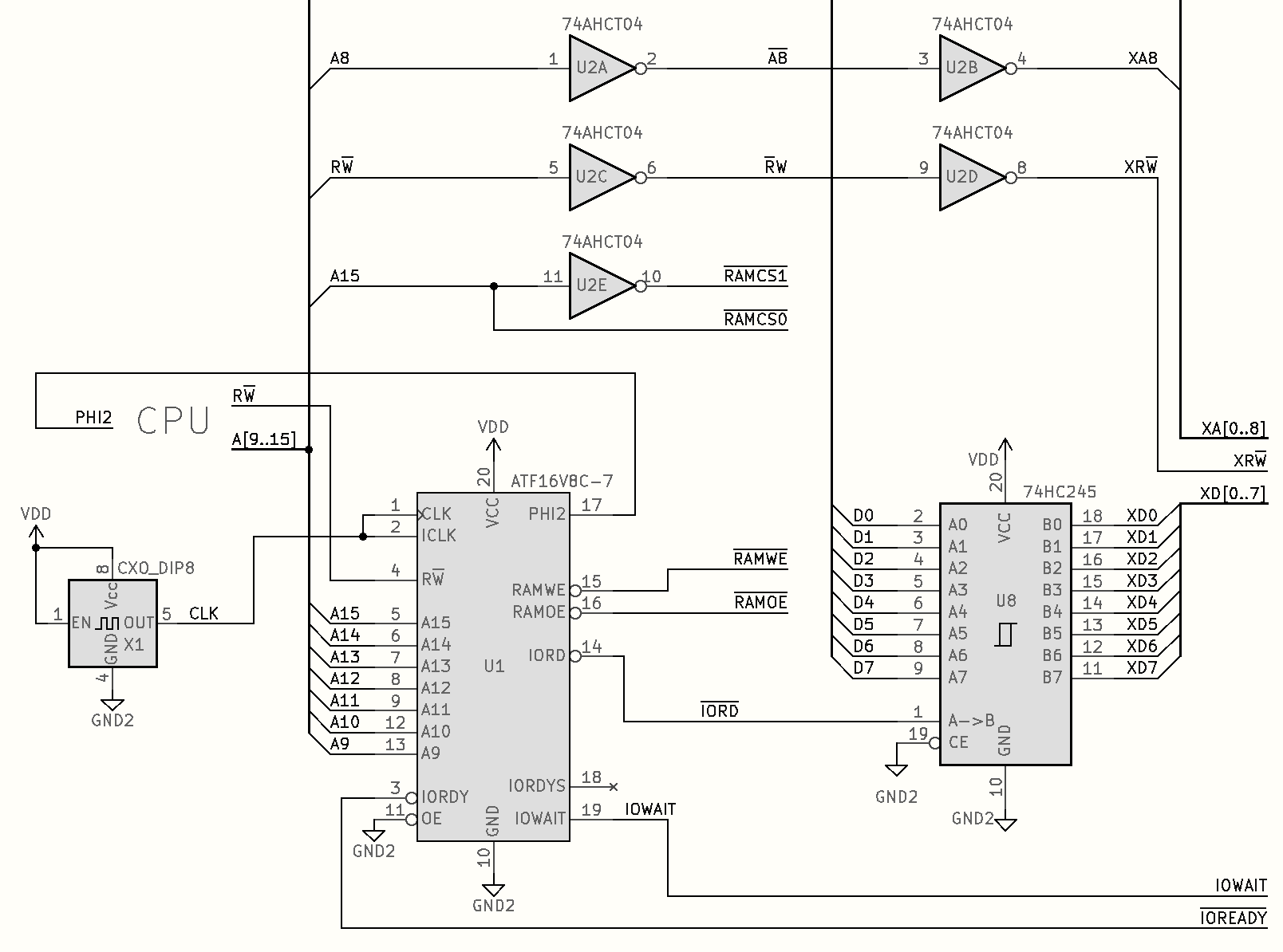

Actually judging by the prediction failures there were some issues with the data capture, it looks like it double-counted some samples. I made a script to edit them out, so here's a version of that trace without the bad data samples in it - there are no prediction failures in this one, as I also made it start at a JMP instruction.
filtout13.txt.gz
(248.32 KiB) Downloaded 75 times
I'm surprised there are no prediction fails if the TSB/TRB Dormann test is hitting a fail.
This sequence just prior to the failure is interesting:
   32554     7f2a 0 68 ? ? ?
   32555     7f2b 1 29 ? ? ?
   32556     7f2c 2 b0 ? ? ?
   32557     7f2d 3 ff ? ? ?
2516 : 68       : PLA            : 4 : A=FF X=?? Y=20 SP=?? N=1 V=1 D=1 I=1 Z=0 C=1
   32558     7f2e 0 29 ? ? ?
   32559     7f2f 1 02 ? ? ?
2517 : 29 02    : AND #02        : 2 : A=02 X=?? Y=20 SP=?? N=0 V=1 D=1 I=1 Z=0 C=1
   32560     7f30 0 c5 ? ? ?
   32561     7f31 1 0e ? ? ?
   32562     7f32 2 ff ? ? ?
2519 : C5 0E    : CMP 0E         : 3 : A=02 X=?? Y=20 SP=?? N=0 V=1 D=1 I=1 Z=0 C=0
This is testing the Z flag (on the stack) against the expected value. After the AND instruction, A can only be 0 or 2, yet the CMP against the expected value is reading FF from address 0E. That's clearly wrong, and if memory modelling was enabled I would expect an error to be flagged, because the previous CMP 0E read a value of 02:
   32496     7ef0 0 c5 ? ? ?
   32497     7ef1 1 0e ? ? ?
   32498     7ef2 2 02 ? ? ?
24E9 : C5 0E    : CMP 0E         : 3 : A=02 X=?? Y=20 SP=?? N=0 V=0 D=0 I=0 Z=1 C=1
What options are you running decode6502 with?
Memory modelling is disabled by default, and needs --mem=00f to enable it.
I suspect the failure here is stray memory writes.

Ah yes, well spotted - I thought I had memory modelling enabled, but I had left it out. There are two memory modeling failures in the trace - the one you spotted, and one which is due to the address in question being a 6522 register.
Given that the error report listed 0E as containing FF as well, it does look like a faulty write occurred at some point, rather than this being a faulty read.
I wonder whether tsb/trb could somehow cause this - as I ran a long stress test in the past without any similar errors. I believe when it's failed in the Dormann tests it's also always been in this specific test.

It does look like it's the TSB instruction that could be causing the fault - writing FF to 0C but perhaps that's causing my circuit to write it to 0E as well. I'm not sure why this would only affect TSB but will check and rerun my memory stress test and see if that's also failing now.
Edit 2 - some memory accesses don't seem to appear in the trace. This was with --mem=FFF. Stack operations in particular seem to not get listed, nor idle bus cycles.

gfoot wrote:
Ah yes, well spotted - I thought I had memory modelling enabled, but I had left it out. It does look like it's the TSB instruction that could be causing the fault - writing FF to 0C but perhaps that's causing my circuit to write it to 0E as well. I'm not sure why this would only affect TSB but will check and rerun my memory stress test and see if that's also failing now.
The most likely source of stray writes is the addess bus changing during the write cycle (i.e. when RAM nWE is low). This might be happening at either end of the write cycle.
If you slow the clock down and the problem goes away, then I think that's an indication that the problem is at the start of the write cycle.
This is running at 25.175MHz with a 35% positive duty cycle?

As the breadboard prototype has been working well, I updated my PCB layouts to match it and sent them off for manufacture. The main change from the initial breadboard prototype was moving from use of RDY to clock stretching, by adding a quad-OR IC so that PHI2 could be held high when RDY would have been low in the old design. The PCBs also have a footprint for the DS1086Z programmable oscillator that was recommended earlier in this thread, so I'll more easily be able to test at different clock speeds.
As it takes a while to make and ship the PCBs, in the meantime I've been thinking about future enhancements to make. This post is mostly going to be briefly mentioning some of the ideas I've had so apologies if it's a bit disjointed - these are early thoughts.
What I've already designed should run quickly and be quite expandable. Potentially some sort of VGA board could plug into one of the I/O slots. The I/O slots don't have many address lines, so it would need to have a command-based register interface rather than memory mapped framebuffer. It would be pretty easy though to make such an interface to one of my existing VGA circuits, I think, and I've been meaning to do that for a while so that I can then expand on it to produce something that's a bit more GPU-like - hardware accelerated drawing operations for example.
Back on the CPU module, I used discrete logic ICs for clock stretching and high level address decoding, because the propagation delays with AHCT parts seemed lower than the nominal delay of the simple PLDs I'm using:
Original design, discrete glue logic
However, in practice the PLDs seem to perform much better than the datasheet would imply, and I'd like to swap out the 74AHCT139, 74AHCT74, and 74ACHT32 for an ATF16V8. That can easily do the same job, should be faster, and will have spare pins for other things:
Potential PLD-based glue logic design
Potentially I could make this update to the PCB design and fab that as a variant of the CPU module, as it is swappable.
It might also be interesting to make a 4-layer board version of the CPU module and see whether that's able to run any faster than the 2-layer board - again this can just be plugged into the existing I/O module without requiring changes there.
For general system improvement, I'm interested in revisiting the memory map and RAM/ROM split. Currently there's 32K of RAM from $0000-$7FFF, with 32K of ROM from $8000-$FFFF except for the region from $FF00-$FFBF which is decoded for I/O (VIAs, etc). A big disadvantage of this memory map is that in this system any code that runs from ROM is rather slow, as all ROM accesses are cycle-stretched just like I/O is. The plan was to just copy the code to RAM and run it there, especially if it's code that benefits from speed, but it means that half the address space is then lost, and there's only 32K of usable memory. It's OK for a prototype but not so good for general purpose use.
The reason for this memory map, initially, was to minimize the address decoding overhead for the RAM, to allow it to run as quickly as possible. Having one IC always selected achieves that, with initialy address decoding based only on A15 - if A15 is 0, it's a RAM access, otherwise it's either ROM or I/O and needs clock-stretching either way. I'm not able to find the 64MB ICs that Michael uses - 32MB is the only one I find in stock at the usual places, at this speed (~12ns). However I can of course use two of them, with one selected by A15 being low and the other selected by A14 being low and A15 being high, for example. In fact with the glue logic replaced with the PLD, there's enough spare pins to wire through all the address bits from 15 down to 9, and have the PLD decide whether high address space accesses are RAM or I/O/ROM.
PLD-based design with 64KB RAM
In this case, the PLD would disable RAMOE and RAMWE during I/O access, and the inverters drive the two RAM CS signals regardless of I/O decoding. The other inverters are also acting to buffer A8 and RWB for passing off the board, so I can get rid of the existing transceiver for the high address lines. I could use an ATF 22V10 PLD instead of 16V8, to get more pins and do the inverting in the PLD, but I found in the past that the 22V10s use a lot more current and run a lot warmer, and I didn't like that, so I try to fit things into 16V8s instead now.
This would lead to a memory map with one bank of RAM from $0000-$7FFF, another from $8000-$FDFF, then ROM from $FE00-$FFFF minus the same I/O window as before from $FF00-$FFBF. That is not much ROM but I believe it is enough for an SD card bootloader or something similar. This should be possible to do with changes to the CPU module alone - a new PCB could be fabricated that would plug into the existing I/O module.
I seem to have a spare inverter as well, which could actually be used to still pass A9 to the I/O board in addition to A0-8, allowing twice as much ROM if that turns out to be needed/useful.
A nice side-effect of this would be that the CPU module no longer needs to send so many address lines to the I/O module. As noted above it saves a transceiver, and also the connector I have between the two is rather overloaded at the moment - it's a 36-pin card edge connection, with 29 data signals and only 7 power/ground lines. Getting rid of 6 address lines will bring it to 23 data signals and 13 power/ground return lines, which is not ideal, but is a better balance.
CPU module card edge connector
Another interesting option is to go ROMless, and preload the RAM - this is why I've been asking about those techniques on other threads, especially regarding SPI EEPROMs. Dr Jeffyl's scheme is very interesting as a hack; or copy data to RAM from a parallel or serial ROM can be done with just a few ICs; or from a microcontroller, maybe even the FX2LP logic analyser with some patched firmware. This would free up three more address lines that would no longer need to go to the I/O module.
For a more retro feel I have also thought a bit about DMAing data from floppy disk into RAM to boot from. The floppy disk driver circuit that I built last year could do this fairly easily if I stored the boot code in the last 256-byte sector of every track on the disk, and rigged the DMA system to fill from $FF00-$FFFF - I wouldn't need to care which track the drive was on, nor decode sector headers, just read every sector into memory and after a couple of index holes to ensure the disk is up to speed, stop and release the CPU to run whatever was loaded last. Again this could be done entirely within the CPU module I believe - though it may be more sensible to redesign the I/O module to properly support DMA.
Anyway I think those are all my thoughts at the moment - quite a mixed bag I'm sure! Mostly right now I'm looking forward to the PCBs arriving in a few days, and being able to test this design more completely.

Your overall concept for this project seems a lot like what I'm going for with Blue August. I'm wondering about this:
This is elegant; but does that mean *all* I/O transactions are slow, including VIA access? I have it so that the VIA is clocked at the same frequency as the RAM and the CPU only slows down for ROM and slow I/O (like my old ACIA). It seems like you're doing the inverse of that - the constant system clock is the slow clock, and the CPU only speeds up to access the RAM. Rather than clock stretching, it's clock shrinking! I hadn't thought of doing it that way, but it does seem like it could simplify some things.
gfoot
Posts: 871
Joined: 09 Jul 2021
Re: "Fast" PDIP 6502 design feedback
Post by gfoot »
Paganini wrote:
Yes, all I/O transactions set the IOWAIT signal and the IOREADY signal won't be sampled until the next clock cycle, so the soonest time such an operation could finish is on the next rising edge of the original clock. But the current I/O module design always stretches the clock to cover the next two cycles of its own clock, and then a random bit more due to the clocks not being synchronised. I was quite conservative here and didn't really care how slow ROM and I/O operations became, for this first pass. In practice with a 25.175MHz CPU clock and 16MHz I/O clock I think this ended up averaging something like 6MHz-9MHz overall cycle rate when running from ROM.
I guess you could view it that way - but really it is the CPU's clock signal that's being stretched - it's actually just forced high during I/O operations, so the duty cycle gets really extended.
Plasmo mentioned that he thinks he's had a 6502+RAM+6522 combination running at about 25MHz in the past, so I think it's probably possible to have the 6522 on the fast bus in general and still get good speeds - however, even if the 6522 is capable of keeping up, simply having it on the bus presents additional loads, both from its pins and also the PCB traces to reach them, and also means that the relevant address decoding moves back on to the critical path. I don't know how much these things matter in practice, but at least for a first pass I wanted to focus my design on ensuring the 6502+RAM could run at their best possible rate, without letting other things compromise that.
