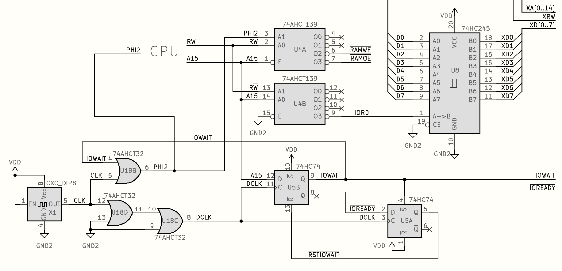

Back on the CPU module, I used discrete logic ICs for clock stretching and high level address decoding, because the propagation delays with AHCT parts seemed lower than the nominal delay of the simple PLDs I'm using:
File comment: Original design, discrete glue logic
However, in practice the PLDs seem to perform much better than the datasheet would imply, and I'd like to swap out the 74AHCT139, 74AHCT74, and 74ACHT32 for an ATF16V8. That can easily do the same job, should be faster, and will have spare pins for other things:

This is elegant; but does that mean *all* I/O transactions are slow, including VIA access? I have it so that the VIA is clocked at the same frequency as the RAM and the CPU only slows down for ROM and slow I/O (like my old ACIA). It seems like you're doing the inverse of that - the constant system clock is the slow clock, and the CPU only speeds up to access the RAM. Rather than clock stretching, it's clock shrinking! I hadn't thought of doing it that way, but it does seem like it could simplify some things.
PostPosted: Thu Aug 17, 2023 4:31 pm
Posts: 741
Paganini wrote:
gfoot wrote:
The reason for this memory map, initially, was to minimize the address decoding overhead for the RAM, to allow it to run as quickly as possible. Having one IC always selected achieves that, with initialy address decoding based only on A15 - if A15 is 0, it's a RAM access, otherwise it's either ROM or I/O and needs clock-stretching either way.
Yes, all I/O transactions set the IOWAIT signal and the IOREADY signal won't be sampled until the next clock cycle, so the soonest time such an operation could finish is on the next rising edge of the original clock. But the current I/O module design always stretches the clock to cover the next two cycles of its own clock, and then a random bit more due to the clocks not being synchronised. I was quite conservative here and didn't really care how slow ROM and I/O operations became, for this first pass. In practice with a 25.175MHz CPU clock and 16MHz I/O clock I think this ended up averaging something like 6MHz-9MHz overall cycle rate when running from ROM.
I guess you could view it that way - but really it is the CPU's clock signal that's being stretched - it's actually just forced high during I/O operations, so the duty cycle gets really extended.
Plasmo mentioned that he thinks he's had a 6502+RAM+6522 combination running at about 25MHz in the past, so I think it's probably possible to have the 6522 on the fast bus in general and still get good speeds - however, even if the 6522 is capable of keeping up, simply having it on the bus presents additional loads, both from its pins and also the PCB traces to reach them, and also means that the relevant address decoding moves back on to the critical path. I don't know how much these things matter in practice, but at least for a first pass I wanted to focus my design on ensuring the 6502+RAM could run at their best possible rate, without letting other things compromise that.

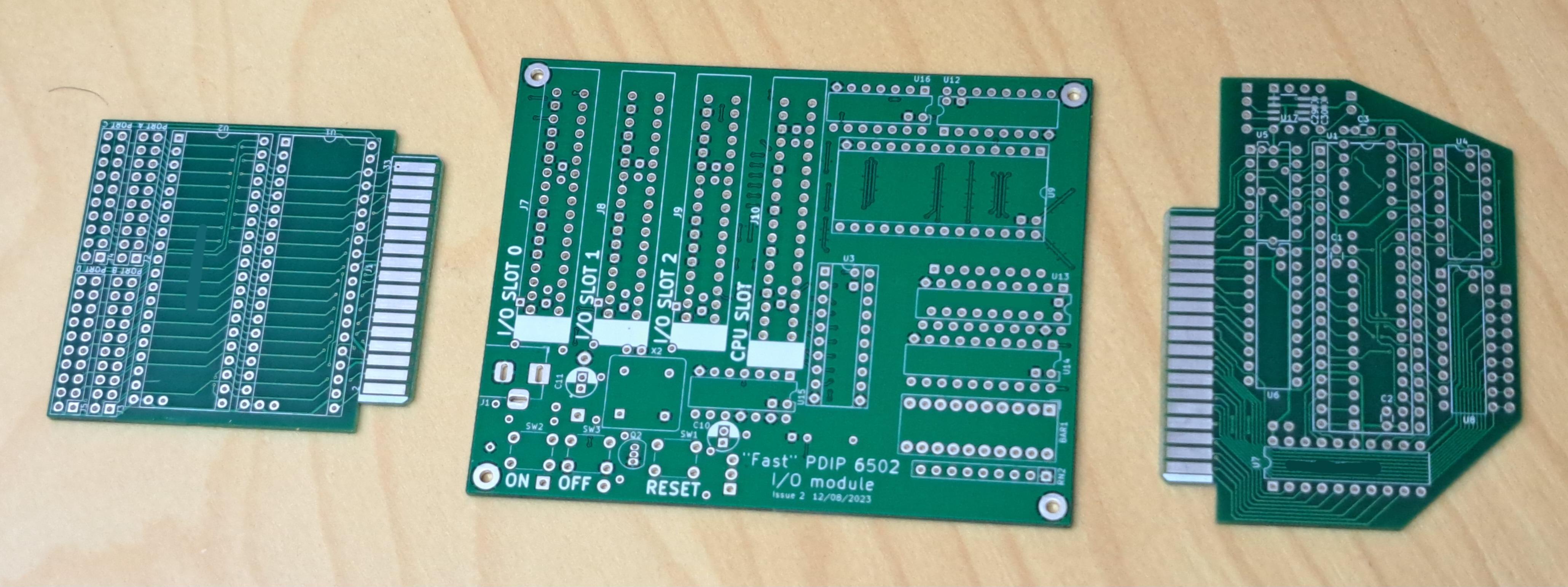

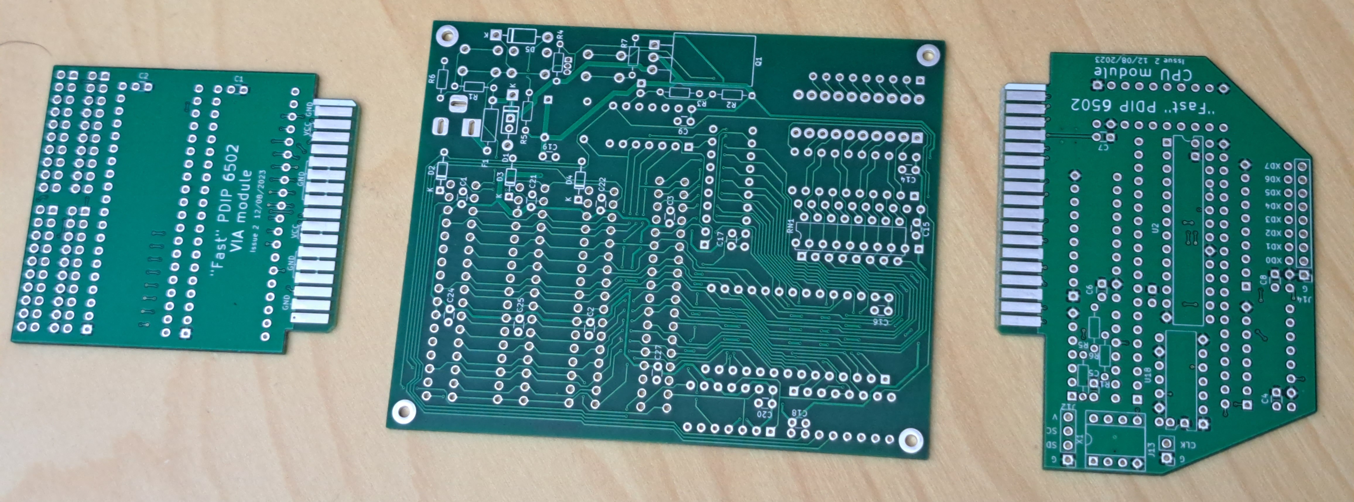

The PCBs arrived today - I have a VIA expansion board on the left, the I/O board in the middle, and a CPU board on the right:
I wasn't sure what to expect from the card edge connections, but they came out well. Crucially, they do fit into the sockets! I'm aware that the tin will get scratched off and connection quality will suffer, but interested to see how much abuse they take before that happens. I asked for a chamfered edge on the cpu board but not the VIA board, to see what the difference was like. I don't think it matters much.
The card edge sockets require a fairly thick board, these are 1.6mm.
