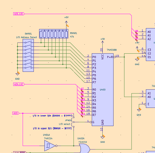

I think you shouldn't use global labels (e.g. A15) that are subsets of the bus, for sure, as the "A15" on the bus is not necessarily the same. I believe you should use the whole bus every time, with a consistent range of members, and break out the wire you need from it - or explicitly export wires like A15 on one of the sheets to a global A15 label, to make sure that in other sheets the global label A15 does refer to that wire.
But the main reason you're getting ERC errors, I think, is that you're using "bus-to-bus entries" to make 45-degree lines - they are not normal connections, so one side of them is not actually the same bus as the other! Either draw 45-degree lines by hand (tedious) or just don't draw the 45-degree lines at all. If in doubt, I think Alt-4 will highlight everything connected to a wire you hover over, so you can verify what is or is not connected.
I can't confirm the above however as Kicad 7 no longer seems to have the bus-to-bus entries, only wire-to-bus entries. I'm not even sure what the bus-to-bus ones actually were meant to do.

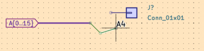

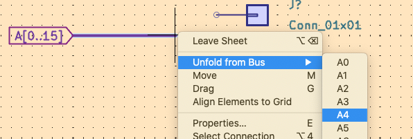

I'm not sure what that means, "bus-to-bus entries?" I made the bus with the blue drawing tool that looks like a forward slash. I defined its net using the "global label" tool that looks like an A inside of a chevron. To connect individual pins to the bus I used the right click menu "unfold from bus" tool that I saw in the "bus" tutorial:
That creates the local label "A4," a bus entry wire, and changes the tool into the green "wire drawing" tool so you can connect to the pin:
And, in fact, this seems to work! This demo connection makes the error about A4 go away!

Anyway, here's a more or less done schematic. It's in black & white in case BDD is lurking menacingly someplace nearby. :P I didn't do the VGA page, because I thought I'd wait until I'm back home to do that so I can make sure it accurately reflects what I really built on the breadboards. Also I plan to add a "Serial" page eventually for an ACIA. I've gotten behind on my Ben Eater videos. :D

Nice! I'd suggest learning how hierarchical pins work, they can be quite nice to use depending on how modular your sheets are, and make you less dependent on getting the global labels matched correctly.
J301 is missing some resistors otherwise it's going to short VCC to ground.
I'm not sure why RAM/~ROM has a pulldown resistor, R401?
Also where did you get your symbols from, did you make them yourself? I've looked for decent 6502 symbols in the past and ended up making my own or customising them I think, so I'm curious where you found yours.
This originally had a separate VCC for each jumper, I think, and I messed it up trying to clean it up visually (it was overlapping with the address bus. I will go rejigger it.
Ah, that's a leftover. I had originally planned to use a VIA port rather than a flip-flop, and I wanted to make sure that ROM was activated by default after a reset. It can be deleted!
I use forum member Alarm Siren's KiCAD library for the 6502 and 6522s. For the others I mostly just edited existing symbols from the symbol library. The only one I had to make from scratch was the DS1813, which didn't seem to have a similar device in the library. (Although, the library is huge, so maybe I missed one.) I just took one stage from a flip flop and gave it new pins.
