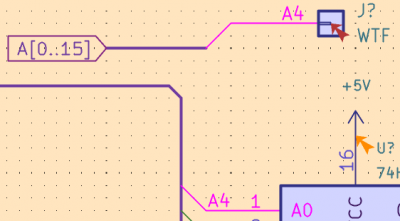

I think you shouldn't use global labels (e.g. A15) that are subsets of the bus, for sure, as the "A15" on the bus is not necessarily the same. I believe you should use the whole bus every time, with a consistent range of members, and break out the wire you need from it - or explicitly export wires like A15 on one of the sheets to a global A15 label, to make sure that in other sheets the global label A15 does refer to that wire.
But the main reason you're getting ERC errors, I think, is that you're using "bus-to-bus entries" to make 45-degree lines - they are not normal connections, so one side of them is not actually the same bus as the other! Either draw 45-degree lines by hand (tedious) or just don't draw the 45-degree lines at all. If in doubt, I think Alt-4 will highlight everything connected to a wire you hover over, so you can verify what is or is not connected.
I can't confirm the above however as Kicad 7 no longer seems to have the bus-to-bus entries, only wire-to-bus entries. I'm not even sure what the bus-to-bus ones actually were meant to do.
Oh hey! Thanks for the tip. It's not Alt-4 on Mac, but now that I know that feature exists, it was easy to discover how to activate it. This is a great tool! It works across sheets, so that if I highlight the address bus on the main sheet, everything on the other sheets that connect to the address bus also light up!
Unfortunately it doesn't seem to clear up what's happening. All those "unconnected" labels appear to in fact be connected! :?:
Screen Shot 2023-07-13 at 2.53.06 PM.png (11.86 KiB) Viewed 1666 times
"A pin with a 'no connection' flag is connected."
Screen Shot 2023-07-13 at 2.59.37 PM.png (10.25 KiB) Viewed 1666 times
"Label not connected to anything."

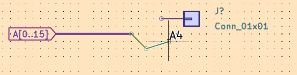

I'm not sure what that means, "bus-to-bus entries?" I made the bus with the blue drawing tool that looks like a forward slash. I defined its net using the "global label" tool that looks like an A inside of a chevron. To connect individual pins to the bus I used the right click menu "unfold from bus" tool that I saw in the "bus" tutorial:
That creates the local label "A4," a bus entry wire, and changes the tool into the green "wire drawing" tool so you can connect to the pin:
And, in fact, this seems to work! This demo connection makes the error about A4 go away!
Screen Shot 2023-07-13 at 3.08.01 PM.png (11.54 KiB) Viewed 1666 times

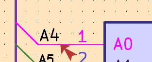

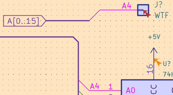

This is frustrating! I feel like I must be missing something, but maybe it's just a weird bug? I think it must be. This works:
And A4 is highlighted on the other sheets too, like you would expect. But if I delete the demo bus:
Screen Shot 2023-07-13 at 3.29.37 PM.png (11.17 KiB) Viewed 1666 times
it says the label is unconnected but it still highlights A4 on the other sheets.
I guess I have spent enough time on this; I'll just delete those address buses and use individual global labels for the `688 and `138. Thanks for helping investigate; at least I learned how the highlight tool works, which is quite useful!

I have found that Kicad gets sulky if you wire the bus connectors the wrong way around...
1) draw and label the bus e.g. [A0..15]
2) place your part to attach to it
3) label each pin to be attached (I usually do a short stub, but I'm not sure it's absolutely required). These should match the bus e.g. A0, A1 etc
4) select the bus connector tool and rotate the 45 joining wire until the control end - the end it rotates around - meets the just labelled stud and the other end meets the bus. This requires the bus to be in the right place relative to the stub - 0.2" away by default.
I speculate that if you do it this way around, the stub acquires the bus label and therefore attaches to the bus correctly; the other way around it's trying to acquire the complete bus name, or just doesn't know what to connect to... I don't know for certain but I haven't had any unconnected issues since I discovered this by trial and error.
Curiously once you have a spray of connections to the bus you can copy and paste them elsewhere and they remember their names.

I'm on my phone so it's hard to type, but what I'm referring to is the 45degree blue corners you have in some places. These are possibly a special type of bus-to-bus join, and may be causing the issue. I'd delete them and just join the blue bus lines together directly.
Note that all identically-named labels on any single sheet are connected, whatever their type. So buses do pretty much nothing within a single sheet as both endpoints already need to have the same net label (e.g. A4)! They are mostly just decorative. The only case they do something significant is when you export them between sheets either using global labels or hierarchical labels for the whole bus (as you have done). But this is why any case where you use the same bus member twice within one sheet is not triggering the error - because it is connected to at least one other thing through the label alone. But not all the things you wanted!
Kicad's legacy handling of buses is quite poor - just a thin veneer over labels. It is more "first class" in version 7.
Edit, oh one other thing - make sure you press the dialog button to rerun the ERC after opening the ERC dialog, or it will just repeat the errors from last time! I've been confused by missing this step before.
