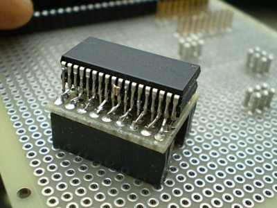

PostPosted: Sun Jul 09, 2023 4:29 pm
banedon wrote:
I've not seen a 36 pin SOJ socket available for sale. I know there are 28 pin and 40 pin ones, but I just cannot find 36 pin ones. Might be that my google-foo is failing me.
Urk! After an admittedly brief search, I'm not even able to find the 40-pin ones! But I know they exist 'cause I have a couple in my junkbox. If you've found a supplier for these please share the link.
What I could possibly do is fit a 40 pin one, but I don't want to and it feels a bit janky.
Other than that, it's DIP adapter time.
Neither of these solutions is especially elegant, perhaps, but they're both tolerably workable.
If you decide to use an adapter, let me suggest you design it without any consideration for what the old DIP pinout dictates. Yes the DIP pinout would be slightly advantageous layout-wise if you planned for the RAM and the (DIP) ROM to directly share the majority of their connections. But you want the high-speed "core" to be as compact and lightly loaded as possible, so there's an argument for excluding the ROM from it (ie, the ROM and RAM would not directly share the majority of their connections).
From an unrelated project, this (below) is an example of an adapter designed without any consideration for what the old DIP pinout dictates. Notice there are two rows of pins on each side of the IC.
Implemented as a PCB, this sort of design wouldn't be the least bit janky, IMO. That's if you treat the extra, piggybacked IC as optional. But you have to admit it's nice being able to fit an entire megabyte into a total footprint of about one square inch! :mrgreen: (And there's space underneath the adapter, for even more RAM (or anything else). For this unit I chose to use female connectors on the adapter and male on the mobo, but of course you can reverse that if you like.
Whether you use some sort of adapter or simply an oversize SOJ socket, you'll be able to remove RAM if desired. But is that consideration really worth the trouble? It's your call, but myself I'd be inclined to simply solder the SOJ directly to the mobo.

I didn't see any 40 pin SOJ adapters for sale - just saw them beign referred to and also some images. If I do find any, I'll send you the link(s).
I think I'll have a go at redoing the DIP adapter. 4 layers and maybe look at sticking them on a very low profile card such as the ones Garth has previously referred to.
