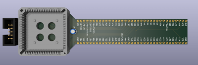

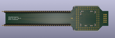

Hi all,
I recently wanted to use Atmel's line of CPLDs, namely the ATF1504 and ATF1508 in PLCC 44 and 84 respectively. In order to experiment with those chips on a breadboard, a small adapter PCB is needed. I'm sure it has been done already, but it was a fun little project!
My goal was to use a slim "stick" format, with the CPLD hanging off to the side. This allows easy access to the pins of the device by keeping accessible two rows of holes on each side of the breadboard. In order to keep costs low because this is just an experiment, I went for a 2-layer design, assuming a breadboard will have poor signal integrity and grounding anyway. Additionally, I took care to group pins from each logic block, so it is easy to hook up related signals in an efficient way. I also added an option for local decoupling with SMD caps on the back.
Fanning out the PLCC-84 this way was a *significant* challenge, so I'm quite happy to have made it (It goes from 25€ to 5€ with two layers!).
I hope this is interesting to someone! Source is available on my GitHub, and gerbers are attached below for posterity.
https://github.com/adrienkohlbecker/atf ... 4_breakout
Note: At the moment I have not actually built these, they are still on order. I will report back if I find any issues!

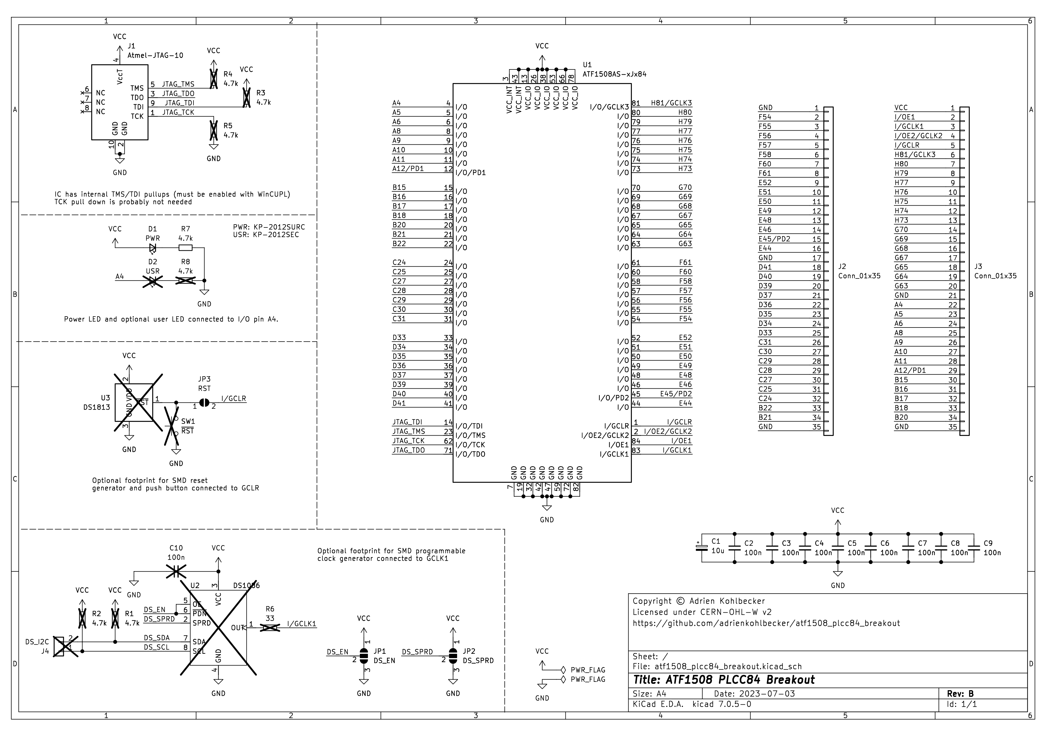

Last minute update to the design before finalizing my order: I added a spot for an optional clock oscillator connected to the first global clock input (GCLK1, 7.5x5.0mm SMD), to help generate high frequency signals such as video pixel clocks. And a spot for a bulk decoupling electrolytic.

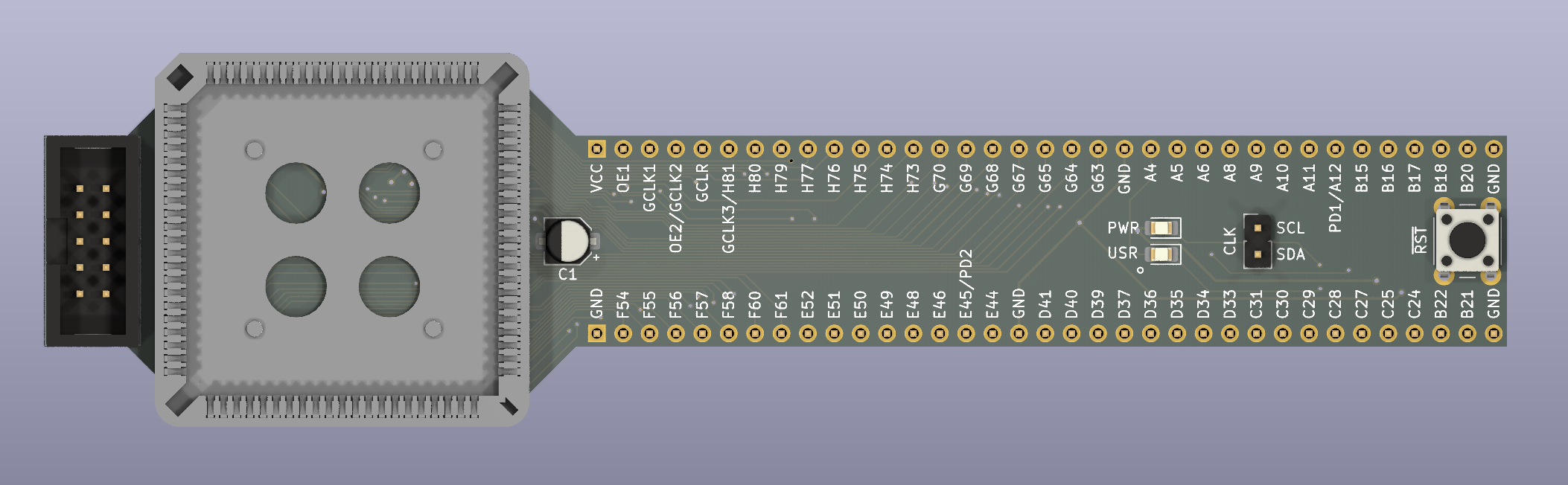

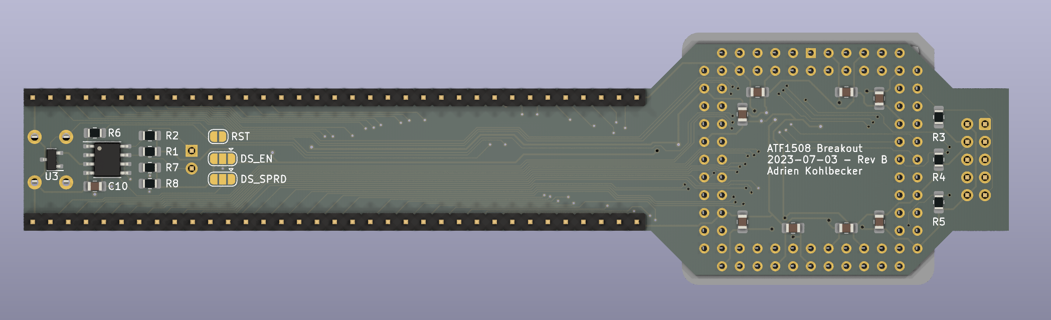

Boards are still in shipping. I've been looking at oscillators for the projects I intend to build on this, and I'm disappointed by availability and price, so I kind of regret adding that last minute footprint.
Consequently, I'm working on a second revision of the 1508 board, with a bunch of new features:
- Footprint for a DS1086 programmable clock generator to use clocks from 260kHz to 133MHz. I tested this IC recently and I've been really impressed by it. It is super flexible and with a price comparable to some of the can oscillators you have to buy. This should give the power to work on any type of synchronous design.
- Footprint for a DS1813 to provide a de-bounced push button input and power-on reset, connected to GCLR.
- Power LED, as well as a User LED connected to pin A4.
- Optional pull-up/down resistors on the JTAG lines (in case the built-in ones are not enabled for some reason).
Here is a preview, I'll post the production files once I've tested revA. As you can see, the board in this form factor is super dense
Feedback welcome!
Feedback welcome!

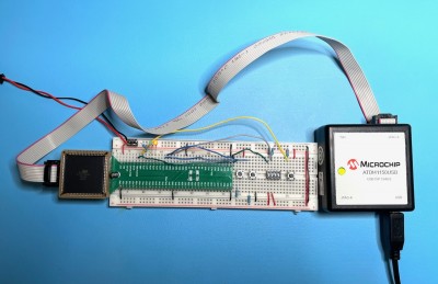

Boards are assembled and looking good
I had quite a bit of fun soldering the FTDI breakout, as it was my first 0805 components.
I'll test them soon and report back.

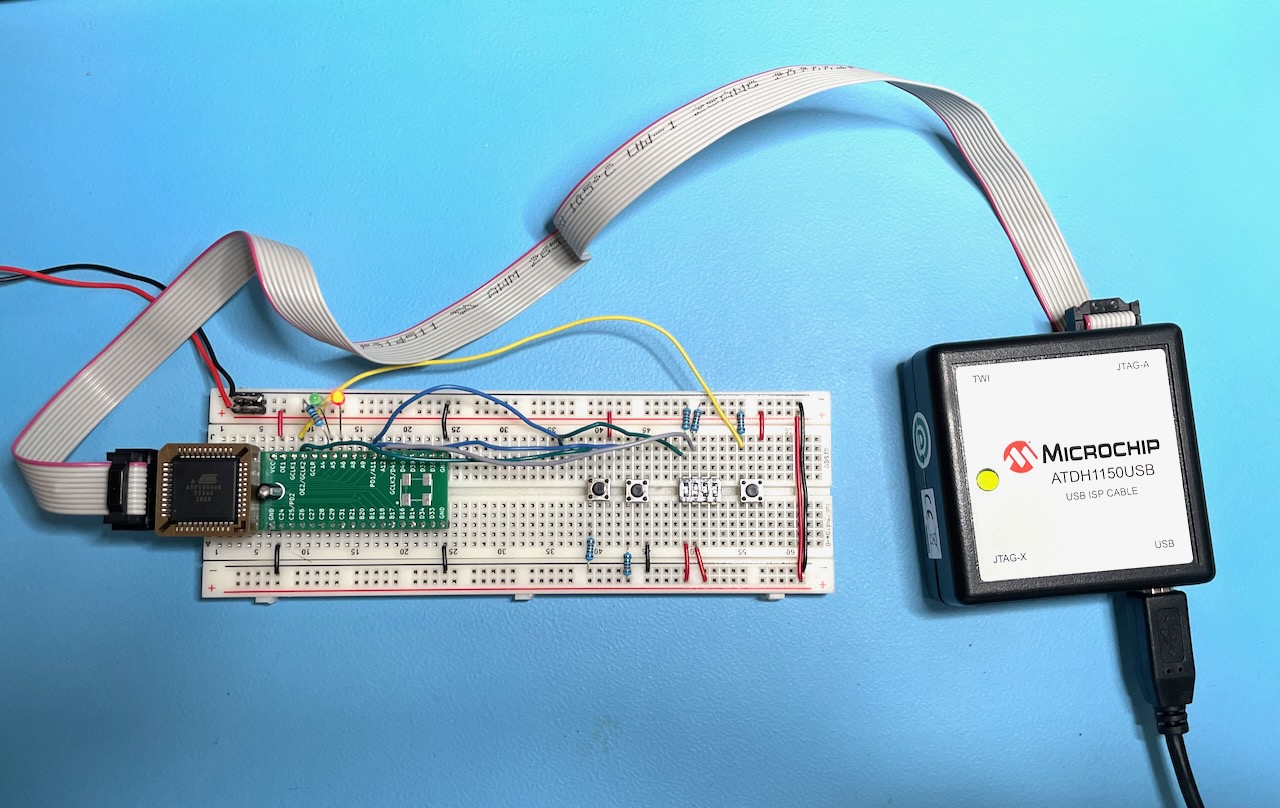

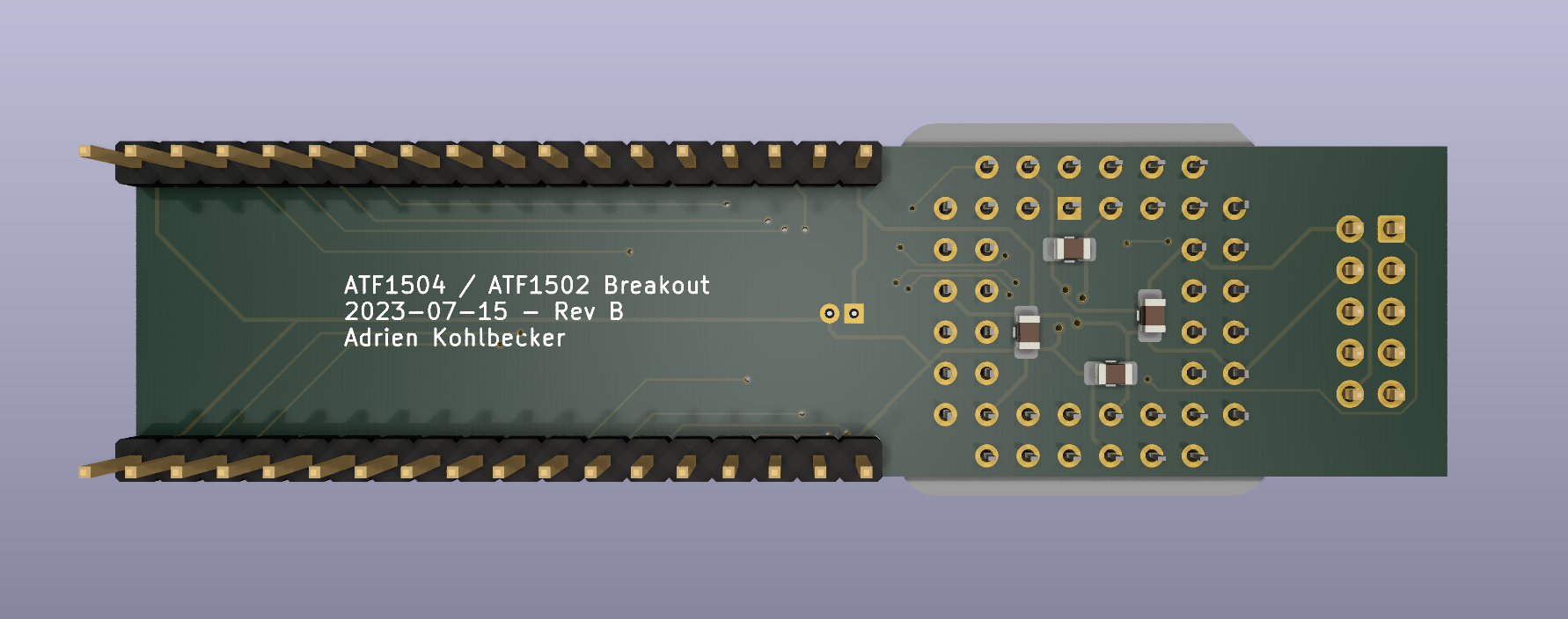

I'm happy to report that both breakout boards seem to work perfectly!
As a test, I implemented the logic from my other recent post on RDY single stepping (viewtopic.php?f=4&t=7641). Here is my source code for that:
I then programmed both an ATF1504 and an ATF1508, using ATMISP and the official ATDH1150USB, and built a testing setup using push buttons, DIP switches and LEDs. The CPLDs were happily programmed and the logic seem to work as it should.
As for a second revision of the boards, that project has kind of turned into a full-featured development board PCB including 12V programming, programmable clock, reset signal, etc. I plan on keeping the breakout board design shown here for quick and dirty projects, as the new version will include a lot of more advanced circuitry which is not always needed. More details to come in another post.

I've made a minor revision B which adds pin number legends for the global inputs, as it makes reading the fitter output easier. I also had to re-order them to make the new silkscreen fit. Top post updated with new gerbers!
