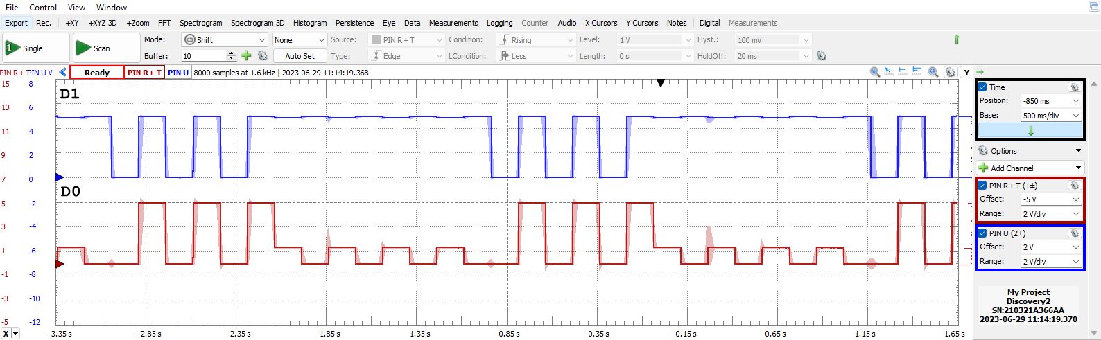

Tracing with a scope:
I have a Digilent Analog Discovery 2 and used its scope to look at the address and data lines. The address lines look sharp and well defined, but several of the data lines are peculiar. This trace is of the D0 (blue) and D1 (red) data lines running at the slow (~2hz) speed with the test firmware.

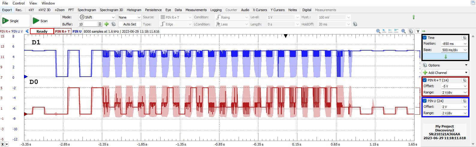

Continuing with the test firmware and slow clock, the D0 and D1 lines have occasionally shown some severe distortion.

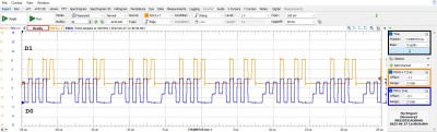

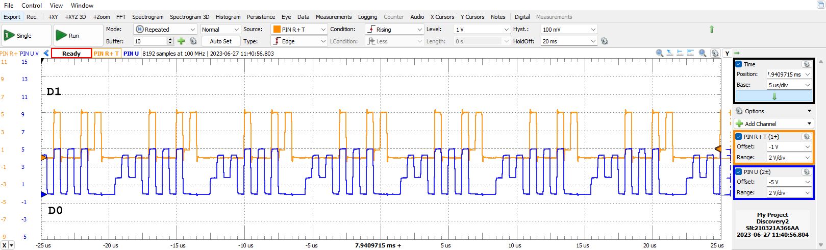

Reinstalling the original firmware, RAM and 6551 and 1mhz clock, the data lines look more peculiar. D7 is blue and D6 is orange. Haven't seen the wild distortion, though.

A clear, monochrome schematic would be *VERY* helpful. Scope traces alone aren’t all that useful without knowing how the circuit was designed.
As the others noted, you may have an address bus wiring error. However, the mess seen on D0 and D1 suggests there may other issues, possibly timing-related.

Mid-level signals on data or address lines are almost always indicative of shorts between active lines. If they're shorted to a rail then they'll stick either high or low (or very close to it, depending how the short is implemented) but what you've got is multiple cases of things - possible more than two - trying to drive in opposite directions.
If your wiring is correct then it's likely you've got an issue in your memory addressing and you're making two or more chips active at the same time.

Thanks to everyone who's helped with this problem so far! The board is now correctly running the test program on the slow clock with all chips in place and has been running for about an hour. I'll try the more complex firmware tomorrow.
I'm thinking that the extremely noisy signals in my third scope trace were caused by the slow clock, which is on a breadboard. I found that I could make the clock go nuts by putting my finger on one of the clock ICs. When the clock went super noisy, so did the signals on the SBC. Possibly the floating ABT was picking up on all that noise and going wacky as well?
