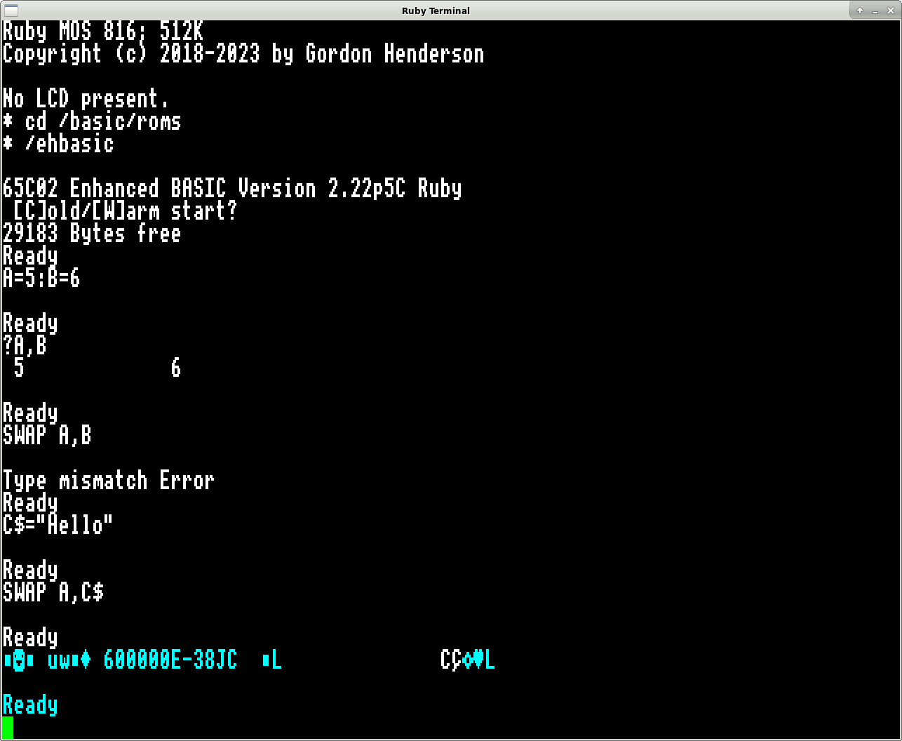

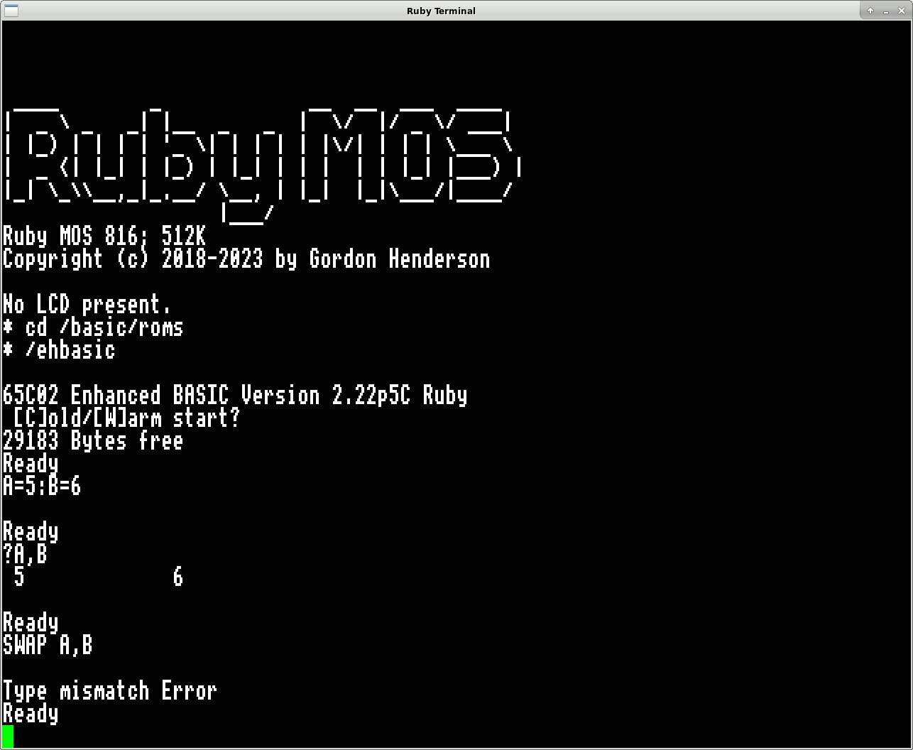

Hm... Not a great fan of diving into ehBasic, but I've had a quick look..
The test is for a string type vs. numeric type. String type is $FF, numeric is $00.
So number EOR number: $00 eor $00 -> 0 (positive)
String EOR string: $FF eor $FF -> 0 (positive)
Number EOR String: $00 EOR $FF -> $FF (negative)
I actually think the branch ought to be (or was intended to be) BMI rather than BPL, but BNE here works too. (So a logic swap waaaaaaay back)
It also makes me think that no-one has ever used the SWAP command...
Swapping a number & string is ... interesting:
I patched my version (the Floobydust 2.22p5C version) with BMI and it works as it ought to.
