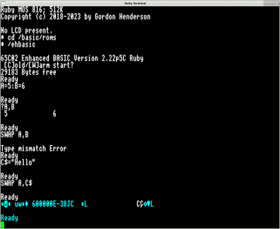

I think I found and fixed a bug, but before declaring it done, I'd just like for all you beautiful people to just look it over and see if I've missed any subtleties.
; perform SWAP
LAB_SWAP
      JSR   LAB_GVAR          ; get var1 address
      STA   Lvarpl            ; save var1 address low byte
      STY   Lvarph            ; save var1 address high byte
      LDA   Dtypef            ; get data type flag, $FF=string, $00=numeric
      PHA                     ; save data type flag
      JSR   LAB_1C01          ; scan for "," , else do syntax error then warm start
      JSR   LAB_GVAR          ; get var2 address (pointer in Cvaral/h)
      PLA                     ; pull var1 data type flag
      EOR   Dtypef            ; compare with var2 data type
; BUGFIX:  SWAP would only swap a string with a number otherwise it would generate an error!
      ; BPL   SwapErr           ; exit if not both the same type
      BNE   SwapErr           ; exit if not both the same type
; End of bugfix.

Hm... Not a great fan of diving into ehBasic, but I've had a quick look..
The test is for a string type vs. numeric type. String type is $FF, numeric is $00.
So number EOR number: $00 eor $00 -> 0 (positive)
String EOR string: $FF eor $FF -> 0 (positive)
Number EOR String: $00 EOR $FF -> $FF (negative)
I actually think the branch ought to be (or was intended to be) BMI rather than BPL, but BNE here works too. (So a logic swap waaaaaaay back)
It also makes me think that no-one has ever used the SWAP command...
Swapping a number & string is ... interesting:
I patched my version (the Floobydust 2.22p5C version) with BMI and it works as it ought to.
