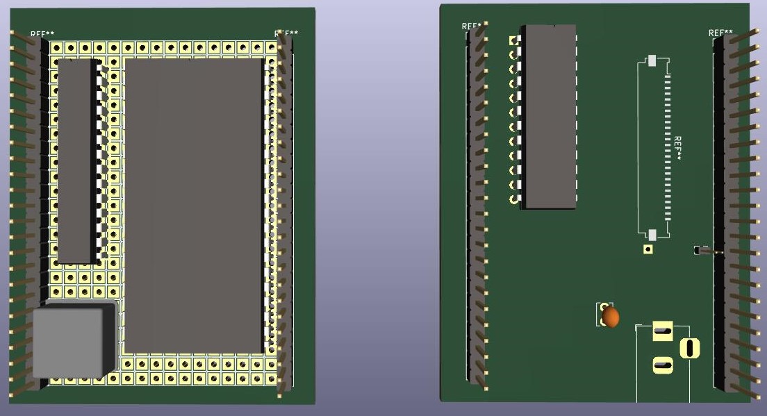

you can get the Q71 in 48 pins or less, its very compact, however it is more the physical size and the cross connections for the busses, this gets very complex very quickly and again, introduces a secondary architecture to the system. Physical Size and Intentional Design constraints limit the build in many ways. A PCB with pre-soldered components and sockets would support what is likely an order of magnitude more components and chips to the device overall. I am also looking at the 65134 just for kicks, it might work...
so normally I think Id put these going the other way, this shows the layout more clearly than the plain side:
Here are several photos of possible options.
File comment: there are a couple of ways to get the pins on the perfboard, these line up to breadboard okay
the long or vertical orientation gives more than enough for 16 address, 8 data, CS and other bits, its 48 pins total, and will support a 40 pin DIP long ways
File comment: its kinda funny, the basic pin header rows i got break so two of them make a full circle around these 5x7cm perfboards
File comment: so the fat DIP isnt quite 40pins like the 6502, either way, these boards can run two rows of up to 24, and there is a little room for support chips, Im thinking 6502+RAM on one, and "everything else" on the other, with the two rows of pins basically the address and data 'sides' of the system, though it will map to the physical IC
File comment: I am going to put 'connections' on the inside of the two boards and components on the outside, there will be a paper card in between them or other insulator, this creates a two layer board (actually like 4 layers almost) out of two perfboards and pin headers, which make a basic buss system for an altoids can PC
File comment: so here on the left side you have a 6502 and a clock can a 28 pin dip (might be too thin?) for the RAM.
On the right side you have the outline for the display thin film connector socket (not sure on this yet, it varies, about that big)
you have a 28 pin ROM, a power connector, and room for a noise diode and maybe a buzzer or audio out, probably a 16 pin dip audio IC if careful, I'll see

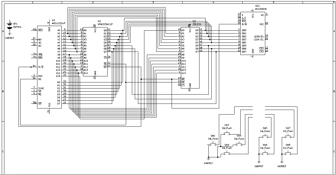

so there is still a lot missing and I want to go over several designs again, this is however as good a start as any and I am fairly certain this problem I face now is one to solve early.
in this schematic you have right to left:
6502 = RAM = ROM = Generic Display Controller.
I do not have adequate buss control, or clock signals yet I am sure. I am not 100% on ram, rom, or other devices yet, each thing in its own time...
In the bottom right, is 8 buttons, that map to a 'controller' on the front. how do I make that an address in RAM?
I think I need a tri-state buffer/driver, one that is a latch?
a 74xx573 or do I want a 74xx259?
what I am after is when a button is pressed, it latches to an input. polled by the CPU every so often and clears the buffer. this should be the easiest, can be tied to the main loop and screen updates easily and needs the least debounce hardware. I do not want to generate an interrupt and debounce 8 switches, I want to poll the controller like 30 times a second or so. maybe 16 or20.
so, if I have an 8-bit latch tied to a set of 8 buttons, how do i make that byte... $FFF1-FFF2 or whatever that is available to the CPU to read?

ok now i need to ask what is happening with the address bus on your ROM in that schematic. specifically A0 on the ROM is connected to the CPU's A15. and the CPU's A0 is not connected at all.
i assume that's a small mistake, because that would causes the CPU to access the ROM out of order.
for example if the CPU reads from Address $FF00, then $FF01, then $FF02, it would map to address $7F01 twice, and then to $7F03.
so yea, you'd want the ROM's Address lines to directly match the CPU's. A0->A0, A1->A1, etc. same with the data lines.
On a side note, with RAM it doesn't matter how you order the address or data lines when connecting to the CPU, it will still work perfectly fine. so for those you can map the lines however it fits best with your routing.
This is roughly the way keyboard scanning works on many '70s and '80s 8-bit microcomputers, such as the Commodore 64. Note that for good keyboard response you generally need to be doing this fairly frequently, which is usually done with a timer interrupt (60 Hz or 50 Hz on most systems including the C64), but if your main loop is such that you are scanning it nearly that often anyway, that should be fine.
It will probably easier not to have the buttons latch when they are pressed but instead just let their state be their state, whatever it is when you scan them. (That also saves you the trouble of releasing the latch.) None of the systems I've examined do any debouncing at all, so it seems that as long as you're scanning the buttons frequently enough, but not too frequently, everything there is fine. You don't even need to deal with anything related to key rollover if you're just doing a small set of buttons that are individually pressed at relatively long intervals compared to typing. (Some of the 8-bit systems, such as the 6800-based Hitachi Basic Master series, do not support key rollover anyway, essentially not scanning for any new keys until all old keys are lifted IIRC, which is annoying to fast typists like me but still usable I suppose.)
If you want to study some hardware and code that uses this technique, I've done a fair amount of reverse-engineering on the Commodore 16 Keyboard Hardware/Firmware, which uses a 6529 Single Port Interface (essentially, a stripped-down, one port version of a 6520 PIA) to set which row to scan and a latch in the TED chip to read the columns from that row. Your system would be simpler, of course, needing just the latch. Their firmware code is relatively long and complex as it does mapping of key codes to PETSCII, maintains a buffer of recently typed characters and so on; you might find extracting the scanning code from my slightly simpler stand-alone program ted-keymatrix.a65 easier. (That program shows the keyboard matrix on the screen and indicates when keys are being pressed, and uses a slightly different scanning algorithm.)
And there's the rub: now you're into dealing with address decoding. I mentioned this earlier, but I suspect you didn't fully understand it, or at least its implications. In your current schematic I note that the chip selects for your RAM, ROM and display are all unconnected; you need to have an address decoding system that deals with all of these, too, as well as your button interface.
I would start with Address Decoding from the Wilson Mines 6502 primer. Once you've digested that, I cannot strongly enough recommend examining and understanding the address decoding on some existing systems such as Grant's 7-chip 6502 computer, tebl's SBC, and a few others, perhaps including a commercial computer or two such as the Commodore PET. Note that you don't need to restrict yourself to 6502 systems here; Motorola 6800 and 6809 systems will be substantially similar, and 8080/Z80 systems differ only in having ROM in the low addresses and a second 256-byte address space often used for I/O devices.
I suspect the simplest system will be to reduce your ROM to 16K and have your display at $8000-$9FFF and buttons at $A000-$BFFF. (Or if you need more ROM and less RAM, reduce RAM to 16K and put your display at $4000-$5FFF and buttons at $6000-$7FFF.) Design this out to get a sense of how it works. If you want to get much more complex than that, you'll probably start to see why people like to use PLAs, CPLDs or microcontrollers emulating devices for this sort of thing.

Proxy wrote:
i mean a VIA would make connecting some buttons pretty easy :lol:
I am greatly tempted to add a VIA. more later.
but since you want to use discrete logic, you can do it like the NES. which only latches the controller inputs when the CPU wants to read them. though the NES controller used a shift register because it send the data over a serial line. in your case all buttons are directly on the PCB so you could get away without a latch and just use a simple tri-state buffer (and maybe some debouncing circuitry). the buffer would be enabled whenever the CPU reads from a specific address, which depends on how your logic is built.
Yes, in fact not going through the serial line that makes things slightly different, because of this certain chips just wont work, even though they have a reset/clear function and 8x tristate outputs...
Just using a simple Latch/Buffer is probably ok., yet it has its own challenges. I have a choice of several chips. the 74573 is pretty simple as a 'gate', its just a single pin and the 'data side' goes to the 6502.. I think this might be easy to wire up maybe...
Ultimately, yes, just like an NES controller, this device has only 8 input buttons, mapped to a specific address in RAM, one bit for each button, up.down.left.right.red.blue.yellow.green. I will discuss use of a VIA below.

Address Decoding: latches and buffers and gates oh my!
yes this is the part I am trying to sort out. The 6502 doesn't have any Chip Select lines.
I would start with Address Decoding from the Wilson Mines 6502 primer. Once you've digested that, I cannot strongly enough recommend examining and understanding the address decoding on some existing systems such as Grant's 7-chip 6502 computer, ...perhaps including a commercial computer or two ...
I did look several of these over and you almost see an idiomatic way of connecting things. The schematic below has more of this done correctly.
so I am going with 32K RAM from 0000-7FFF, 8K ROM to upper block E000 (for EEPROM, lolz) through FFFF, this will maintain all vectors. This leaves "8K" open to use for I/O and any screen mapping, about 8K. I could just about leave the controller inputs, at 0000 or whatever, as it will just 'be on the data lines' if I send I bit to it on the 74573, its just an 'enable pin', the other pin Id probably just wire static.

(Note: this is rather long and I was too tired to properly proofread it by the time I was done, so there may be errors or unclear things I didn't catch.)
Controller Mapping
wayfarer wrote:
cjs wrote:
wayfarer wrote:
what I am after is when a button is pressed, it latches to an input. polled by the CPU every so often and clears the buffer. ...
This is roughly the way keyboard scanning works on many '70s and '80s 8...
gotcha, I am not putting a full keyboard on here...This is to keep it simple and minimize complexity and hardware connections.
It doesn't matter; your buttons are exactly the same thing as one row of a keyboard: it's a keyboard with a single row. If you think of a keyboard as different from your buttons (beyond the row enables) it's worth studying more closely how keyboard scanning works until you see that it's just a one-row keyboard.
So the trouble here is 'missing' an input because of operator timing...
It's not an issue so long as you're scanning reasonably often, as you've seen when you used a keyboard on a TRS-80, PET, C64, MSX or many other old computers. If you scan 60 times per second you're guaranteed to see any key that's held down for at least 16.6 ms, which is faster than a human presses and releases a key. You'll note that the NES controller, too, uses a CD4021B shift register which does not latch when a button is pressed, but latches only when the NES main unit strobes the clock signal. So there, too, in theory, if a button is not held down for long enough it will be missed.
The '573 won't do what you seem to be saying you want (latch each individual button on a button press) anyway, since it has only one latch input. To latch on a button press you need an individual flip-flip or latch for each input, set up as a bistable multivibrator that can be reset by the CPU after it's triggered. You could build something like this, but it's a bunch of extra devices, extra wiring, extra work for the code running on the CPU, and just isn't necessary as we saw above.
(And note that the software will still have to track both down and up states; if you unlatch the input it will immediately latch again if the button is still held down, so doing a "scan; see latched; unlatched; scan; see latched" sequence does not mean the button has been pushed twice.)
There is a buffer and it actually looks simple and not too bad, its in the picture below, the 74'573. It just needs two control pins, more on that below. It would just 'expose the pins' when told to, so addressing on that just needs to turn everything off and let it be on the data buss...
Right. Basically, you have the address decoding assert /OE (bring it low) when the CPU wants to read it, and deassert /OE (bring it high) when the CPU is accessing anything else. You can just wire LE/Load high so that it's always showing on its outputs (when /OE is asserted) the current state of the buttons. (Note that bringing LE low will capture the current state of all the buttons at once; but you're doing that anyway at the moment you read from it with LE high, anyway.)
But one thing you're missing there is that you need a pull-up resistor on every input line of the '573. Closing a switch properly brings its input line to ground, but with the switch open the line will be floating, and so you'll get a random value.
Or you could simply use a PIA, which has internal pull-ups in the chip so you don't need another eight external resistors. :-) (Check the data sheet for the particular one you're using, though. I just noticed in that in the Ben Eater schematic you linked, he's got external pull-up resistors on his switches even though he's using Port A of the 6522. From a look at the data sheet, it appears that, unlike the Motorola 6820, the MOS 6522 does not have internal pullups.)
No, of course not. The whole point of address decoding circuitry is to generate the chip select signals. The CPU has no idea what it's accessing when it puts an address on the address bus; it's up to the address decoding circuitry to look at that address (and perhaps other state) and enable the correct device. (The same address might even cause different devices to be enabled at different times; this is how bank switching works.)
With 32K RAM and 8K ROM, you have 24K remaining for I/O. I'm not sure what you mean by "screen mapping"; the display you've chosen is just another I/O device. If you're thinking of having a frame buffer, where you have separate code that reads that area of memory and updates the screen to match it, that frame buffer would be in RAM. (It's sort of a "soft" frame buffer, really, since it would be code reading it rather the screen hardware reading the RAM directly as on an TRS-80/PET/Apple II/C64/etc.)
One plan you might consider, since you're good with 32K RAM and ROM and I/O sharing the other 32K, is to use A15 to determine whether you enable RAM or ROM+I/O, and then for the ROM+I/O section use a '138 decoding A14, A13 and A12 to eight blocks of 4K each. You can then use two or four of these to enable 8K or 16K of ROM, and each remaining block for one I/O device. (This is exactly how the RC6502 SBC is set up.) And this can be done entirely with the '138 and a '00 quad NAND gate, the latter supplying both the decoding and the clock qualification for the RAM.
[/quote]I could just about leave the controller inputs, at 0000 or whatever, as it will just 'be on the data lines' if I send I bit to it on the 74573, its just an 'enable pin', the other pin Id probably just wire static.[/quote]
Sure, but how do you "send the bit" (i.e., assert /OE) on the '573? You need to design circuitry that does that when it sees a specific address (or range of addresses) on the bus.
I've not done a detailed examination of the other schemes you linked, but they look reasonable. I'd suggest you go through all of those and study them until you know exactly how they work, and can say for any address what combination of outputs those circuits will generate. It's a bit tedious, perhaps, but doing that exercise is how you build an intuition for address decoding systems.
there seems to be an idiomatic way of doing things, I can probably get away with not using a VIA, though it has a LOT going for it.
Sure, but do you understand that whether or not you use a VIA (or PIA) is completely irrelevant to those decoding schemes? Whether you are enabling a VIA or enabling a '573, the address decoding is exactly the same.
A15 is CS RAM/Other
A14/A13/A12 is free if A15 is on.
A14 = ROM
A13 = Display
A12 = Buttons
You're still more than a bit confused here; you should go back to the schematic that you think is doing this and work out what it's really doing. Here are some of the mistakes you made:
  • A15 is ROM+I/O; /A15 ("not A15") is RAM.
  • By consequence of the above, A14,A13,A12 are not "free," but are used for decoding if A15 is high.
  • A14 is is not just ROM, it's ROM plus everything else in the upper 32K. A13 and A12 also determine whether you're enabling ROM, Display or Buttons. (You can't enable them all, just one!)
  • A13 selects ROM; /A13 is not just display but display+buttons. As with the above, when /A13 is asserted, you need to use A12 to determine which one of the two you're going to enable.
I am highly interested in adding a 6522, it complicates and simplifies things. It seems like any Address Pins lost to it are recovered with CA1/2 and CB1/2, plus the Ports, and the internal registers and functions. If I can run without it I will, though I wonder if I can use a 6522 without a 7400...
Again, you're confused. As I mentioned above, it doesn't matter if you use a 6522 or a '573, you still need an enable line for each, and they're both enabled in the exact same way. No, you can't use a 6522 without a 7400 (or some similar substitute), it won't save you any decoding logic (unless you use it to interface to multiple devices that you would otherwise attach directly to the data bus), and CA1/2, CB1/2 and the Ports have nothing to do with decoding.
and it seems RAM is tied to the clock a lot, this is for WRITE operations?
Yes. This is called "ϕ2 write qualification" and is discussed in detail in Garth's pages, as well as most 6502 hardware tutorials.
I think in the course of reading several dozens (a hundred or so I guess) datasheets in the last couple of months I had the 6502 and 6522 pinouts a little mixed up. For the life of me, I also thought you could use all the WDC extra pins like SO, SYNC MLB and BE to control I/O devices somehow... alas, not quite, though I think one makes DMA easier....
got it, 6522 needs CS1/CS2 and 4 Register select lines. Plus the general I/O lines, R/W and PHI2
so the display modules all have 8k onboard ram, its just only available at the one address/port so its not really useful, you can read from it, though it seems like most read operations from the display take a bunch of cycles, require odd timing hurdles and are mostly good for checking device status. dual port RAM would be really nice for video out, not this build though. Im more likely to use 4k (a 'page') of tiles and sprites or characters than actual mirrored RAM. 8x8 blocks or so. that might need some 'Row/Column' transformations for display writes.I'll see when I get there.
I am not sure I need the '138 here, Im pretty sure I can just use a 7400...
Sure, but how do you "send the bit" (i.e., assert /OE) on the '573? You need to design circuitry that does that when it sees a specific address (or range of addresses) on the bus.[/quote]so I think at this point its going to be at E000 or a similar 'top of block' address that can be extracted from the A15-A12 lines going through the 7400. B000. C000, D000 E000.. one of those that has no conflicts and is obvious to use out of the 7400 once the other 3 devices are sorted out. Which ever address turns the others off and sends a bit to the OE on the 74573 is where it will go for now.
yeah they all look basically the same, and use a 7400 to encode the upper 4 data lines as chip selects etc. its all 'idiomatic' at this point.
A15 is CS RAM/Other
A14 = ROM
A13 = Display
A12 = Buttons
we are totally saying the same things from different directions, you are saying 'these use' I am saying 'when not using this, it frees these up'. totally get you.
I had meant to use the CA/B1/2 as control lines. doesn't quite work though. If I could put ROM behind the 6522, and still boot, I would do so. I never need to be reading ROM and the controller at the same time in the same operation. They could share a port, and then Id use the Cx1/2 handshake bits to control which one was read from. I do not think I can get the 6522 to pass through the ROM on bootup though, and I dont want RAM behind the 6522. For this build it offers only a few advantages to include at all, and will probably not be on the Mark-1. the timer, DAC for audio, etc,. that portA or B could take the place of the 74573, stick the display on the other port... with just two devices plus RAM and ROM, it doesnt quite do enough to wire in. and it makes things just a tiny bit more complicated here.. I think Id rather have a headphone jack and amplifier and a noise diode, maybe a simple buzzer... idk. tough call. USB is cool too.

Well, no, not exactly: you've mixed together the "computer" side and the "external" side of the 6522 there. On the computer (system bus) side you need the chip selects, the four register selects, R/W and ϕ2. All the other stuff is connected to external devices, where the 6522 mediates between your system bus/CPU and those devices.
so the display modules all have 8k onboard ram, its just only available at the one address/port so its not really useful, you can read from it....
Ok, so that's not part of your system RAM at all, then. That's basically sending commands over the I/O ports to the display system to tell it to read or modify its internal RAM, which is not directly accessible to you.
Think of it like the memory of another computer that you're accessing over a network.
Well, the gates on a single '00 may not be enough to decode enough different chunks of memory for your ROM and all your I/O devices. But sure, you can use any arrangement you like, so long as you get enough different I/O selects happening. I suggest the '138 in part because a '00 + '138 combination for 32K RAM and ROM+I/O selected by A15 is one of the simplest address decoding systems to understand. (Compare the RC6502 SBC I referenced earlier with other address decoding schemes, and then pick whatever works for you.)
I'm not sure you do. For example, you said "A14 = ROM," but when using the ROM and not using the display, A13 is not "freed up"; A13 is essential to indicate that it's the ROM, and not the display, that you're accessing. Perhaps this picture will help:
│      │  A14         │   16K ROM           │
│  A15 │       │  A13 │    8K I/O device 2  │
│      │ /A14  ├──────┼─────────────────────┤
│      │       │ /A13 │    8K I/O device 1  │
│ /A15                │   32K RAM           │
Note that A15 distinguishes between RAM and ROM, but A14 is not enough to distinguish between ROM and the other things in the A15 area; you also still need the A15 to the left of it. And A13 distinguishes between I/O devices 1 and 2 only when A14 is low, and A15 is high.
It's not like, "one address line selects one thing"; it's a cascading tree of, "one address line selects the next group of stuff, with further selection done by the address lines below it." (This is part of why the '138 makes things simpler; it handles three address lines – eight blocks because 2³=8 – worth of decoding.)
If I could put ROM behind the 6522....
This betrays an essential confusion: you cannot put any memory from which you run a program behind a PIA or similar.
In fact, you not only need never read any two devices at the same time in the same operation, but you cannot do this.
Not if you're reading your program code from that ROM.
I do not think I can get the 6522 to pass through the ROM on bootup though....
Well, there are some tricks about doing this kind if thing, such as Plasmo's brilliant Prog65, but seriously, don't even look at that until you understand and get comfortable with basic address decoding, including getting your current project built and working.

wayferer, let's see if this helps any.  Here's another way of looking at it, assuming you still want 8K of ROM and 16K of RAM (although there's an awful lot to review in the posts above, and I'm not sure I have the latest wish list in mind):
        A15 │ A14 │ A13 │    A12...A0     │ used for:
         1  │  1  │  1  │ --used by ROM-- │ 8K ROM
         1  │  1  │  0  │  VIAs will      │ I/O devices
            │     │     │  typically      │
         1  │  0  │  1  │  use A3-A0      │ I/O devices
            │     │     │  for register   │
         1  │  0  │  0  │  selects.       │ I/O devices
         0  │  -------used by RAM-------  │ 32K RAM
For 8K of ROM, all three high bits must be 1's, and all the remaining 13 bits must be available to the ROM's address inputs.  For 32K RAM, although it is selected by having bit 15 low, the remaining address bits must all be available to the RAM's address inputs.  Here you'll have a 24K address space for I/O.  I think it'd be somewhat better to use the 2nd diagram at http://wilsonminesco.com/6502primer/addr_decoding.html (the address-decoding chapter of the 6502 primer), about 3/4 of the way down the page, which gives 16K of ROM, 32K of RAM, and more I/O devices than you'll ever need.  It uses a 74xx00 and 74xx04 (with gates left over for other things).
Every chip needs to be individually addressable for all of its addresses.  Duplicated address ranges, and addresses that select more than one thing at a time, are ok as long as you don't use those, and you leave a way to address each chip individually without enabling others, and a way to address each register of each I/O chip individually and each address of each memory chip individually.
