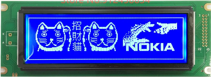

I recently got a really neat display based on T6963C. Its resolution is 240x64 and it supports both character & graphic modes. It also includes char generator ROM.
File comment: Image from product page on AliExpress
However, it doesn't support 4-bit addressing as HD44780 & friends do, so using VIA is off the table since it needs 8 data bits + /RD & /WR + EN + C/D (12 total, reset & font selection can be hardwired.)

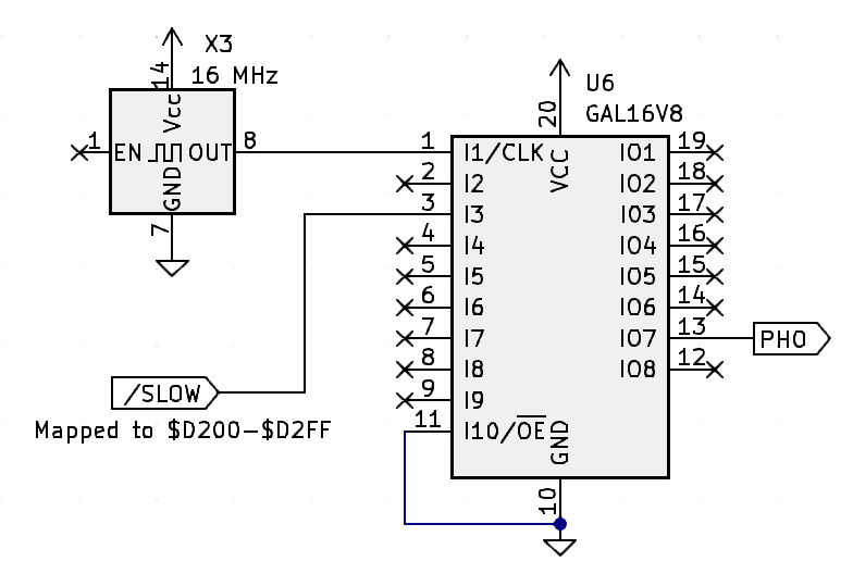

Schematic (I used GAL16V8 for presentation purpose since my Kicad doesn't have GAL20V8):
Actual test:
Surprisingly, this worked really well. Obviously, PHO will go to 6502 only: VIA will still use CLK/2 (probably divided through GAL as well in order to avoid clock skew between 6502 & VIA and ensure matching clock edges).

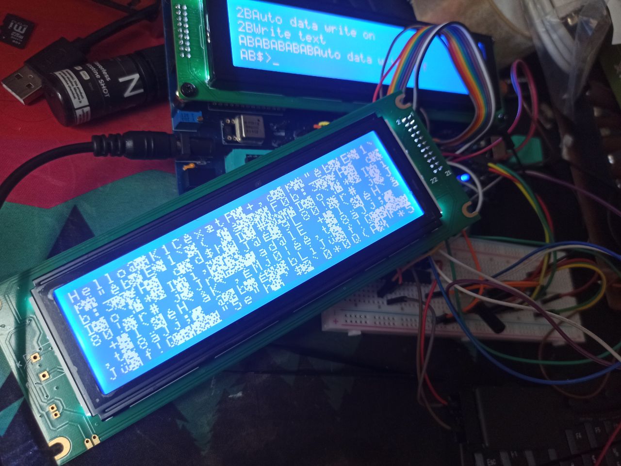

I did not think about this! Thanks for pointing that out. I might add a TTL-CMOS level converter in my next build for this. Would a Schmitt trigger be sufficient for this or is something more complex required?
Meanwhile, my 6502/6522/T6963C/GAL are doing really well together: I was able to load & run a program from uSD card (through VIA) which properly initialized my 24064 display (underclocked with GAL):
(Might be hard to notice "Hello" in the top-left corner since I forgot to clear screen VRAM beforehand.)
This display can draw up to 48 cols x 8 rows (with 5x8 font). Plenty of space for my needs, and those 4 extra rows are exactly what I was missing with my 4004 LCD.
/Andrew

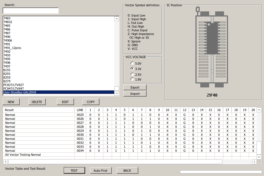

So Lattice's GAL20V8 worked with my SBC, however it was failing test vectors with my TL866-II unless I set test levels to 3.3V instead of 5V. :) Seems like TL866 probably latches asserted pins too fast, before the levels rise to CMOS level due to higher input capacitance (if I understand electronics, which I sometimes feel like I don't.)
I've decided to switch to ATF PLDs for several reasons:
- They are TTL/CMOS compatible;
- They are still made.

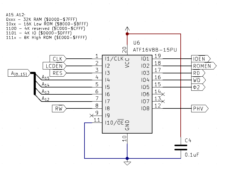

I've ordered a bunch from Mouser, 8 outputs feels enough for my purposes, including address decoding & R/W qualification:
GAL16V8
Addr
CLK  /SLOW /RST   A15   A14   A13   A12   RW    NC    GND
/OE   PHV   Q2    Q1    PHI2 /WD   /RD   /ROM  /IO    VCC
; Address decoder, bus underclocking, R/W qualifier
; If /SLOW is asserted, this works as 3-bit counter: [PHV (MSB), Q1, PHI2 (LSB)]
; Bus underclocking
PHI2.R = /RST  * /PHI2
Q1.R =   /RST  *  SLOW  * /Q1  *  PHI2
       + /RST  *  SLOW  *  Q1  * /PHI2
Q2.R =   /RST  *  SLOW  * /Q2  *  Q1 * PHI2
       + /RST  *  SLOW  *  Q2  * /Q1
       + /RST  *  SLOW  *  Q2  * /PHI2
PHV =
    ; Fast mode (PHV=Q0)
         /SLOW  *  PHI2
    ; Slow mode (PHV=Q2)
       +  SLOW  *  Q2
; PHI2 =     Q0
; R/W qualifier
WD =      PHV  * /RW
RD =      PHV  *  RW
; Address decoder
; RAM =    /A15
ROM =     A15  * /A14  +  A15  *  A14  *  A13
IO =      A15  *  A14  * /A13  *  A12
DESCRIPTION
PHV = CLK / 16 if /SLOW is asserted or CLK / 2 otherwise
PHI2 = CLK / 2
RAM/EN is not managed by GAL, since it's simply tied to RAM's A15 ($0000-$7FFF), and I still use '138 for 8x256B I/O segments.
I also found this nice utility that can convert to and from .lgc format and a more human-readable .toml - https://github.com/evolutional/xgpro-logic - and made some tests to make sure my PLD behaves as expected:

I'm running XGPro under wine with patched libusb, works great:

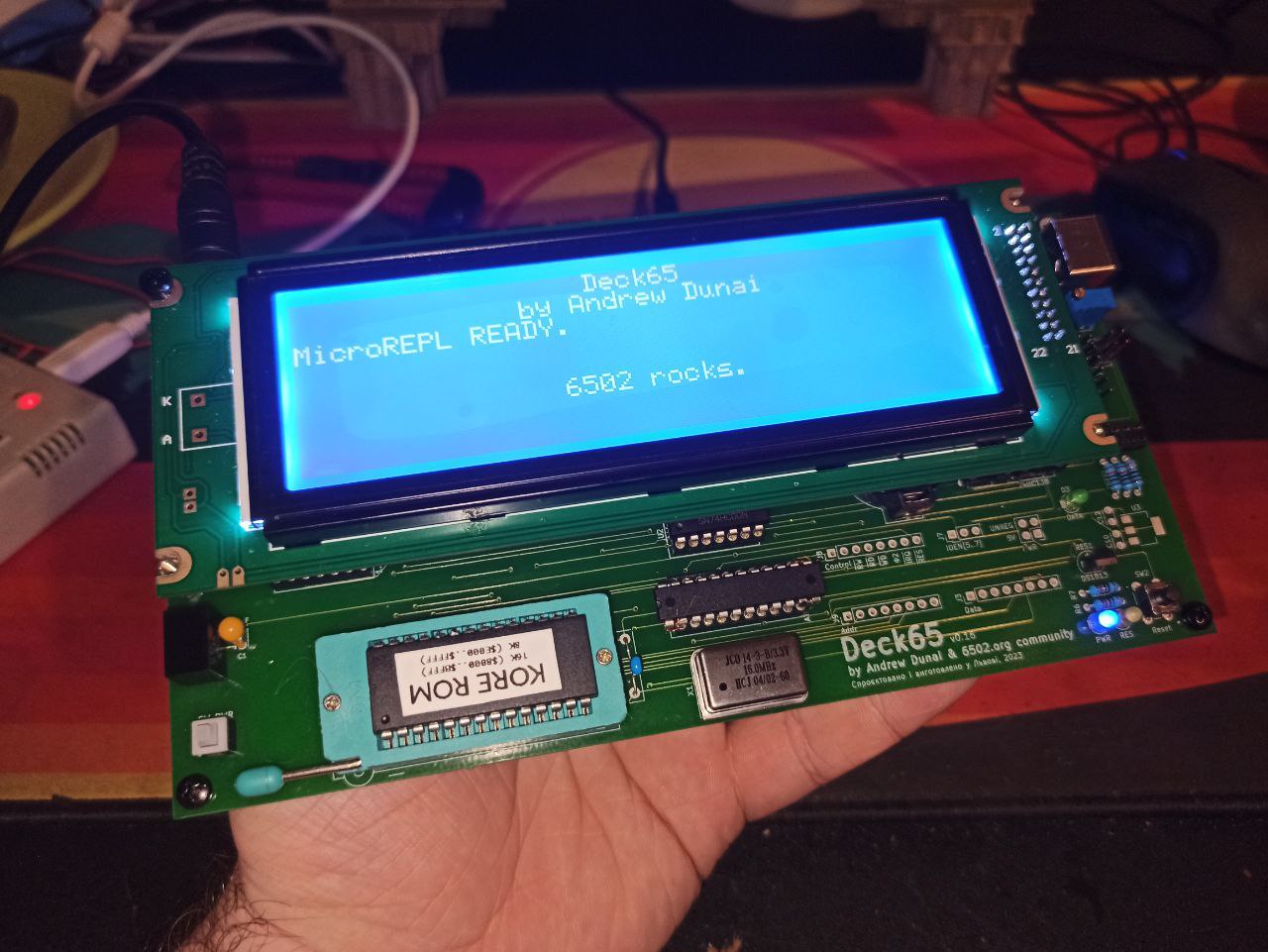

New board - GAL + 240x64 LCD (T6963C) are doing great! Using GAL20V8 until my ATF EEPLD arrives.
I'm running master clock @ 16 MHz, CPU is clocked between 8 MHz & 2 MHz based on LCD/EN.
Also, some new fancy stuff:
  • DS1307 (I2C RTC) with CR2032 battery
  • MCP9808 (temperature sensor, mounted under the 6502 (well, it's all CMOS nowadays and things aren't getting as hot as NMOS did, but I still wanted to be able to "get CPU temperature" in a fancy way).
  • Slot for ESP8266 (ESP01) to talk to it with 6551 - I want to write a simple telnet client to be able to connect to some C64 BBS that are still running. Gonna try out something like https://github.com/dhansel/WifiModem or write my own firmware - I worked a lot with ESP8266 and really love them.
Still left one '00 for reset LED and also just in case I'll need to reroute things. Life taught me it's always good to have at least several spare NAND gates on the board which is still WIP.
1K pot for LCD contrast is definitely too low and is getting warm, will replace it with 10K.
Last but not least, it took me 16 revisions to add the damn power switch. Friggin' finally!

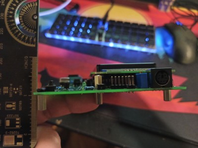

And the entire thing is lass than 1" thick (excluding standoff legs):
Perfect fit! (Well, I had to slightly bend metal legs that hold display's case & PCB together.) Clearance is ~0.4" (11 mm) - just enough to fit chips with machine-tooled sockets, as well as barrel jack.
I also renamed my SBC to Deck65 - the name might imply that there should be like a dozen of stacked things, but I'm a modest person and only have 2 layers!
/Andrew
/Andrew
