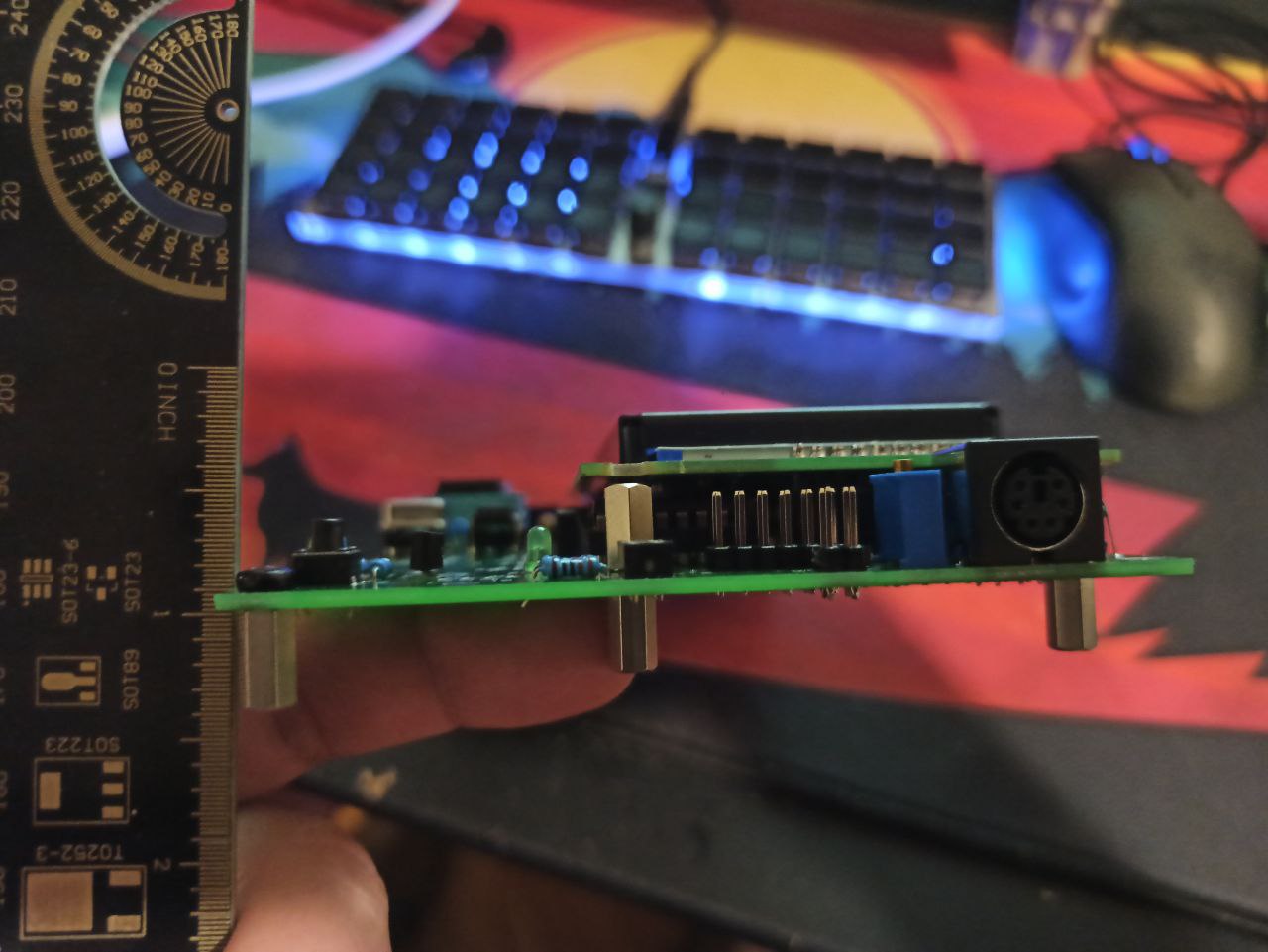

New board - GAL + 240x64 LCD (T6963C) are doing great! Using GAL20V8 until my ATF EEPLD arrives.
I'm running master clock @ 16 MHz, CPU is clocked between 8 MHz & 2 MHz based on LCD/EN.
Also, some new fancy stuff:
  • DS1307 (I2C RTC) with CR2032 battery
  • MCP9808 (temperature sensor, mounted under the 6502 (well, it's all CMOS nowadays and things aren't getting as hot as NMOS did, but I still wanted to be able to "get CPU temperature" in a fancy way).
  • Slot for ESP8266 (ESP01) to talk to it with 6551 - I want to write a simple telnet client to be able to connect to some C64 BBS that are still running. Gonna try out something like https://github.com/dhansel/WifiModem or write my own firmware - I worked a lot with ESP8266 and really love them.
Still left one '00 for reset LED and also just in case I'll need to reroute things. Life taught me it's always good to have at least several spare NAND gates on the board which is still WIP.
1K pot for LCD contrast is definitely too low and is getting warm, will replace it with 10K.
Last but not least, it took me 16 revisions to add the damn power switch. Friggin' finally!
And the entire thing is lass than 1" thick (excluding standoff legs):
Perfect fit! (Well, I had to slightly bend metal legs that hold display's case & PCB together.) Clearance is ~0.4" (11 mm) - just enough to fit chips with machine-tooled sockets, as well as barrel jack.
I also renamed my SBC to Deck65 - the name might imply that there should be like a dozen of stacked things, but I'm a modest person and only have 2 layers!
