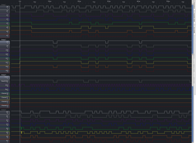

If you have a logic analyser with at least 10 inputs, even a cheap and cheerful one, then you can probably make use of hoglet's code which observes the databus and reads out what the CPU is doing on each cycle.
I certainly do, just got it last week. I have an OpenBench Logic Sniffer with 32 channels. Here's a test using it on my breadboarded test article.

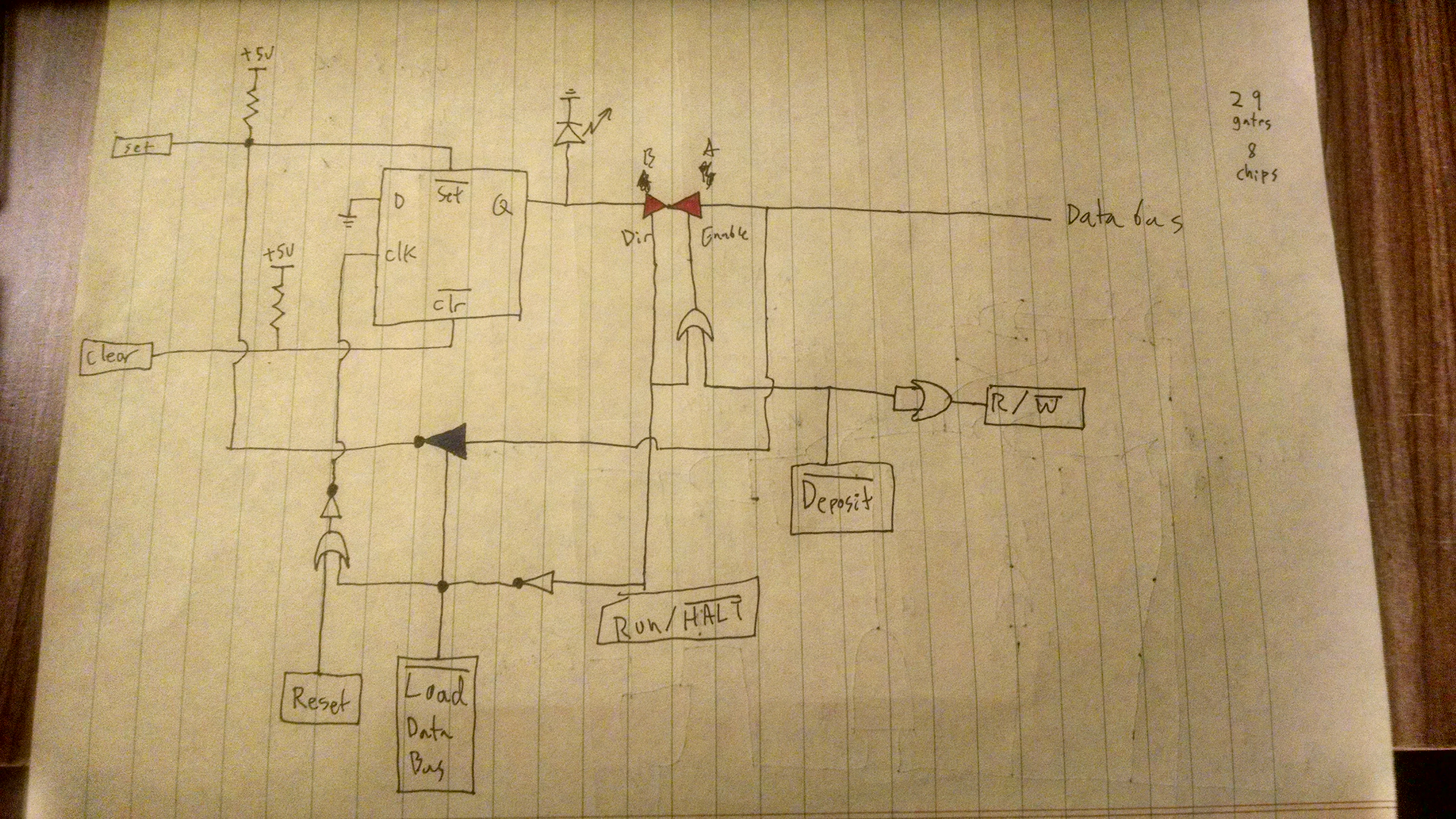

Onto the front panel control cards!
In theory, they should be self sufficient enough where if you had a device on the bus with an address, you could view the data on that device, with or without a 6502 sitting on the bus. In practice, I've fouled up something well enough that each card works fine on it's own on the test stand, then fails to work find in concert while connected to the bus, talking with other cards.
Data Control Rev 6
Data Control Rev 6
Data Control Card
Here we see the fundamental element of the data control card which is far more complicated than it needs to be. This has to be like revision 6 by now. There are effectively 8 of these, one per byte. Thus, there are 8 D-latches acting as RS flip-flops (7474's), and 8 of each tri-state buffer (3x 74244, 1x 74240). The inverters that control the buffers are not duplicated.
The idea is that we can load a value from the data bus into these D-latches. The load signal clears the flip-flop, and then lets any 1's populate their respective flop-flops. Say you made a mistake, and need to change a single bit, you use the set/clear momentary switches to make your changes. This will be visible on the LEDs, while not interfering with the data bus. When you are happy with the value, you can deposit it right back onto the data bus by twiddling the R/W line to make RAM overwrite the new value.
However, all of that is rendered dormant while the CPU is running. One buffer prevents this card from interfering with the data bus. while another buffer now allows the LEDs to directly view data bus activity. The flip-flops are cleared whenever the CPU is running.
Data Control Rev 8
Data Control Rev 8
I've managed to simplify the design a bit since this point for revision 8, but I'm holding off on building the improved version for the moment. Every time I think I've reduced the complexity on this card (while retaining the same functionality), someone consistently points out a new way for me to improve it (which I should note is more than welcome). Rev 8 doesn't reduce the chip count all that much, but it does reduce the total gates to 29, and eliminates quite a few wires, which makes me happy. I wish I had understood the 74245 sooner.

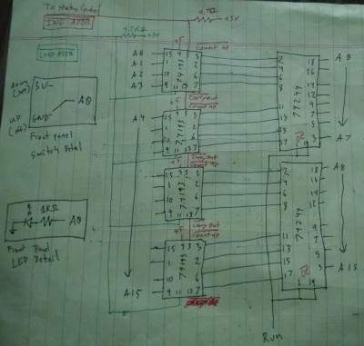

Address Control
Address Control
Address Control Card
This one is probably the most straight-forward card in the bunch. Want to hop to a specific address? Set the toggle switches, and load up that address. Then, you can increment from there to see what is in subsequent addresses. Again, this card has a run lockout to prevent interference when the CPU should be in control of the address bus. The LEDs here are always watching the address bus. Upon typing this, 8 months after assembling the card, I realize I should probably add buffers to prevent extending the address bus lines unnecessarily...

If a computer doesn't work, there are a myriad of things which might be wrong, so the point of experiment is to try to narrow down what needs fixing.
For a NOP test to work, you need a working CPU, a good power supply and clock, and the various CPU lines tied off in the right way. If you can observe the address bus closely you can rule out shorts, opens, or unwanted reorderings. To a small degree you've also shown the data bus is OK. If you do the NOP tie off a long way from the CPU, you might be showing something about your motherboard or backplane too. As there are various values which can serve as a NOP test you can take it a little further, showing the databus is working as intended.
After the NOP test you might put a tight loop into a ROM and try running that, to show that the ROM is correctly wired up, correctly accessed and correctly programmed.
Then you can run something with JSR and RTS and show that RAM is working.
