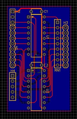

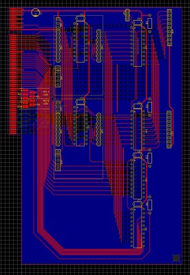

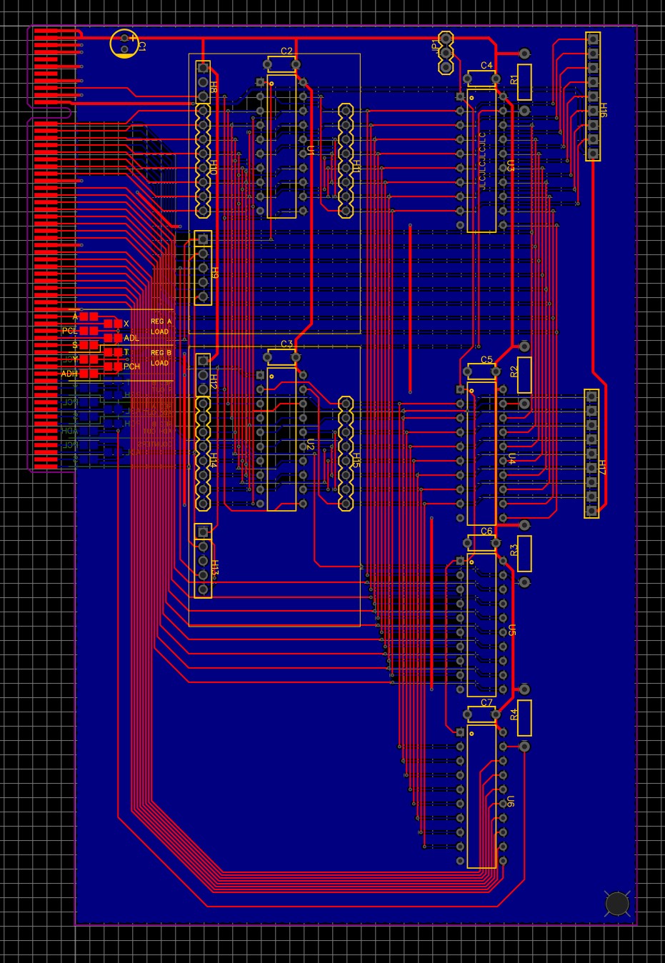

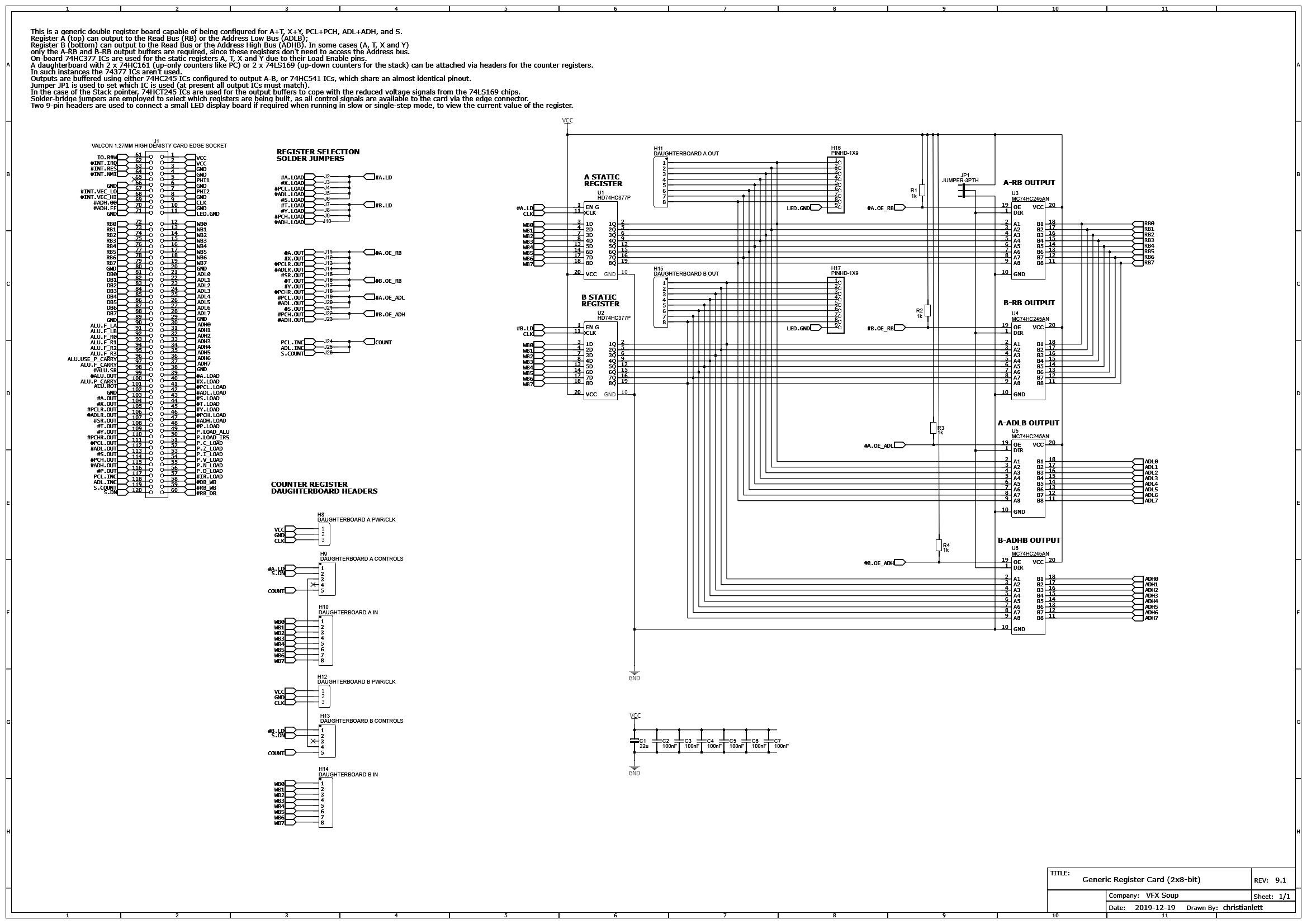

So here's the schematic and a screengrab of the PCB layout for the Register card, along with the little daughterboard that converts the registers into counter registers.
16-bit Generic Register Card Schematic
16-bit Generic Register Card PCB layout
The text reads for the Register card:
This is a generic double register board capable of being configured for A+T, X+Y, PCL+PCH, ADL+ADH, and S.
Register A (top) can output to the Read Bus (RB) or the Address Low Bus (ADLB);
Register B (bottom) can output to the Read Bus or the Address High Bus (ADHB). In some cases (A, T, X and Y) only the A-RB and B-RB output buffers are required, since these registers don't need to access the Address bus.
On-board 74HC377 ICs are used for the static registers A, T, X and Y due to their Load Enable pins.
A daughterboard with 2 x 74HC161 (up-only counters like PC) or 2 x 74LS169 (up-down counters for the stack) can be attached via headers for the counter registers. In such instances the 74377 ICs aren't used.
Outputs are buffered using either 74HC245 ICs configured to output A-B, or 74HC541 ICs, which share an almost identical pinout.
Jumper JP1 is used to set which IC is used (at present all output ICs must match).
In the case of the Stack pointer, 74HCT245 ICs are used for the output buffers to cope with the reduced voltage signals from the 74LS169 chips.
Solder-bridge jumpers are employed to select which registers are being built, as all control signals are available to the card via the edge connector.
Two 9-pin headers are used to connect a small LED display board if required when running in slow or single-step mode, to view the current value of the register.

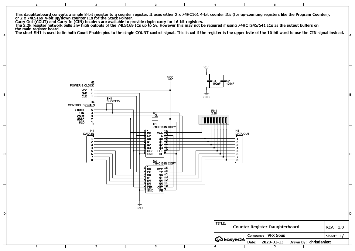

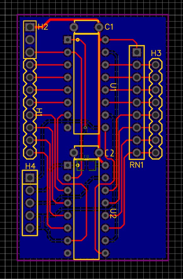

Counter Register Daughterboard schematic
Counter Register Daughterboard PCB Layout
And for the daughterboard:
This daughterboard converts a single 8-bit register to a counter register. It uses either 2 x 74HC161 4-bit counter ICs (for up-counting registers like the Program Counter),
or 2 x 74LS169 4-bit up/down counter ICs for the Stack Pointer.
Carry Out (COUT) and Carry In (CIN) headers are available to provide ripple carry for 16-bit registers.
The 2.2k resister network pulls any high outputs of the 74LS169 ICs up to 5v. However this may not be required if using 74HCT245/541 ICs as the output buffers on
the main register board.
The short SH1 is used to tie both Count Enable pins to the single COUNT control signal. This is cut if the register is the upper byte of the 16-bit word to use the CIN signal instead.
Regarding clocks, the CLK signal is a 3.125MHz PHI0 (I guess) that contains both half-cycles PHI1 and PHI2 (1.5625MHz). PHI1 and PHI2 are available but only used by certain boards. In this implementation everything is done on the rising edge, since most 74 flip-flop logic uses the rising edge to latch data.
I'm 90% convinced that the edge connector is the way to go, but as yet haven't updated the other cards with the new connector, so I'll hold off uploading them for now. In the meantime I'd love to hear your thoughts on any of this. PCB layouts should be taken with a pinch of salt - the silkscreen info is barely started and I'll need to print them out and try components for spacing, etc.

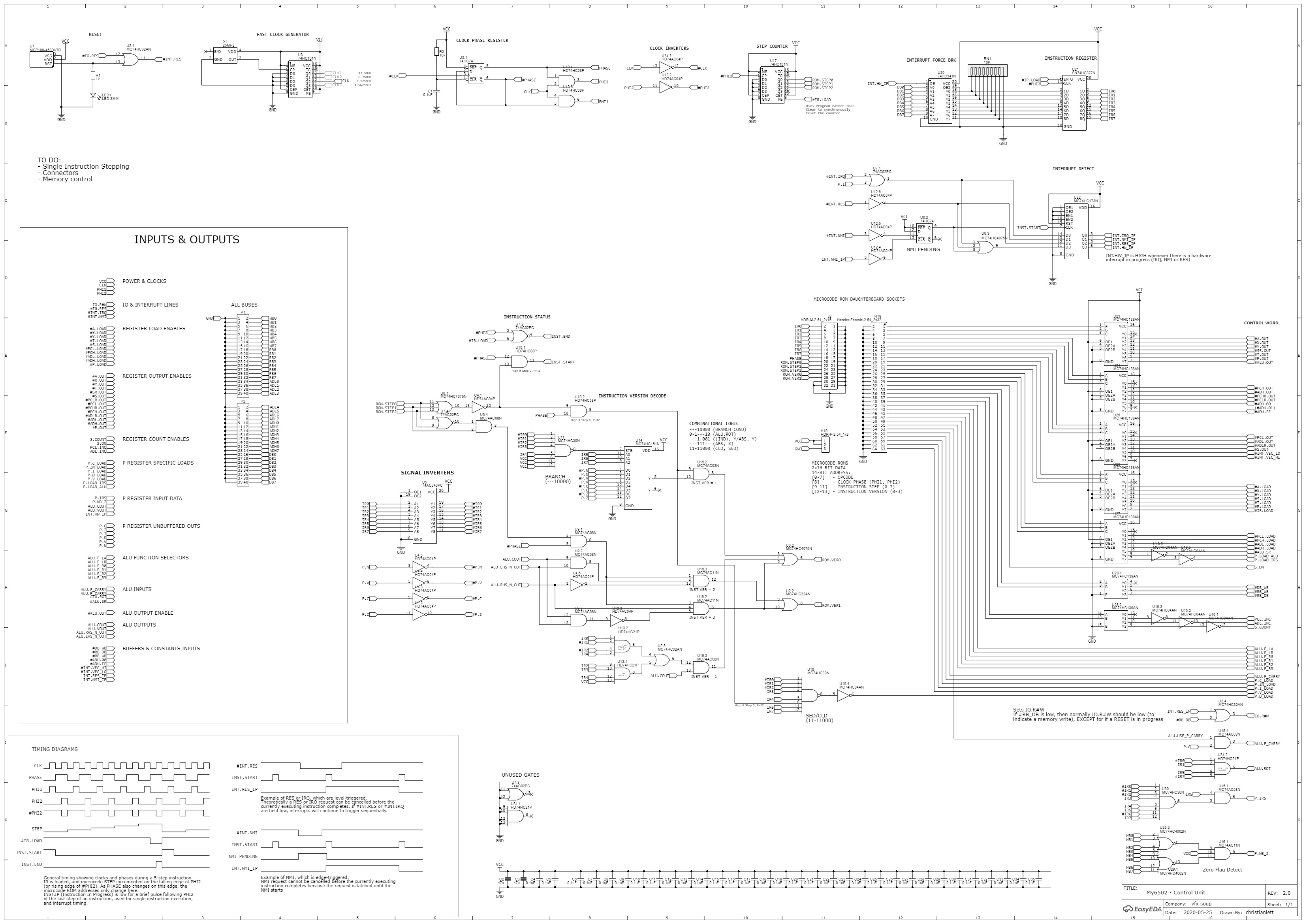

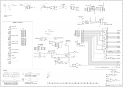

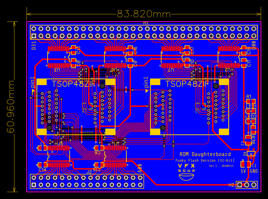

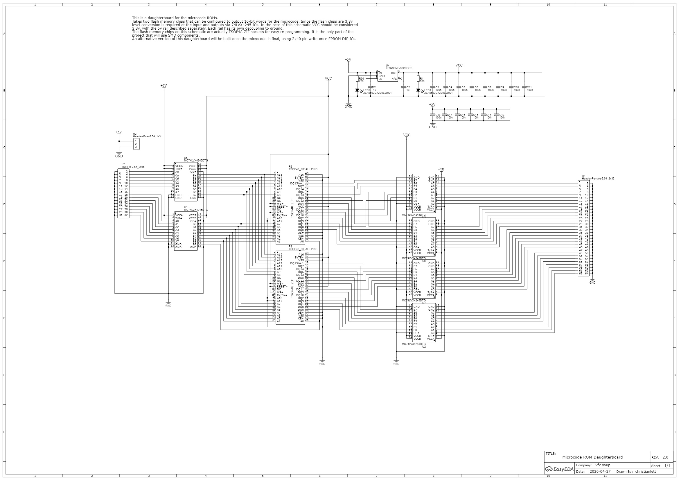

Having run them past him and made some changes following his advice, Dieter has recommended I post the schematics here for wider comment. So here goes!
First the Control Unit. This is the circuit that's changed the most and had a considerable diet, shedding about 10 ICs in the process. It also has clock generation and interrupt detection. The clock is the least developed part at the moment - I'm struggling with how to do single step and single instruction; The clock is derived from a 25MHz oscillator, which will be the VGA pixel clock. The CPU will run at 3.125MHz, with each half-cycle being 1.5625MHz. The microcode will be stored on 2x16-bit ROMs that, in the first instance will be Flash memory. I've also included the daughterboard schematic and PCB layout for the Flash memory, which is the only SMD part of the whole project at the moment. (The reason for the Flash is that the only 16-bit DIP ICs I can get are write once EPROMs, and therefore errors in programming will be costly!)
My6502 - Control Unit
My6502 - ROM Daughterboard (Flash version)

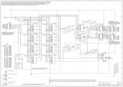

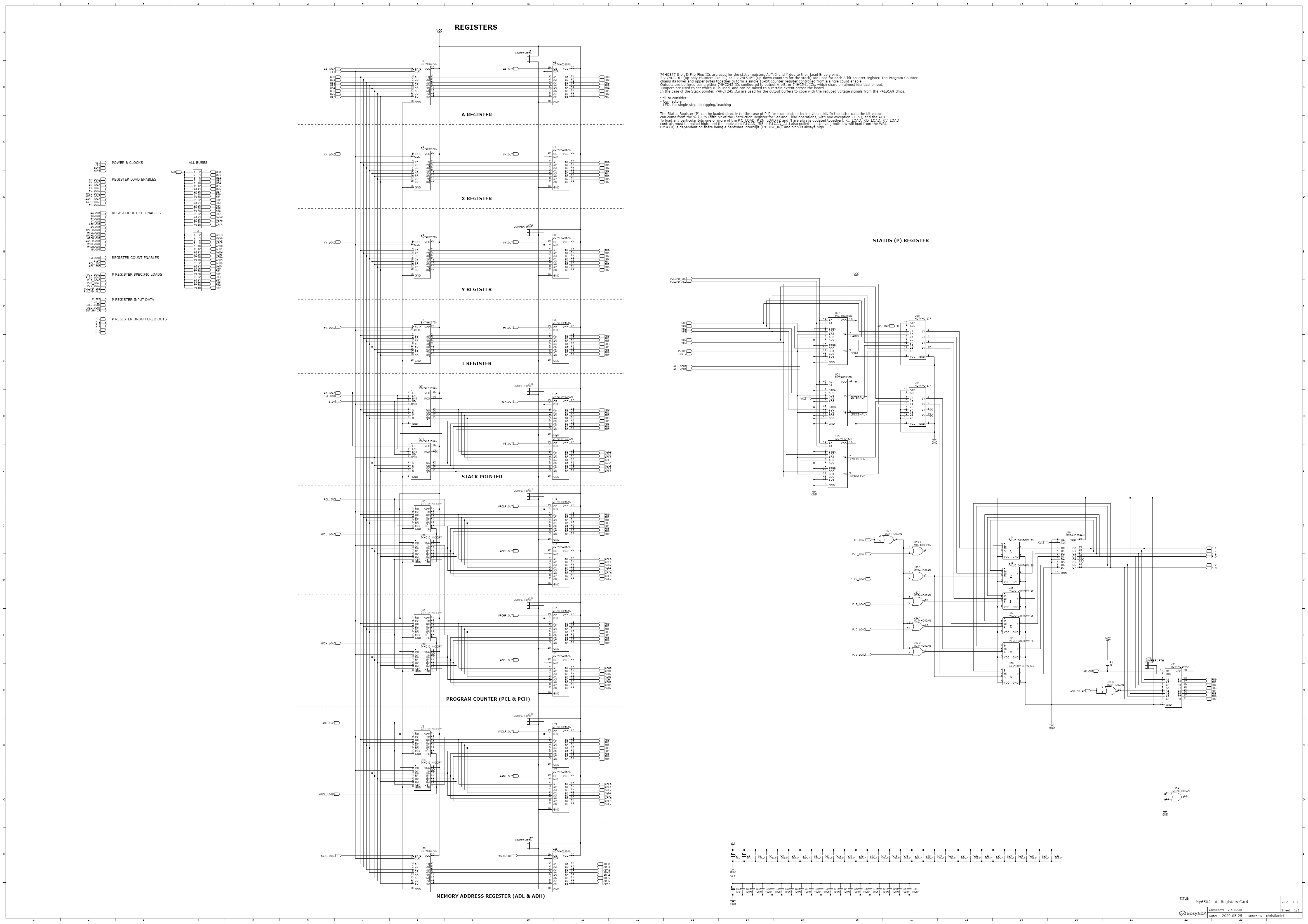

Next up is the Register board, which has changed from what I posted before. Now all registers, including the Status Register are on one board.
My6502 - All Registers

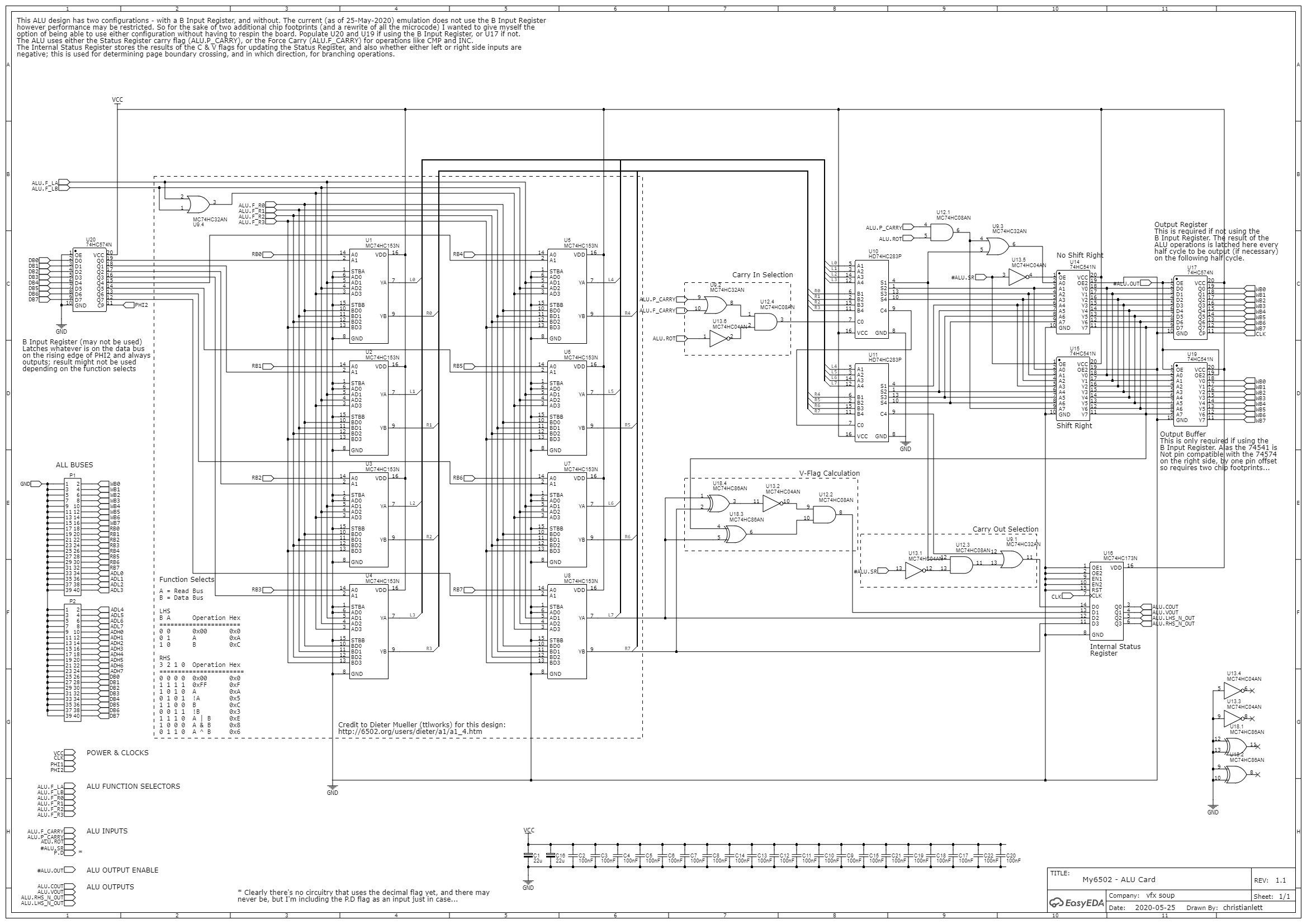

The ALU is based on Dieter's multiplexer design. There's a config to use the B-Input Register, or not, as per my current emulation. If I find that there are timing errors due to contiguous memory access & ALU processing, I can rejig the microcode and use the B-Input Register instead.
Currently an ALU process goes something like this:
Step 1 PHI2 - ADL_OUT, ADH_00 // Zero-page access - memory read onto DB
              ALU_L_A, ALU_R_2, ALU_R_3 // Load Left side with the RB, Load Right Side with the DB; ALU latches result in output register
Step 2 PHI1 - ALU_OUT, A_LOAD // Output ALU output regsiter onto WB, Load WB into Accumulator
but it would change to:
Step 1 PHI2 - ADL_OUT, ADH_00 // Zero-page access - memory read onto DB, automatically latched into B-Input Register
Step 2 PHI1 - ALU_L_A, ALU_R_2, ALU_R_3 // Load Left side with the RB, Load Right Side with the DB
              ALU_OUT, A_LOAD // Output ALU onto WB, Load WB into Accumulator
So no change in execution time, just which half-cycle the ALU setup happens.
You'll also see that there's currently no Decimal conversion on the ALU. It was never something I'd intended to implement, however I have got SED/CLD implemented so it could be retrofitted somehow (perhaps a daughterboard, so tips on where that could go would be great), or the board revised.

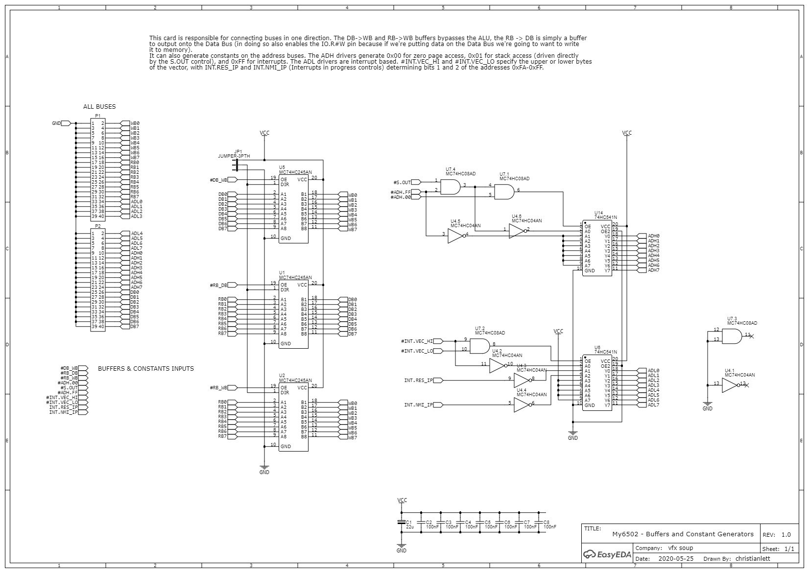

Finally for now are the Buffers and Constants, for bus-to-bus transfer, and zero-page/stack/interrupt address generation.
My6502 - Buffers and Constants
