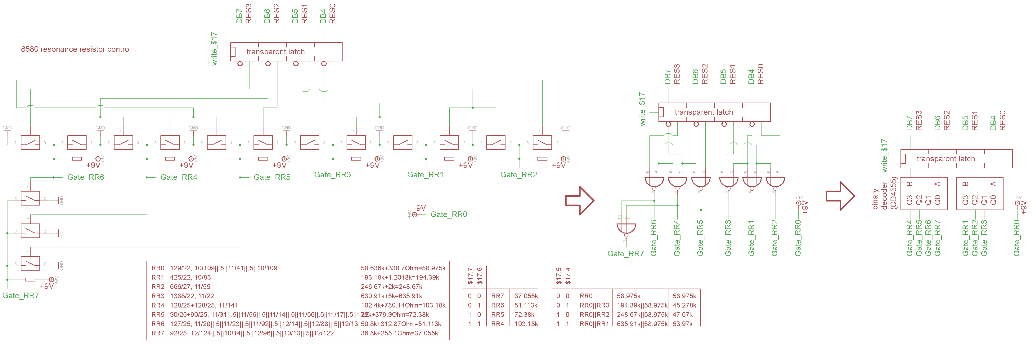

Now about the switches.
From the logic design point of view, the registers which control all the switches
and the filter frequency DAC all have identical schematics.
The layout for the register bits varies a little to make better use of the space
on the silicon, also size\geometry of the FET at the output might vary a little
depending on the load it has to drive...

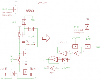

Schematic for one register bit:
BTW: the PolySi write control lines are a bit long, so the designers added a FET to every 8 bit register
as a "kludge" to meet the bus hold timing that clobbers the write control signal to GND if PHI2 =0...
like with the registers in the envelope generator.

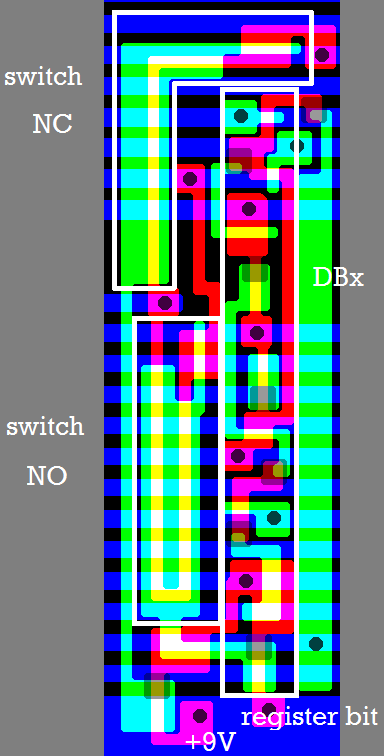

The game is similar like in the 6581... except for one thing:
each of the switches is built from two FETs instead of just one FET.
East, we have a big PolySi pad that connects to a bit on the internal data bus.
West, we have two analog switches,
one normally open (NO) // closed, if the register bit is written with 1
one normally closed (NC) // closed, if the register is written with 0
BTW: geometry\ratio of the FET that works as an analog switch gives the resistance of a closed switch.
...and in the middle, we have the register bit.
In the 6581, we had one FET working as a switch for an analog signal.
In the 8580, we have _two_ FETs working as a single switch for an analog signal:
A FET with a low impedance and a FET with a high impedance in series.
IMHO this might be a trick from the designers to reduce capacitance between both ends of a switch.
The FET with the higher impedance tends to be at the side of the switch that connects to an OP or such...
Note, that this trick is also used in the frequency control DACs...
and maybe for resistors which don't act as a switch, too.

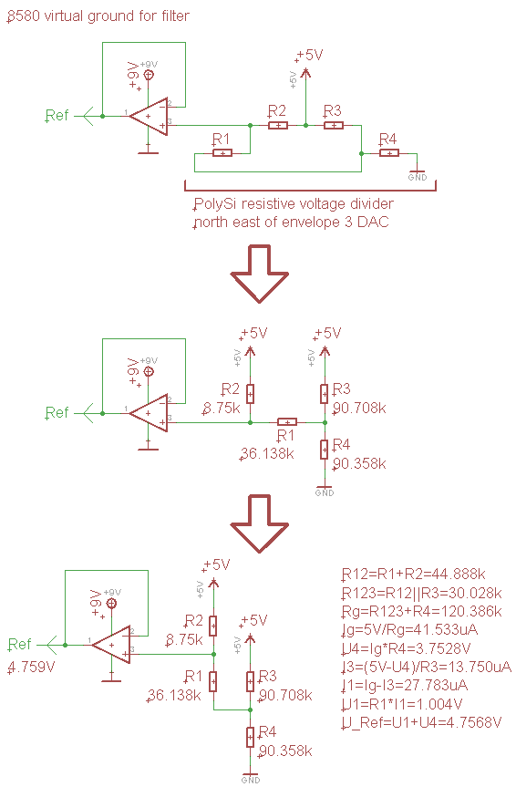

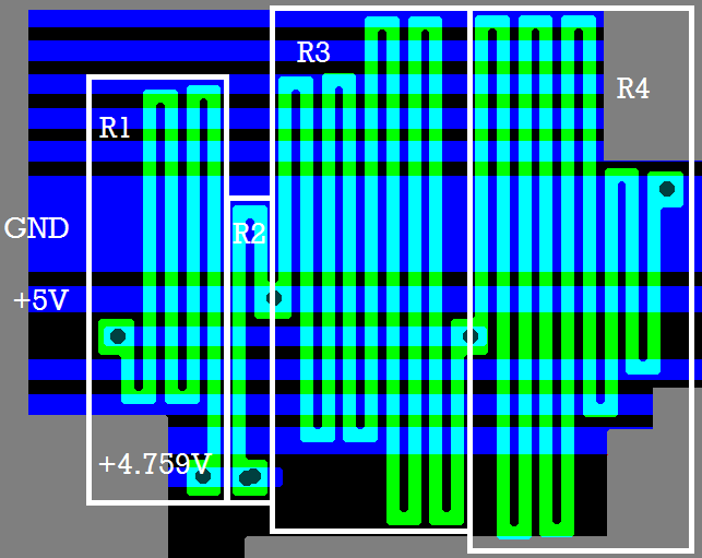

The 4.759V voltage for the virtual ground is generated by a PolySi resistor divider
north east from the LSB of the channel 3 envelope DAC.
...we'll see about that OpAmp later.

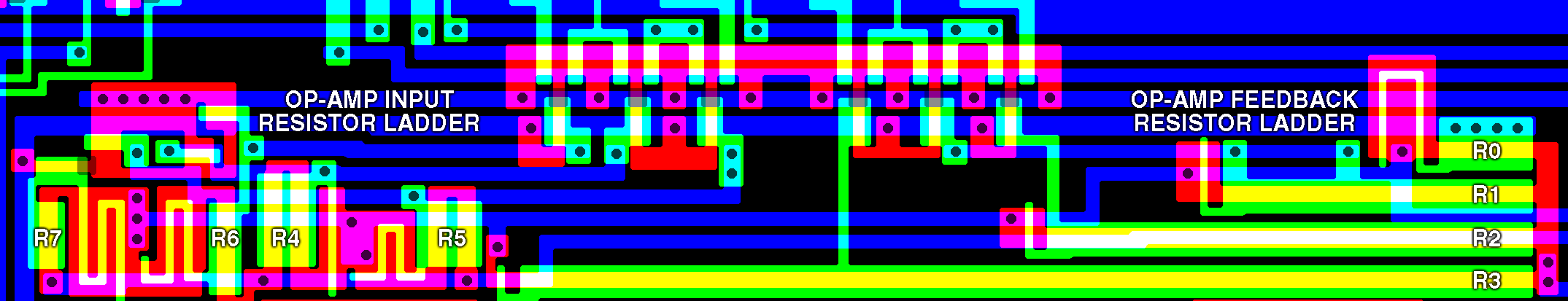

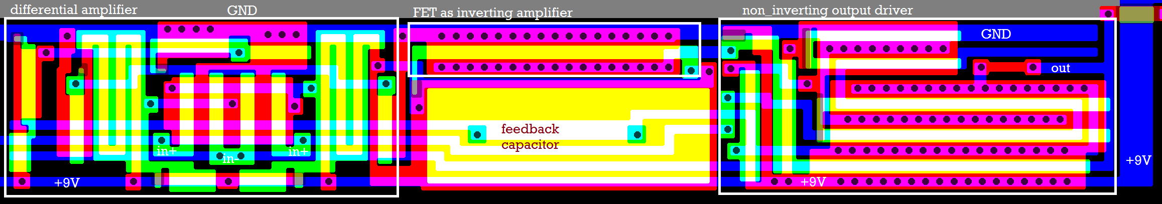

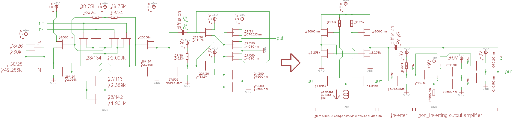

Unlike the 6581, the 8580 has real OpAmps:
// sorry for the size of those pictures.
In the differential amplifier sensing +in and -in, we have 4 FETs instead of two.
That's a temperature compensation.
I remember from my transistor OpAmp experiments, that when just touching
one of the two transistors in the differential input amplifier with my finger,
this caused the output of my OpAmp to go off by 10V or such just because
of the temperature difference between those two transistors...
But back on topic:
The output buffer circuitry looks a bit complicated, the constant current sink in the differential
input amplifier looks complicated, too. If you want to know how it works in detail,
you better consult an engineer.
Layout for all the OpAmps in the 8580 looks pretty much similar,
except that the OpAmp which generates the gate voltage for the frequency control DACs
has a smaller feedback capacitor... in other words, it's supposed to be faster than the others.

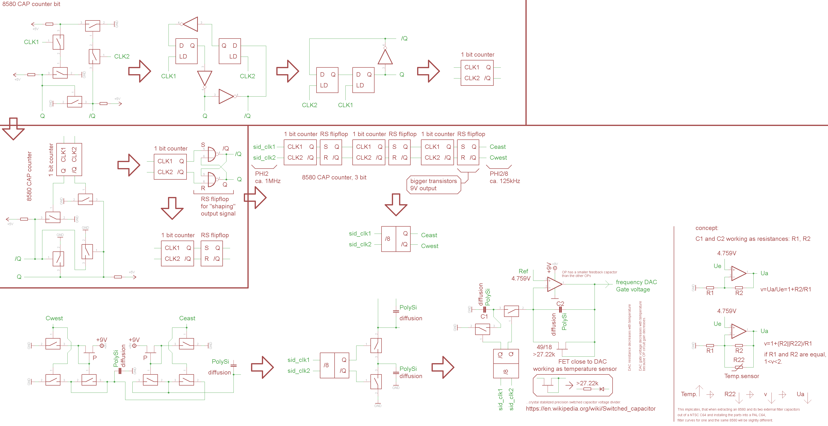

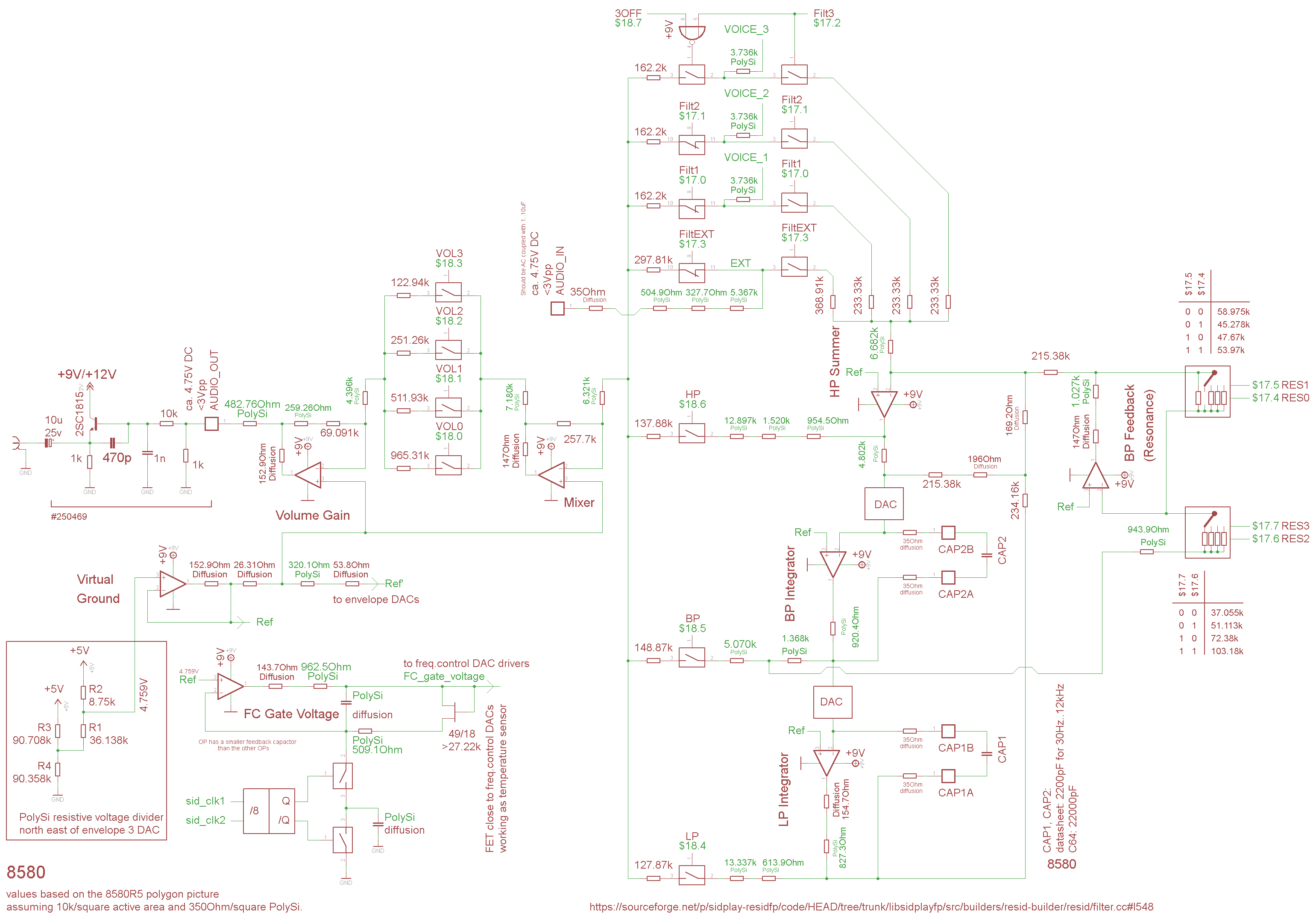

At some point, I noticed two big capacitors in the 8580 layout.
So I started to wonder, what they might be good for.
Voltage doubler charge pump ? Can't be, because all the OpAmps turned out to be +9V powered.
Switched capacitor filter ? Can't be, because of how the switches attached to those capacitors are wired up.
It turned out that the two big capacitors are part of a trick circuitry,
which changes the gate voltage of the frequency control DACs according
to the temperature of the DACs, to reduce the effects of temperature
to the filter curve.
There is a FET working as a temperature sensor close to the DACs...
but we are getting there later.
We have an asynchronous 3 bit binary counter, LSB is running at the speed of PHI2.
Every counter bit drives a R\S flipflop for making the inverted and non_inverted
output of the bit non_overlapping.
From the logic design point of view, those three bits in the counter are pretty similar...
on the silicon, the transistors in the R\S flipflop output of the MSB are just a bit bigger...
and +9V powered.

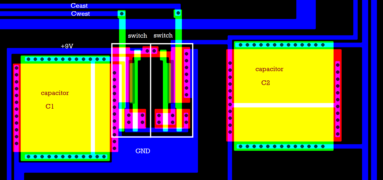

The two big capacitors and the +9V powered switches "between" them:
It's an ingenious idea to use the AC resistance of two capacitors as a voltage divider.
The AC resistance of the two capacitors depends on the PHI2 clock frequency,
while the resistance of the temperature sensor FET does not.
This implicates, that when taking a PAL C64 and modiying it into a NTSC C64,
or vice versa, this might shift the filter curve by 4% or such.

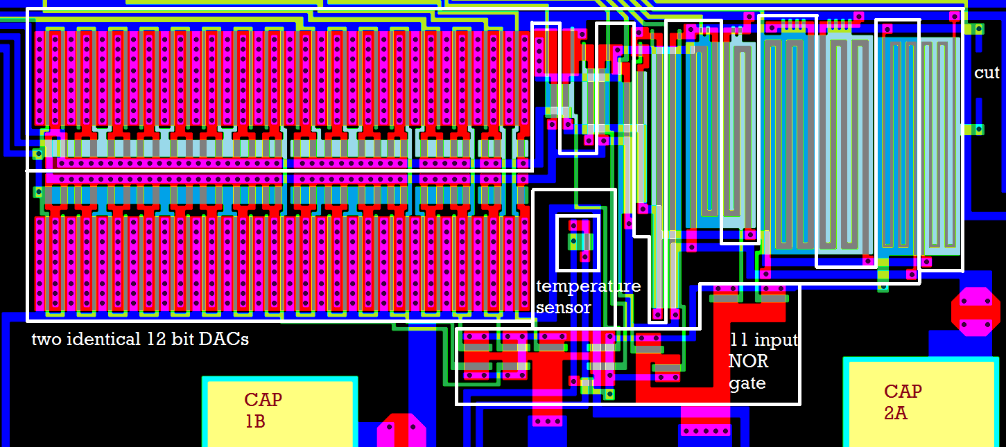

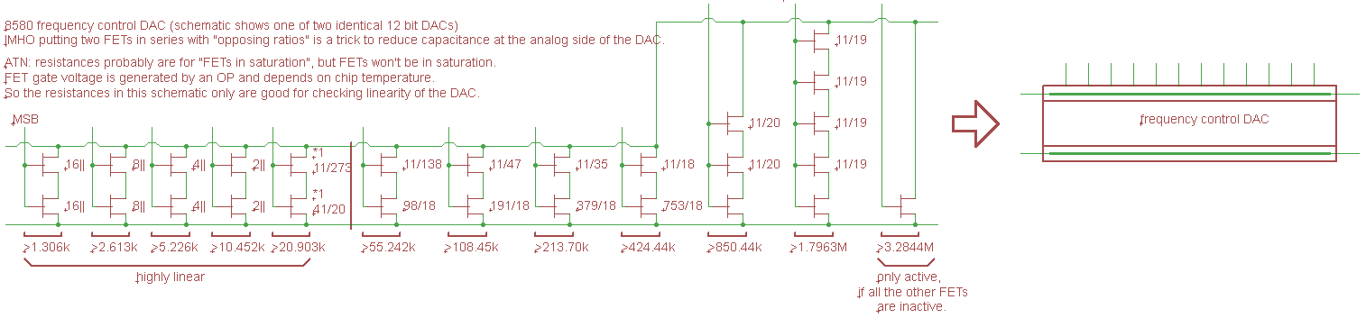

We have two identical 12 bit DACs in the 8580, which work as resistances for the filter integrators:
// sorry for those colors.
The 8580 has 11 bits for frequency control, but 12 bit DACs.
If those 11 bits would be '0', the impedance of the DACs would be "infinitely high".
To get around this, there is an 11 input NOR gate below the DACs sensing those 11 bits.
If they are 0, the NOR gate gives the gate control voltage to the 12 bit DAC LSB.
Between the DACs and the NOR gate, we have that FET which works as a temperature sensor
for the circuitry that changes the gate control voltage according to the DAC temperature.
Schematic for one of the two DACs:
Like with the other analog switches in the 8580,
in the DAC we have _two_ FETs working as a single switch for an analog signal:
Nothing special, conceptually the DAC buffer is just a super buffer... but it's +9V powered.
The output either is tied to GND, or to the gate control voltage mentioned in the previous post.

Ah, I nearly forgot:
For resonance control, we have two more tiny DACs and a little bit of decoding for them.
That stuff is located north of the "BP feedback" OpAmp on the silicon.
Schematic:
'Gate_RR0'..'Gate_RR7' in the schematic above is just the gate voltage for the analog resonance switches R0..R7.
Again two FETs of different resistance in series for every switch,
and the geometry\ratio of the FETs defines the switch resistance when the switch is closed.
Nothing fancy in there...

Ok, now for my interpretation of the 8580 filter:
There is a nice picture of the 8580 filter section at Tommi Lempinen's site,
but the picture is a little bit too big for directly linking to that image...
and making the image smaller would spoil the readability of it:
http://oms.wmhost.com/misc/MOS_8580_R5_filter.png
