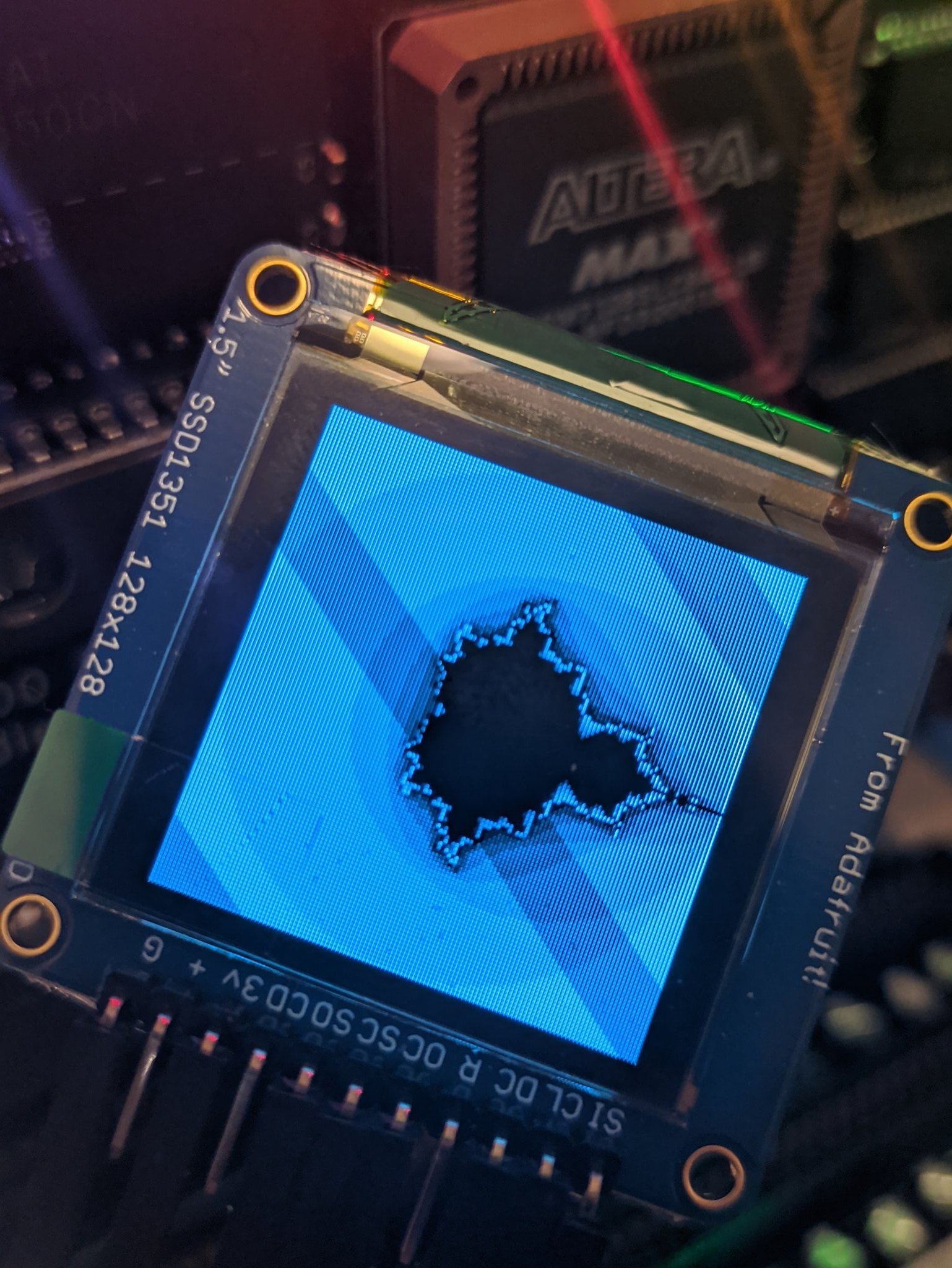

I can second that. I am using Quartus with Verilog on my 68000 build and it is very good and productive. I am using the EPM7128S for all the glue logic and SPI. Here's a picture of my build.
I got the SPI Master working last night driving a oled display.

I can also see 27C1024 PROM, 16C550 DUART, and 12MHz 68000. I can't make out the RAM. How fast is the processor running?
The QVGA screen is cheap now and it can be driven with SPI. SPI is quite useful for interfacing with modern I/O.

the sram is CY7C1049D. The cpu is running at 12Mhz (not try to overclock yet). That mandelbrot is C code with soft floating point math so a bit slow. Take around 1min 15sec to render.

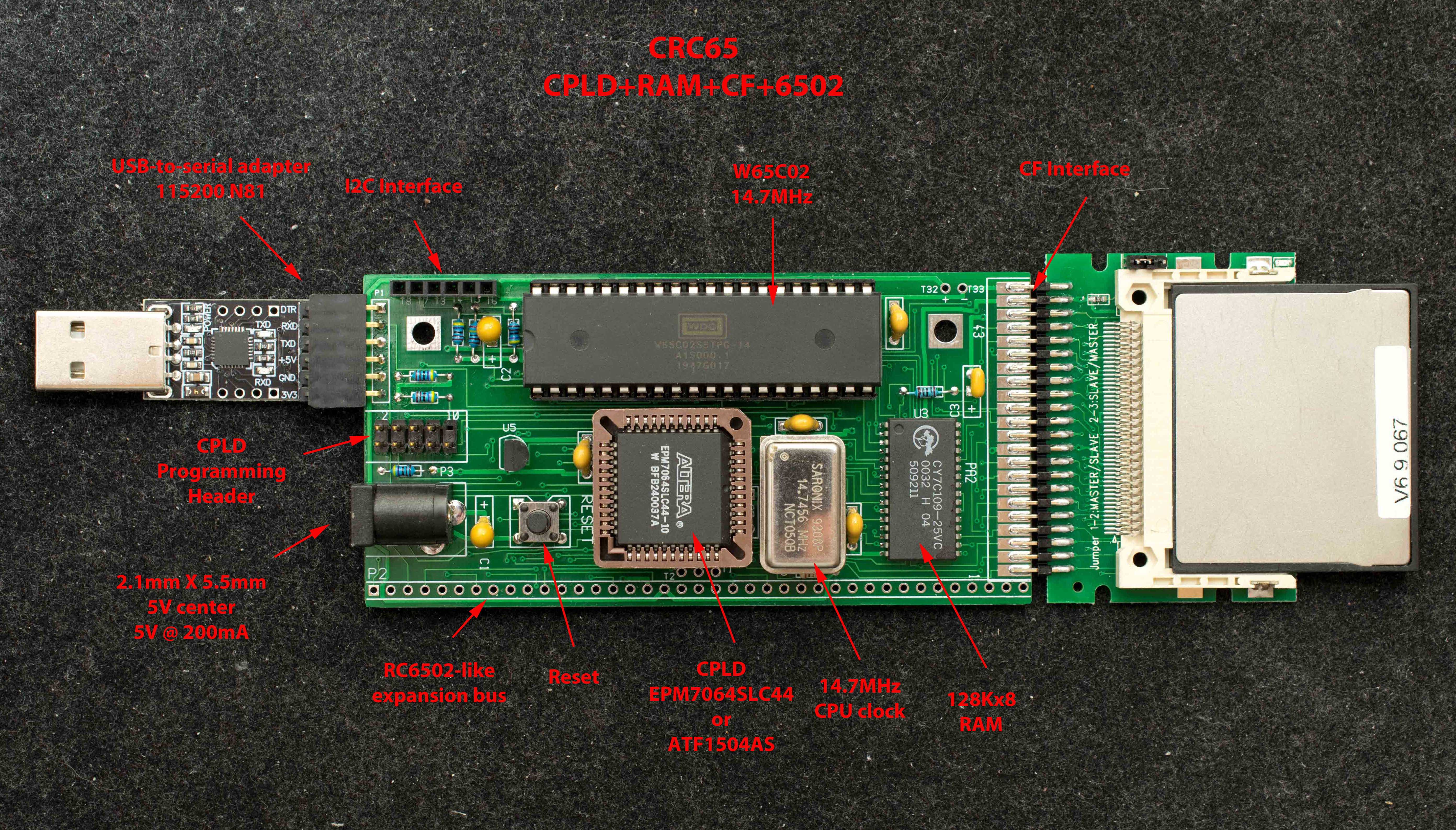

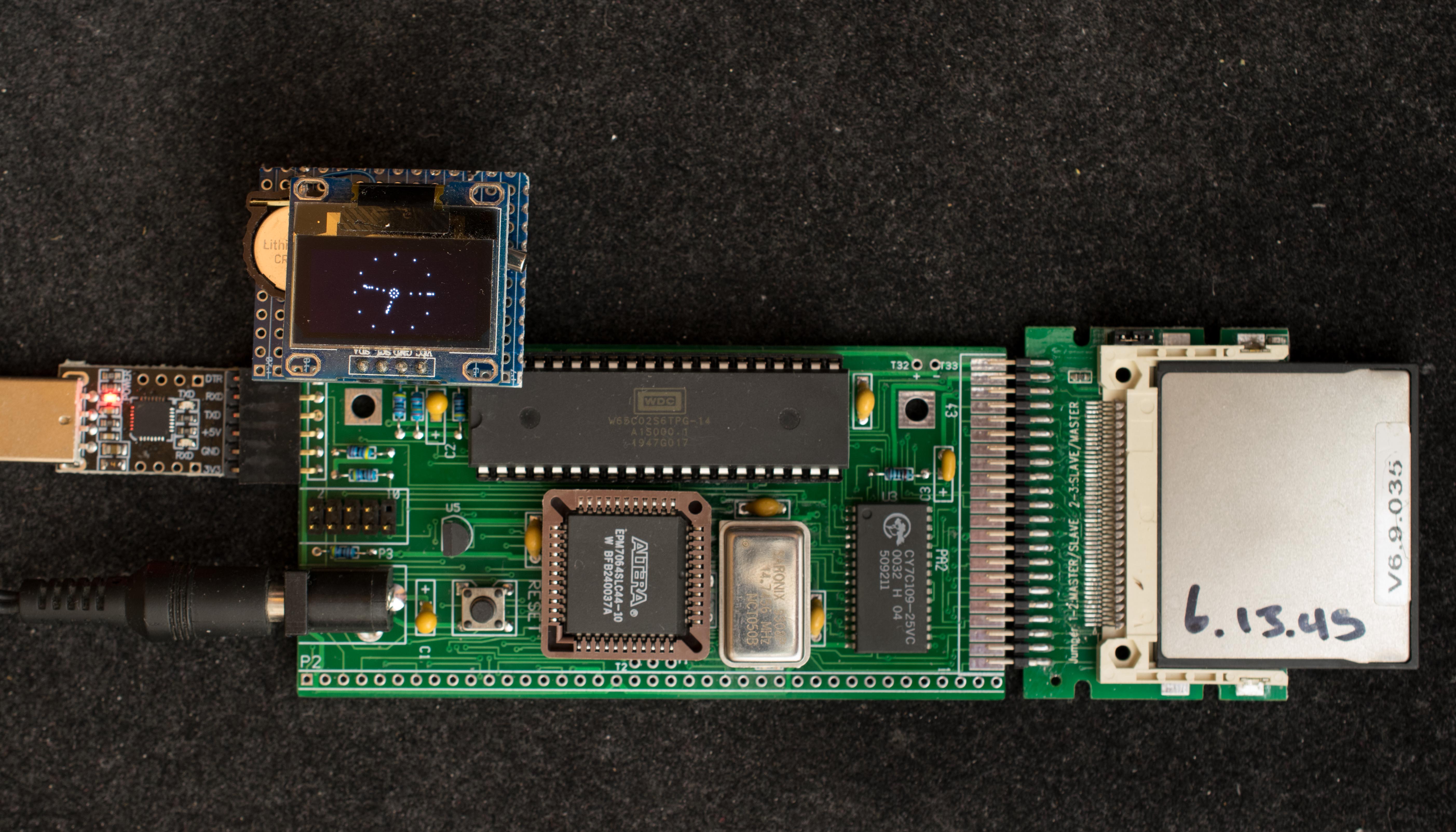

Finally received the pc board last evening. The pc boards are well made. It is a 2-layer 2"x4" board; the design rule is 7 mil trace and 7 mil space and 7 mil annular ring for via. JLCPCB pretty much hit the bull's eye as shown in the first picture.
Build up two boards so I can experimenting. As built there are 223 solder joints so a board can easily be assembled under an hour. 2nd picture shows the finished board with major components annotated. The board in the picture is 8" long from tip of USB-serial adapter to end of CF disk.
They both work!
I'll update & finalize the CRC65 homepage. I'll be doing overclock experiments this weekend to find out its upper frequency limit.
They both work!
very nice and clean pcb. I also use JLCPCB for my boards, they are really good and cheap.

At 24MHz the board is flaky, but it is running solidly at 22MHz from 4.75V to 5.25V. I have to remove I2C capability to run at 22MHz, but I think I can pare down the bootstrap software to restore I2C capability.

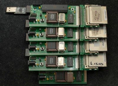

Built up 5 CRC65 to make sure the design is producible. I'll need several for experimentation anyway. One is set aside as the reference design at the nominal 14.7MHz; another is for overclock experiment; another as tester for whatever 6502 acquired on eBay; and one for general experimentation.
All 5 boards have been tested to 22MHz and passed. The CPLD design is completely full so in order to run at 22MHz I need to remove the I2C functionality. Even with that, I believe the CF write access is marginal. It will intermittently failed the write test but CF read is working fine. The important point of 22MHz operation is to prove sufficient design margin of which I'm satisfied. Nevertheless, I believe it is possible to simplify the boot ROM and apply the freed resources to restore I2C functionality and fix the CF write issue. Something to work on...
The CPLD is Altera's EPM7064SLC44 which is obsoleted part. Atmel has a Altera-to-Atmel converter, POF2JED, which should convert the Altera programming file to program Atmel's equivalent (ATF1504AS) I will put out an order to Mouser for few ATF1504AS and an Atmel programmer so I can check out the file conversion.

One of the boards will be the clock. I'll also find out how long a CRC65 can run continuously. The hand-wired RTC is not particularly accurate; it has gained about a minute since 9 days ago.
