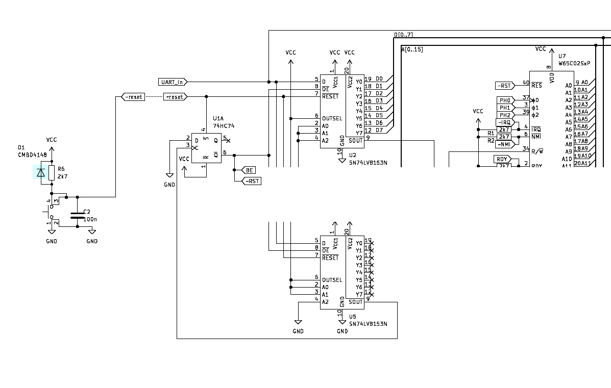

This first drawing is basically identical to what you posted, but for clarity I moved some things around -- stuff I'll be mucking with later. There is one small change; diode D1 now connects between the cap and Vcc (not between the cap and Gnd), as I suspect you actually intended.
In this second drawing I put two previously unused inverters to work, and was able to eliminate the 74HC74 (which itself was only half used).
Speaking of putting chips to work, it irks me to see U5 (the final '8153) with only one of its outputs connected. Those other outputs are a solution looking for a problem! :lol: So... here's a version that could be applicable to the '816, assuming one doesn't need all eight of the extra address lines.
Looking forward to further news of your progress...

Using the top bit of one of the 8153s was my original idea but it wakes up with the pins low, which of course reset the flipflop before it got started. I think your double inverter ff works the other way up; nice catch. It does seem a waste of a chip, and you can't even use it for blinkenlights :(
Yes, with the diode turned around this "flipflop" can accept an active-high signal after memory has been initialized and it's time to say "go"!

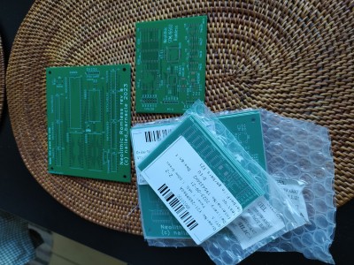

The circuit boards came back for both Neolithic Romless designs, along with a solder stencil for the STM-powered board. Hopefully I get some time to build at least one of them... I bought a new house yesterday so there may be some liftin' and carryin' to be done :mrgreen:
Posts: 3525
Re: Neolithic Romless
Starting with all your 6502 paraphernalia, of course! :P And congratulations, BTW!
(Regarding the new PCB's, I mean! 8) Oh, and the new house, too, I guess... :wink: )
