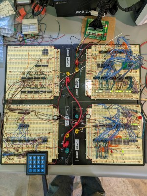

I've set myself a challenge that might seem a bit silly to some, but helps me to learn and discover in a way that is fun to me...
Imagine that you are in a locked room (or on a nice Island or whatever you fancy), and you have a pile of chips and data sheets, wire and basic electronics-making supplies and equipment. Not in the room is there any preprogrammed non-volatile storage or already designed and built computer systems. Your goal is to incrementally build up a fully working 6502 computer with keyboard, video, storage and the ability to program it nicely, and maybe create some video games.

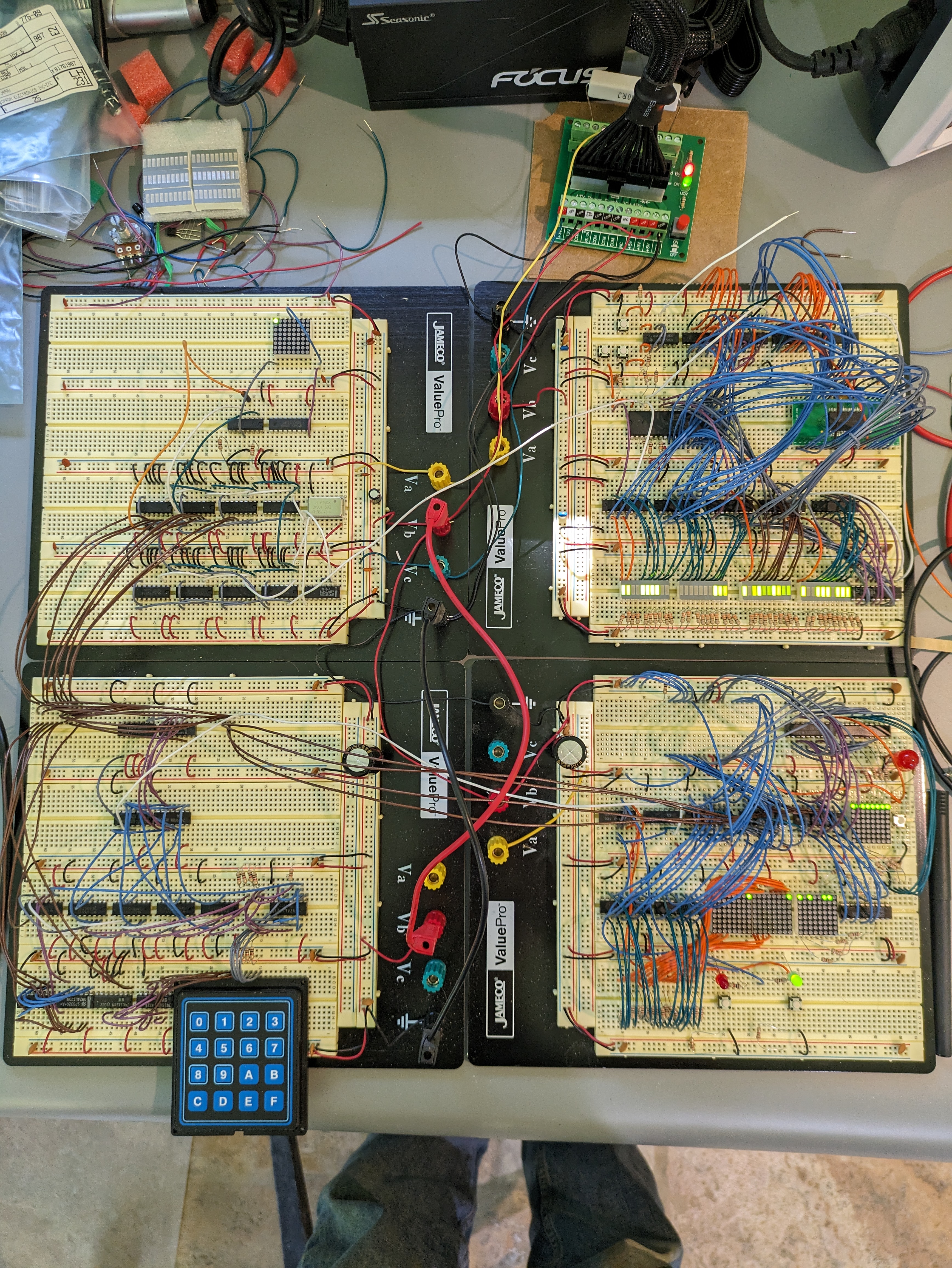

So here is where I am in this process:
File comment: First working program on locked-room bootstrap machine
This has just gotten to the point where I can program in machine language. entering bytes into NVRAM using a hex keypad, and watch the CPU run, either using the LED address/data/control line visualization when single stepping the clock, or using an oscilloscope to look at the various lines when running up to 12.5875 MHz so far.
There is one module per wireless proto board. The first one I built is the clock/counter module in the upper left, with a crystal oscillator module starting a divide-by-two chain at 25.175 MHz. The second module is in the lower left, which turns hex keypad presses into keypress events. The third is in the lower right. That takes hex keypress events and turns them into a nonvolatile RAM byte editor. There is no hex-to-segment/font decoding yet, so the address and data values are displayed in binary for now. Finally, the programmed NVRAM can be moved to the upper right CPU module to be executed. The CPU module proper is the upper half, with the CPU, clock half-stepping circuit, address decoding and RAM control logic. The lower half has a bunch of LEDs to visualize the address, data, control and memory-mapped output latch (the latch is the chip just to the right of the LEDs).
My long-winded journal of the design and build process, with a number of tangents, is captured at http://cognigraph.com/6502. I'll put more at that web link as I go along and post here on the forum as well.
The key chips I'm using so far are:
    CPU: W65C02S PDIP
    NVRAM: amazing CY14E116L-ZS25XI (acts like a static RAM, similar performance, but saves itself to a NV store on the same chip on power down)
The rest is mainly more mundane 74Fxxx gates, latches, counters and glue logic, and a 25.175 MHz clock module,
Here are some details on each of the four prototype modules so far.
CLOCK MODULE
I started by using the 12-bit ripple counters tied to the 25.175MHz crystal oscillator module, but realized the ripple counters have nasty glitches in the count values if you use their outputs directly. While it is possible to do some sort of latching to fix this, that seemed overly complicated. Searching around, there is a sweet 74xx163 counter chip that deals with this latching nicely. I also played with using 74xx175 flip flops directly, maybe combined with some logic similar to what the 74xx163 has. This would have the advantage of providing normal and inverted outputs per clock counter bit.
My second build-out after the ripple counter demo was using straight 74F163’s clocked directly from the 25.175MHz clock. This worked when chaining together around six of them (4*6=24 bits count out of the 32 bits I was aiming for), then the seventh counter chip would not count. It turns out this was due to the chained propagation delays of the carry lookahead logic: it just could not manage that many chips in the chain at the high clock speed. So I placed a one-bit flip-flop counter using a 74F175 at the beginning to divide the fast video clock in two, to 12.5875MHz, and was able to chain eight 4-bit 74F163 counters off of that. With that fix, I think the clock module is adequate, and will supply the following interface lines: GND, +5v, clear input, 25.175MHz (640x480 VGA dot clock), 12.5875MHz (CPU clock), and count bits 0 to 31. Total lines used: 37. It turns out that the big soldered proto boards I have include 37 pins on the edge connector array. What luck!
The clock module counter has 32 bit, with cycles time going from 6.29375MHz in powers of two divisions:

INITIAL 6502 MODULE
To start, I am making the 6502 setup run off or a manual half-cycle-step clock, with an S-R latch set high/low with respective pushbuttons. I’ve also added a reset pushbutton and lots of 1x10 LED arrays to visualize all the state, including address, data and clock/control/output lines. I’ll put in a simple clock/counting program in the NVRAM, add memory-mapped output to an 8-bit latch, and see how it goes.
[July 20 or so....] It worked! The memory-mapped output latch shows the count incrementing correctly during half-step execution, and the latch bits show the correct frequencies on the oscilloscope when running at various CPU clocks.

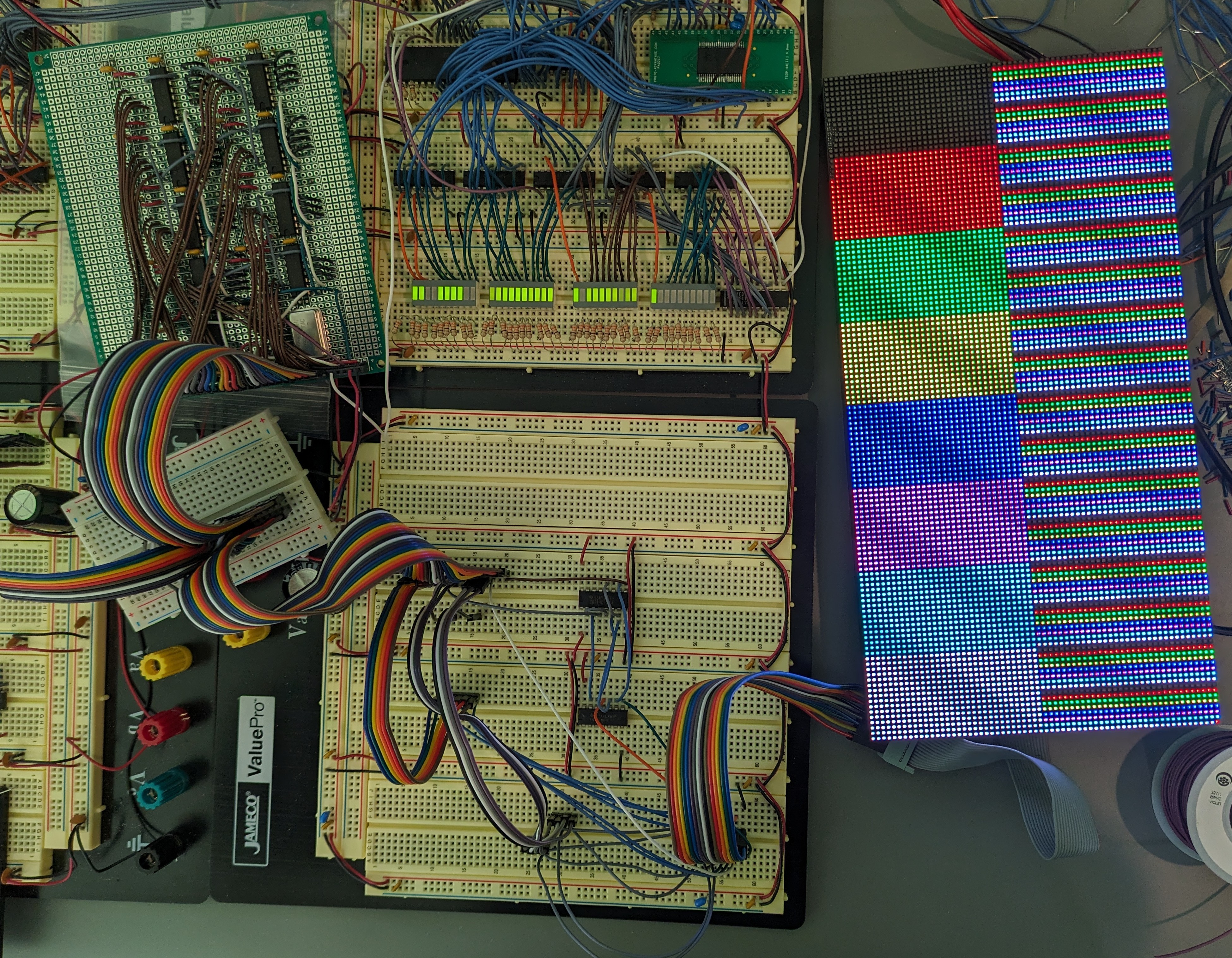

I'm thinking of working incrementally up to full 24bpp VGA, maybe 640x480 60Hz. My next immediate step is to drive a single 8x8 LED matrix to support editing an initial font. After that, I've got a really nifty 128x64 LED module that I'll try and drive Apple ][ style using the low phase of phi2, when the W65C02S is not using the RAM. At that point (and with a real keyboard hacked and hooked up), I can start building my own editor and assembler and various support libraries. To get to full 24bpp VGA 640x480 I will need to push for a lot more compute, such as more CPUs or higher clock rates, or add some hardware rasterization support (primitive GPU sort of stuff). I was tentatively thinking 6 CPUs would work out nicely with the other requirements, like needing almost a megabyte of memory and six bytes read during phi2 low. From other 6502ers clocking experiments I see that running at 25.175 MHz should be fine, so that would help a lot.
The NVRAM is amazing but, as I discovered, dangerously easy to corrupt/overwrite if something goes haywire in the CPU execution. Copying backups and keeping old versions around seems like the smart move. The NVRAMs I got were also really expensive, over $50 each in quantity 5, so I will move away from them to cheap big flash storage once I get the I/O routines written.

I’ve converted the clock module to a soldered breadboard. Testing it isolated from the other modules was fine, all power-or-two count bits measured correctly on the scope. However, when connecting to the hexadecimal keypad module and the NVRAM byte editor module the keypresses went haywire. It turns out the long wires were getting too noisy, picking up some clock-switching spikes, and creating false keypress signals on the keypress event line. Adding a 22pF capacitor on either or both ends of the event line cleaned that up. Here is the state of the modules with the soldered clock module in place, and the upper left breadboard cleared and starting to be populated for a font editing module.
6502_locked_room_soldered_clock_module_PXL_20230802_190040905.jpg [ 4.46 MiB | Viewed 6211 times ]
I'm planning for the font editor to have the CPU in the loop. One byte of memory mapped input to grab switch up/down states, and three bytes of output to drive the 8x8 matrix and the address LED bar.
--Mark

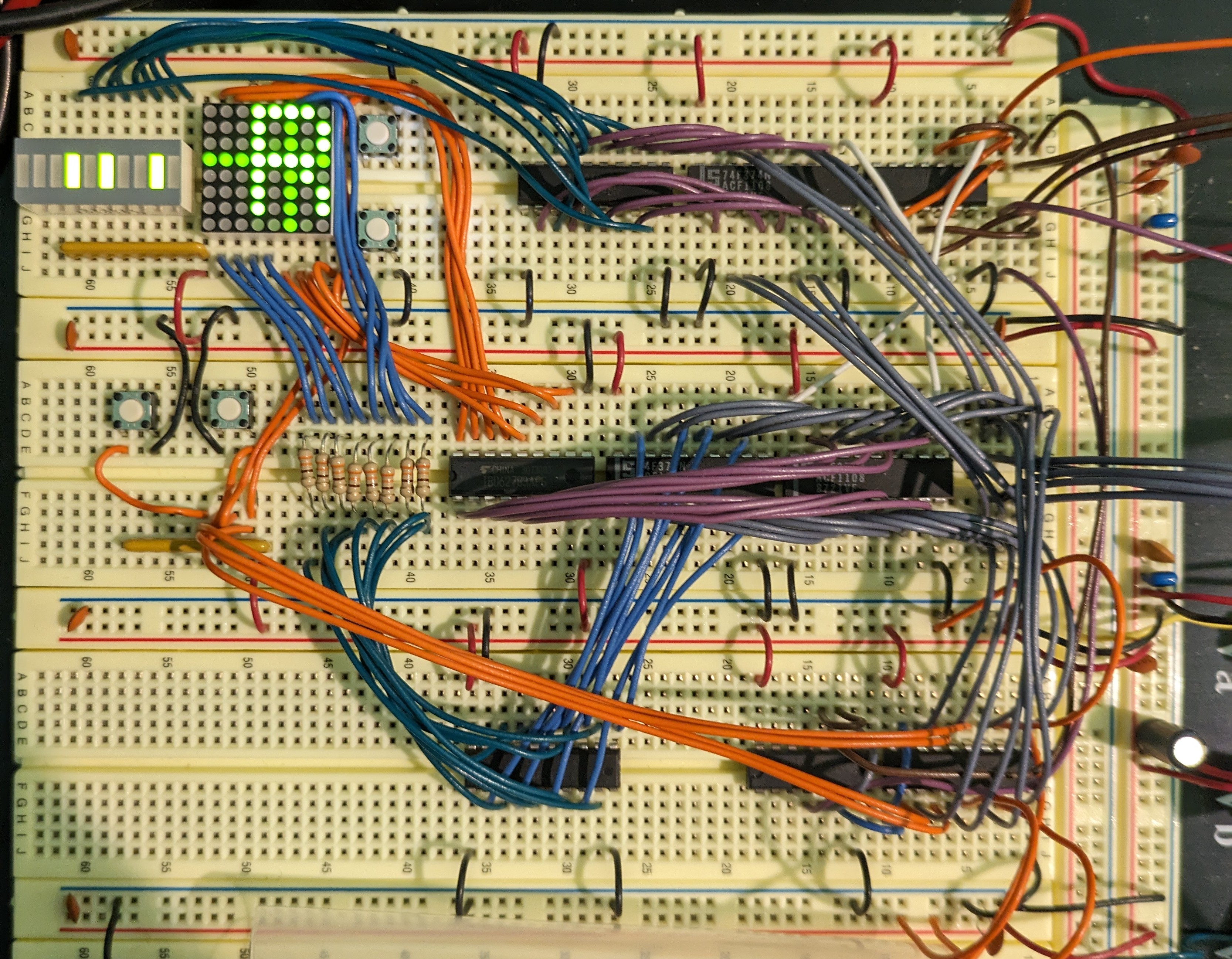

Here is my latest progress, a font editor module (used already to create a decent 5x7 font for all the printable ASCII characters):
FONT EDITOR
The next module I built is the font editor. Since I can now program the W65C02S by byte editing the NVRAM, it made sense to go with minimal hardware and put most of the logic into software. The finished solderless version as of 2023-08-23 looks like this while in use:
I tried to make the user interface as intuitive and self-explanatory as possible. The use of grayscale for highlighting what you are editing means you can get a feel for what the button presses do quickly. My son, with no instructions, was able to figure it out and make a heart shape in 5 minutes of playing around.
The software interface from the font editor module to/from the CPU consists of:
Output latch at $C000 that drives a bar of LEDs (8 of 10 are used). For the font editing, this shows the ASCII value of the character being displayed and edited.
Output latch at $C001 that drives the 8 row anodes of the 8x8 LED font matrix display. We typically activate (set high) just one row at a time, with the row scan clocking at 12.3 kHz. The whole array is thus scanned at 1537.5 Hz, and with 3-bit (8 levels) grayscale via PWM we end up with full grayscale scanning effectively at 192.2 Hz.
Output latch at $C002 that drives the column cathodes (bit set means LED on).
Input buffer at $C003 that allows reading of bit 10 of the clock module in the high bit and four push button states in the lower four bits (the remaining bits are unused for now). The buttons are:

The hardware specific to the font editor module is:
3x 74F374 8-bit latches
3x 74F240 inverter/buffers
1x TBD62783APG 8-bit anode driver
8x 330Ω current-limiting resistors to avoid burning out the 8x8 LED matrix
1x SIP bank of 8 330Ω resistors connected together on one end to limit current to the LED bar.
1x 74F32 quad positive OR gates to generate the latch clock signals from the write enable and respective address selection lines.
1x 74F00 quad NAND gates to generate the output enable of one of the `240s to output to the CPU data lines, based on the $C003 address decode selection line and the CPU RWB line.
A 10 LED bar (currently using only 9 of them)
An 8x8 LED matrix
4x push buttons
I’ll work on putting out some schematics.

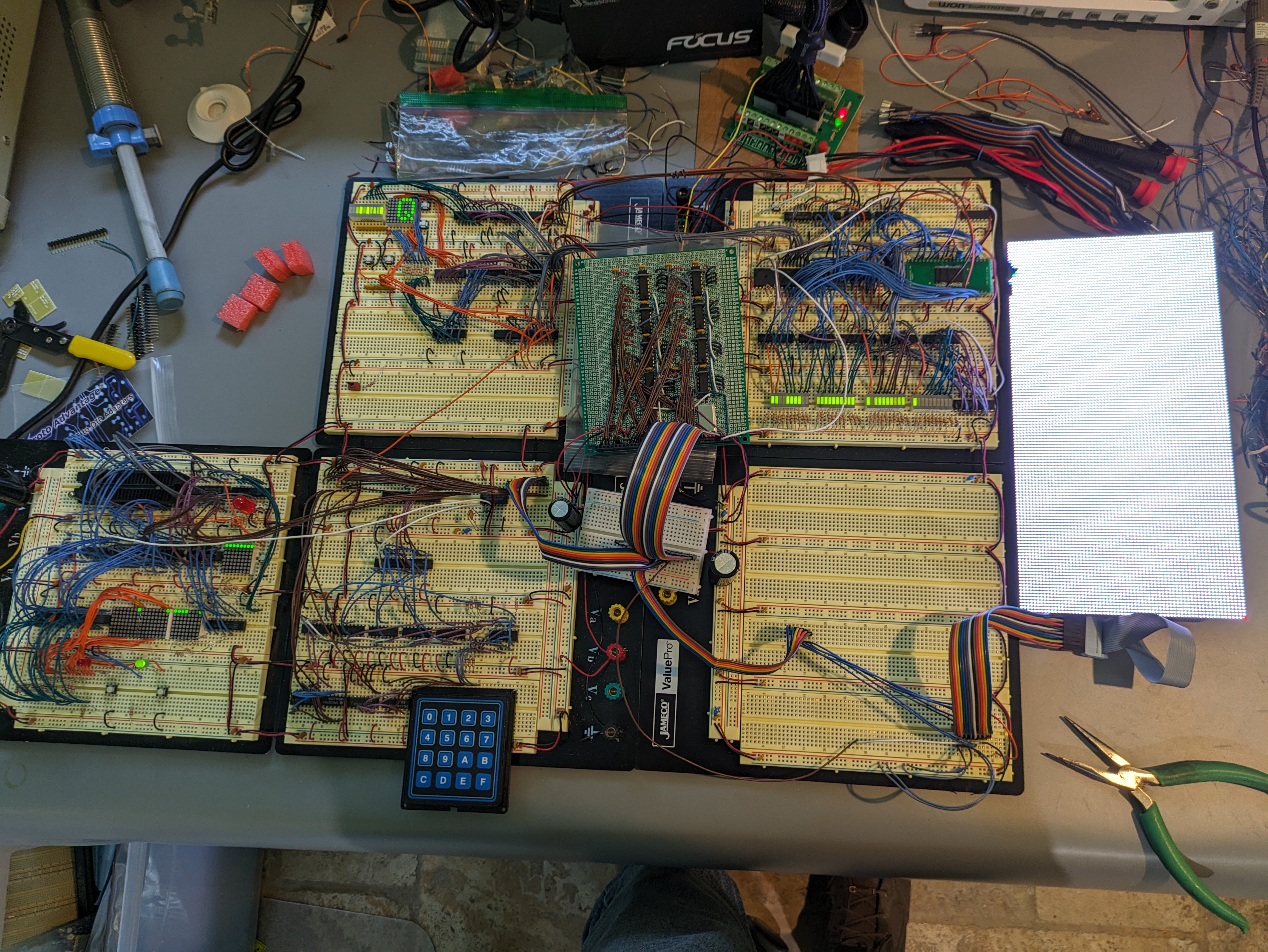

Here is a quick update on starting the display module using a nifty RGB LED matrix module.
LED RGB PANEL
Next up, after getting a complete 5x7 font edited, is a display to put text onto. After considering generating NTSC or VGA analog video, or directly driving an LCD panel digitally, it looks like the easiest option is RGB LED matrix modules, the kind intended to be mosaiced into large billboard or stadium video displays. The one I got is a 2mm pitch 128x64 module for under $60. The first one that arrived was somewhat damaged, as the wee RGB led pixels can break off easily with rough handling, but still usable for developing the driver circuitry:

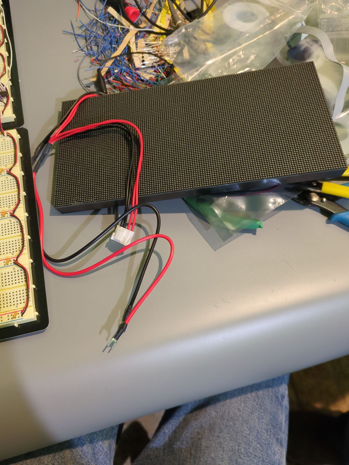

File comment: LED panel unboxed
These display panels are quite bright, and draw a lot of current, hence the beefy power cable. Here is a close up of where some teensy surface mount pixels got knocked off:

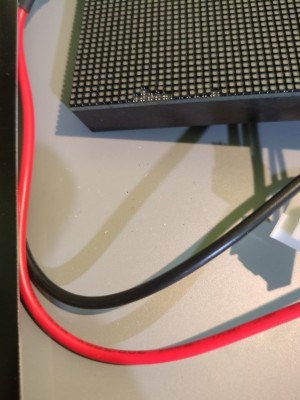

File comment: The wee SMD pixels can be broken off easily with rough handling.
There are some great resources online of folks reverse engineering how to drive these types of modules. A Google search for HUB-75E led panel pinout will get you some of these. It turns out these modules are super simple to talk to in a TTL prototyping environment, much simpler than trying to cook up a VGA signal or drive an LCD panel. I boldly hooked my module up to my power supply, and with no additional chips was able to display all white with a few minutes of wiring:
File comment: LED panel first full light, plus modules rearranged/clock power network improved.
There is a 16-pin ribbon cable with a simple serial TTL type interface. You are driving two scan lines at any one time, 32 pixels apart, and provide a five input address of which scan lines to activate . I just hooked these to five contiguous power-of-two clock lines from the clock module. There is a clock line for loading two RGB pixels at a time, shifting the data into the two row shift register chains. There is a latch line to put the loaded data into the drivers. And finally an output enable line. I hooked the LED data clocking line to a faster clock line in the clock module. The RGB inputs I hooked to 5v. I moved the latch and output enable lines by hand between ground and 5v. And voila!
Note that I rearranged the placement of the NVRAM byte editor module to make room for the future LED display module driver module. This was easy since the byte editor only has connections to the hexadecimal keypad module, and is independent of everything else. I did need to improve the power/ground wiring network some more, mainly since the clock module only had a single connection each to ground and 5v that was too far from the modules it was not directly connected too. So I connected it at all four corners to all four modules that it talks to, respectively. So I’m still good to go running all these modules at 12.5875 MHz as they spread out more and more in the build-out process. Eventually I will be converting the designs that seem stable and are “keepers” to soldered bread boards. I’ve ordered a bunch of Samtek SSA-132-W-G stacking “shield” type headers to make a vertical stack of well-connected modules. I’ll either use my initial breadboard design that I got three of from OSH Park, or refine it a bit first and do another run. Here is the manufactured board:

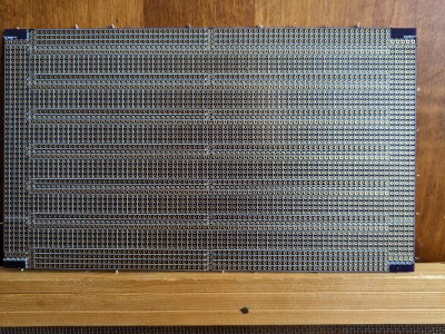

File comment: Initial stacking breadboard design -- what OSH Park produced.
--Mark

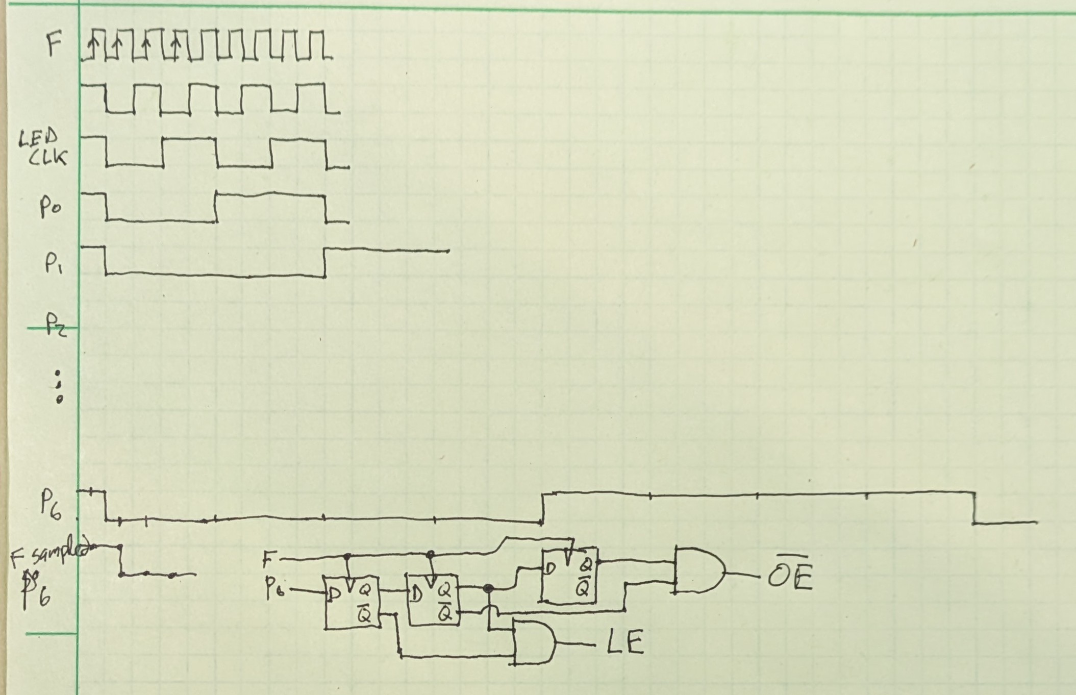

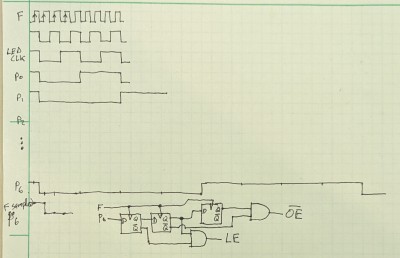

Update 2023-08-28: LED panel timing circuit
Looking at the back of my LED 128x64 RGB panel, I see the critical chip type is labeled ICND2038S. Google search gave this data sheet:
[url]https://olympianled.com/wp-content/uploads/2021/05/ICND2038S_datasheet_EN_2020_V1.6.pdf
[/url]
ICN2038.pdf [1.46 MiB]
Downloaded 37 times
This is written in a fairly confusing way, but gives some good hints and min/max specs. Playing with driving the panel, I came up with the following timing circuit that works great:
File comment: LED panel timing diagram and circuit
The idea is to clock in 128 pairs of pixel data (two pixels in two rows are loaded per clock pulse), then, while the clock pulse is low just after this finishes, generate a positive latch pulse and a positive output enable pulse (OE is active low, but latches with a positive pulse). So there is a kind of double latching sequence going on. The neat things about this timing circuit are: 1) it does not require any timing gap between transmitting double rows, and 2) it uses only two chips (in the context of having the power-of-two set of clocks from the clock module) – a 74F175 acting as a serial-in-parallel-out shift register, with positive and inverted outputs, and a 74F08 positive AND gate. The use of the flip flop to sample the MSB pixel count signal serves to grab the count signal at a safe/stable point in time, not right at the count signal edge in other words.
Here is the result in action, using some power-of-two clock signals as pixel data to get some color patterns. This timing circuit updates cleanly and correctly when I switch the input data, such as hooking one of the color inputs to 5v or ground.
File comment: LED panel timing circuit in action with test pattern
My next step is to get data during phi2 low, Apple ][ style. This will involve some surgery to switch the RAM’s address/data/control lines back and forth between the CPU and the video every phase of phi2, likely with a bit of delay/lag needed since the W65C05S needs 10ns beyond phi2 going low. My NVRAM, when powered, is equivalent to a 25ns SRAM, so I’ve got some timing margin to work with. I obtained some impressive-on-paper fast FET bus switches (both 2:1 and 1:1 styles). We’ll see how those work out.
--Mark
