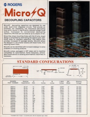

Without any planes, just make the connection as short as possible. If the power and ground pins are on opposite corners (oh why oh why did they do that? How could it not have crossed their minds that logic would be getting a lot faster?!), the shortest route is diagonally, under the IC. It won't matter where the capacitor is along that diagonal connection, ie, whether the longer wire or trace is on the Vcc side or the ground side. However, the best is what is shown on this brochure's front page which I just now scanned from 1985, before SMT took hold:
It's pretty self-explanatory, so I'll leave it at that.
