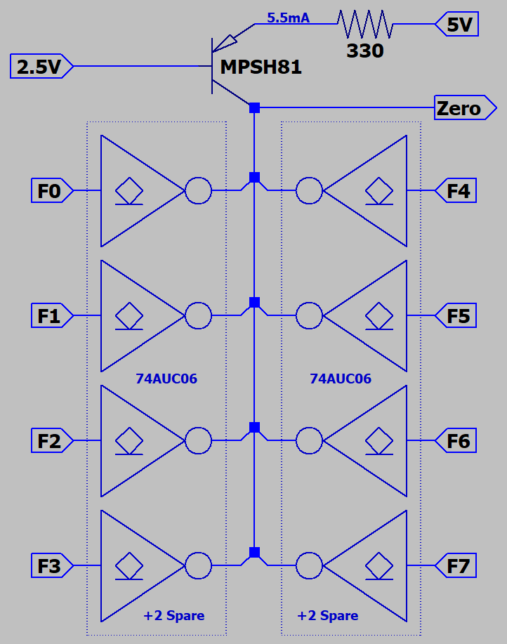

PostPosted: Wed Oct 04, 2023 5:35 pm
Joined: Fri Sep 22, 2023 9:42 am
Posts: 34
Lookahead tree for logic Zero is Karnaugh then NOR8.
Can't make any simpler than straightforward solving.
Greatest problem, no part offers wide enough NOR.
Open drain 74AUC2G06 loaded with current mirror?
PostPosted: Thu Oct 05, 2023 10:06 pm
Posts: 34
No clue if this NotZero could actually work.
Throwing stuff at ceiling to see what sticks.
Obviously NOR style Zero using inverters would be preferable.
Trouble is finding a good enough PNP.
I've tried KSP10 before. Impressive NPN.
Replacement for gold doped MSP10 I think.
Tried as 10MHz DTL, never as Widlar mirror.
650MHz is FT unity gain bandwidth, not
saying the mirror will work as imagined.
Maybe doesn't need mirror, just a -12V rail?
Ground KSP10 base. Pull emitter toward -12V
using emitter resistor that sets the current.
Steal -12V from a MAX232 or something...
-edit- Simpler is better, 600MHz PNP found.
Might throw RF suppressor bead on the base.
