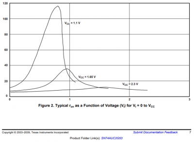

Let me be more specific: I don't believe AUC2G53 transmission gates provide best propagation.
Totally on-board with AUC as combinatorial logic, but the transmission gates don't benefit from
triple output totem with diodes and feedbacks. Gate drives maybe, not what is passed through.
Not enough Volts for N to pass logic true, too much P-CH capacitance to fake for the lack of it.
This is the Elmo I don't believe. Measure obvious design flaw and conclude it'll never work.
Analog ring oscillator might not be best use case for AUC's totem or transmission gates.
You also know the pass resistance isn't linear, and highest around the middling voltages.
Was a worthwhile experiment, but not one that proved everything concluded from it.
Look back my AUC drawings and the 1G66 transmission gates are tripled up to better handle
the load of XOR gates. RC in parallel with RC is no faster, its about those loads along the way.
Can't make the smallest XOR gate input any smaller than it is. Instead bond a 3x fatter chain.
I already believed and feared Elmo, just not enough to shave my head and light tea candles.
CBT, with about 2 Volts more on N pass gate than the signal passing under it are a better option.
VDD7V works (probably not for all, but all I've tried) I doubt even these are good as it might get.
We need to look at discreet pass transistors, but I'm OK with CBT for now.
Doubled, tripled, or quadrupled driver at the head of the chain are good advice, but was already
doing that. Last drawing you will see 2.5 ohms for 5ohm, my way of not cluttering the drawing
while implying that two 5ohm gates work in parallel. Even less with the VDD7V trick.
Now update me on the CLA plan for handling decimals. Series chain provides no easy answer.
To have reached a point in life where thinking in decimal makes my head hurt...

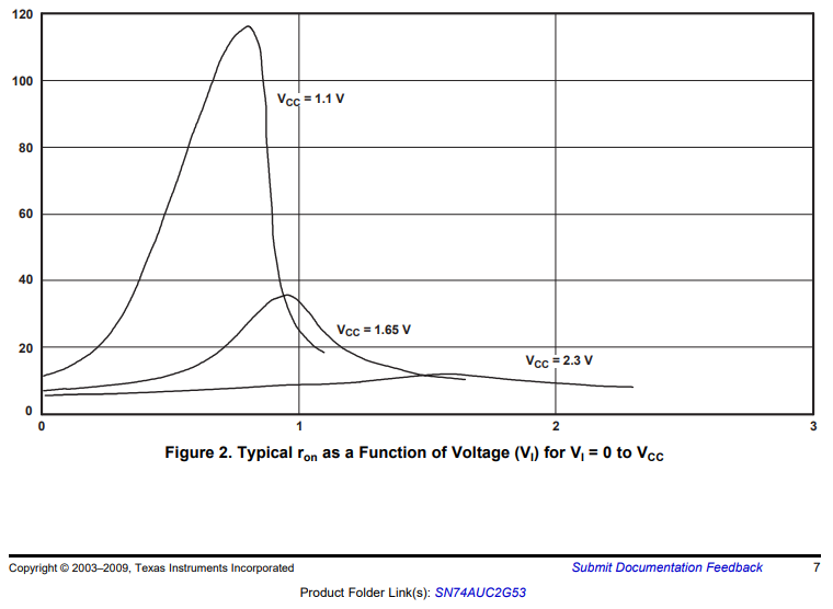

"As you can see, the Rdson is growing exponentially with the supply voltage"
No. Supply voltage was a constant 5V for that graph. Sais so at the bottom.
You are reading the graph entirely inside out.
Resistance rises with the voltage in the channel, not on the gate.
Resistance I've measured. <3 Ohms passing 3.3V under CBT VDD7V.
Got the idea to try 7V from capacitive charge pumped SN74CB3Q3253.
Doubles a 3.5V supply to 7 internal volts, and N passes with low ohms.
I would use as-is, but the pump has a 20megaswitch/sec power limit.

Neither LVC or AUC look much like your theoretical figure 2-4.
Not sure what logic family inspired that graph with a mid dip.
Can't be HC we were looking at, resistance too low to be HC.
TMUX, CB3Q? Something boasting more VGates than 4.5V
TMUX offering greater voltage do not offer fast switching.
Seem more concerned with balancing out charge injection.
CB3Q does switch plenty fast, just can't switch very often.
LVC and CBT may offer best pass-between or pass-under.
