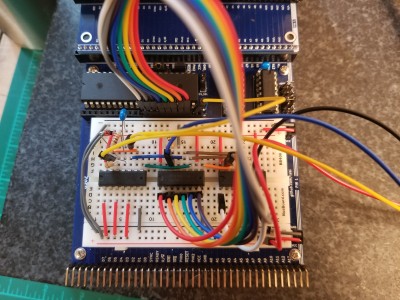

Here is my breadboard circuit:
It works great! As I mentioned up thread, it's pretty close to identical with the one from Ben Eater's video. If you're interested, I can sketch a schematic, or point you to the video, etc., but I mostly include the photo just to show the wiring - bit loopy data lines, long unshielded wires from the PS2 connector (that's what's going off the right side of the frame) and so on. This seems to run indefinitely with no errors.

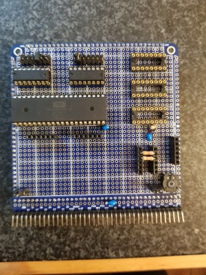

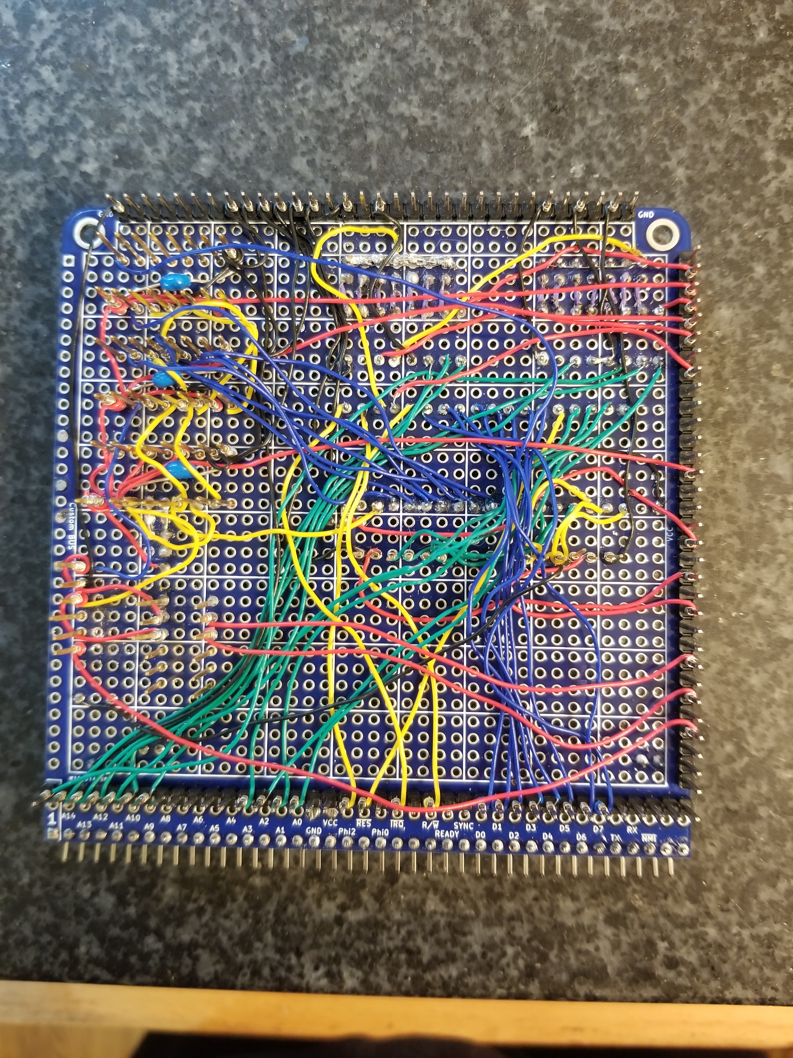

Since that was so, I thought now would be a good time to add it to my custom I/O card that holds my LCD circuit. Here it is:
The LCD plugs in just under the VIA on the left.
It... kinda works. The good part is, adding the PS2 stuff to the board did not make the LCD stuff that was already there stop working. I don't expect anyone to try and analyze that rat's-nest of wiring, I'm just posting it so you can see my technique (or lack of it!).
So, what's happening is, the keyboard circuit does work. When I push down the spacebar, I get a space... usually! But sometimes I get a random character. This is what happened on the breadboard circuit before I added the pullup resister on the data line. I've poked around with my multimeter and everything to do with the data line seems to be hooked up the right way. The other thing is that my voltage regulator (LM7805) is now getting REALLY hot. It wasn't doing that before, so something must be wrong with my power network. I'm not sure what though; there don't seem to be any shorts.
What I'm wondering here is, how to troubleshoot this with just a multimeter?

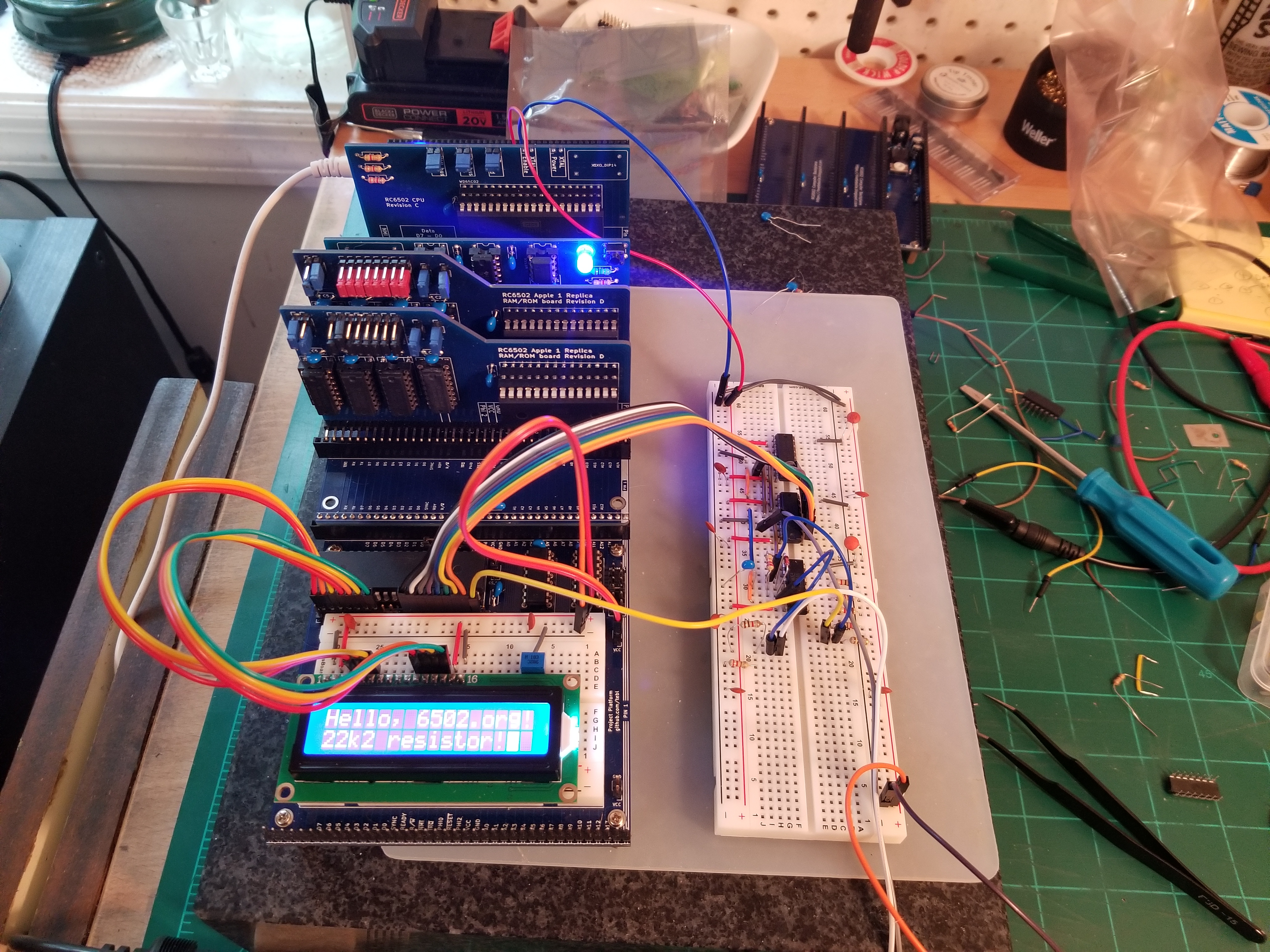

Here's another picture for Chad. :P
I don't seem to be able to be both operational and tidy. That big mess is working great at 8Mhz. My continuing mission uncovered a whole comedy of errors... wrong resistor value, wrong capacitor value, (both of these off by an order of magnitude), a crucial capacitor connected to VCC instead of GND (!) - yikes.
The really critical bit, though, that made it work without errors was altering the design slightly. I had to reduce the value of the resistor in the RC circuit from 3k3 to 2k2 to eliminate the intermittent errors I was getting. I was getting the right number of pulses, but they didn't always line up with the data, so I was getting garbled scancodes every so often. I did not do any math to figure out the resistor size, I am slightly embarrassed to say; I just grabbed my big ammo-pack book of resistors and applied the good old "cut 'n try" method. :D
I think that maybe the reason I had to reduce the resistor size is that I'm using 74AHCT logic instead of the 74HC logic in Ben Eater's reference design.
Thanks for the picture :) It looks like a nice setup honestly. I like how you have a backplane to plug modules into, and out of. I have never used one, but it seems handy.
Is that breadboard that the LCD is attached to itself attached to the backplane?
This is my greatest failing personally. Little resistor values that change big things. I, like you, just "wing it" when it comes to those sorts of things. 3k3 for anything connected to control lines on the 6502, 4k7 for anything on an address bus (basically banked RAM with a VIA), and 10k for slow things like keyboards and whatnot. I have no clue if that is good or not, but it has worked so far!
Why are you using the 74AHCT logic in particular? Perhaps the fast edges were not happy with the 3k3 resistor, but ok with the 2k2 resistor?
It's coming along well! So what's next on the to-do list? :)
Chad
