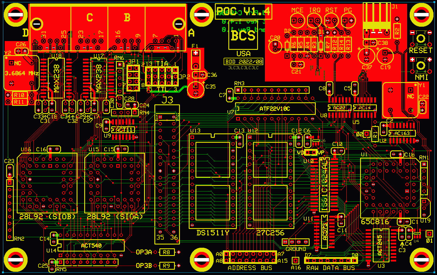

Here again are the schematic and PCB layout for the unit:
File comment: POC V1.4 Schematic

File comment: POC V1.4 PCB

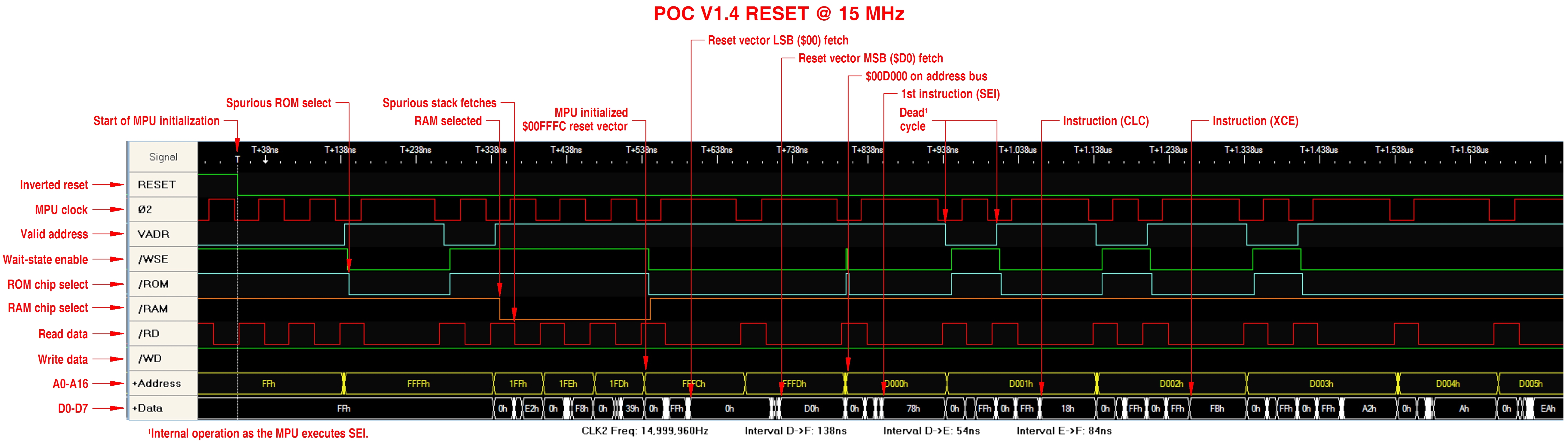

Meanwhile, back to the Ø2 ceiling.  Below is an annotated logic analyzer trace of V1.4 coming up at 15 MHz:
File comment: POC V1.4 Boot @ 15 MHz
At that speed, everything appears to be copacetic, and in fact, periodic sampling of bus activity showed that the 65C816 was merrily working its way through a loop full of NOPs.

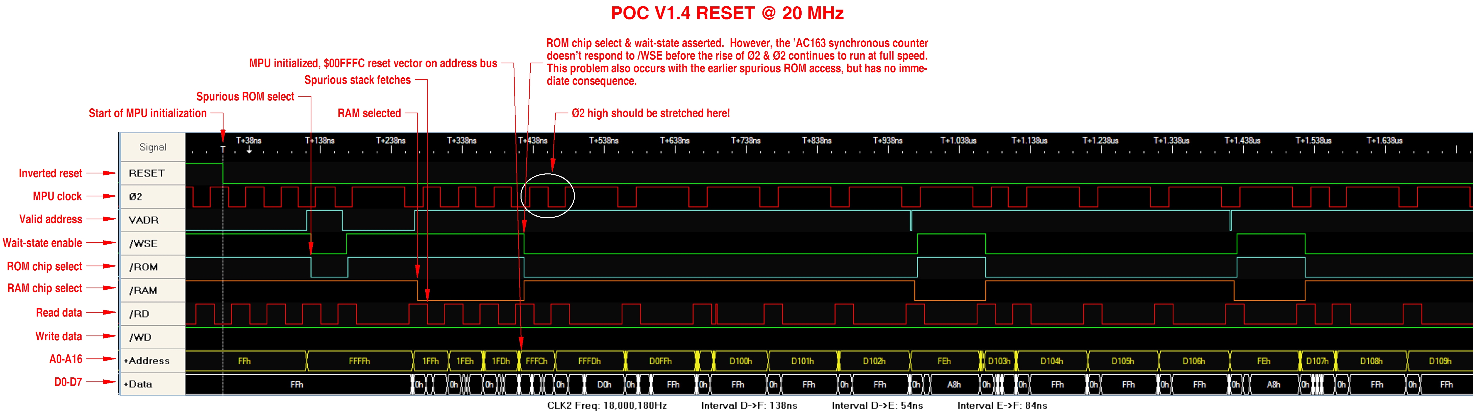

Now, here is another trace, this one of V1.4 coming up at 20 MHz:
File comment: POC V1.4 Boot @ 20 MHz
This time, the train goes into the ditch as soon as the MPU places the reset vector address ($00FFFC) on the bus.  The 74AC163 counter fails to react in time to /WSE (wait-state enable) being asserted and Ø2 continues to run at full speed for another cycle.  The ROM can’t keep up, the MPU gets a garbage address and it’s all down hill after that.  Adding to the fun, the AC163 does finally respond to /WSE during the low phase of the next clock cycle, definitely a case of locking the barn doors after the cows have wandered off.
As a harbinger of things to come, note system behavior when the spurious ROM select occurs as the MPU is going through initialization following the clearing of reset (three cycles after reset clears).  The AC163’s behavior is identical to what happens when the MPU is finally ready.  Clearly there is a timing issue involving the AC163 and how quickly it can react when /WSE is asserted.  My analysis may be off to some degree and I fully expect attempts to shoot big holes in it.  :D  But, here goes...
POC V1.2 was the first unit in which I used the AC163 as a clock source.  You may recall that it was an exact adaption of Jeff’s clock-stretching circuit described here (in fact, he built the module for me).  V1.2 was stable at 20 MHz, although a more detailed look at things now indicates the AC163 I used in that unit was punching well above its weight class.  In any case, there was no extended RAM in that unit, which made the glue logic less complex than later units, with a correspondingly-reduced prop delay.  The glue logic could assert /WSE more rapidly, which when combined with an AC163 running substantially better than specs, made it work.
According to the AC163 data sheet, tsu, which is the required setup time for the A through D inputs before the clock input goes high, is 4.4ns minimum, operating on 5 volts and anywhere within the commercial temperature range.  That is, as long as an A-D input is stable at least 4.4ns before the rise of the clock, things will work.  That timing margin seems manageable until you consider that tsu is relative to the 40 MHz oscillator driving the clock input.  In other words, the 4.4ns minimum is relative to the 12.5ns half-cycle period of the oscillator.  At that speed, the timing margin available to satisfy tsu would be 12.5 - 4.4 or 8.1ns.  So at first blush, it would appear things ought to work.
In this application, the AC163’s B input is controlled by /WSE, the latter which is generated by the GAL.  The GAL I’m using, a Microchip ATF22V10C, is rated at 7.5ns tpd pin-to-pin.  All logic in the GAL is combinatorial, so the worst-case prop delay from when the MPU does something until the GAL’s outputs reflect the change will be 7.5ns.  That would seem to be within the previously-quoted 8.1ns margin available to meet tsu.  However, here comes the “gotcha”...several of them, actually.  :twisted:
The MPU is running at 20 MHz, not 40, which means the GAL is reacting to events that occupy two oscillator cycles, not one.  That 8.1ns margin I earlier mentioned is relative to the 40 MHz half-cycle period, which is 12.5ns.  The Ø2 half-cycle period is 25ns, which effectively makes the 8.1ns look like 4.05ns for timing purposes.  The GAL can’t respond in 4ns, so it is unable to assert /WSE quickly enough to meet the tsu deadline.
Above, I said there were several “gotchas.”  The other one, which appears to be the final nail in the coffin, is the AC163’s tpd, which is the prop time from when the (oscillator) clock goes high until a change is seen at any Q output.  The worst-case for tpd running on 5 volts is 9.4ns.  The logic analyzer says the AC163 in V1.4 is running right around 6ns—“punching above its weight class.”  Hence a Ø2 phase change lags an oscillator cycle by a more-or-less constant 6ns, which further messes up timing.
Given what I’ve learned from this, I’m less confident in the synchronous counter method of generating a stretchable clock, at least in a circuit that is intended to run faster than 15 MHz.  The logic analyzer traces show that while the GAL can quickly assert /WSE in response to the address on the bus, the timing is too skewed relative to the oscillator to be reliable at high speeds.  At 15 MHz, the GAL in V1.4 takes only 4ns from the time the MPU drives the address bus until /WSE is asserted.  Unfortunately, that looks like 8ns from the perspective of the AC163, since its timing is slaved to the oscillator’s signal, not Ø2.  The 6ns skew from the oscillator to Ø2 aggravates the situation by making it look like 14ns to the AC163.  Hence the results.
It looks like it’s back to the metaphoric drawing board.  :roll:

PostPosted: Tue Nov 22, 2022 9:33 am
Hmm, I don't understand this bit:
> The MPU is running at 20 MHz, not 40, which means the GAL is reacting to events that occupy two oscillator cycles, not one. That 8.1ns margin is based upon the 40 MHz half-cycle period, which is 12.5ns. The Ø2 half-cycle period is 25ns, which effectively makes the 8.1ns look like 4.05ns.
I wonder, is there another way to describe this, or draw it out?
PostPosted: Tue Nov 22, 2022 11:10 am
Posts: 166
I think the extra piece of the puzzle is the propagation delay from 74AC163 clock high to processor PHI2 low.
From your schematic the worst case timing path is as follows:
(i) 74AC163 clock high to QD low
(ii) 65C816 PHI2 low to address valid
(iii) 74AC573 input to output propagation (for A16)
(iv) 22V10 input to output propagation (An to WSE)
(v) 74AC163 setup time B valid to clock high
From the data sheets (or reasonable guesses) these values are (typical, worst case):
(i)    5.5     9.5
(ii)  10.0    15.0
(iii)  5.5     7.5
(iv)   4.4     7.5
(v)    4.0    10.5
Tot   29.4    50.0
So your circuit's typical max frequency is 1/29.4ns which is ~34MHz, so 17MHz CPU clock.
Worst case timings give max frequency 1/50ns = 20MHz, so 10MHz CPU clock.
My suggestion would be to use a CPLD and try to put everything - the clock divider, clock stretch logic and address decoding on there.
PostPosted: Tue Nov 22, 2022 11:12 am
Posts: 8504
Hmm, I don’t understand this bit:
It is kind of hard to explain clearly. I’m reasonably confident I understand what’s going on, but seem to be having difficulty articulating it.
Since the AC163 looks like a D-flop the way it is connected, its QD output, from which Ø2 is derived, makes one transition for every two low-to-high transitions at the clock input. Under normal operation, the A-D inputs are held high, and Ø2 is one-half the frequency of the oscillator, with a 50 percent duty cycle. When the B input is driven low while QD is low (corresponding to Ø2 low), the next low-to-high clock transition will cause QD to go high and remain so until two more low-to-high clock transitions occur, this being due to the AC163 being a counter, not just a bunch of flops. Hence the clock is stretched by one Ø2 cycle. That’s the easy part. :D
The tricky part is in driving B low at the right time relative to both Ø2 and the clock input. All timing in the AC163 is measured relative to the clock input only. There are two things at work here: tSU, which is the A-D input setup time before the clock goes high, and tPD, which is the elapsed time from when the clock goes high to when the Q outputs change state.
Since two full clock input cycles are needed to produce one unstretched Ø2 cycle, timing from the perspective of the GAL, which is responding to address bus transitions occurring at Ø2 speeds, is effectively tSU ÷ 2, not tSU. When that is coupled with tPD, tSU effectively becomes tSU ÷ 2 - tPD.
tSU and tPD, of course, will vary from part to part. While tSU will never be worse than the minimum specified in the data sheet and therefore can be thought of as a constant for timing purposes, tPD can be as slow as 15ns or as fast as 4.2ns. Such a wide range makes it hard to predict how well the AC163 will work in a given timing scenario.
Did this explanation make more sense?
PostPosted: Tue Nov 22, 2022 11:47 am
Posts: 166
Or, another possibility is to use RDY for wait states instead of clock stretching. That gives an extra half cycle for the circuit to figure out if wait states are needed, at the expense of a more complicated circuit to generate the bank latch enable signal.
PostPosted: Tue Nov 22, 2022 12:01 pm
Posts: 8504
Did you read all of my write-up? I did describe how the 163’s tPD skews Ø2 relative to the oscillator.
That is a wide range. The TI data sheet I have says anywhere from 4.2ns to 15ns on 5 volts over the full commercial temperature range.
The 816 I’m using in V1.4 is consistently driving the address 12ns after the fall of Ø2. I looked at analysis I did on POC 1.3 when I built it and was seeing 11ns. In general, the timings specified in the 816’s data sheet are pessimistic, and likely reflect the capabilities of the Sanyo 0.8µ cores that were used long ago (all product since around 2006 is 0.6µ).
In this particular test, that isn't a factor, since code is being executed only in bank $00. The latch’s Dx to Qx prop time only matters if Dx changes state on the next Ø2 low half-cycle.
That would be 7.5ns, worst-case. The GAL in V1.4 is running in the range of 4-6ns.
That would be 4.4ns, worst-case.
It’s unstable at 16 MHz, as I explained above.
I’m ahead of you on that. POC V2.0 uses a CPLD to implement most of that stuff.
That has been discussed at length in other topics. See here for some discussion on the foibles of using RDY, especially with the 816.
PostPosted: Tue Nov 22, 2022 1:53 pm
Posts: 166
You could get the benefit of RDY without the hassles by using a more complicated state machine for clock stretch.
Suppose you have 4 states S0-S3, S0 is the initial state. The state machine is clocked by your double-frequency oscillator.
The transitions are:
S0 always goes to S1
S1 goes to S0 if WSE is not asserted, S2 if it is
S2 always goes to S3
S3 always goes to S0
The CPU clock is high in S1, S2, S3 and low in S0.
That would give you the same clock stretching behaviour as now, but you have until the point where the unstretched clock would fall (minus a setup time) to generate the WSE signal.
This could be implemented using the AC163 plus a couple of gates:
input D = 0
inputs A,B,C = 1
QD feeds PHI2
/LOAD = !(QD & \WSE) & !QB
So the counter starts with count 7, counts up to 8 then reloads 7 if WSE is not asserted. If WSE is asserted it counts up to 9 then 10, then reloads 7, thus stretching the high phase by 2 oscillator clocks. By rejigging things a bit you might be able to put the /LOAD logic into the 22V10.
