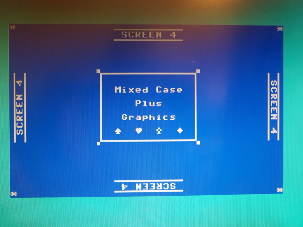

PostPosted: Fri Oct 13, 2017 7:38 am
Posts: 1429
Just another thought:
While looking at the graphical LCD at fpga4fun.com, I remembered that my D04 TTL CRT controller
(mentioned somewhere way up in this thread) was able to generate an analog video signal
while at the same time working as a LCD controller driving a 320*200 graphics LCD.
Whad had brought me to the idea of building a graphics card controlling a CRT and a LCD "in parallel"
was flipping through datasheets of LCD controller chips. One of those chips (don't remember which one)
seemed to be built around a 6845 core... and from there, I knew what to do.
Ok, so D04 doesn't _exactly_ meet the display timing specs for TV and LCD,
but it gives a nice and stable picture on both.
The picture above shows D03, the predecessor of D04.
D03 was a sandwich of two PCBs, in the picture it's plugged near the top end of the backplane.
D04 only had one PCB with a more dense layout and less chips.
But back on topic:
It's a pity, that it became pretty hard to buy LCDs _without_ a LCD controller chip already integrated.
Else, one could try to pull a similar trick when trying to build a TTL implementation of the VIC-II.

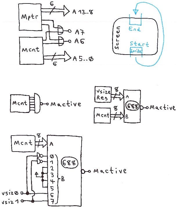

Spent some thoughts on vertically increasing the size of the sprites.
// Vertically increasing the size ain't "rocket science", but horizontally increasing the size probably is.
First, the sprite address counter Mcnt needs to be 8 Bit instead of 6 Bit.
The simplest way of address generating seems to be taking the two uppermost Bits from the now 8 Bit Mcnt
and to OR them with the two lowest Bits from the pointer that tells the VIC-II at which 64 Bytes Block
in memory a sprite starts.
Second, we would have to terminate displaying the sprite somewhere in the last raster line to be displayed
to prevent it from warping around the screen.
If one would be using two 74163 counters for implemening Mcnt, a good approach would be loading them with
the end count value. For a 24*21 sized sprite, the end count value is 63 (21 * 3 Bytes).
In the VIC-II, we seem have a 6 input NAND gate, if the counter reached 63 Mactive goes 0,
indicating that displaying this sprite is no longer active.
When having bigger sprites, two approaches which use a 74688 identity comparator instead of the NAND come to mind.
First approach compares 8 Bit Mcnt with an 8 Bit register, but since there are 8 sprites, this would take 8 registers.
Second approach uses two Bits, labeled vsiz1..0, for switching between 4 different vertical sprite sizes.
vsiz1 vsiz0| Mcnt end value | Binary Mcnt end value
  0     0  | 1*21*3 =  63   | 0011.1111
  0     1  | 2*21*3 = 126   | 0111.1110
  1     0  | 3*21*3 = 189   | 1011.1101
  1     1  | 4*21*3 = 252   | 1111.1100
BTW: one also could use SRAM and an adder instead of counters for implementing the sprite address counters,
but it would have to run at twice the PHI2 speed.
Interesting question then would be, if the ROW and COLUMN counters and the refresh counter also could be
put into that RAM.

Your 1994 design post prompted me to think about a hardware cursor, though sorry to disappoint, it's not analog.
I added a hardware cursor with variable blink rate and both block and line modes.
Decided I'm not quite done with this first design yet. I'll add an attribute bank for implementing
X-Flip, Y-Flip, Rotation and Inverse, then I'll look at the other screen window idea again.
Everything other than rotation will translate easily to TTL. Rotation would require very fast SRAMS and either TDMA or double buffering.
It'll probably take longer to draw the demo screens in PETSCII, than to add the functions to the design, I'm no artist.

PostPosted: Tue Oct 24, 2017 8:55 am
Posts: 134
I'll put this design down for a while and go investigate my original idea.
Current result bellow.
File comment: Not the best photo ever, but will have to do.
