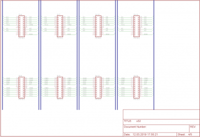

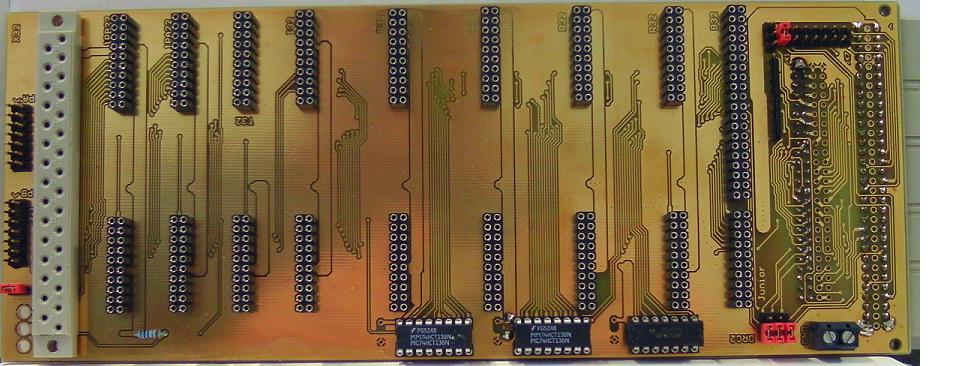

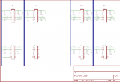

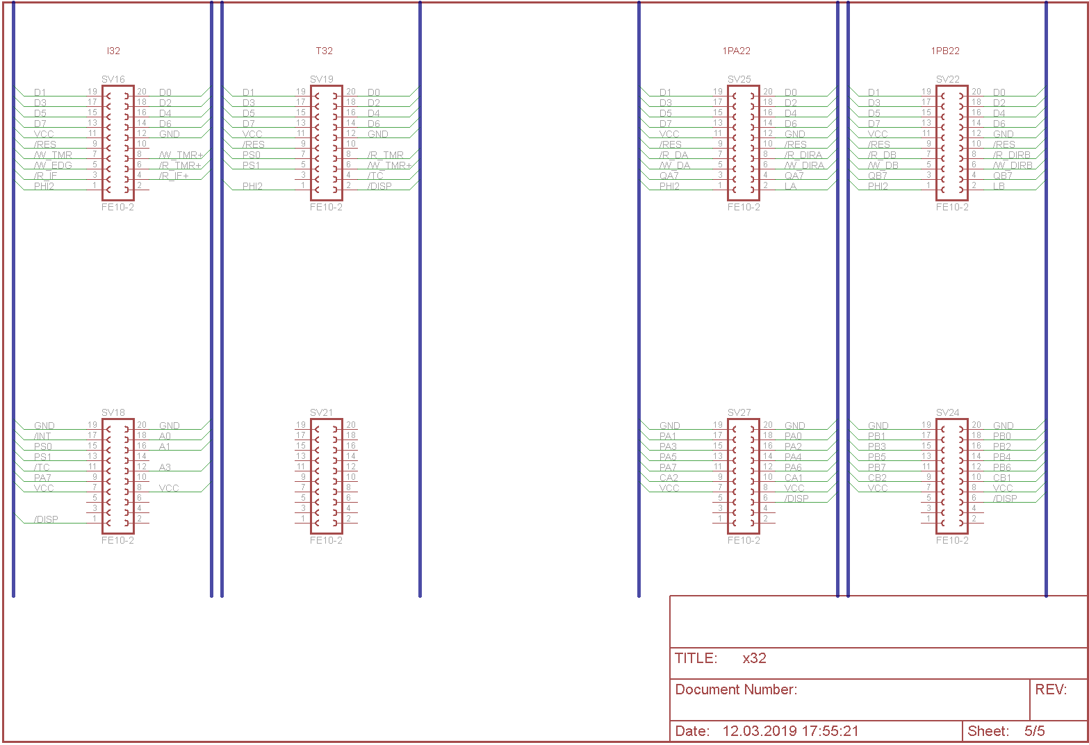

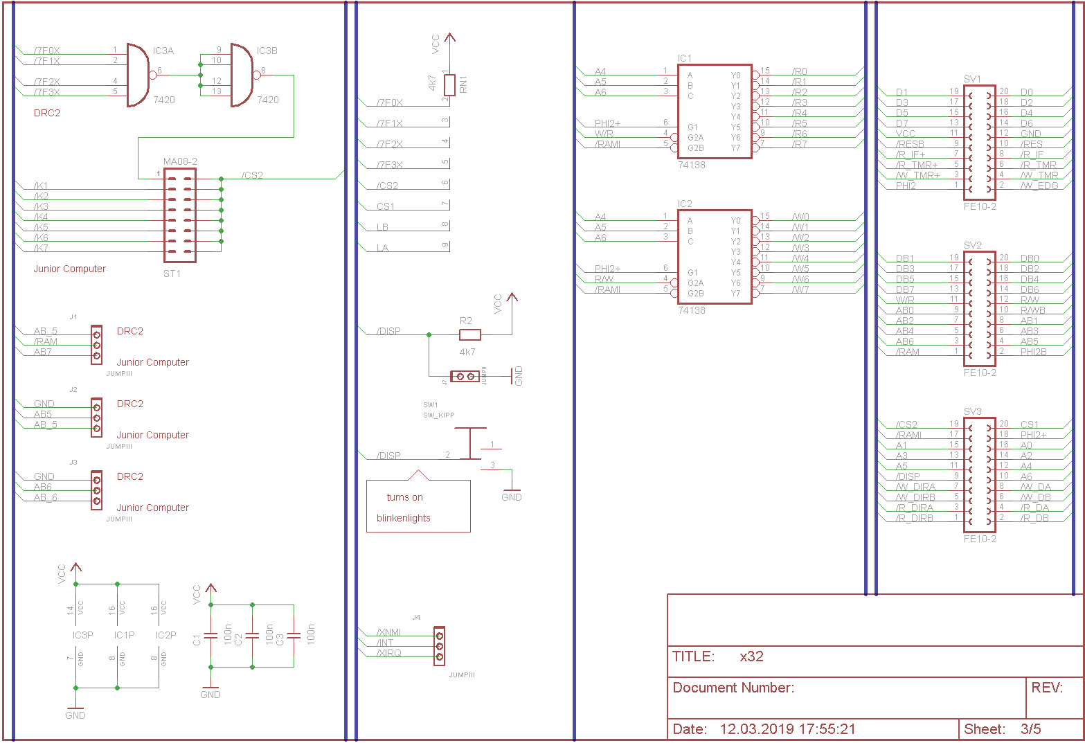

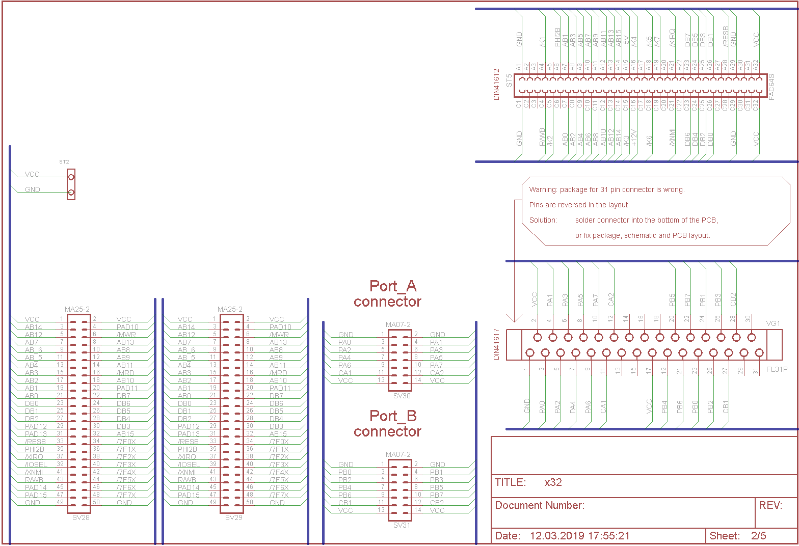

X32 backplane.
Something went wrong when making the Eagle device for that 31 pin connector at the left side of the PCB:
connector pinout seems to be reversed.
Also, one should be _very_ careful about that 64 pin Junior Computer bus connector,
because the EPROM inside the Junior Computer needs a +12V and a -5V supply voltage.
Making a mistake here could turn out to be quite expensive.

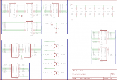

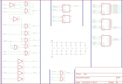

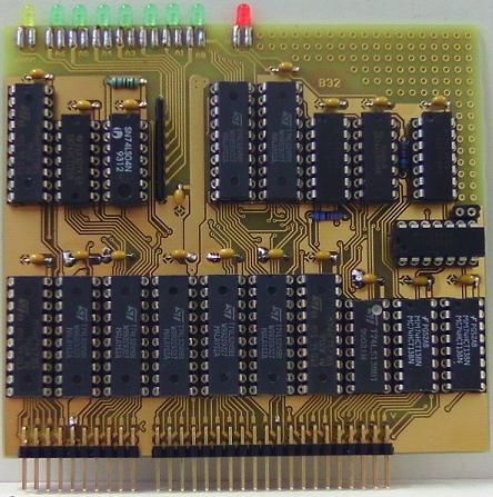

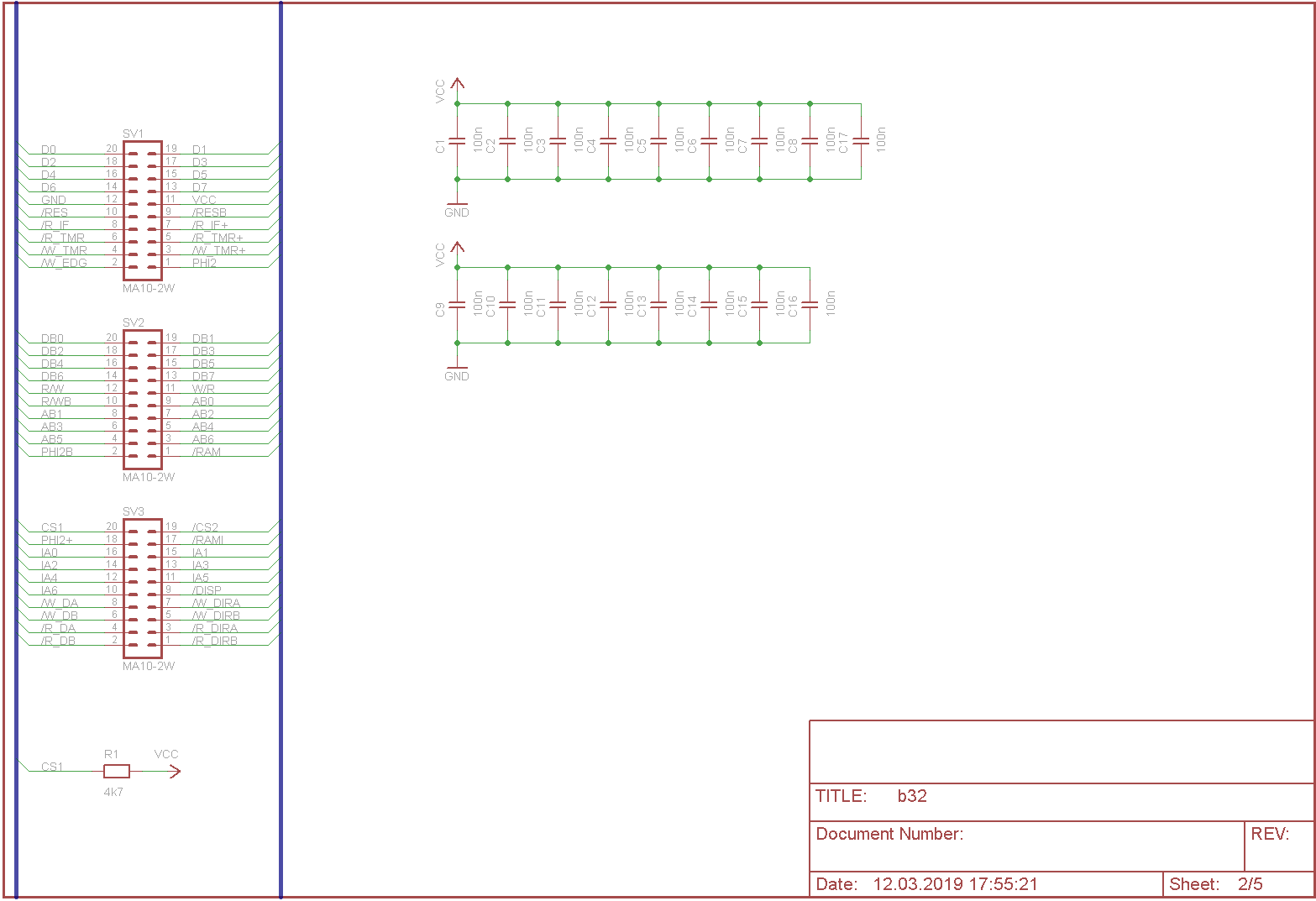

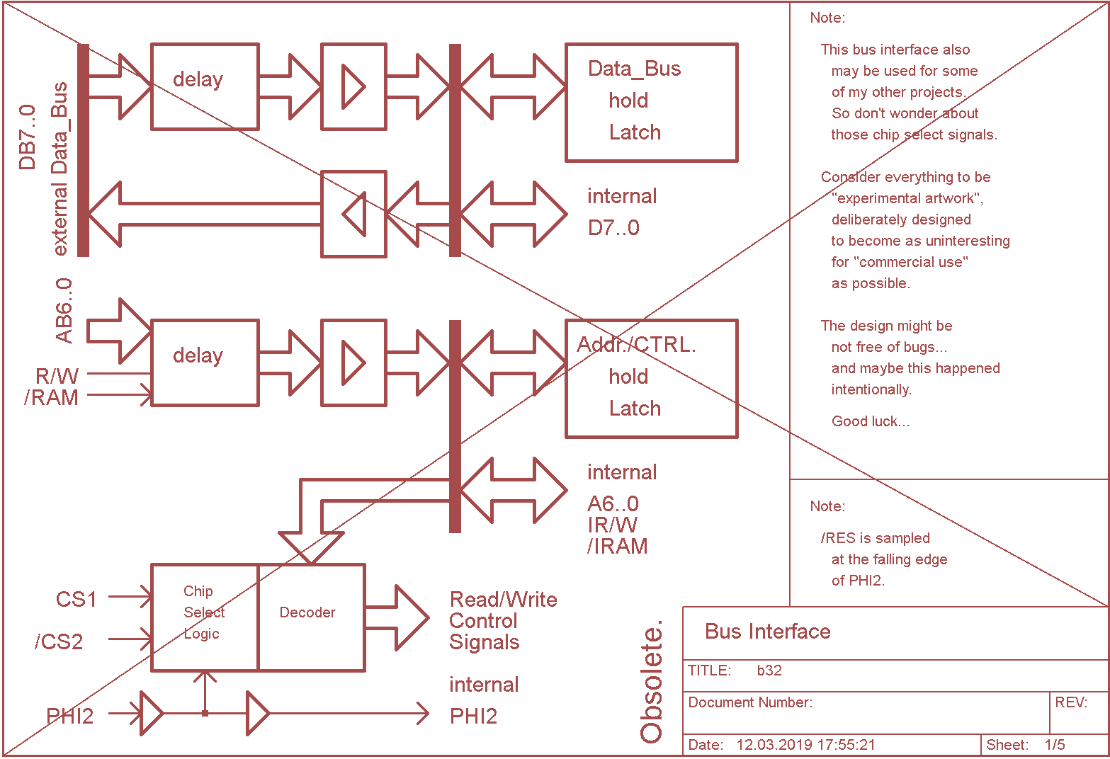

1PA22 and 1PB22 I\O ports already went described somewhere up in this thread.
B32 bus interface.

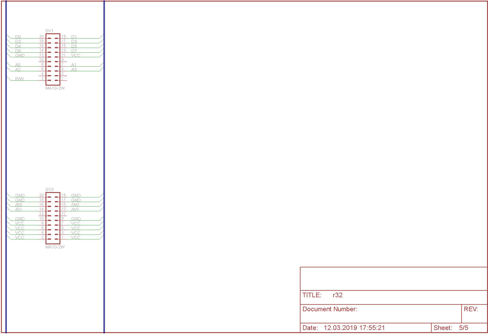

PostPosted: Sat Apr 06, 2019 12:24 pm
Posts: 1431

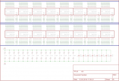

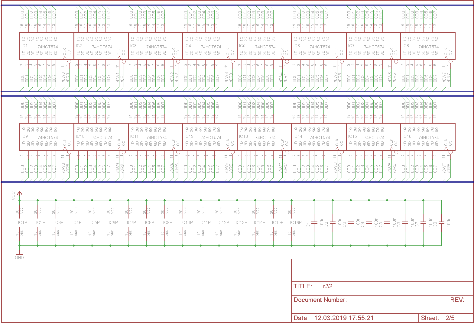

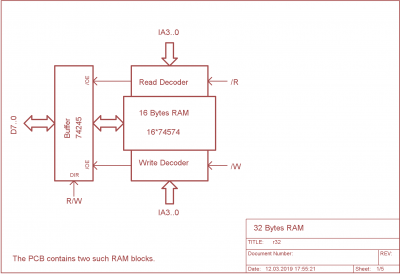

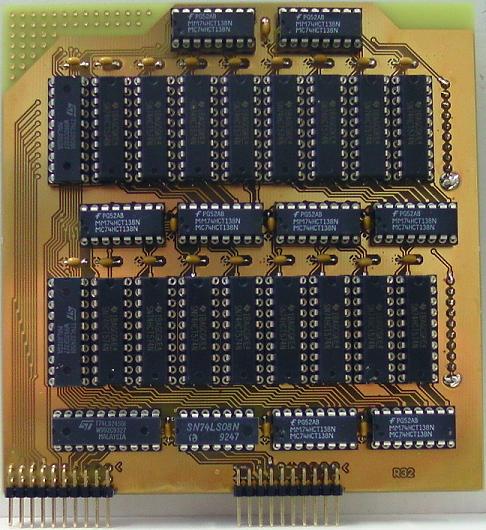

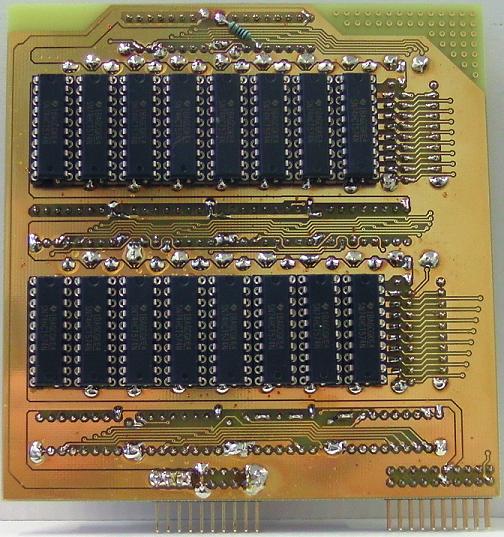

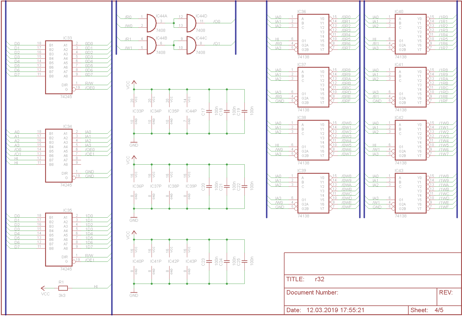

R32 module, 32 Bytes of TTL SRAM, 4 modules required (only one was built).
Top and bottom of _one_ module:
And yes, 44 chips on one PCB.

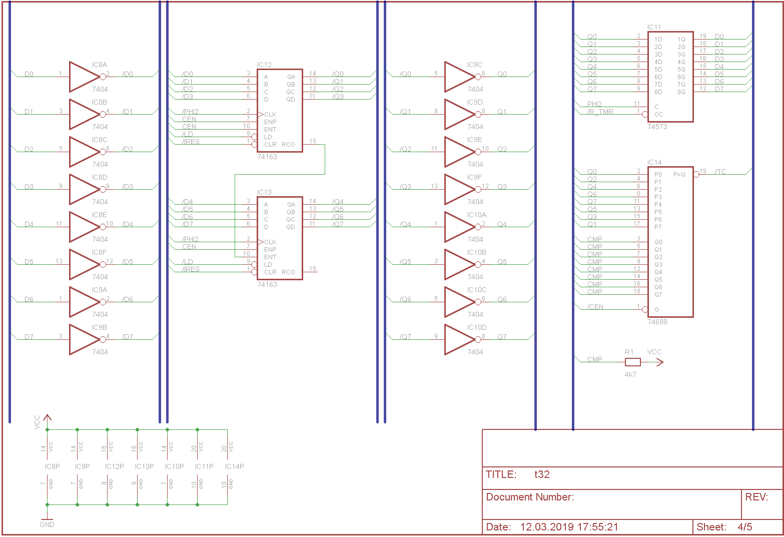

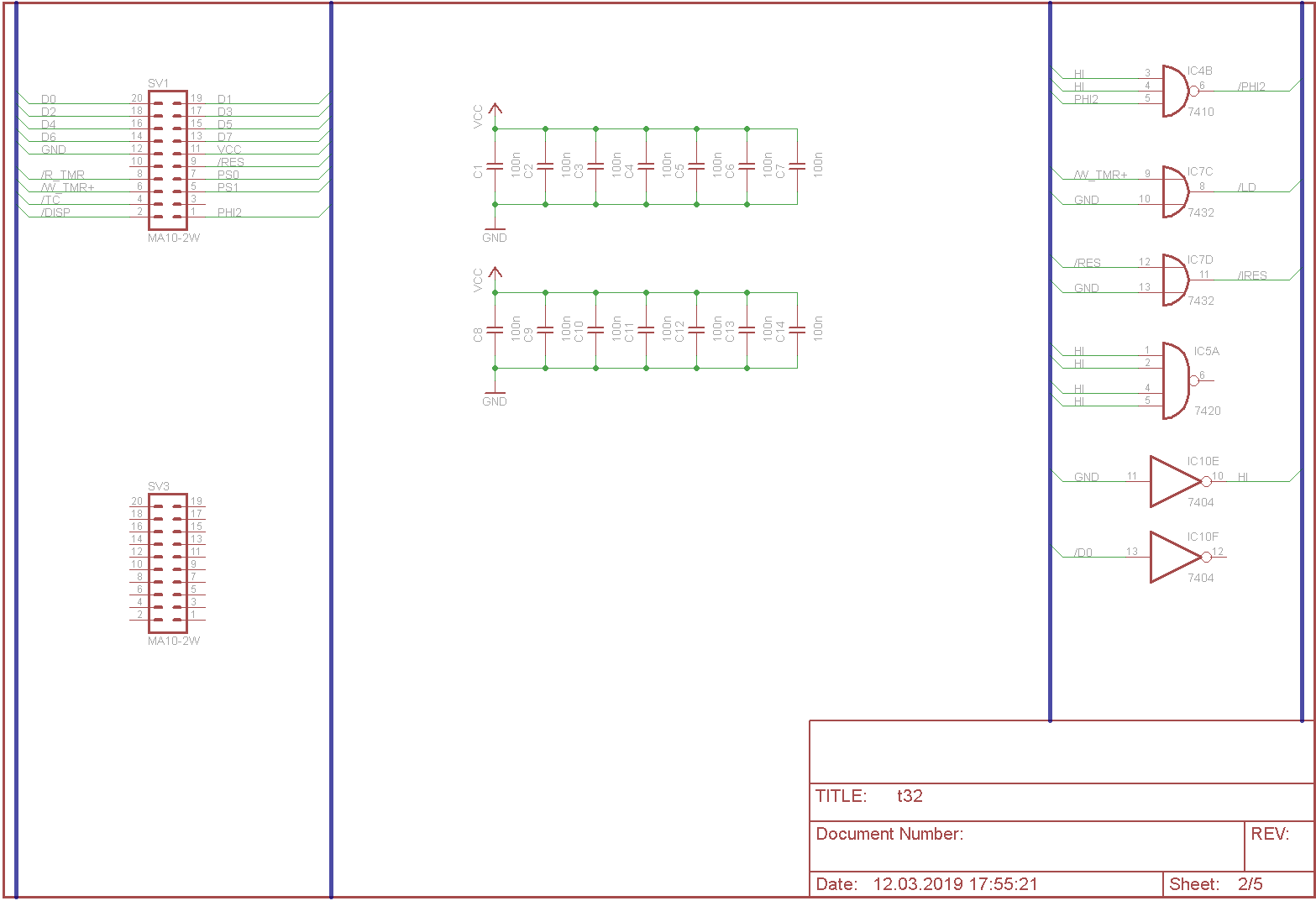

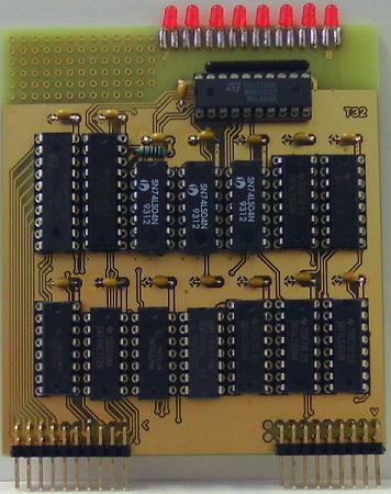

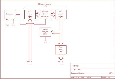

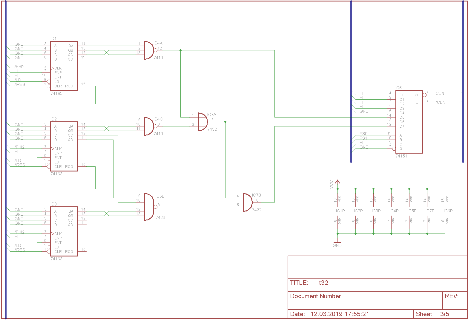

T32, 8 Bit timer with prescaler.
Bug warning: the prescaler is supposed to be set to :1 on timer overflow,
and IIRC this feature somehow is missing in T32.

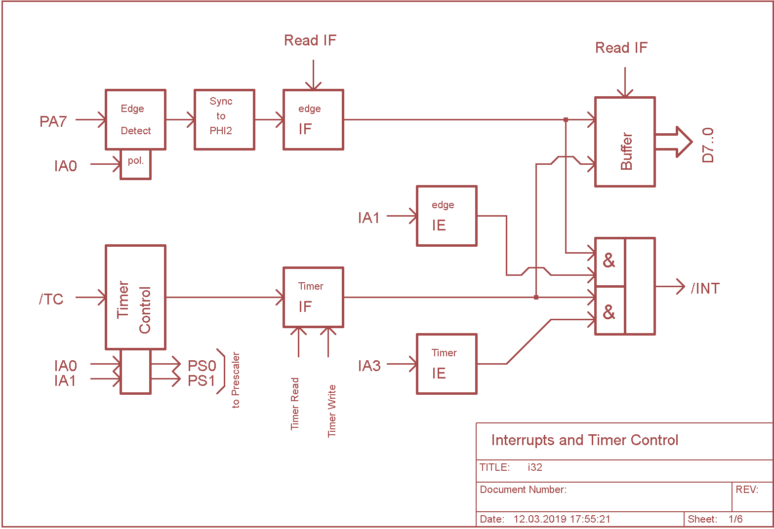

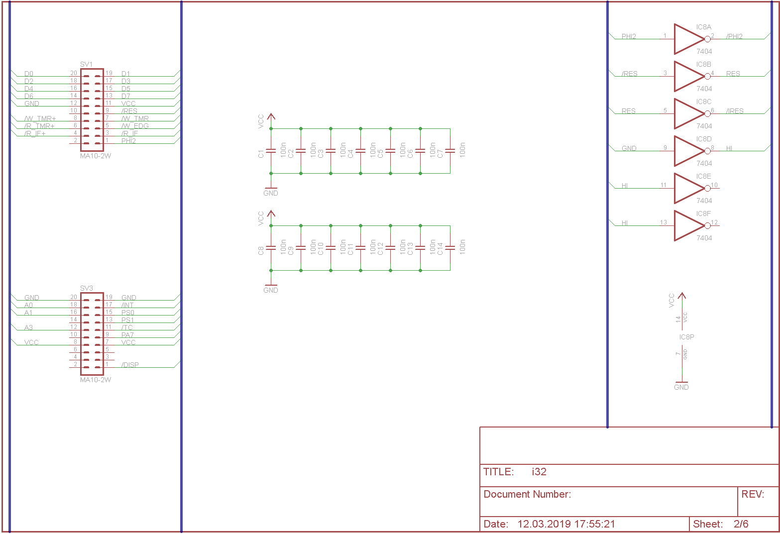

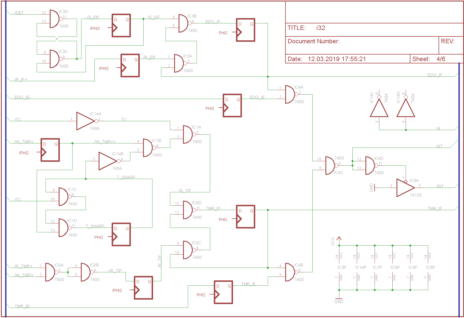

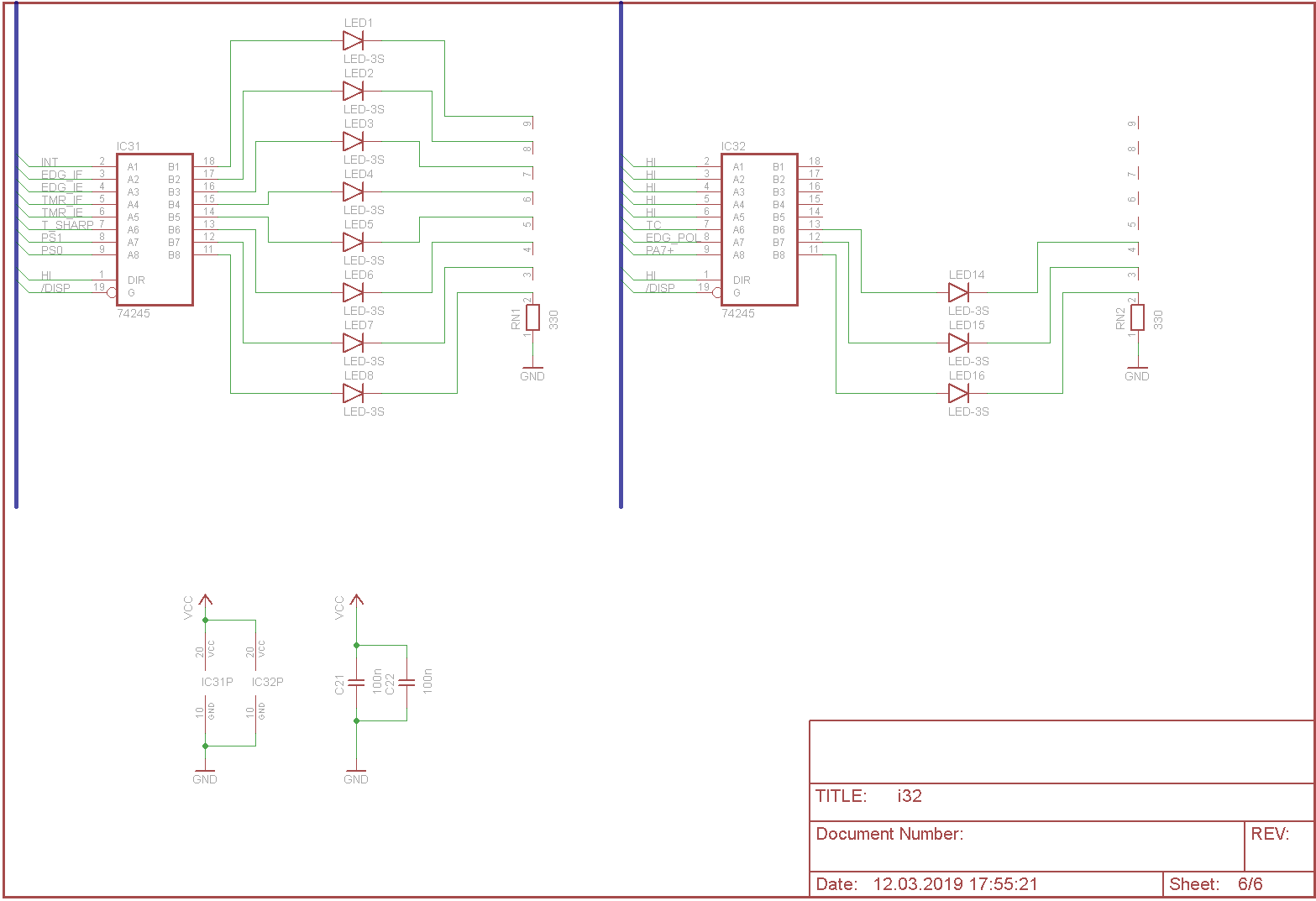

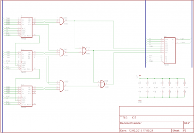

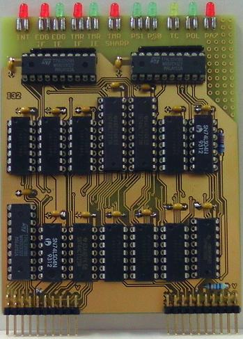

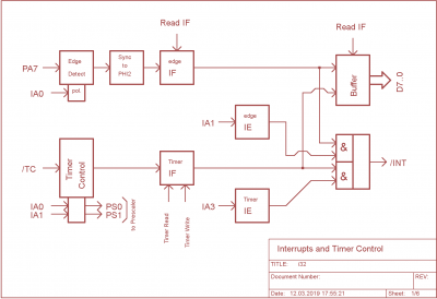

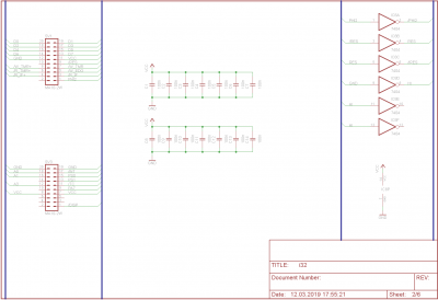

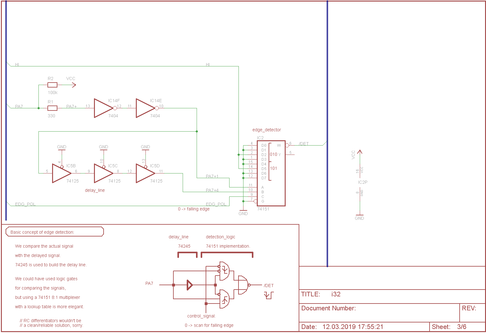

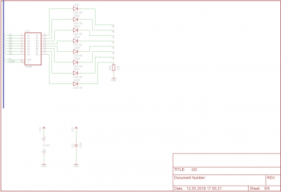

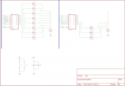

Last part: I32, timer control and interrupt module.

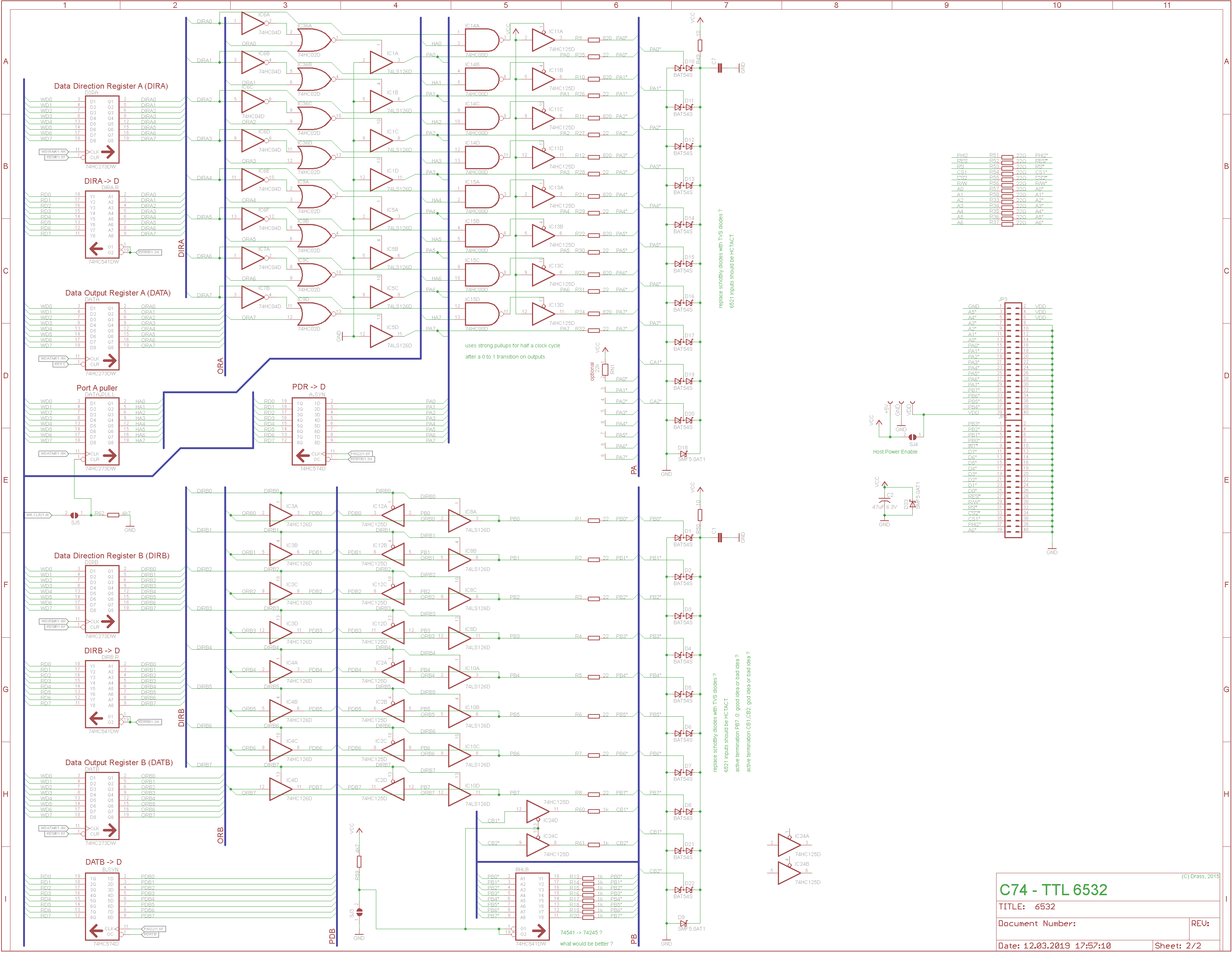

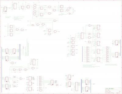

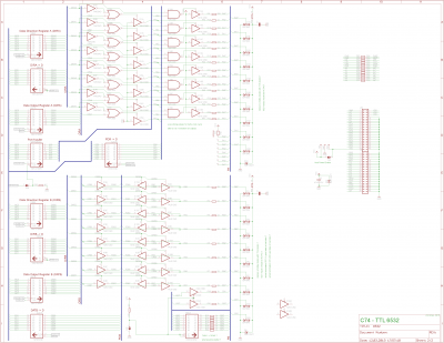

...And an obscure paper design for a 20MHz TTL 6532, which most likely won't work.
Don't ask me why the circuitry looks the way it looks, I fail to remember these details.
This design uses a real SRAM instead of TTL RAM.

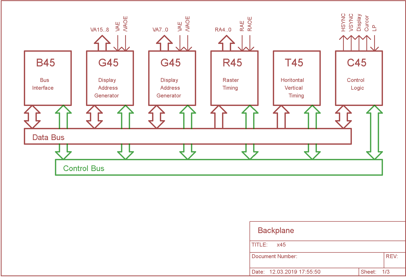

X45, experimental 6545 TTL implementation.
16 Bit video address output (instead of 14 Bit), transparent latches in the address output lines
for compensation of bus hold timing issues, and IIRC it was a three-state output.
Interlaced mode with some conceptual bugs, also sort of a horizontal scrolling mode where
one line of characters is 256 Bytes.
D45 demonstrator PCB (for generating a video signal) was plugged between the computer and the
X45 backplane.
Plugged into the X45 backplane, we have:
1* B45, bus interface
1* C45, the control module
1* T45, horizontal\vertical timing module
1* R45, raster timing module
2* G45, two video address generator modules

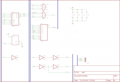

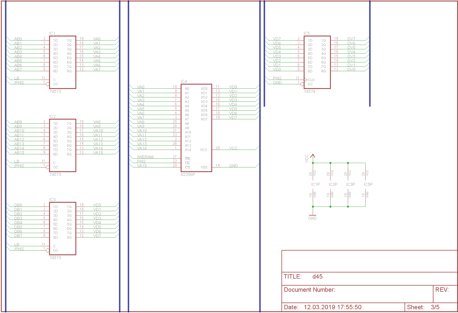

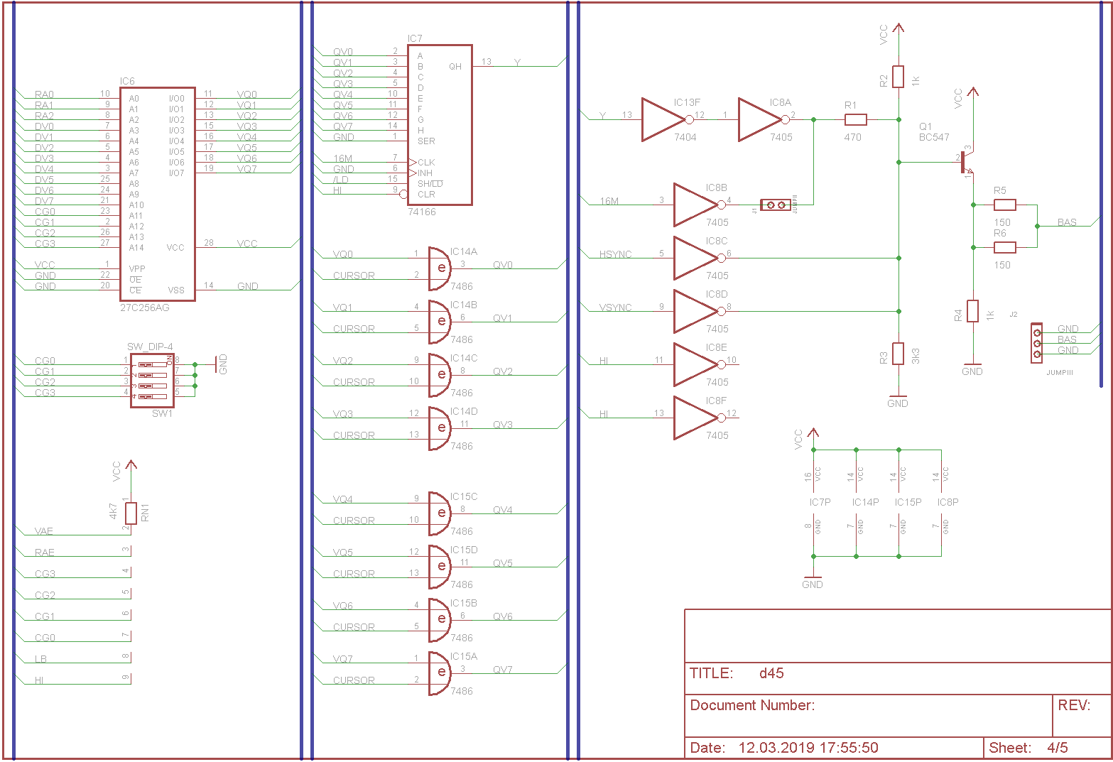

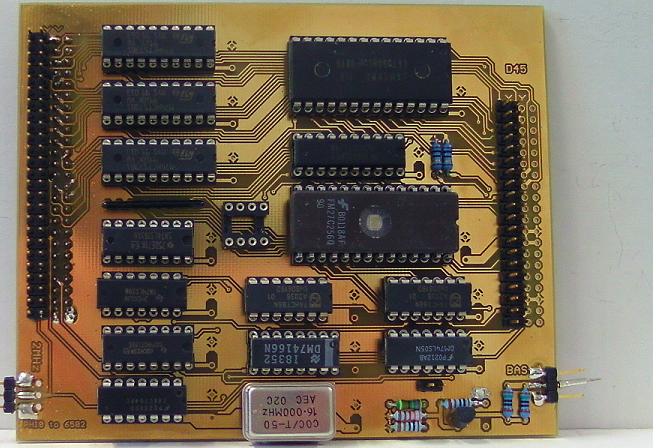

Let's start with D45, the demonstrator PCB containing the display RAM, the character ROM, the shift register etc.
80 characters per line (6502 has to run with a 2MHz clock generated by D45), monochrome analog video signal.

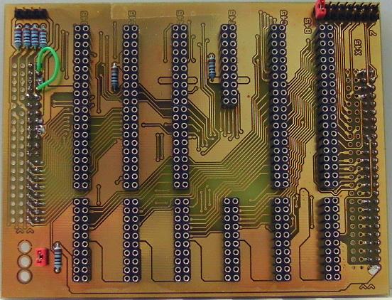

PostPosted: Sat Apr 06, 2019 1:54 pm
Posts: 1431

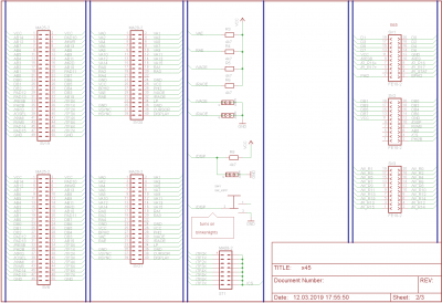

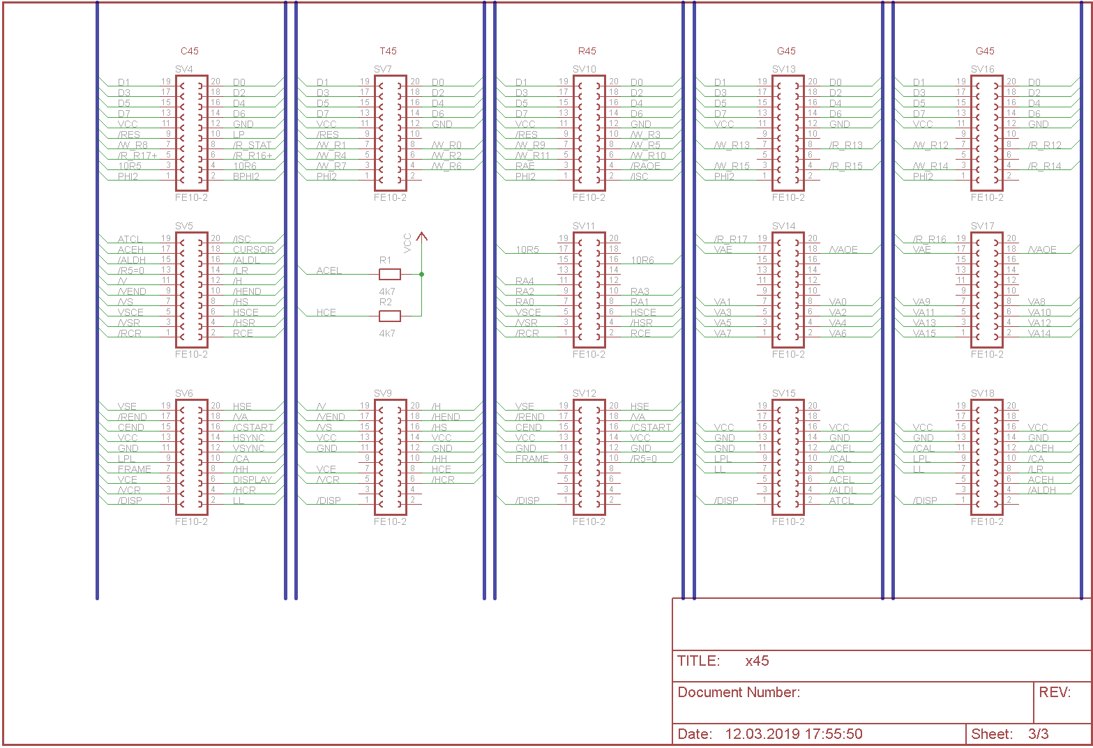

The X45 backplane.
IIRC the little green wire was added for testing the light pen registers.

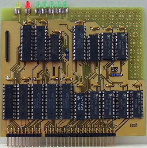

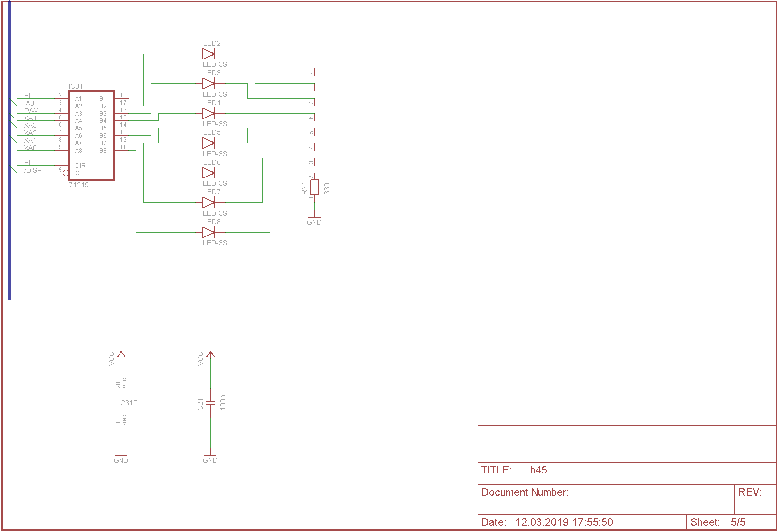

PostPosted: Sat Apr 06, 2019 1:57 pm
Posts: 1431

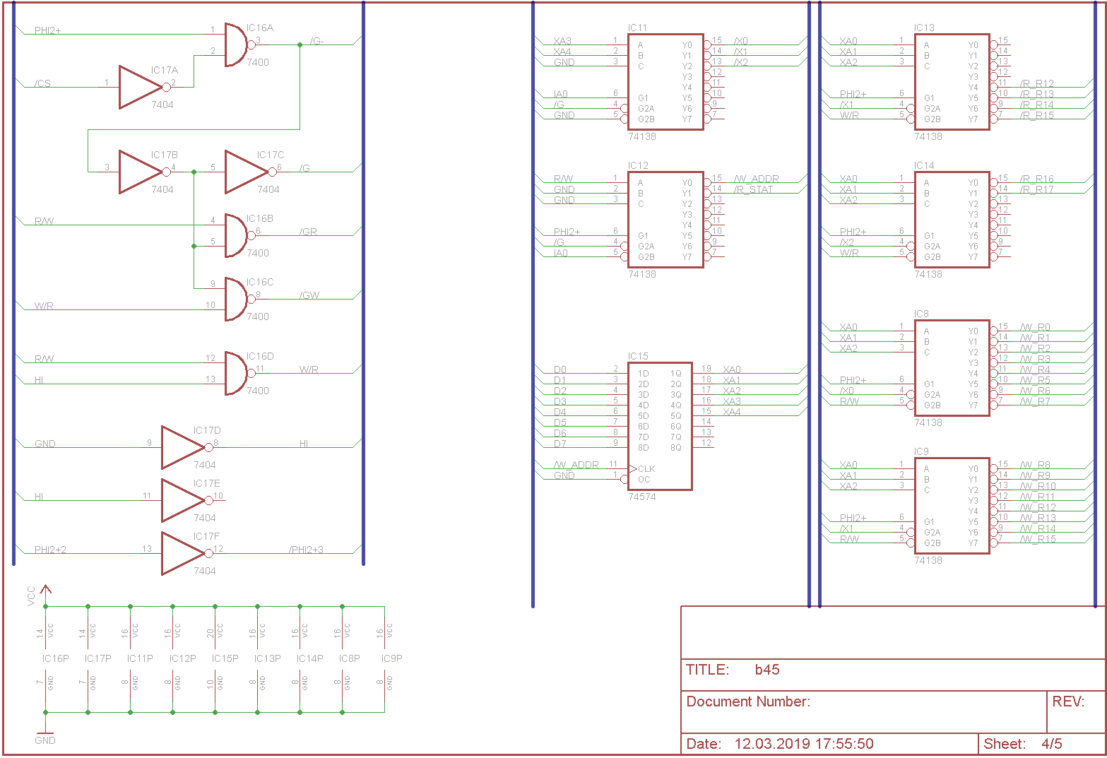

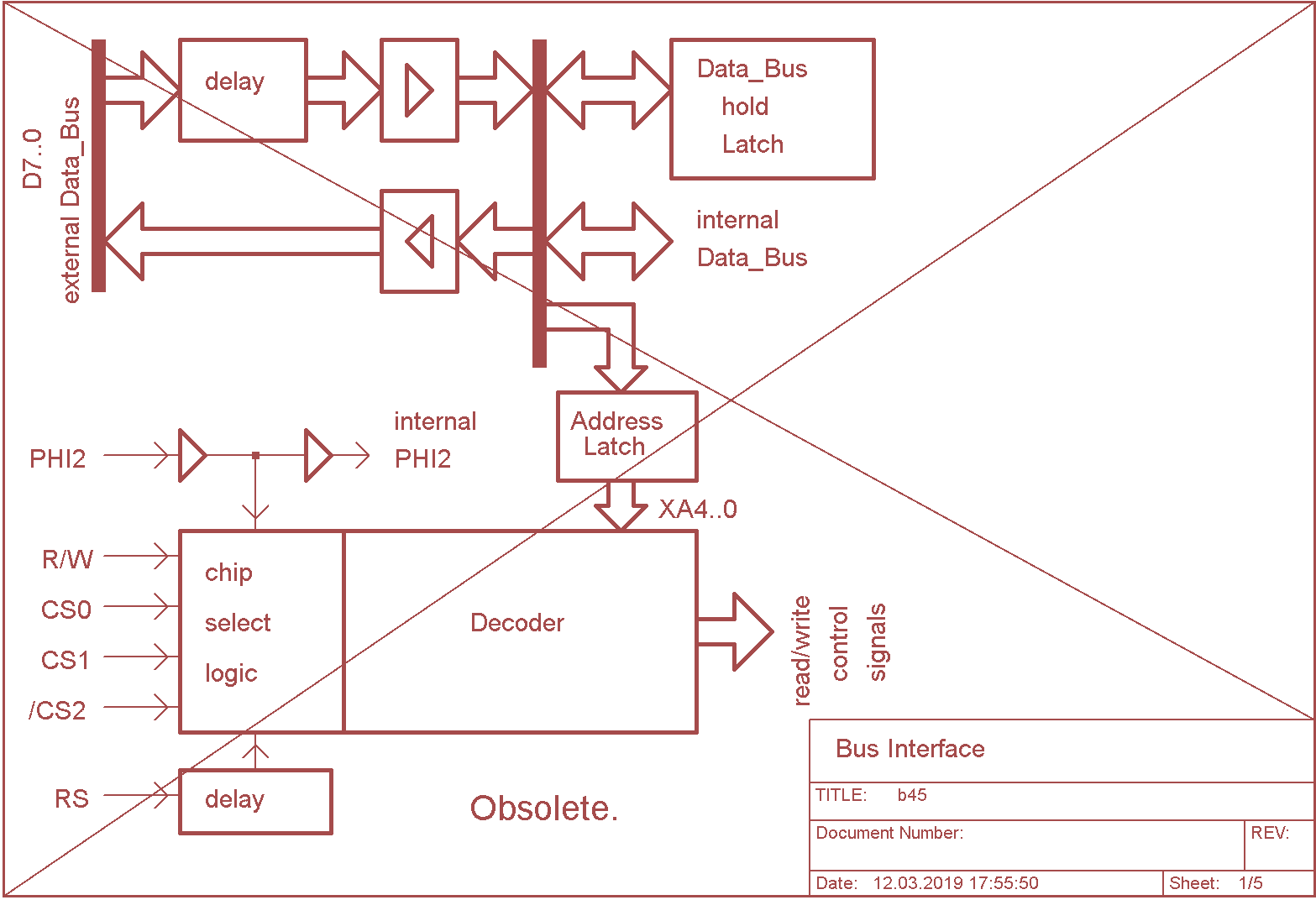

B45, the bus interface to the 6502.

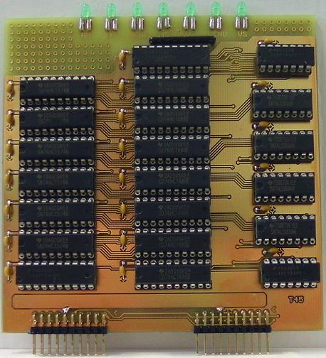

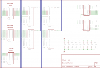

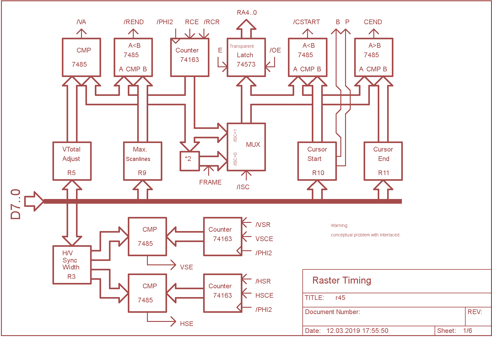

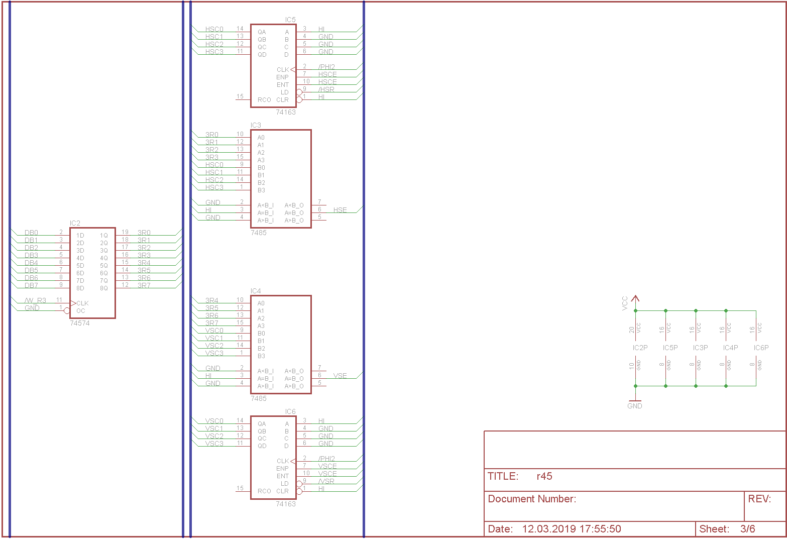

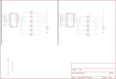

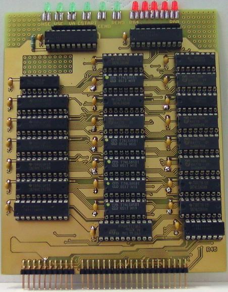

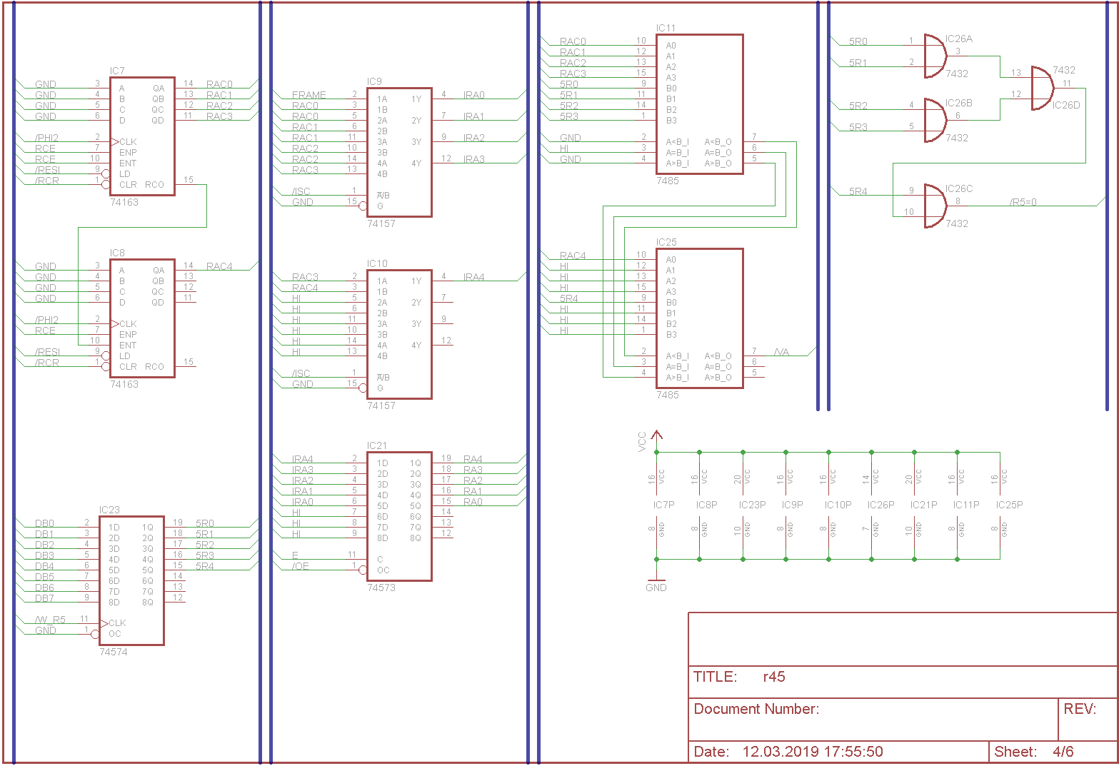

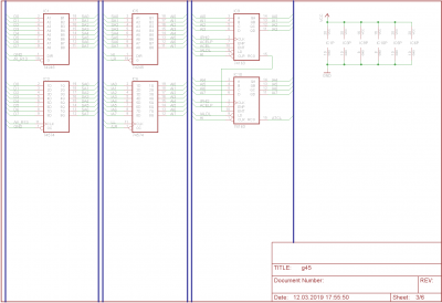

PostPosted: Sat Apr 06, 2019 2:04 pm
Posts: 1431

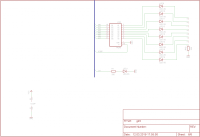

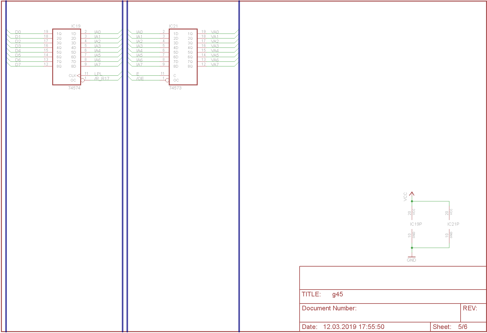

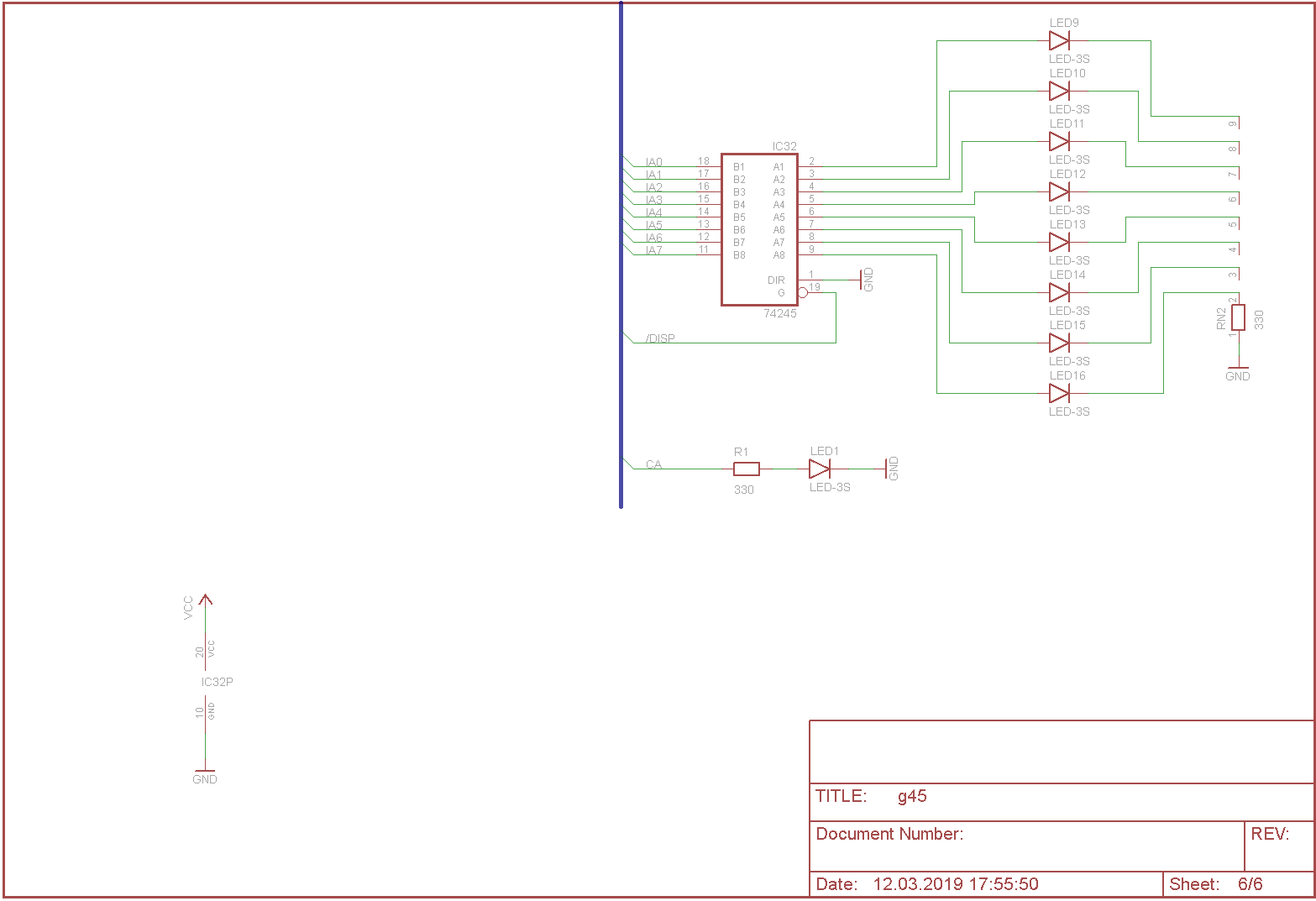

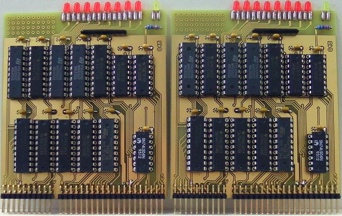

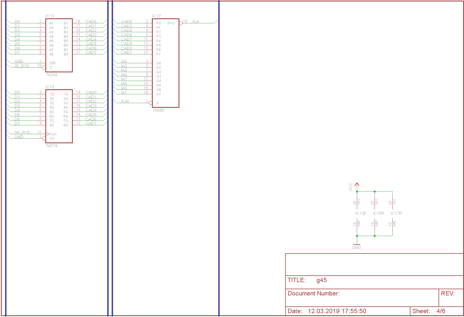

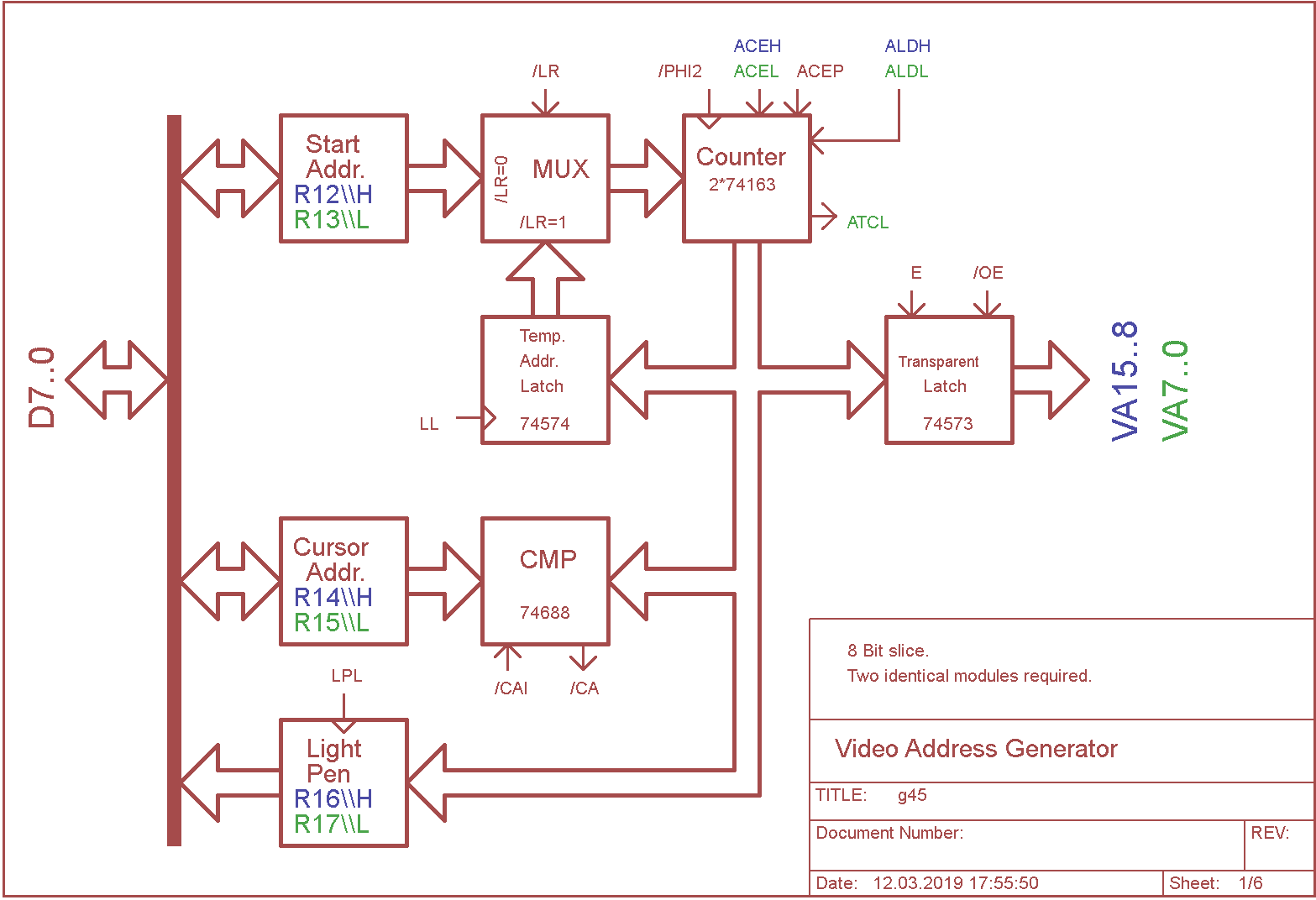

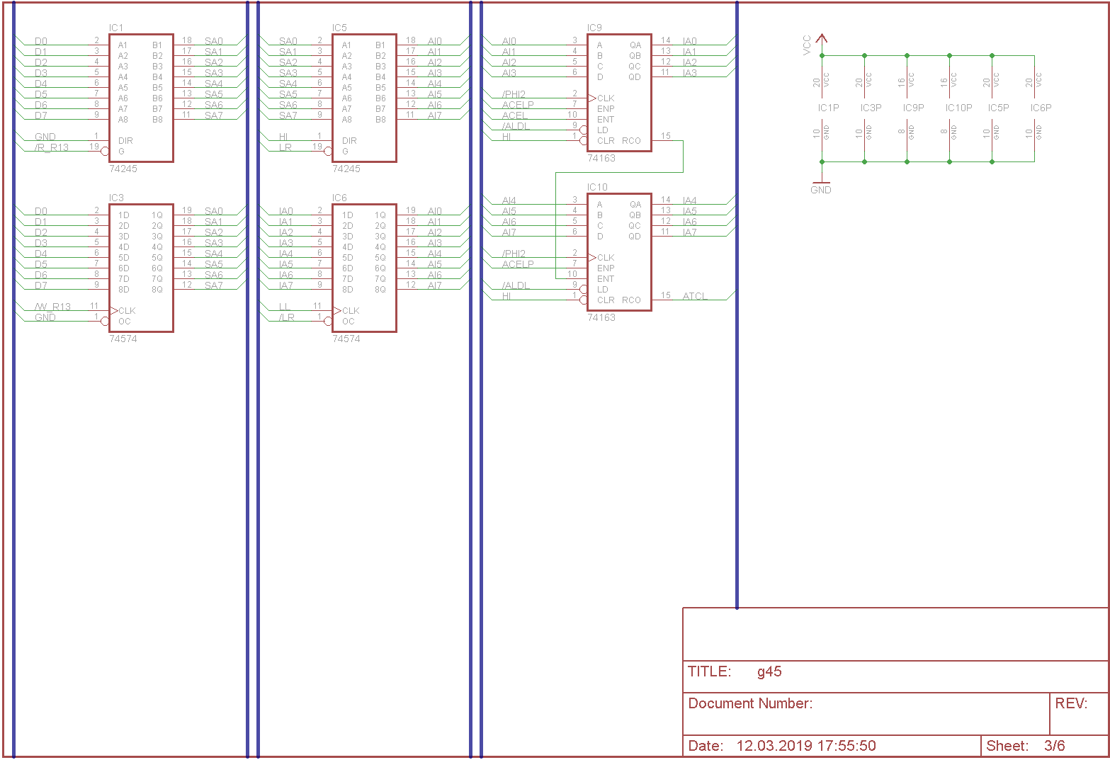

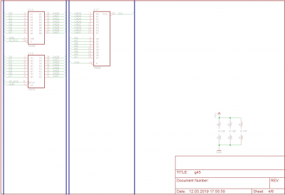

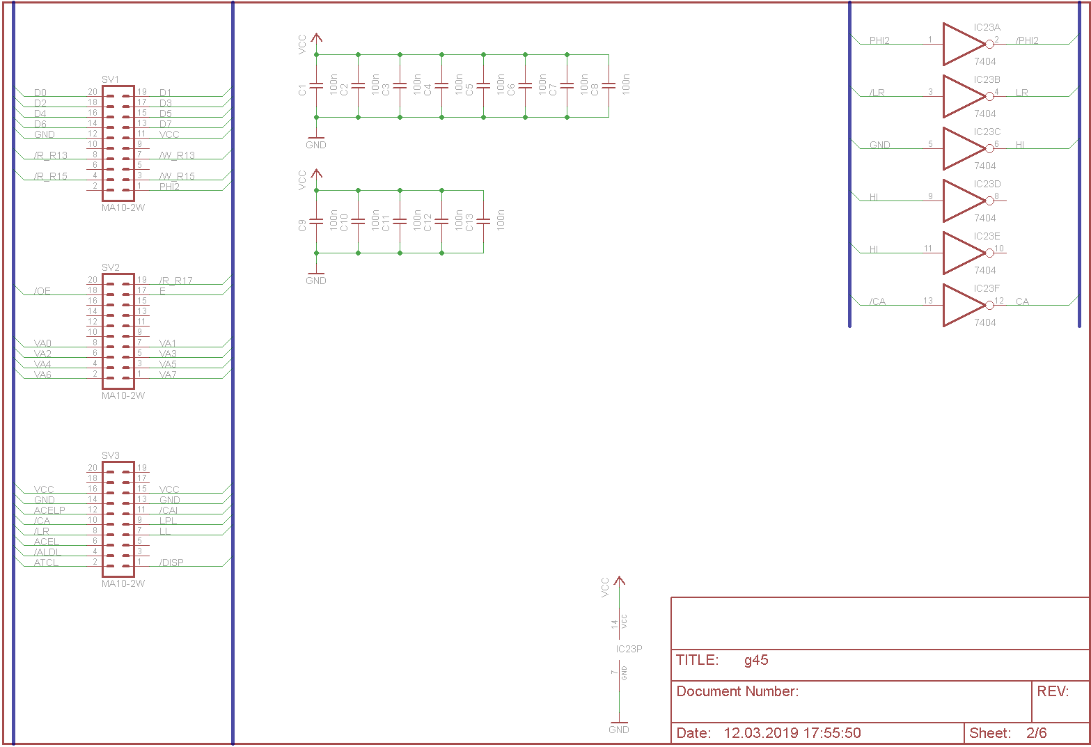

G45, video address generator module, two identical modules required

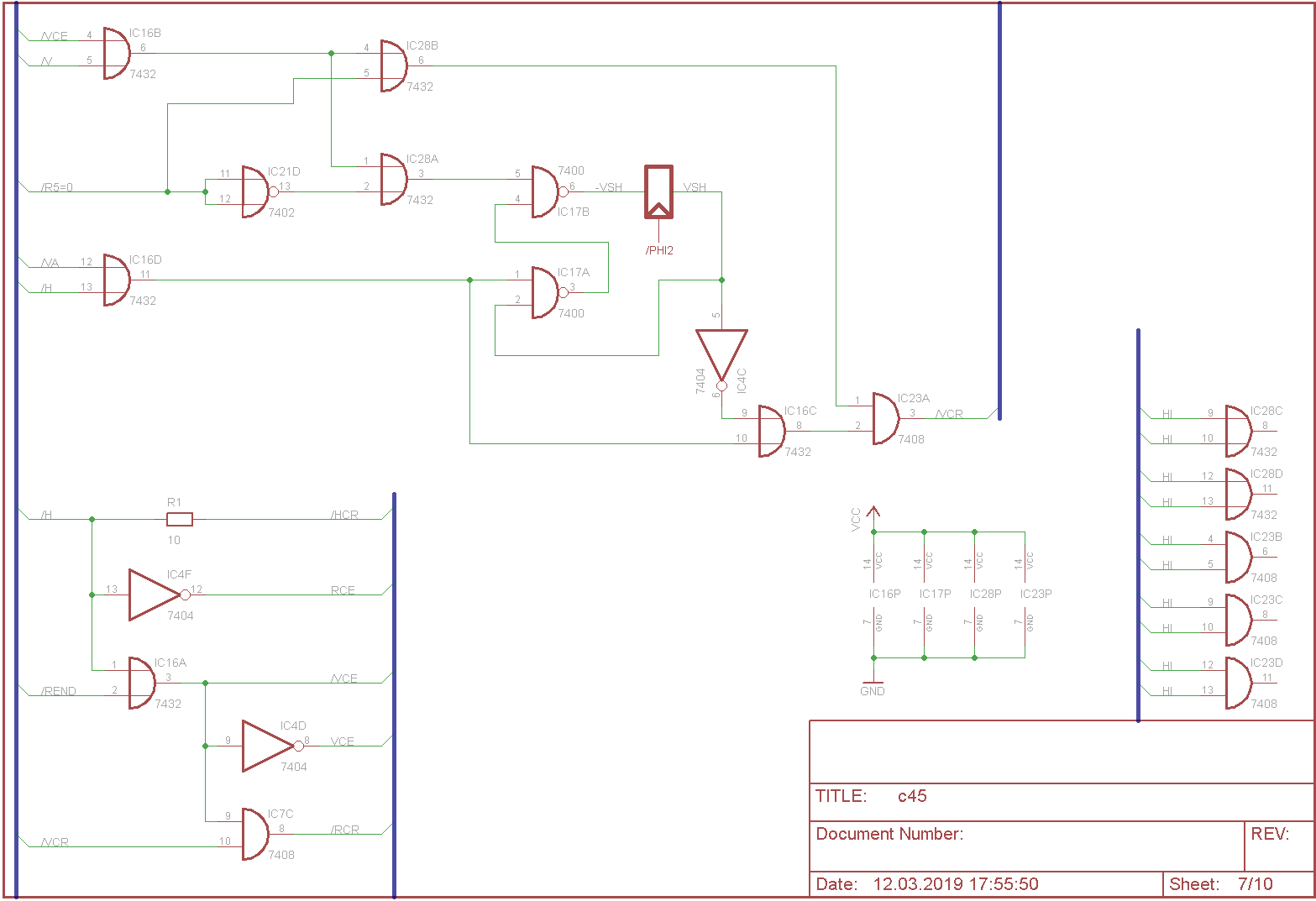

PostPosted: Sat Apr 06, 2019 2:11 pm
Posts: 1431

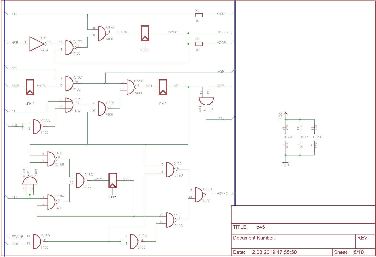

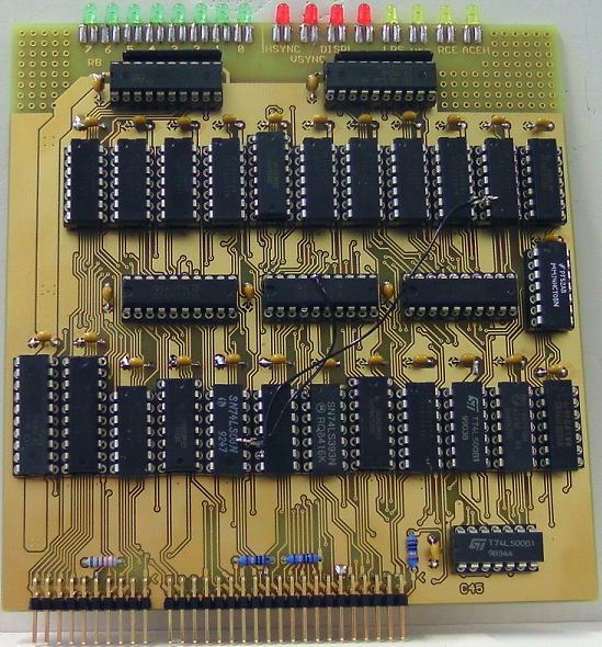

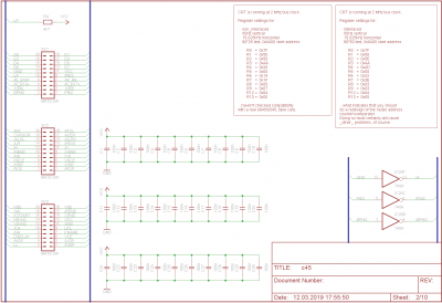

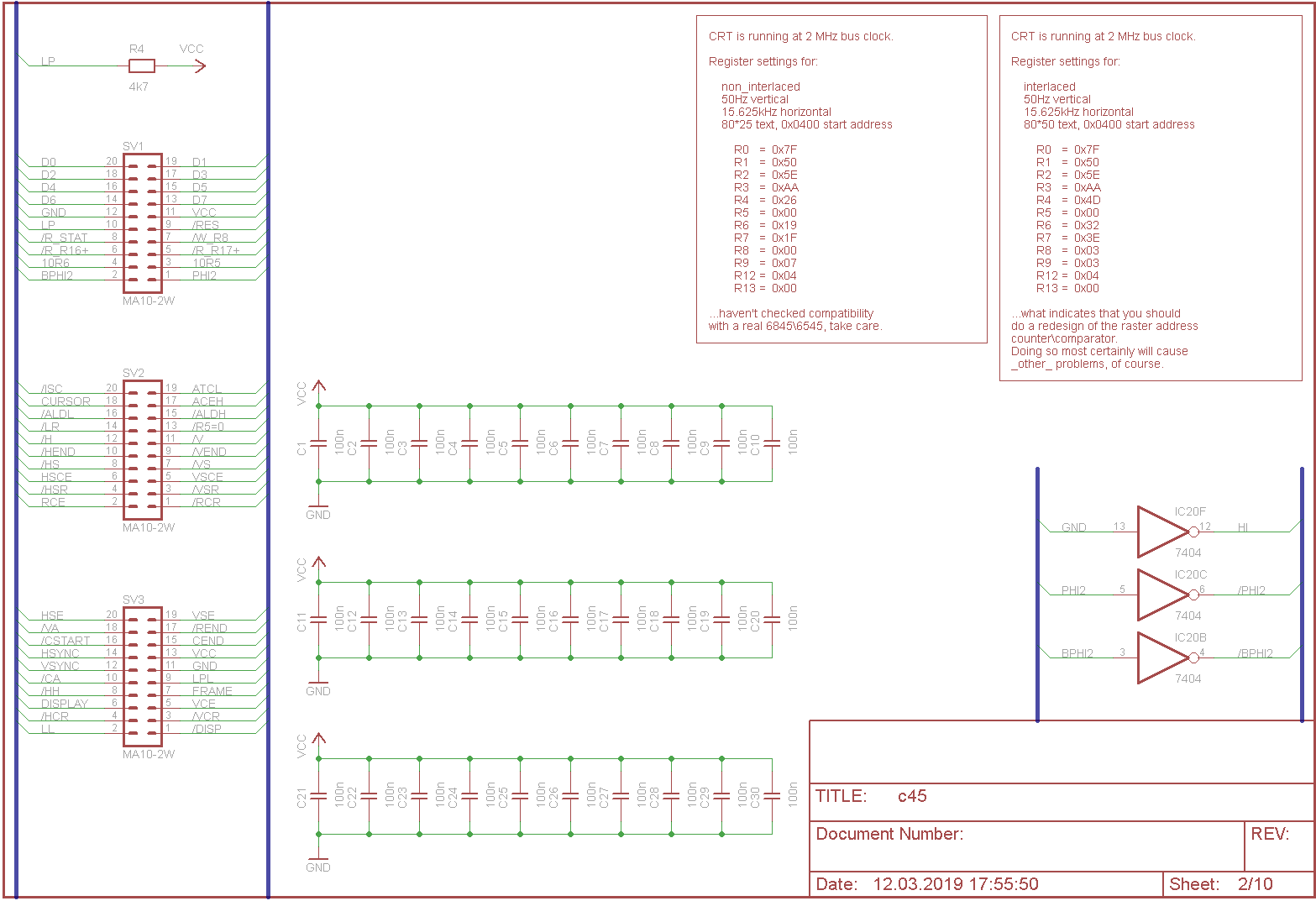

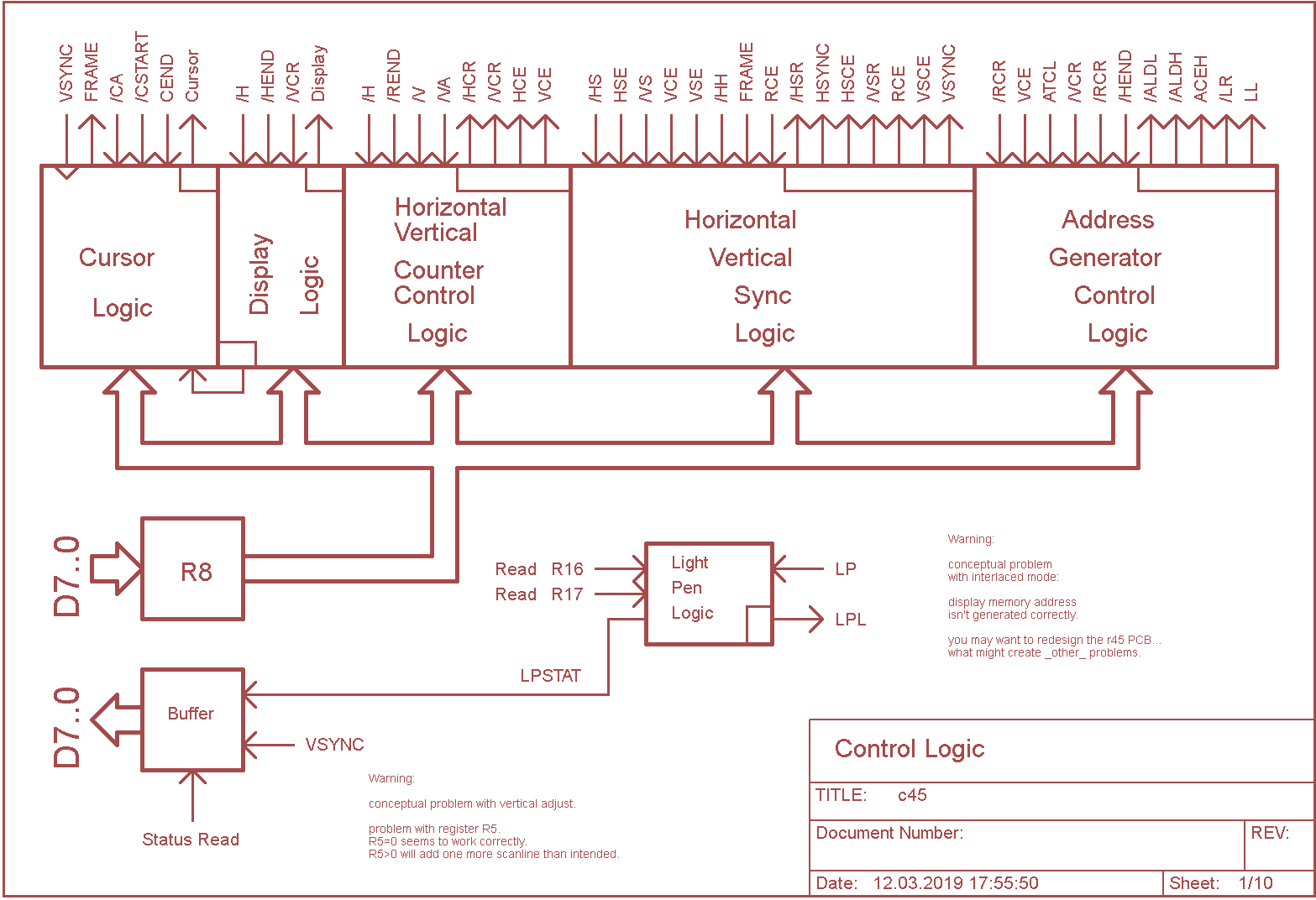

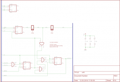

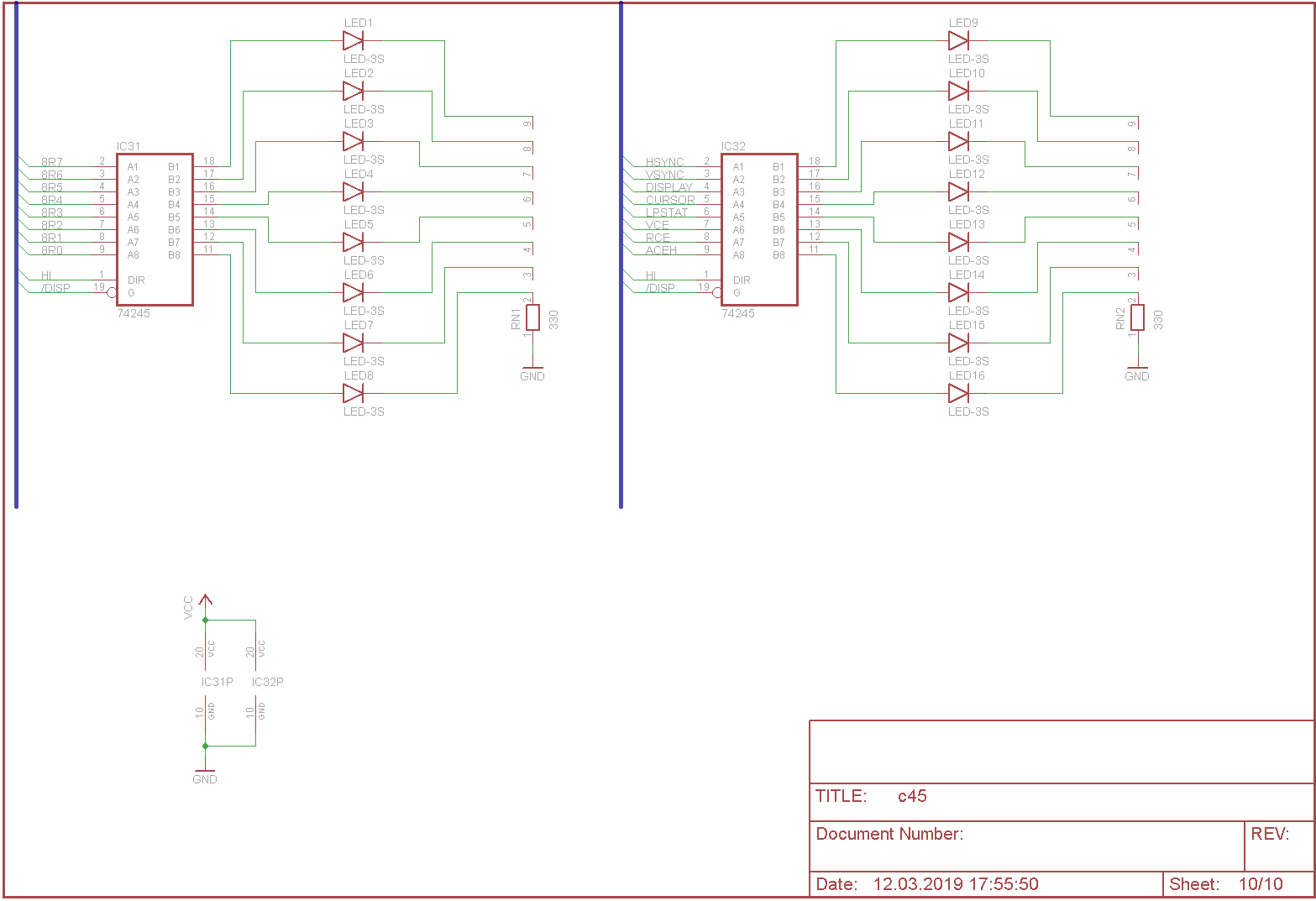

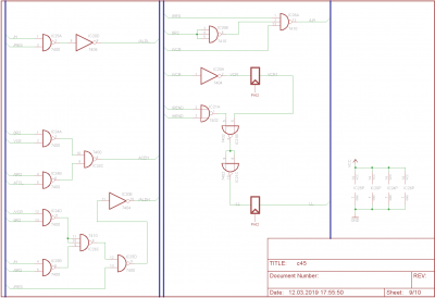

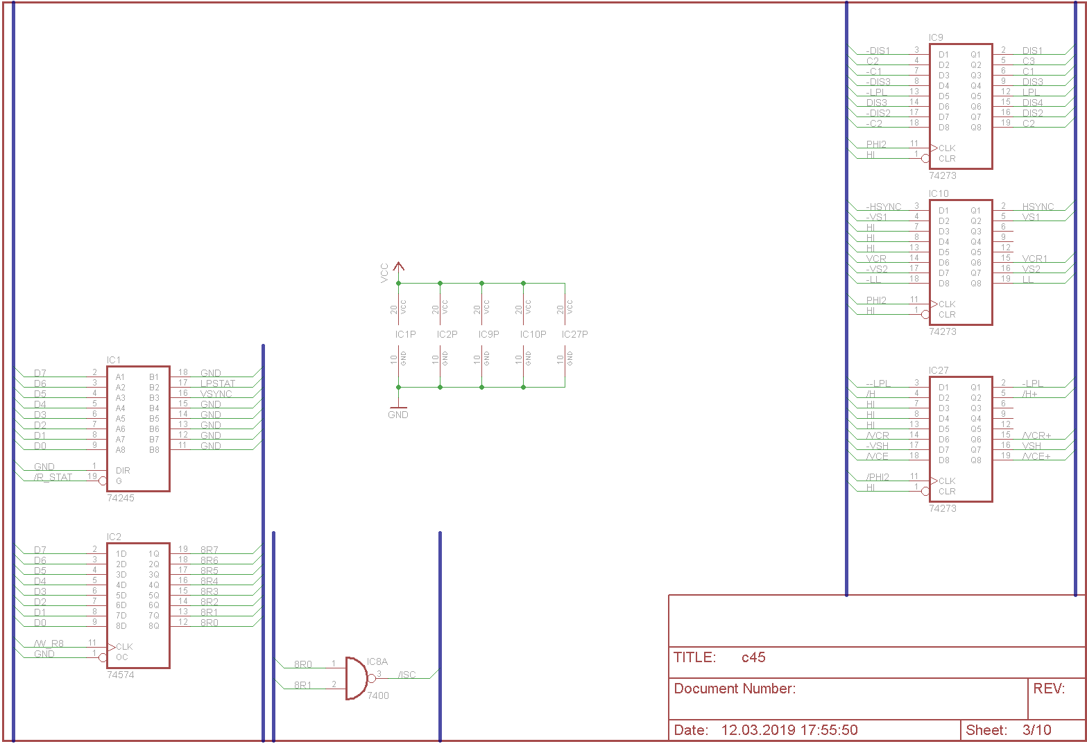

Now the last part:
C45, control module.
Unfinished work, has conceptual bugs, and you better design the whole thing again from scratch. I really mean it.
IIRC the intention was being able to run the video address generation circuitry at a higher frequency than the 6502 CPU,
with the idea in my backhead of porting the design to a CPLD someday, so I had decided to go with synchronous logic.
But this had bloated and complicated the logic design a lot, maybe it would better you go for another concept
like making creative use of RS flipflops at some places in the circuitry if you are trying to build something like that.
