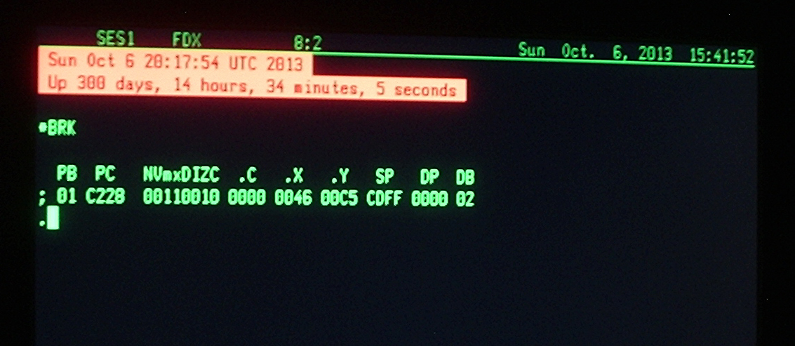

POC V1.1 achieved 300 days of uptime in the early AM hours. :)
File comment: 300 days of uptime.

For those keeping track, Dec 10 will be the year date. Let's home for stable power through then.

Funny you mention that. The power supply that runs POC is plugged into the 1.4 KVA UPS that keeps our two servers going. Unless a protracted outage (>1 hour) occurs, loss of power isn't likely. If anything, me doing something boneheaded and crashing the unit is a more likely scenario.

I've been wanting to make some changes to some of the BIOS primitives that would compact the code and make it run a bit faster, but held off on doing so in order to see how far I could push the uptime. I decided to bring the uptime saga to an end, as I also wanted to change a SCSI primitive function in a way that would/might allow me do an ISL from tape. So I decided to burn a new ROM and try it out.
POC V1.1 had reached 306 days, 13 hours and 21 minutes at the time of shutdown. :(

Arguably, this is better progress. There's always next year to go for an uptime record. Now you can focus on the shortest uptime as you start making changes and improvements.

I figured that 306 days demonstrated that hardware stability isn't an issue. Making it a full year would be something to crow about, but trying to do so was impeding progress.
