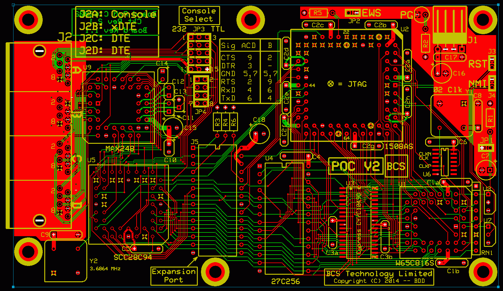

...Adding to the fun, I discovered some irritating bugs in Atmel's WinCUPL that wasted a fair amount of my time as I tried to convert what I want the circuit to do into the mumbo-jumbo understood by the CUPL compiler. Some of the syntax described in the CUPL programming manual is either not correctly implemented in the compiler, or is not supported at all.
I did get some help on this from Atmel and learned that some bugs are well-known. The question is why haven't they been resolved?
Anyhow, I was able to build and compile CUPL code for the ATF1508AS CPLD. Here's what I've developed so far:

The above code incorporates some of the concepts I had worked on for a protected environment. It won't fit the 1508AS, however, without design changes to the board layout.
File comment: POC V2 w/ATF1508AS CPLD
A constraint of the EPCB Proto-Pro layout is the maximum allowable board size of 21 square inches (1354 square centimeters). The rectangular shape I conceived for POC V2 allows me to use the SCSI host adapter I devised for POC V1—the west end of the board has to stay unchanged so everything lines up. Unfortunately, that limits the space available to the CPLD and significantly limits the ability to use the topmost row of pins. However, the fitter that is part of Atmel's WinCUPL software can't fit my design to the 1508 as I want it. If I let the fitter auto-fit the design it works out fine, but results in many of the top row pins being assigned to a circuit function. I can move a few of the connections, but not enough to make it work.
It seems that I am going to be forced into using EPCB's production service so I can shape the PCB in a way that allows me to use the pins that are not readily accessible in the Proto-Pro layout. This issue is not unlike what ElEctric_EyE underwent in his project, except his problem was that of too many holes, rather than insufficient area. In my case, I'm okay with the hole count (637), but need more board area—my board is 6 inches × 3.5 inches, putting it right at the 21 square inch limit.
I'm going to work out a totally new board layout that is designed to make best use of the 1508, rather than work within the Proto-Pro limits, which should allow me to distribute I/O connections evenly around all sides of the device. I'm not seeing any other (obvious) solution.

Those mounting holes @ 12:00 and 6:30 don't look necessary unless it's going to be used in a fighter jet, IMHO. Might you consider getting rid of them and doing a tiny bit of parts shuffling in order to get the space that you need at the top?
Mike
 Post subject: Re: POC Version 2
PostPosted: Mon Dec 01, 2014 1:36 am
Posts: 8505
The hole at 12 o'clock is one of the three that secure the SCSI host adapter, so is necessary. I added the hole at 6:30 because flexing in that area would occasionally partially disengage the host adapter bus pins from the J5 socket into which it is plugged, this problem occurring with POC V1.1. Its removal would not really accomplish much, as the relationship between the holes at 10 o'clock, 12 o'clock and 8 o'clock and J5 socket must be maintained. Hence J5 can't be moved to occupy any of the space taken by the hole at 12:30.
The original plan for POC V2 was the use of the smaller Atmel 1504AS CPLD, which comes in a PLCC-44 package. My code fitted that device. Recall that the switch to the 1508AS was because I couldn't get my hands on the Atmel programmer adapter for the PLCC-44 package and couldn't program the device via JTAG, since those pins were being used as I/Os.

Hi BDD, I feel your pain.
It's over $100 more for the Production service @ $300US for 2 boards. It does add some pressure to make sure the design comes out 100% the first time!

Sounds like its time to move to a more open design tool and send the plot files to China.

BitWise: I was going to suggest exactly the same thing.
Can't you knock up a JTAG programming rig -- a PLCC socket on some strip board with power and JTAG connections. I would have thought that in 'programming mode' the I/O pins would return to thier JTAG mode until the programming operation completes.
I could.
They do. The caveat about the JTAG pins being used as I/O is that in-circuit programming can't be done. Ironically, with the 1508AS I could have a JTAG port on the board, since I don't need to commit those pins to I/O.
