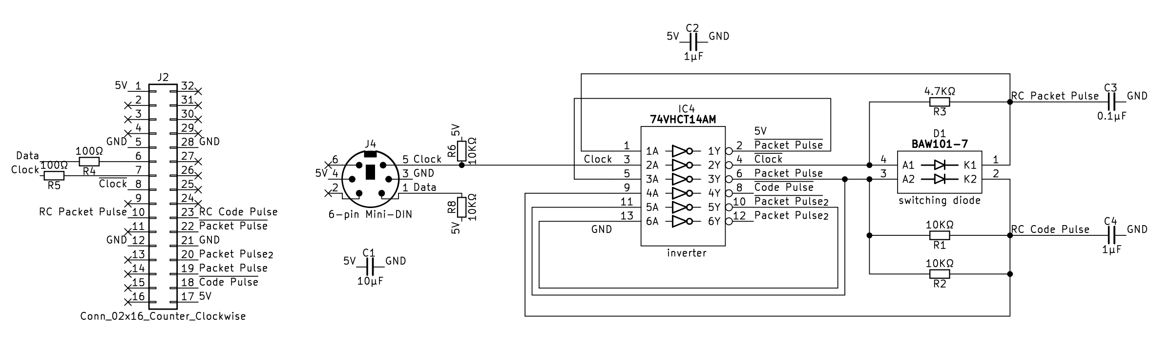

It's an open-drain interface so you're meant to pull it to your power rail with resistors. Are you seeing the keyboard pulling up to 5V itself? I'd imagine this is harmless, and it'd be fine for you to connect that down to your 3V3 rail with diodes, clamping it at that level - the keyboard's end should be very high impedance so not much current should flow through the diodes.
Edit: It sounds like keyboards may well have their own pull-ups, e.g. about 2K. It is possible that the keyboard also requires the line to reach close to 5V at the bottom of that pull-up resistor. So the diode solution might not be good, you might need more active level conversion, either an open-drain level converting IC or a couple of transistor-inverters, one for each direction, like this: https://www.falstad.com/circuit/circuit ... geCCnlUJAA
In that example the left portion represents what's in the device, and the right is what's in your host; and I've rigged it so that the device and host both periodically pull the signal line low, so you can see that they then both see a good voltage swing at their inputs when the other device does this to the signal line. You can try removing the device's pull-up resistor and see that the circuit works fine whether it has one or not.
I can't speak for Neil but I saw both keyboards pulling all the way up to 5V. I didn't use pull up resistors.
Above is what I want to build. And basically what I have built on a breadboard without the 10KΩ pull-ups on the clock and data lines. I'm not sure the 100Ω current limiting resistors are necessary but if not I'll jumper them with 0Ω resistors.
As a bit of an aside the (poorly named) /CODE PULSE signal goes high only after all the packets for a key-press have been sent (that's why I have two 10KΩs in parallel so I can play with RC timing values if I turn up a keyboard that is very different). That allows me to feed the '595 shift register (not in the schematic) into a '40105 FIFO (also not in the schematic) and that means that I only have to service an interrupt once per key-press. Overkill? Absolutely. Fun? Yes!

Just to note, some PS/2 keyboards, but not all, can run with 3V3 supply and signalling.
PostPosted: Tue Nov 21, 2023 12:10 pm
Posts: 741
Yes, I'm not sure how much you can rely on the keyboard being 3V3-tolerant but YMMV. Note I edited my post to include a link to a possible circuit in falstad, using two transistors per signal line, that allows connection to a 3V3 host but still gives good voltage swing at the device regardless of its own pull-up capability.
