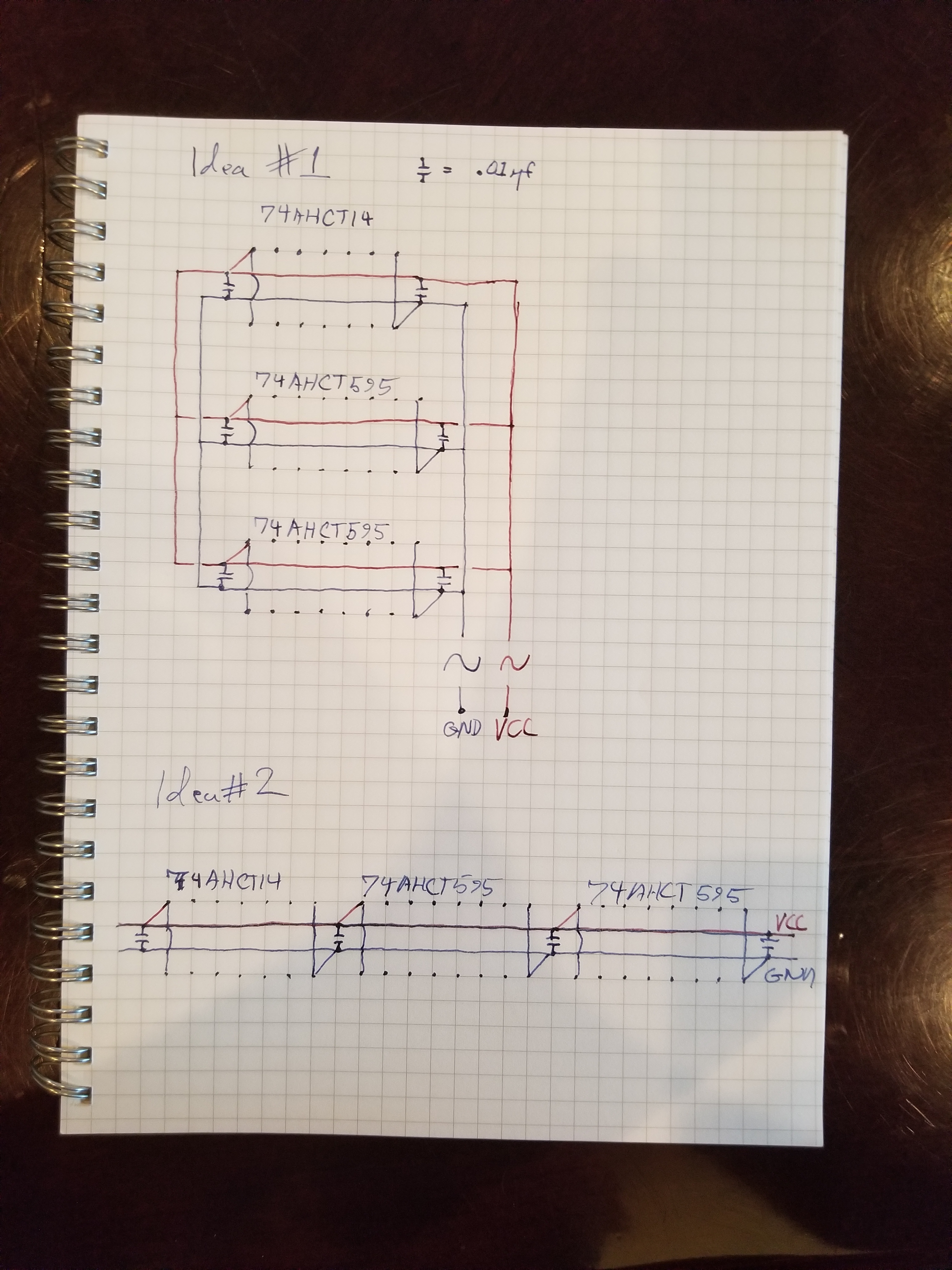

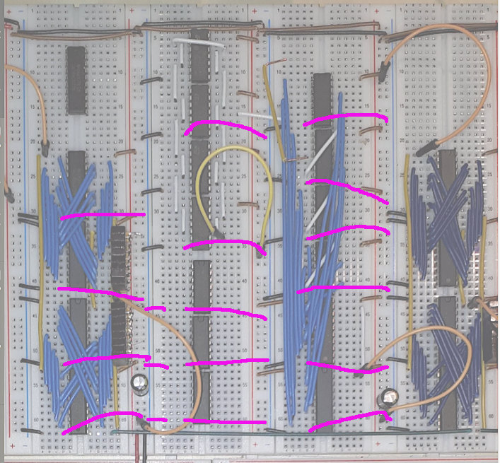

I can see from photos earlier in the thread that you're using 74AHCT logic chips for this keyboard circuit. When used on a breadboard the 'A' version of the logic chips can be problematic due to rapid rise and fall times of the outputs for this logic family.
Indeed I struggled with reliability of this same keyboard circuit on a breadboard using 74AHC logic chips. The same circuit worked perfectly after switching to 74HC logic.
PostPosted: Fri Jun 17, 2022 9:11 pm
Here's to emphasize what Jeff is saying above. (See also the 6502 primer's page, "Construction: Avoiding AC-Performance Problems" and the links added there.) Here's someone's picture I downloaded and modified. Clearly the builder is not finished with the circuit; but so far the only power and ground connections between boards is along the top. I put, in hot lavender, how the ground connections should go across from ICs in one column to ICs in the next. (Power should be done the same way, and the bypass capacitors should go over each IC, not just at the rails.) The signals' return current needs to go through these added connections. If they have to go clear up to the top and over, it makes for a lot of extra inductance, and they'll try to come back on neighboring signal lines instead, not because of reduced resistance, but because of mutual inductance, that is, the electromagnetic field around one wire trying to produce an opposite current spike in a neighboring line, resulting in glitches. Make the wires no longer than they need to be.
adrianhudson wrote recently, "I read somewhere, Garth's primer I think [linked above —GW], about ground return paths on breadboard. I put several more power and ground connections between my breadboards and bingo, fixed."

Also, what power supply are you using? I noticed in the schematics that there is no larger (eg 47u or 100u) bypass (are they called this?) Cap between gnd and vcc. I have them on every board where the supply hits the board and sometimes even some across the board, to decouple power fluctuations between boards and the supply.
(And now I'm looking for comments of our resident experts if that actually makes sense...)

[color=#000000]Here's to emphasize what Jeff is saying above. (See also the 6502 primer's page, "Construction: Avoiding AC-Performance Problems" ...
That picture is illuminating. I read the AC Performance Problems page about 3 times this week, thanks to other threads where people are discussing similar issues to the one I'm having. I always attach GND to GND and VCC to VCC at both ends of breadboard, but it still never occurred to me to attach both rails at each IC like that.
I have a 9 volt wall-wart; it plugs into a power regulator circuit on the backplane that has a 10uf and a 100uf electrolytic capacitor. It's a pretty standard thing, I think, using an LM7805 to generate 5 volts. That's the only place I have larger electrolytic capacitors; all the bypass capacitors are .1uf or .01uf.

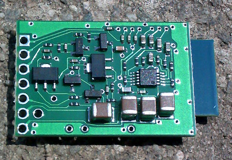

The high highest frequencies of current will go through the SMT capacitor down low, almost in contact with the board. There's just enough room underneath it so the flux gets washed out (less than the thickness of a Post-It note). I just grabbed a 1206 package capacitor which is considered "large" by today's standards, to measure it, and the very top of it was only .030" (3/4 of a mm) off the surface of the board. The "leads" (ends) of the chip capacitor will be much closer together too. The biggest capacitors on this board (below) that I designed recently for work are 1210 package size, ie, 0.12"x0.10", and 0.10" tall, and those are 100µF (yes, one hundred microfarad)! (I'm not using them as bypass capacitors though. Those are handling audio.)
The smallest capacitors on this board are 0402 (0.040" long and 0.020" wide). The next size down from that (but not shown here) cuts that size in half to 0201, and there's also one that cuts the size in half again, 0105 (or is it 01005—that one is rare). They're like the smallest flecks of pepper.
The matter left is that of vias. Yes, if you need to connect to a plane or anything else on another layer, there will have to be a via, and those usually go right next to the capacitor pads. Normally you can't put them in the pads, because then the screen printing of the solderpaste will make a whole lot of solderpaste squish through the hole and make a mess; but if getting minimum inductance and/or maximum density is important enough, you can have them drill and plate the holes, then plug the holes and plate again, over the top of the plugs, and then you can't even see where the via is. In our case where we assemble by hand, the screen printing of solderpaste does not normally come into play, so I put vias in the SMT pads.

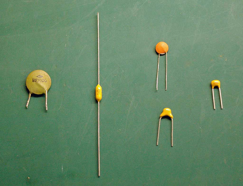

Through-hole caps have been improving over time. The left most I used to use in the late 70s to mid 80s, then going toward the right most the ones I use to day. Lead spacing is only 2.54mm and they sit pretty close to teh board. Using planes in a 4-layer board you can get away with very sort leads (~< 1mm). Perhaps they will not beat smal SMT on a 4-layr board, but they are a lot better than what we had in the past.

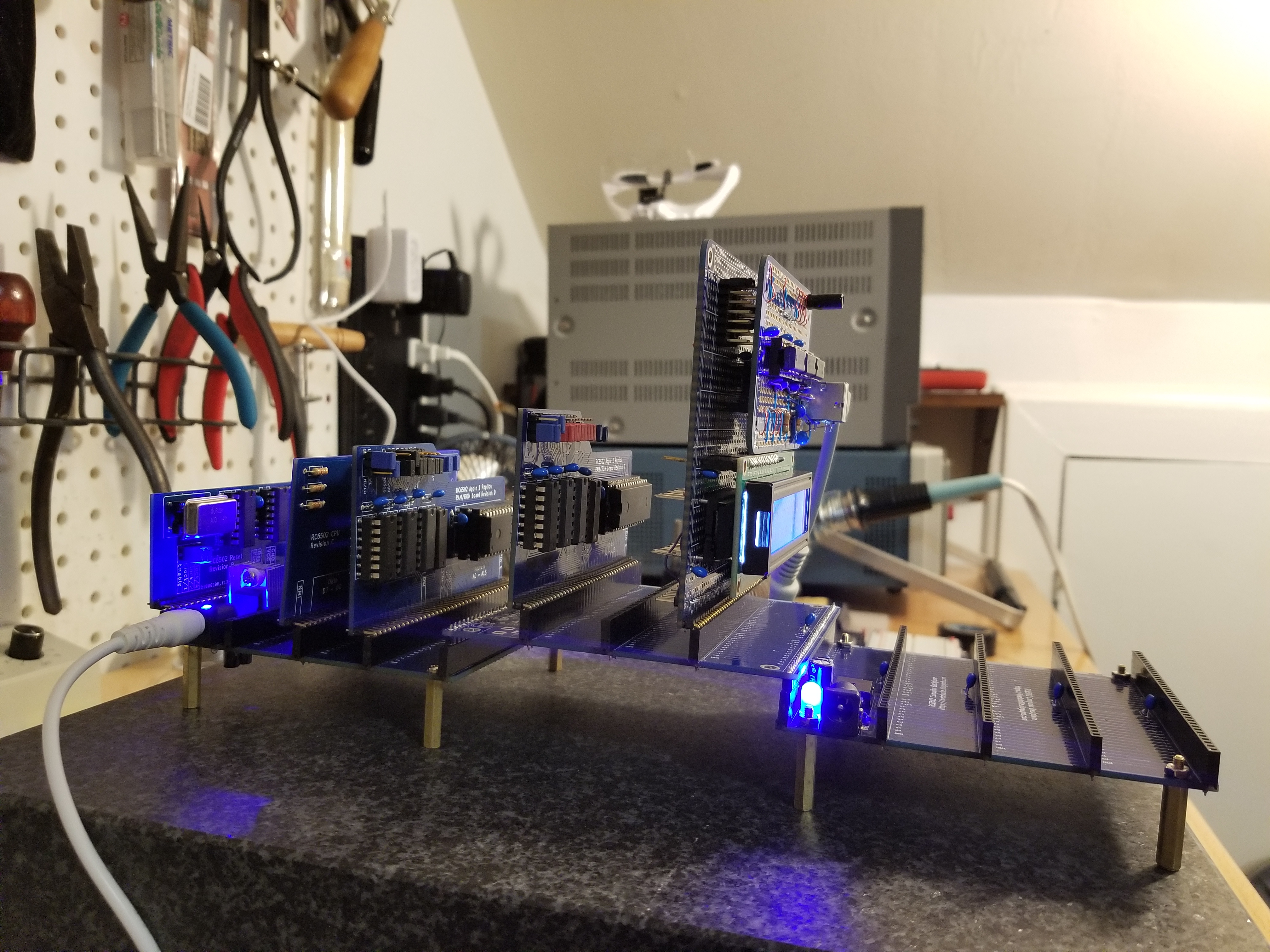

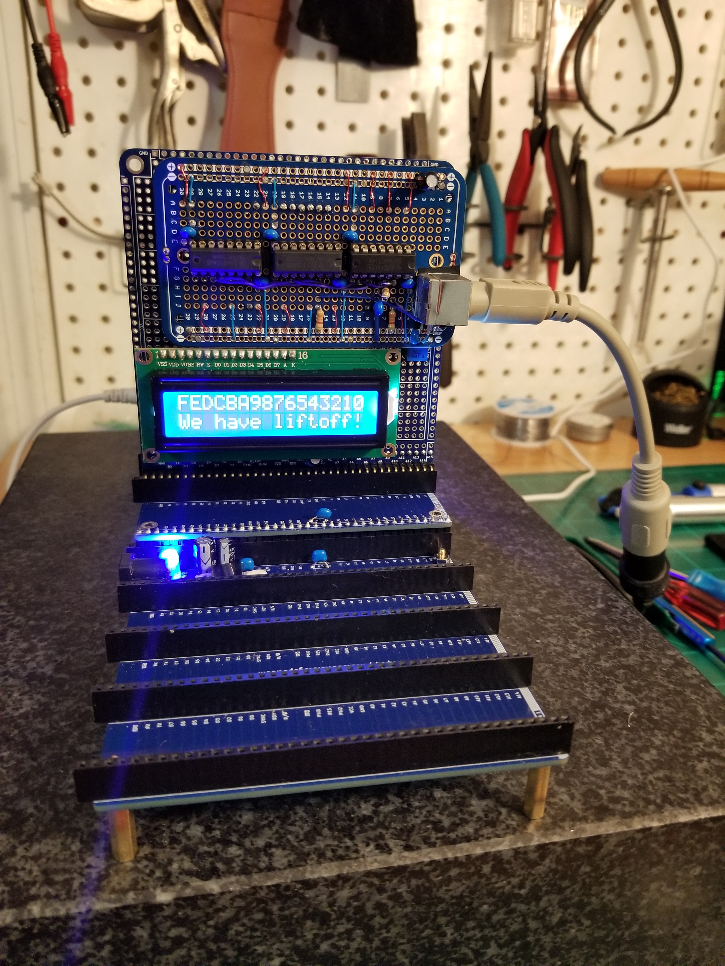

PostPosted: Sun Jun 26, 2022 2:16 am
Posts: 491
I suppose this shouldn't feel like such an accomplishment, seeing as how this is the 3rd or 4th time I've built the thing, but...
Blue April now (finally!) has an I/O board. LCD output and keyboard input are provided by something other than breadboards! :D Here are a couple of side / back views. I kind of like the one with all the lens flare - I didn't do that on purpose!
Now I can get back to my regularly schedule project of making a video card and importing code from 1970s issues of Dr. Dobb's Journal!

PostPosted: Sun Jun 26, 2022 10:56 am
Posts: 718
Great job! Glad it's working well. Did you end up going with the 74HC or 74AHCT parts in the end?
So, you have 3 backplane boards, and to connect them you made a little staircase!
I see you have gotten wire-wrap figured out. That's neat to see, glad that is working for you.
Any starting places for the video? As some have told me, "it is best to start with a working model". And they were right. I was having major difficulties, but when I used George's (gfoot) design, everything worked out nicely afterwards.
Great job again! Thanks for the updates and pictures.
I did switch to 74HC while troubleshooting the old circuit, but with this rebuild all the ICs are back to 74AHCT. (Actually, if you look REEEEELY closely at the photo, one of the 595s is still an HC - I must have reached into the wrong parts compartment! - but I have since noticed and swapped it out, so they really are all AHCT now. :)
Yep. :) TEBL made a kind of bridge connector for extending the backplane, but it took up two bus slots and only provided one. I figured rather than making another PCBWAY order, I could just make a third backplane and solder on some upside-down male headers. Sacrifice two bus slots to gain three. Also the front backplane module can be swapped out for the RC Project Platform board - that's the one with the half-breadboard and 6522 on it.
It seems to be working OK; I followed Garth's instructions in the primer. :) There are still a few solder connections on this version, but all the bus signals are wire wrap to wire wrap.
