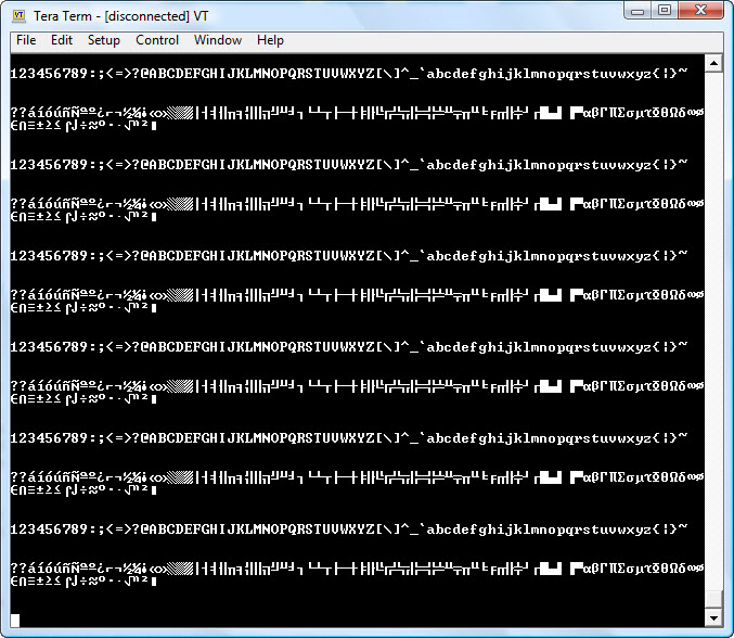

I found out why I wasn't able to write to FT245. It is because my TTL logic is too slow with too many cascaded logic such that 6502 can't run at 7.37MHz. The program that was loaded in RAM wasn't executing properly and wandering off somewhere. So when I changed the CPU oscillator to 3.68MHz everything is working as expected.
The attached program is actually 3 programs in one. The first part up to C06A is the bootstrap opcode stream executed by 6502 as they come out of FT245 FIFO. That part of the program build a simple loader in RAM locations starting from 0xb000. The simple loader code is in the commented section C06D; it basically loads 256 bytes of data from FT245 into 0xb100 and jump into 0xb100. So whatever 256-byte program after C06D will be loaded and run. In this case the 256-byte program writes a byte to FT245, delay a bit, increment and write the byte to FT245 again and again as the screen capture showed. That is obviously not 256 bytes worth of program so it is padded with lots of zero just so program will start.
This is a good way of loading 256-byte diagnostics, but in actual use it is a Intel Hex loader to load EPROM programming software into RAM and burn the EPROM.

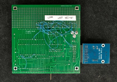

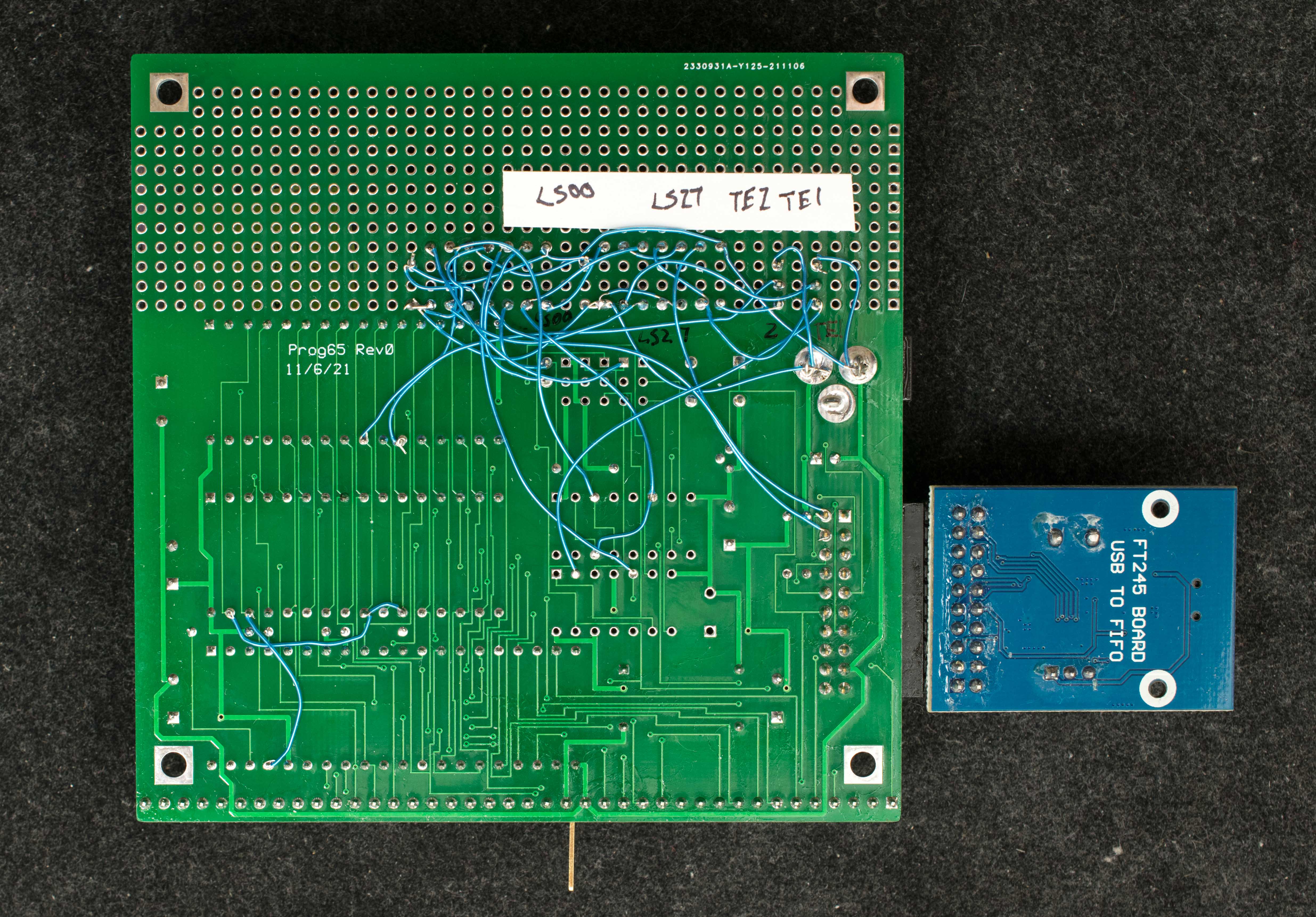

I have not given up on the idea of ROM-less 6502-based EPROM programmer. I did give up the original concept of putting EPROM in location $0-$7FFF and RAM in $8000-$BFFF--it is just too difficult to write program with such memory map. Programming is hard without stack and Zero Page.
So this is another concept and modified pc board (schematic and board picture attached):
RAM $0-$7FFF
FT245 $8000-$FFFF in programming mode, $8000-$BFFF in normal mode
EPROM is writable shadow at $8000-$FFFF, $C000-$FFFF in normal mode
I have been waiting on 74ALS27 which came in yesterday. Hardware is now working, I can load program into RAM through FT245 and I can run it. Now I need to come up with software to program the shadow EPROM resides in $8000-$FFFF.
Prog65_rev0_Experiment_2_sch.pdf [35.99 KiB]
Downloaded 53 times

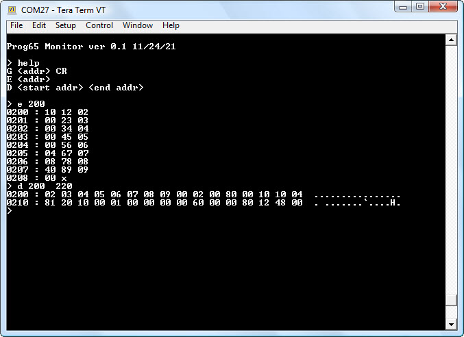

I believe I have a working 6502-based EPROM programmer. This is the programming flow:
1. Switch to programming mode, load bootstrap (Prog65boot), then load the 4-function monitor (ProgMon), and load the SST39SF040 programmer (ProgSST). Run SST39SF040 programmer which erases EPROM from $C000-$FFFF then copies data from memory $4000-$7FFF to EPROM.
2. Switch to normal mode, and power up to run software of the newly programmed EPROM. Picture shows a basic 4-function monitor (load, display, modify, go) running on Prog65.
Some additional details:
RAM is from $0-$7FFF. Bootstrap loader and EPROM programmer are located in lower half of RAM. The upper half of RAM (16KB) contains the image to be programmed into EPROM. Different EPROM will require a different EPROM programmer software because they have different command sequence. Bootstrap and EPROM programmer are small software; bootstrap is 256 bytes and SST39SF040 programmer is 200 bytes. It only takes a few seconds to program 16KB.
A double-pole, double throw switch can simplify switching between programming and normal mode. The board only consume 30mA at 7.37MHz, so it can get its power from USB via FT245R. I'm getting rather fond of FT245R. It is really fast and an effective I/O device. It is somewhat expensive at $12, but offset the cost by replacing an I/O component resulting in a simple SBC consists of CPU, memory, and glue logic.
OK, I'll write up this design and release it to public domain. Normally I put my design files in retrobrewcomputers.org, but I also like to enter it in the document area of 6502.org. How do I access the 6502.org repository?
Edit, I'll send the design out to JLCPCB in a few weeks and get 10 pc boards fabricated. I'll have plenty of spare boards to give away. Let me know if you are interested. This should be a cheap and easy board to build; all through-hole components; W65C02 is the expensive part, but other CMOS 6502 should work; oscillator frequency can be anywhere 1MHz to 8MHz; RAM is any regular 128Kx8 RAM; EPROM is the inexpensive SST39SF0x0; and glue logic is the common 7427 and 7400.

Michael,
In step 3, ProgMon is loaded into RAM from $7000 to $7FFF. The program is written for $F000-$FFFF, but when converting to Intel Hex, I specified origin of $7000 so it is loaded into RAM and later copied to EPROM at the targeted location. While 16K of RAM data from $4000-$7FFF is copied to EPROM, only $7000-$7FFF contain meaningful data.
I use TeraTerm in Windows to communicate with the hardware. In fact I used a TeraTerm macro file to load the 3 programs. The bootstrap, prog65boot.bin, is loaded as binary file; the other two are loaded as Intel Hex files.
sendfile 'c:\users\dad\desktop\dayfiles\6502\prog65\prog65boot.bin' 1
pause 1
sendfile 'c:\users\dad\desktop\dayfiles\6502\prog65\progSST.hex' 0
pause 1
sendfile 'c:\users\dad\desktop\dayfiles\6502\prog65\progMon.hex' 0
