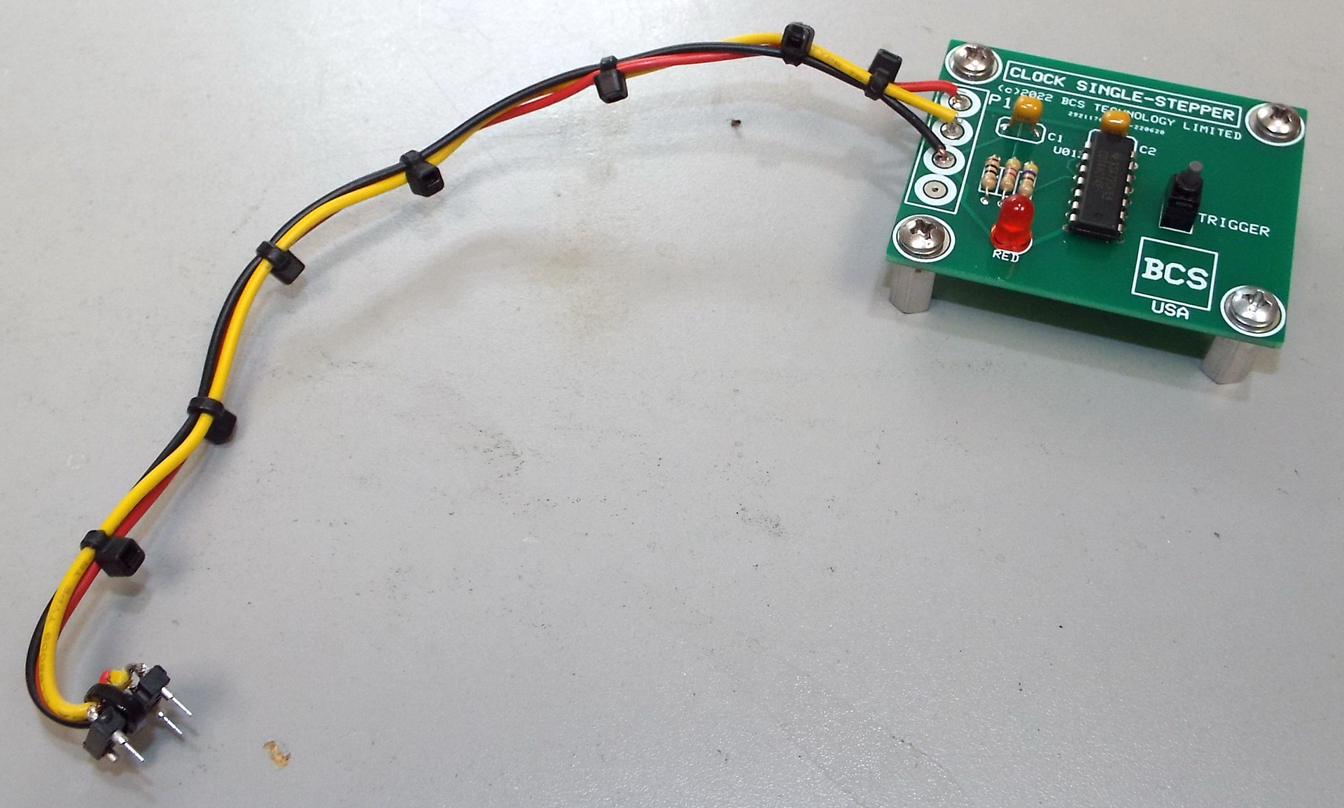

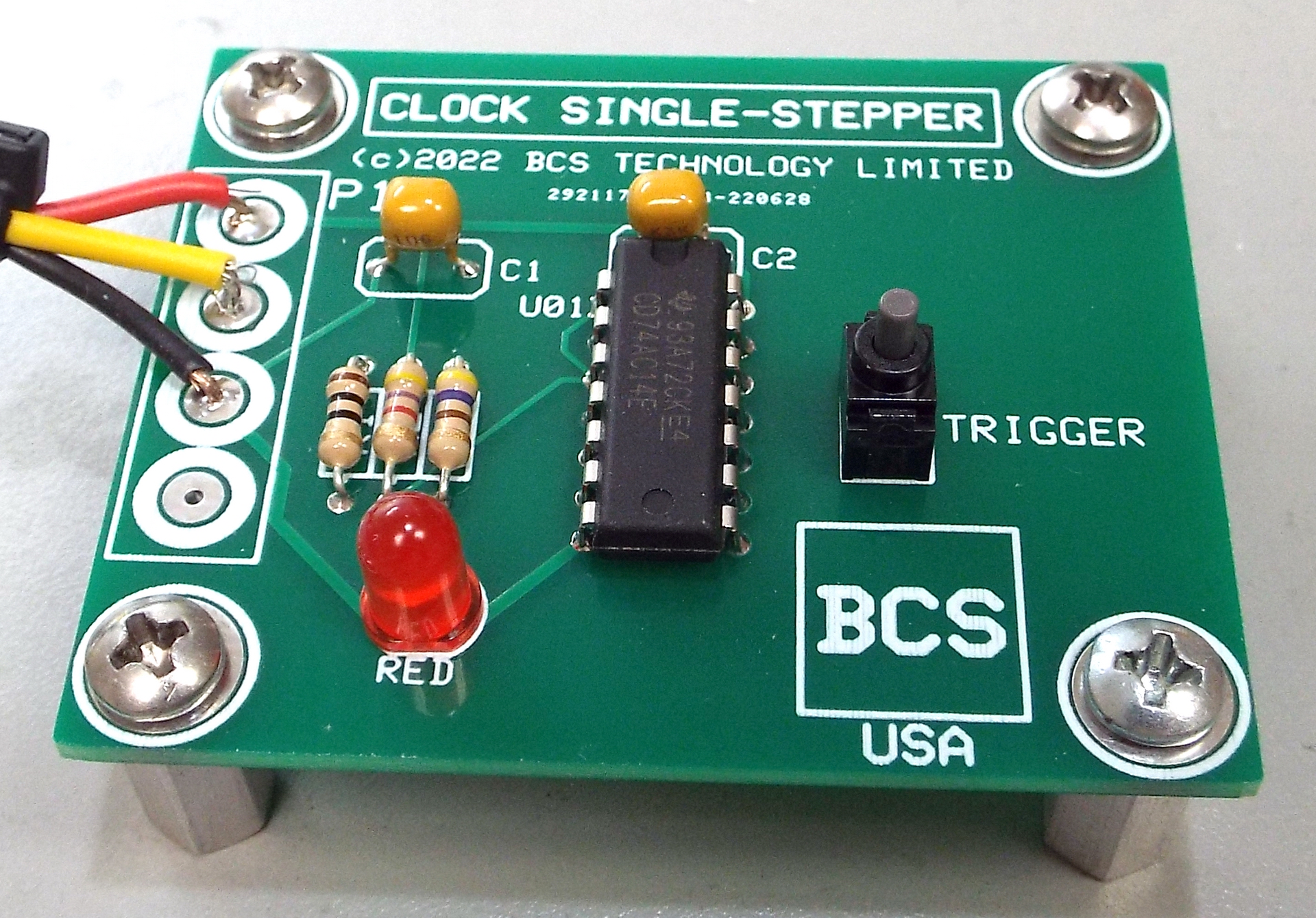

The new and improved clock stepper has been built and actually works.
File comment: Clock Single-Stepper Assembly
File comment: Clock Single-Stepper Detail
File comment: Clock Single-Stepper Wiring
If anyone is interested in acquiring one please PM me. I've got enough parts to build four more.

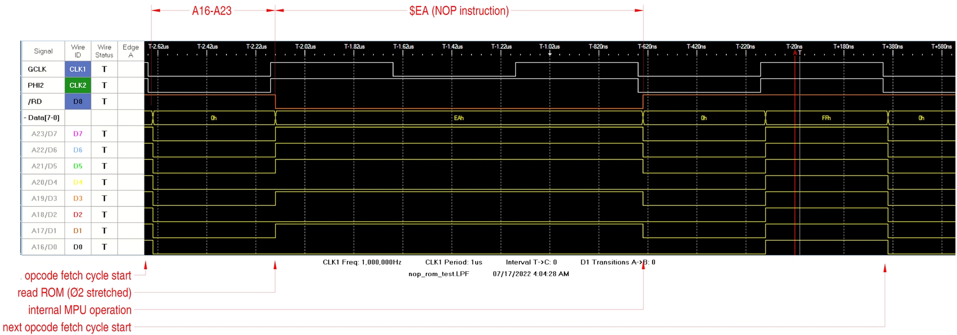

I've completed the first stage of testing V2.0, using a NOP ROM and observing some key signals with the logic analyzer. The unit appears to be functional running on a 1 MHz clock. Here's a capture from the logic analyzer:
Signals in the capture are as follows:
  • GCLK — global clock, running at 1 MHz, which is 1/2 the speed of the clock oscillator.
  • PHI2 — Ø2, nominally GCLK, except when stretched.
  • /RD — read data control signal.
  • DATA — composite view of the data bus on the MPU side of the bus transceiver, with the bit pattern displayed as hex.
  • D7-D0 — individual data bus lines on the MPU side of the bus transceiver.
Next step will be to crank up the clock speed and see what happens with the timing. The fastest oscillator I have is 40 MHz.

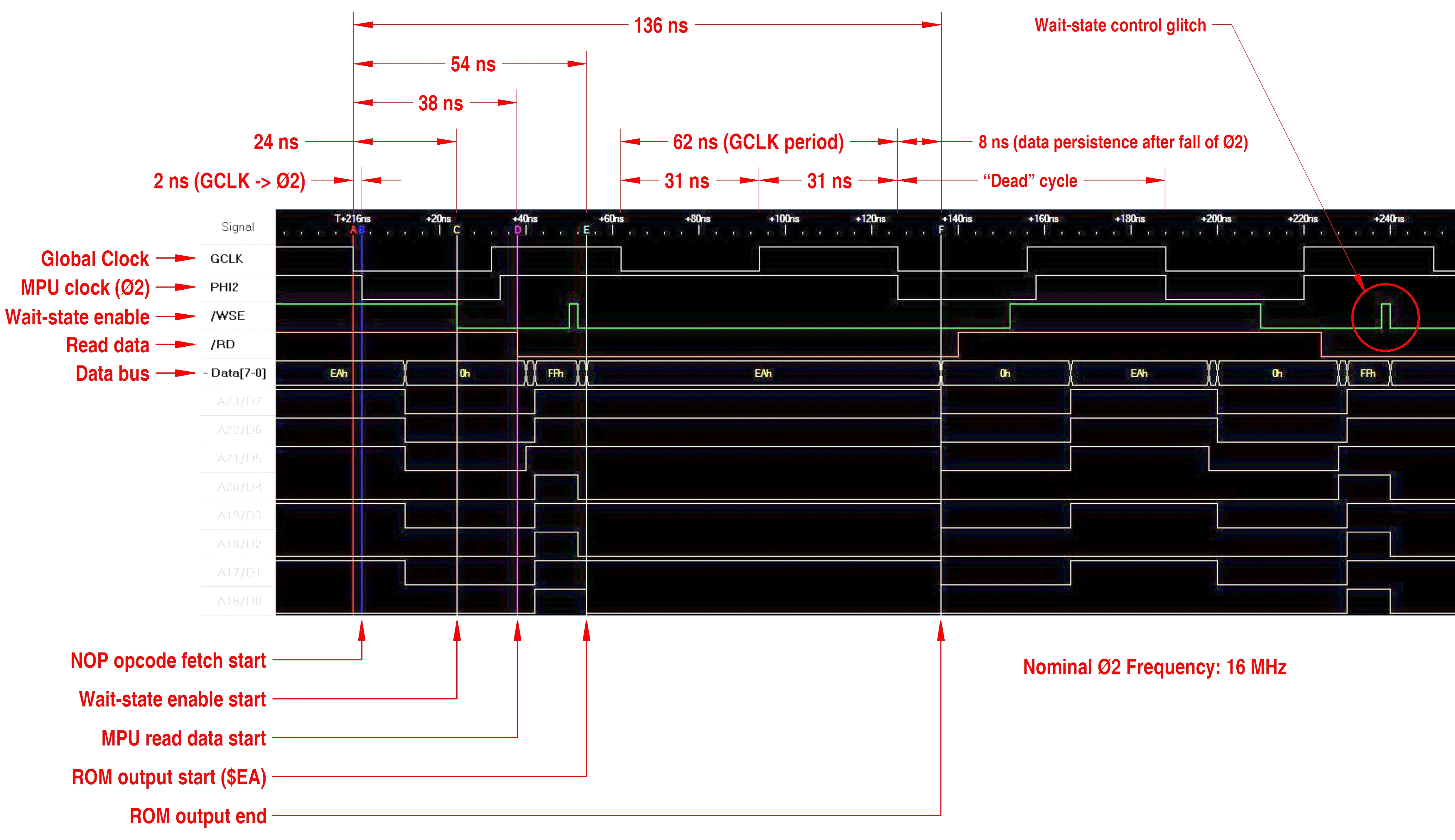

I've completed the first stage of testing V2.0, using a NOP ROM and observing some key signals with the logic analyzer...Next step will be to crank up the clock speed and see what happens with the timing. The fastest oscillator I have is 40 MHz.
Higher-speed testing is done. The maximum speed at which the unit can reliably run is 16 MHz, which is also the limit for POC V1.3—and for the same reason.
Below is a capture from the logic analyzer while V2.0 was running at 16 MHz with the NOP ROM:
A key takeaway from the above is while my clock-stretching setup does work, it falters at high clock speeds. The choke point is the time required for the 74AC109 J-K flip-flop to start a wait-state cycle when gated by the CPLD.
Before any wait-state setup can be carried out by the CPLD, the 65C816 has to emit a valid address, the timing of which is defined as tADS. tADS is officially specified to be 30ns maximum at 5 volts, which makes no sense—16 MHz operation would be impossible with such a figure (N.B., POC V1.2 runs with ease at 20 MHz, which gives the MPU less that 25ns to emit an address after the fall of Ø2). Judging by the time that elapsed from the fall of Ø2 to the asserting of wait-state enable (/WSE), which is 22ns, tADS is probably around 15ns, since the prop time of the CPLD causes an approximate 7ns lag after the address goes valid before /WSE can be asserted.
With a clock half-cycle period of 31ns, the 22ns it takes for /WSE to assert after the fall of GCLK (global clock) leaves only 9ns to gate the AC109 J-K flop. The AC109 requires about 5ns minimum setup time on the /K input before GCLK goes high. That requirement is being met with 4ns (worst case) to spare, so the circuit will work reliably at 16 MHz. At 20 MHz, there would only be 3ns to gate /K. GCLK will have gone high before the required 5ns setup time has been met and the AC109 will fail to start its timing cycle. So the wait-state will never happen at 20 MHz and the system will puke.
A logical modification to get around this clock calamity would be to eliminate the AC109 (and the prop time it inserts) and have the CPLD directly control the AC74 clock generator flop’s PRE input. In order to do so, I'd have to synthesize a J-K flop in the CPLD. That flop would drive the /WSE signal, which would be wired to PRE on the AC74.
The AC74 has a setup time for PRE that is defined as tPLH, which is the time that will elapse after /PRE has been driven low before Q will go high and /Q will go low. tPLH is about 11ns maximum, which is workable at 20 MHz. tPLH added to the 7.5ns pin-to-pin prop time of the CPLD, plus about 2ns for feedback delay associated with the synthetic J-K flop, means the worst-case timing would be ~20ns from the rise of GCLK to the AC74 responding to PRE and freezing Ø2 in the high state. That leaves 5ns of timing headroom at 20 MHz.
Meanwhile, since the unit can run NOPs without any problem, the next step will be to use another diagnostic ROM that bangs away at RAM, and a third one that beats on the I/O hardware. Assuming that testing is good, it will be time to assemble firmware for the unit and give it a spin. POC V1.3's firmware can be reused with only memory map changes.
BTW, there are other interesting things to be seen in the above capture. That glitch on /WSE is perplexing, although harmless.

Since you already have a CPLD, you should be able to place the discrete flip flops inside the CPLD to reduce propagation delays.
The AC109 can be synthesized in the CPLD—I mentioned that when describing a possible solution to the timing “choke point.” The AC74 needs to remain discrete because the CPLD’s output levels are TTL and can’t reach VCC × 0.8 in a 5 volt system, VCC × 0.8 being the specified minimum for the 65C816's Ø2 input. I do have pullup resistors on the outputs of the CPLD to try to get them as far into CMOS logic 1 territory as possible. However, doing so creates an R-C situation that slows the rise time once above the theoretical 3.4 volt no-load limit of a TTL output. As the 816 requires a Ø2 rise and fall time of no more than 5ns, I can’t expect such an arrangement to work in a reliable fashion.
