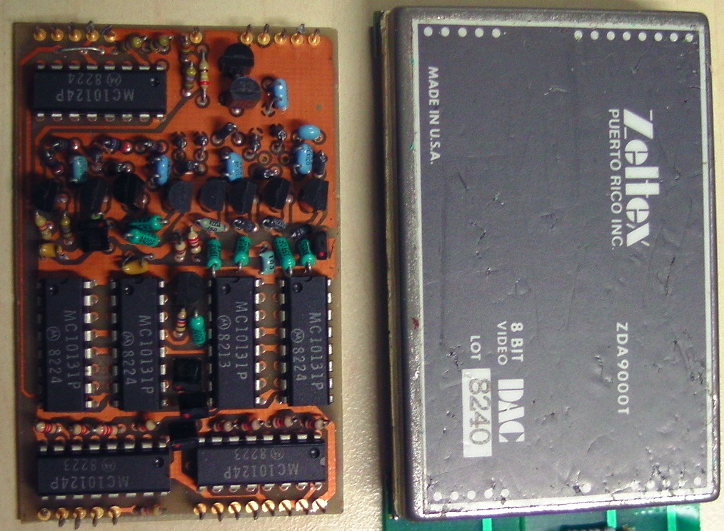

Anyhow, speaking of ECL I now remembered that another hobbyist gave me two video DAC modules more than 15 years ago.
(If anybody happens to have specifications or technical infos about those modules, please post it here.)
Starting to think, that the Potato chips could give you quite a bandwith when trying to generate analog RGB signals for VGA.
A closer look to that DAC module with the casing removed:
Anybody interested in reverse engineering those cute looking artefacts ?
MC10124: quad TTL to ECL level translator, 3.5ns
MC10131: dual Master\Slave D flipflop, 3ns, 160MHz max.

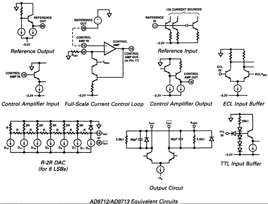

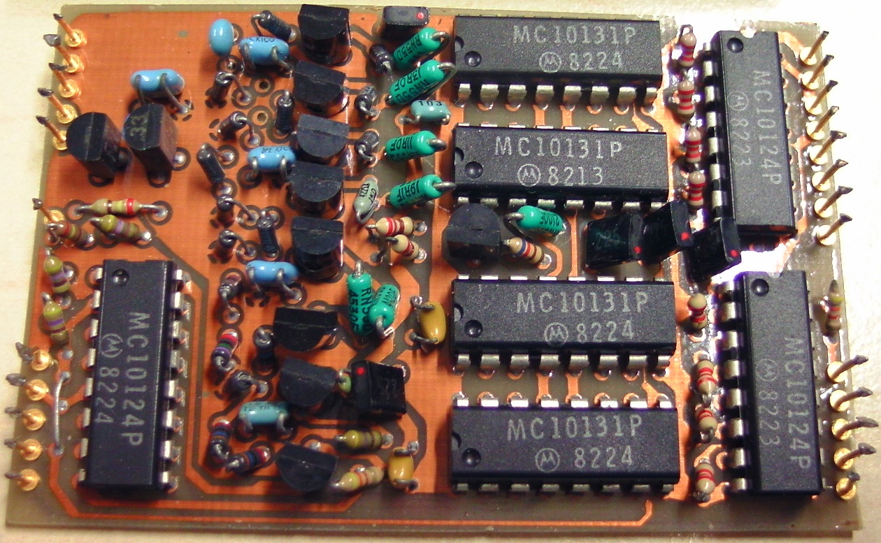

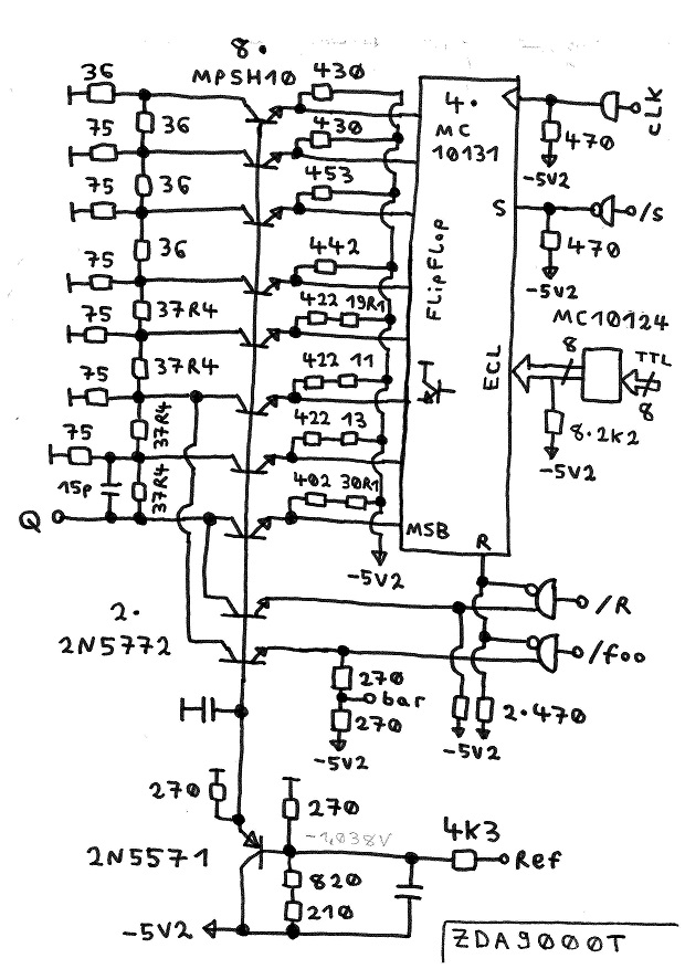

We have MC10124 TTL to ECL converters, and MC10131 D_flipflops.
Those Motorola 10k ECL chips have open emitter outputs,
so all the ECL outputs require a pulldown resistor to -5V2.
For control signals and flipflop outputs we have 430..470 Ohm pulldown resistors,
for the 8 data lines between the TTL\ECL converters and the ECL flipflop inputs
we have 2k2 pulldown resistors.
From the datasheet, MC10131 at 25°C has: VOH=-0.96V..-0.81V, VOL=-1.85V..-1.65V.
A 2N5771 PNP transistor with (in theory) ca. -1.038V at the base generates the base voltage
for all the other transistors which (from the ECL output voltage levels) seem to work as switches.
From the capacitors around that transistor, I think that the DAC was not intended to be used
as a multiplying DAC.
2N5772 NPN is a a switching transistor, tON\tOFF=18..28ns, ft=350MHz.
MPSH10 NPN is a RF transistor, ft=650MHz.
Looks like every semiconductor used in those DAC modules already went out of production. :lol:
The R-2R ladder looks a bit like that in the AD9712 datasheet, but I'm not sure about that little
"asymmetry" in the resistor values, would be nice if an engineer would be able to explain this.
// Source: 1992 Analog Devices Data Converter Reference Manual Vol.1, PDF page 773 (document page 2-759), available at bitsavers.org
But back to our DAC modules:
Those two 2N5772 transistors look interesting.
when recalling what a composite video signal looks like on the oscilloscope at Wikipedia:
Sync level:  0.000V
Blank level: 0.285V //retrace period
Black level: 0.339V
White level: 1.000V
It's an 8 Bit DAC, and when generating Sync level and Blank level with the DAC this would reduce the dynamic range
between black and white, so IMHO in my schematic /R should be /SYNC and /foo should be /BLANK.

PostPosted: Sat Dec 30, 2017 6:30 am
Posts: 343
Well, its a normal resistor ladder.. You can go about it by using the standard x-bit to analog with different resistors, but that ladder will limit the number of resistors values. In both cases, the resistors limit the amount of current that goes through the output driver, so you get different voltage levels according to which output is active. Ok?
PostPosted: Mon Jan 08, 2018 10:00 am
Posts: 1430
Back from two weeks of vacation.
kakemoms, thanks for the link, I think for building a 4 Bit D\A converter it's a nice solution.
At 8 Bit, the game might be getting a bit more difficult, of course.
Back in the 70s, I think those ECL modules were the best approach for building a fast DAC.
The circuitry is a bit tricky, and to me the R-2R resistor ladder doesn't look exactly 'normal':
When looking at the LSB: R = 36 Ohm, 2R = 75 Ohm (should be 72 Ohm).
I think that's because MPSH10 is a RF transistor (not what one would use for building saturating switches),
so to make use of the full speed of the MPSH10, some current (in my ECL experiments with BFR93A I went for ca. 200uA)
has to flow through collector\emitter of the transistor to prevent it from going into cutoff.
(BTW: replacement type for the MPSH10 seems to be the 2SC2570A.)
When looking at the resistor values for the upper 4 Bits in the resistor ladder, I think they were a bit "tweaked"
to give the DAC a better linearity (maybe depending on the electrical parameters of the ECL chips and transistors).
(DC offset error won't be important anyway when generating an AC coupled video signal.)

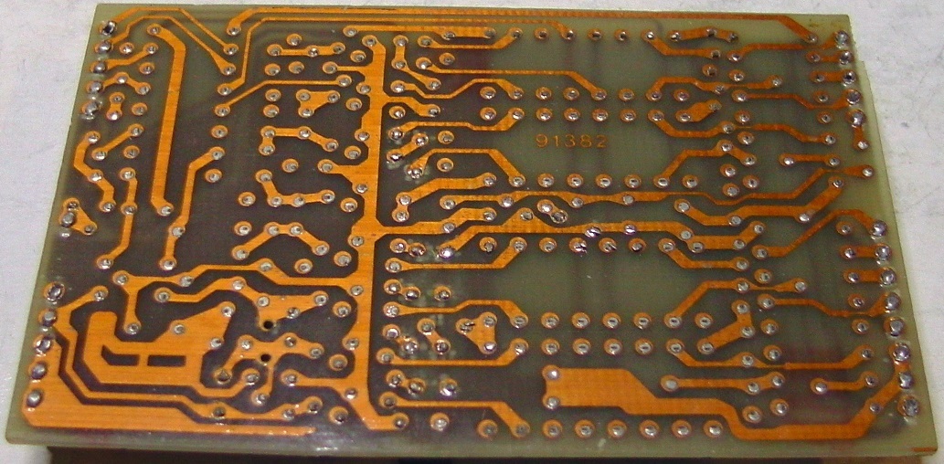

What I found a bit scary is, that the resistors were not manually soldered.
IMHO this might implicate that the manufacturer of the module did test the electrical parameters of the chips,
of the transistors, and maybe of the resistors too before inserting those components into the PCB.
The component wires at the bottom of the PCB are as short as possible.
Looks like they were not just cut to this length... but milled.
Since PCBs with components soldered in don't tend to be _exactly_ flat, that's quite impressive.
Building modules of that sort certainly requires some skill and know-how.

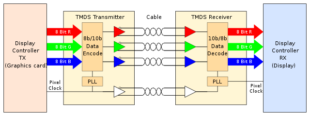

Picture from Wikipedia about TMDS (transition-minimized differential signaling):
From the specifications, it appears that DVI and HDMI are very similar at physical level (except that the connectors seem to be different).
HDMI encoding is based on DVI encoding, HDMI just adds some tricks for transmitting digital audio.

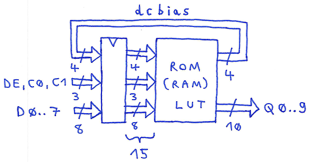

PostPosted: Mon Aug 26, 2019 3:29 pm
Posts: 1430

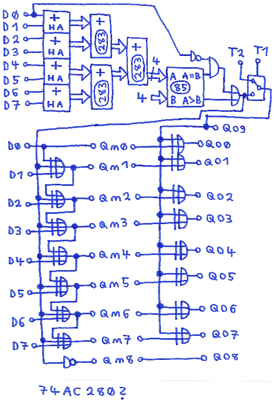

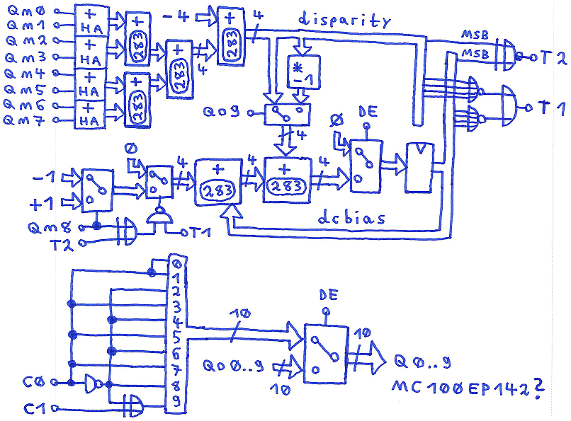

We have three 8b/10b encoders, one per color channel.
The purpose of the encoders is to achieve DC balance and to provide enough state changes to allow clock recovery in the decoders inside the monitor.
//Gigabit Ethernet and USB3.0 also use 8b/10b encoding.
And now, I wanted to know.
When trying to translate the VHDL of Mike Field's 8b/10b encoder, I'm getting something like this (you better check for errors):
//Don't get confused: for the intermediade results, I had tried to stick with the DVI specification somehow.
D0..7 is a Byte which sets the color for one channel.
DE is display enable, if DE is LOW we are not in the visible part of the picture.
If DE is LOW, C0 and C1 of the blue channel seem to be the horizontal\vertical sync signals.
For DVI, C0 and C1 for the other two color channels are supposed to be LOW. //For HDMI, it's different.
Q0..9 is the encoder output which feeds the data inputs of a fast 10 Bit shift register.
The adder boxes labeled "HA" are half adders, basically an XOR gate and a AND gate,
sort of a habit when adding partial sums in a multiplier or such...
Of course, my block diagram above never would be able to run at dot clock speed.
One needs to break it into, let's say, a 5 level pipeline and to replace the 7485 comparator and the 74283 adders with something that's much faster.
Serial upstream would be 10 times faster than the dot clock, and at a reasonable dot clock IMHO TTL would be too slow,
this asks for OnSemi PECL shift registers. Microchip\Micrel has neat level translators.
Physically, what goes through the DVI\HDMI cable seems to be CML, Microchip\Micrel has neat CML drivers and flipflops, too.
But IMHO the timing skew between the four channels after the encoders (three color chanels and a dot clock channel) would be critical.
Bad thing is: the block diagram only is one channel, so building a non_proprietary DVI encoder would take a lot of chips.
I would estimate it might take at least half a year to build something like that,
and maybe more than 200€ of material cost... if it works at first try, and it usually doesn't.
//DVI encoder chip might cost just 5€ or such.
Of course, one could be cheating and use fast SRAM (preferably sychronous RAM) as a lookup table (LUT) for replacing that lump of TTL chips,
but then one needs to initialize the lookup table in the RAM from a ROM at power up.
