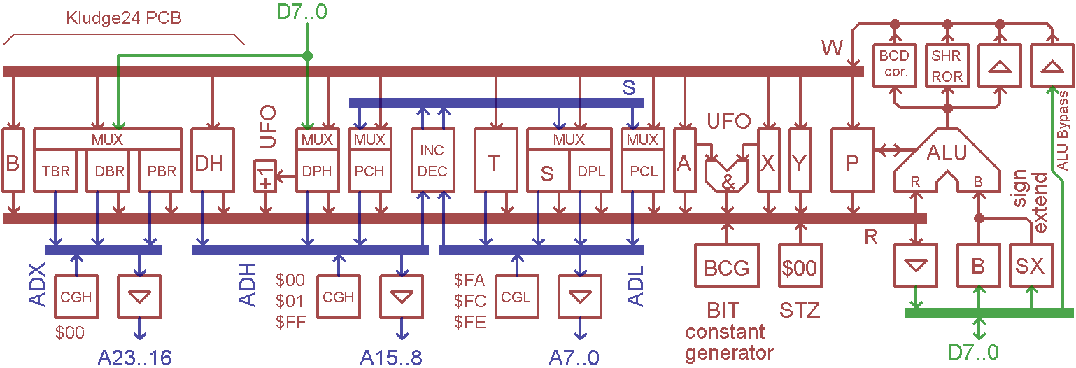

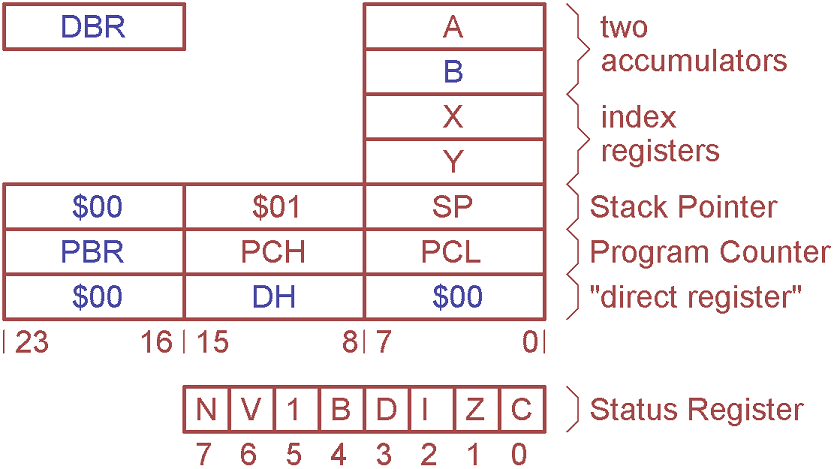

6502 (red) plus Kludge24 (blue) register map:

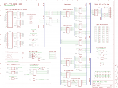

(Initial\preliminary) Block diagram of OurCPU with Kludge24 attached:
TBR is a temporary register for address calculation.

In my previous post, I had written "A (nearly linear) 16MB address range", because there are some limitations:
The 16MB break down into 256 banks 64kB each.
Incrementing PC will stay within a bank.
Branch instructions will stay within a bank.
Most addressing modes will stay within a bank,
except when calculating the effective address for a data read/write when it comes to: absl absl,x [ind],y
Now a list of how I think Kludge24 should place something on the address lines A23..16:
A23..16 = $00 //page 0
  • vector fetch: RES, NMI, IRQ, BRK
  • stack push/pull
  • data read/write: addr.mode: z z,x z,y d,s (d,s),y
  • pointer read: addr.mode: (ind) (ind,x) (ind),y (d,s),y [ind],y
  • pointer read: JMP(abs)
A23..16 = PBR //program bank register
  • program memory read
  • pointer read: JMP(abs,x) JSR(abs,x)
A23..16 = DBR //data bank register
  • data read/write: addr.mode: abs abs,x abs,y (ind) (ind,x) (ind),y
A23..16 = TBR //temporary value for 24 Bit addressing modes
  • data read/write: addr.mode: absl absl,x [ind],y
Any comments or suggestions about this list from somebody with 65816 experience ?
Problem is, that I never have used a 65816 in native mode.
My info was from the manual: Eyes & Lichty: Programming the 65816.
BTW: the idea is that empty microcode locations in the microcode ROM on the Kludge24 PCB
(all Bits '1') won't modify registers while placing $00 on A23..16,
to ensure compatibility with the NMOS 6502 and 65C02 which are supposed to only use memory bank 0.

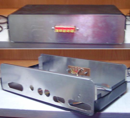

After digging through the basement at the weekend, all I found was the casing:
35 years of hobby computing... and only one of my projects had a casing. :lol:
Five buttons, every button had a LED to indicate which 64kB page was active.

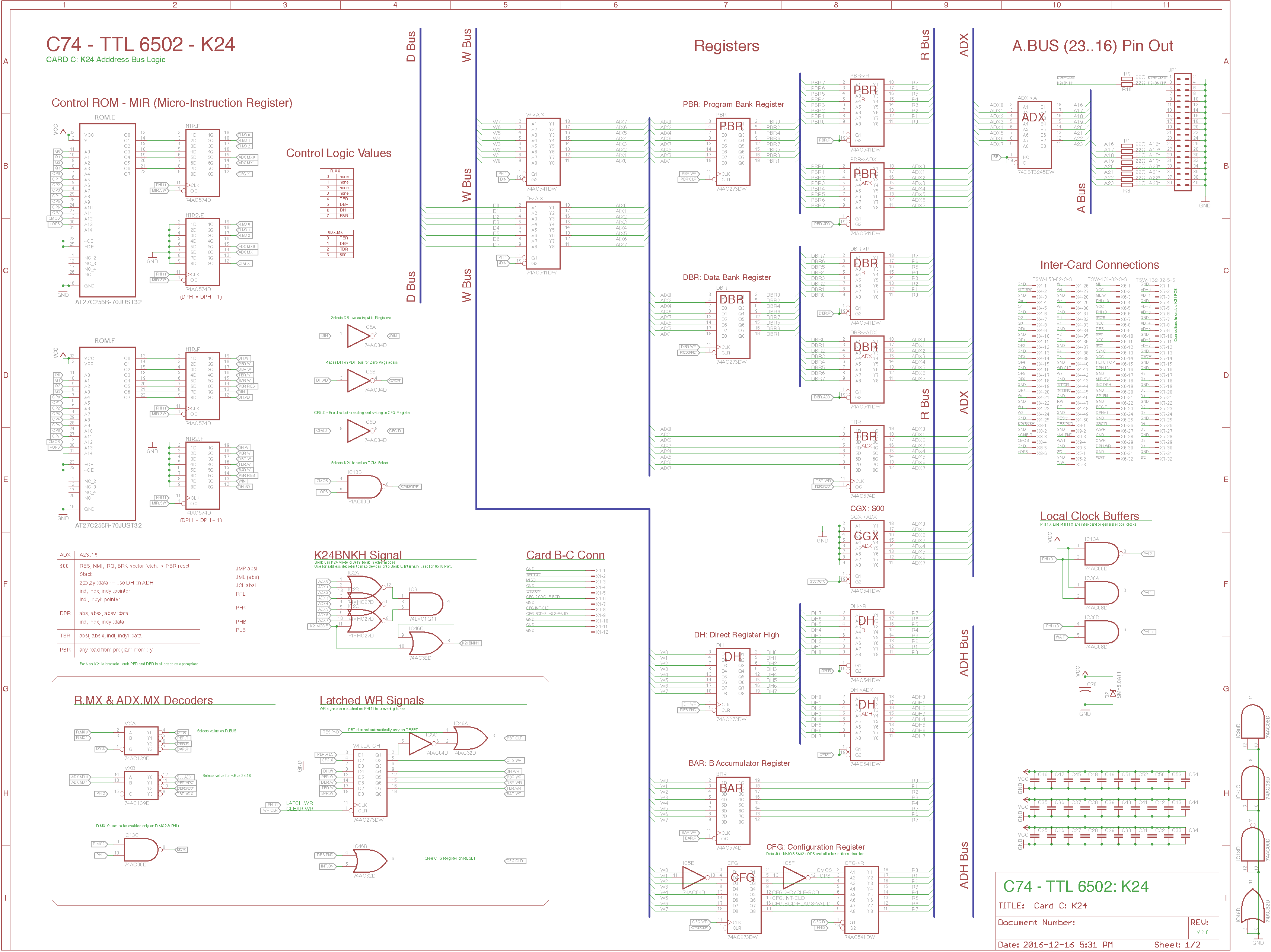

It’s been a while, but I finally had an opportunity to spend some time on the project. When I left off, I was busy routing the ALU & CU Card, which may finally need more than the 4 layers I was hoping for. We’ll have to see about that …
In the meantime, Dieter posted his Kludge24 (K24) addition, and it certainly looks interesting. Reading up a bit on the 65816, I can see how K24 provides for a reasonable implementation of Emulation Mode - supporting a 24 bit address bus, 8 bit registers and nearly all 65816 instructions. That’s exciting. I also clearly remember thinking about “partitions” on my C64 many years ago, and I was excited to see Dieter's version of just that above! A few mods and some microcode is all it would take to make K24 compatible with the existing TTL CPU. After kicking it around with Dieter a bit, I decided to get K24 done now while it’s all still fresh in my mind, and return to the thorny layout issues thereafter (good thing we're still not in a hurry :)).
K24 is very similar to the Registers Card so it didn’t take long to get my head around it. So far, I have:
  • Added the microcode pipeline mechanism, making sure that the default “All Zeroes” control word works properly
  • Changed the naming of signals and encoding of ROMs to be consistent with the other cards and simplify things a bit
  • Added the “bus collision” management scheme - R and ADX busses are enabled only in Phi1, and the W Bus only in Phi2
  • Added inter-card connectors and clock buffers
  • Added logic to manage the 6510 port being mapped into bank 0 in “K24 Mode”, and into all banks otherwise
  • Added external connections for two useful control signals: /K24MODE (low when K24 microcode is selected) and /K24BNKH (low when Bank > 0 in K24 Mode)
  • Added a Configuration Register (CFG) to enable programmatically switching the current microcode and setting various operating options (see below)
After reviewing the microcode required, I made the following compatibility notes:
  • K24 will not be cycle accurate.
  • The Direct Page register is 8 bits (called "DH") and points only to page boundaries. We can still have PHD and PLD push and pull 16 bits on the stack just for compatibility (with $00 as the low byte).
  • The A & B accumulators cannot be combined into a 16 bit C register. TCS, TSC will use only the A accumulator (low-byte); and TCD, TDC only the B accumulator (high-byte). (btw, I refer to the B Accumnulator Register as “BAR” in the schematics to distinguish it from the B input of the ALU).
  • SP is 8 bits, so all opcodes which push or pull values on the stack will wrap on a page boundary. Other rules for crossing bank boundaries, however, can be applied correctly (e.g., Abs,Y [Ind],Y)
  • The ABORT and COP Interrupt Vectors and MVN and MVP opcodes are not implemented.
  • Opcode $42 (WDM) is replaced by a CFG instruction, which will exchange the contents of the A accumulator with the CFG register.
The K24 Microcode will manage the upper 8 bits of the 24 bit address bus dynamically to reflect various addressing modes, as Dieter described above. Meanwhile, the 6502 and 65C02 microcode will restrict addressing to the current Program and Data banks (PBR and DBR respectively) - each bank can then work as an independent “partition”, with the additional flexibility that the Program and Data Banks need not be the same. As expected, interrupts set PBR to 0 in K24 mode but leave that register unchanged otherwise (which means that an external address decoder has to map interrupt vectors across the various banks for both the 6502 and 65C02 microcode. The /VP signal on the 6502 Pinout Connector is useful in this regard and can be activated for all microcode options via a jumper on the Registers Card).
The CFG Register is formatted as follows:
CFG bit 0-1: Microcode Select (6502+UFOs, 65C02, 6502+NOPs, and K24)
CFG bit 4: Enable 2-Cycle-BCD
CFG bit 5: Enable BCD-Flags-Valid
CFG bit 6: Enable Interrupt-CLD
If the K24 Card is not present, jumpers on the ALU & CU card are used to select the microcode, and the other CFG options are set accordingly by the hardware (2-Cycle-BCD, BCD-Flags-Valid and Interrupt-CLD are all enabled for the 65C02 microcode and disabled otherwise). On RESET, the K24 microcode zeroes the CFG and Bank registers, which defaults the CPU to NMOS 6502 compatible behaviour running in Bank 0. To enable microcode switching, $42 will also implement the CFG instruction in the 6502 and the 65C02 microcode (replacing a KIL illegal opcode in the first, and a 2 byte NOP in the second).
To illustrate how the K24 microcode might work, here’s a first cut at microcode for ORA [ind],Y (Direct Page Indirect Long Indexed with Y - 65816 opcode $17):
(DPL := *PC; PC += 1)             ; Fetch-operand (“All Zeroes” default u-instruction, PBR->ADX)
T := *zDP; DPL += 1               ; Low-byte of target address (DH->ADH, 0->ADX)
DPH := *zDP; DPL += 1             ; High-byte of target address (DH->ADH, 0->ADX)
TBR := *zDP                       ; Bank-byte of target address (DH->ADH, 0->ADX)
DPL := T + Y; INCDPH.C               ; Add index, increment High-byte on carry (PBR->ADX)
TBR := TBR + 0; USE(IC)               ; Increment Bank-byte on carry (PBR->ADX)
B := *DP.TBR                          ; Load target address (TBR->ADX)
A := A ORA B; SETF(NZ); IR := *PC; PC += 1; END      ; ALU operation and fetch-opcode (PBR->ADX)
8 cycles rather than 6, but so be it. Trying to be cycle accurate for K24 is too much of a stretch for the current design.
That’s it for now. K24 schematics as ammended are below …
Drass.

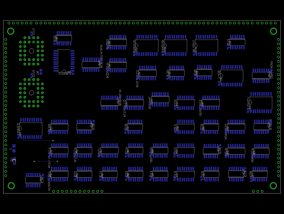

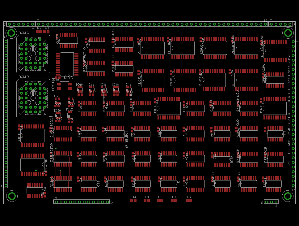

Speaking of the PCBs, I have once again started a layout of the ALU & CU Card. Frankly, it's a little daunting. Not at all sure it's even possible to route it as is. :evil: We'll have to see how that plays out.
Top and bottom layers below.
Cheers for now,
Drass

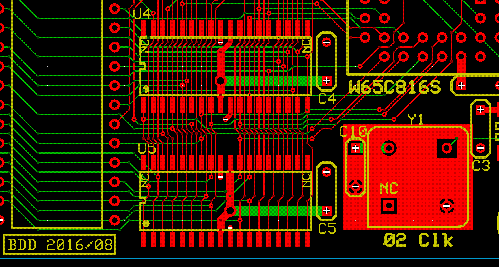

PostPosted: Mon Feb 06, 2017 6:26 am
Make sure you use the smallest possible vias to make routing easier.
PostPosted: Mon Feb 06, 2017 7:07 am
Posts: 8505

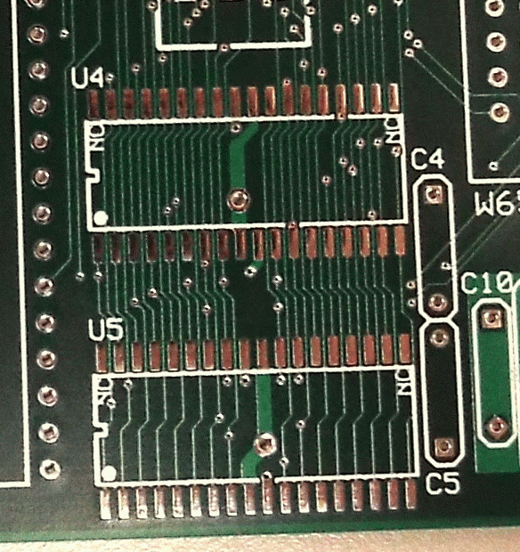

Also, it is possible to snake 0.006 inch traces in between SMD pads that are on 50 mil centers, such as with SOIC14 and SOJ36 packages. I did that on POC V2 in wiring up the two SRAMs (SOJ36, with 34 connections) to the CPLD and the address and data buses. It worked out fine.
File comment: POC V2 SRAM Trace Routing
File comment: POC V2 SRAM Trace Routing on PCB
Above is a graphic of how traces were run in between the SRAM pads (red is the top layer). Right below is the actual PCB before the SRAM was attached. An adequate amount of solder mask was present between the pads to prevent bridging while being manually soldered (done by Garth). The finished product looked almost like it came from the boarding stuffing house.

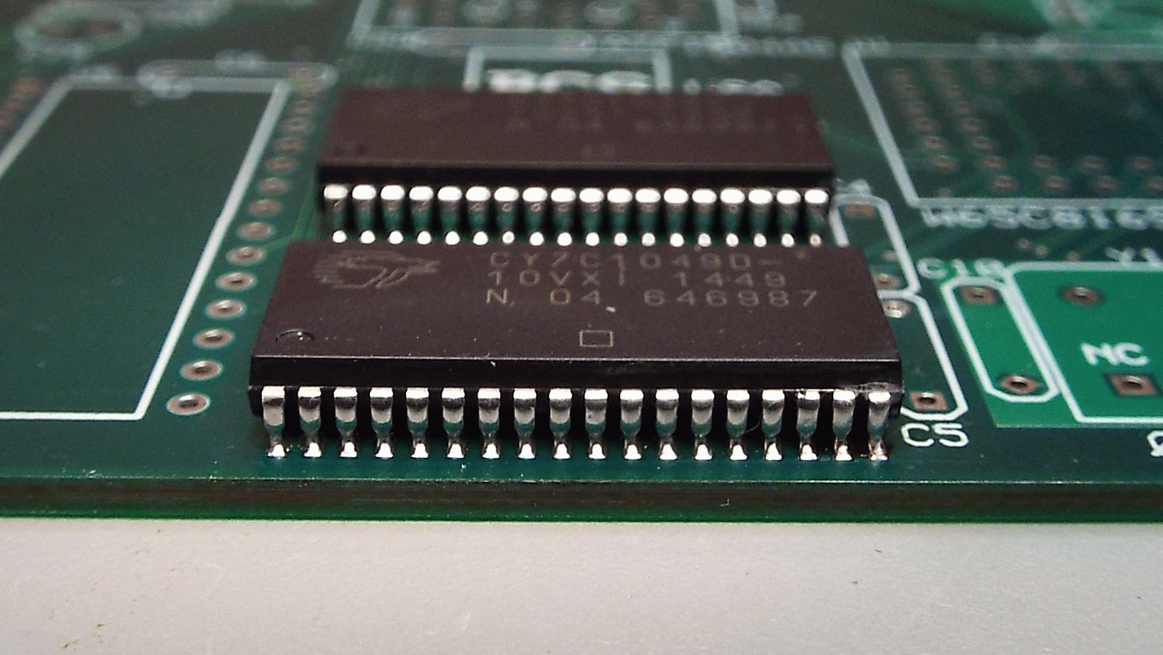

File comment: Closeup of Mounted SRAM
PostPosted: Mon Feb 06, 2017 11:51 pm
Posts: 428
Location: Toronto, ON
That board looks beautiful BDD! I'll have to figure out how to do that come soldering time :)
I take your point regarding trace width. I can definitely fit signal traces between the pads of a SOIC package. Curious, what size vias are you using?
Arlet, I recall you had suggested I was perhaps being a little too cautious when using the VCC layer for signal traces on the last board.
Arlet wrote:
The VCC doesn't really need a plane, as a bit of inductance between the power supply and the bypass cap only helps to filter the signal. As long as you have bypass caps close to the IC, and sufficiently wide traces leading to the cap (to avoid DC voltage drops), you should be okay.
It's likely I won't have the luxury of a clean VCC plane this time around in any case - in fact, I'm considering doing away with the VCC place altogether on this board and running 24mil traces for VCC lines. I'm imagining power rails along the horizontal edges of the board with vertical VCC traces to reach ICs (or maybe it should be vertical power rails with horizontal traces?). Anyway, that should give me lots of additional room on that layer. Does this sound right?
PostPosted: Tue Feb 07, 2017 12:30 am
Rather than taking a lot of board space making the Vcc lines so wide, I would just put bypass capacitors with the shortest possible connections from Vcc pins to the ground plane. The current peaks you have to worry about for AC performance will go through the bypass capacitor, not the traces.
I did the soldering above with a 30W 1/8" chisel-tip soldering iron, .032" 60/40 rosin-core solder, and no additional flux. IOW, the commonly preached rules aren't necessarily absolutes. :lol: Or, as my boss (of all people) once said, "Rules were made to be broken."
