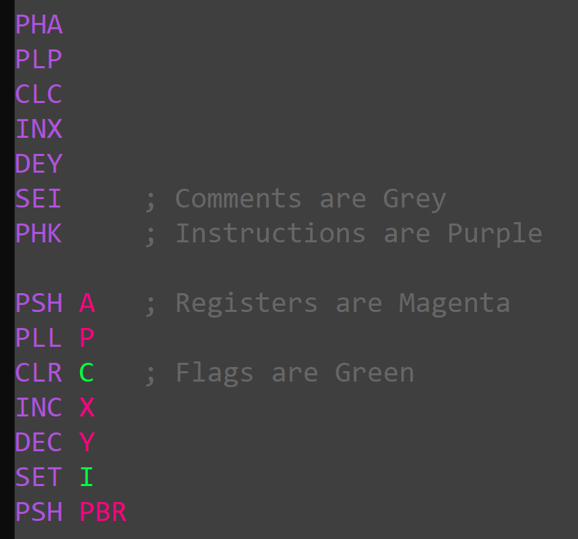

Not sure it's something everyone should be using, but personally i added some alternative instruction mnemonics to make them more readable.
specifically for INC, DEC, CL*, SE*, PH*, and PL*
examples:
PHA
PLP
CLC
INX
DEY
SEI
etc
can be turned into:
PSH A
PLL P
CLR C
INC X
DEC Y
SET I
etc
it's especially noticable with the NotePad++ highlighting i'm using for Assembly:

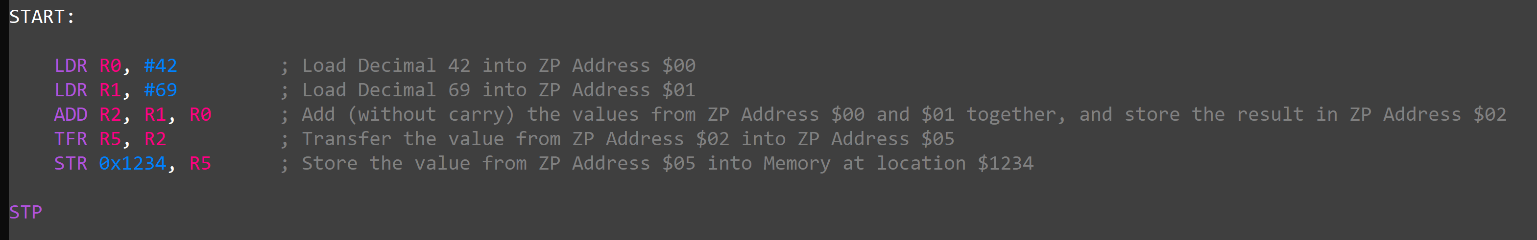

and just for fun, and becuase i often hear people compare the Zeropage to a RISC CPU's Register File i added a bunch of RISC-like instructions that actually use the Zeropage as it's Register file. it also predefines some constants so you can use R0-R255 to refer to decimal 0-255, making the RISC Experience even more immersive!
maybe one day i'll make a 65C02 FPGA Core around this idea.
