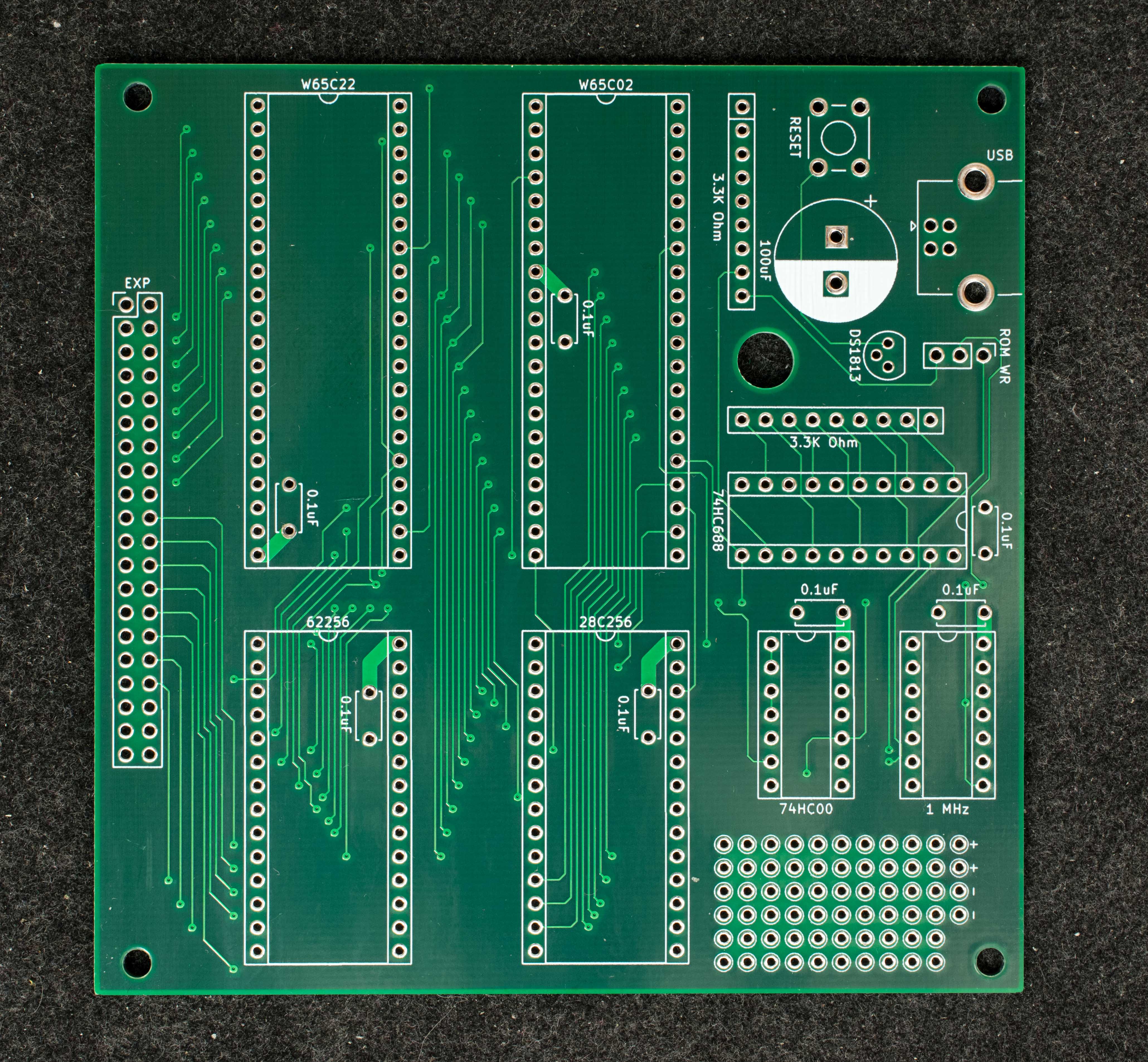

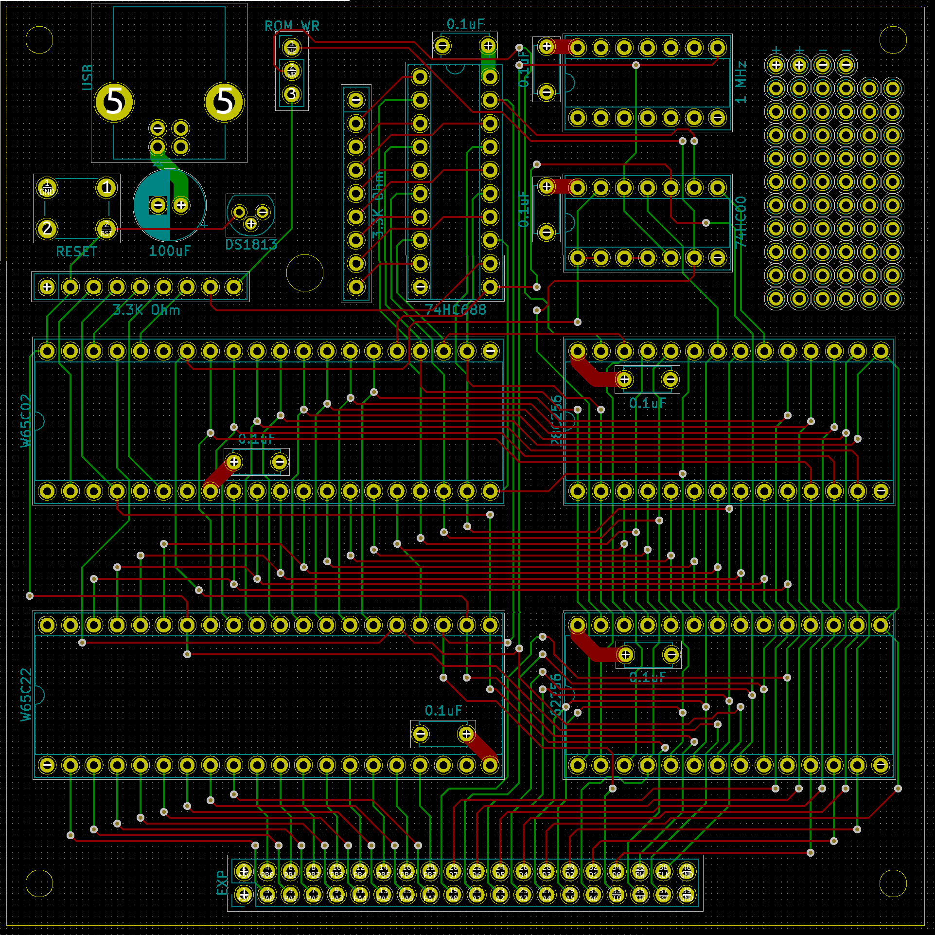

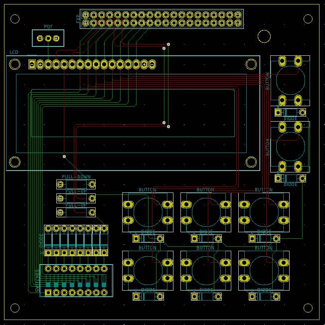

Hello everyone!
I am starting a new topic because I don't want to clutter the last one. A link back to the original is here:
viewtopic.php?f=12&t=6818
I just posted a link to this topic on the last one as well.
Anyways! Attached is my Version2 schematic in B&W PDF form, and two pictures of my 4-Layer PCB layout in PNG format. I'm using KiCad, so if anyone wants those filetypes instead, I can supply them.
I'm posting them here, mainly as an update, but also to see if y'all spot any glaring mistakes. I've been through it a few times, and will go over it a bit more before I send off for the boards to be made.
They should be the 10cm x 10cm size, which JLCPCB sells for $8 right now, so I am taking advantage of that. Once I get BoardOne running as expected, I plan on soldering it to BoardTwo with those expansion pins, making it 10cm x ~20cm.
Thanks to all of y'all who have helped me thus far! Hoping that V2 will work more often than just... sometimes.
Chad
EDIT:
This will be using the W65C02 with a single W65C22 for nearly all of it's I/O (hence the name of the topic). 4-Layer board, 62256 32K SRAM, 28C256 32K EEPROM (with option to write to it from this 6502), and using a 74HC688 and 74HC00 for address finding and glue logic. I'm planning on running it on a 1 MHz oscillator, and powering it through USB. Definitely nothing fancy here, doesn't even have a power switch or power LED. I put a small 'expansion' place on the top-right for fun, and I have a hole near-ish to the top-left to run wires through in case I need to do surgery. Each chip will be in a socket, and so I put the capacitors underneath the chips themselves if possible.
I also added a white-background PDF version of both boards. Likewise, looking at dimensions as I was gathering parts online, I found I needed more room for my polarized capacitor in the top-left corner. So I had to adjust a few things to make it fit.
Lastly, I already ordered the board to be printed. I'll let you know how things go whenever it comes in.

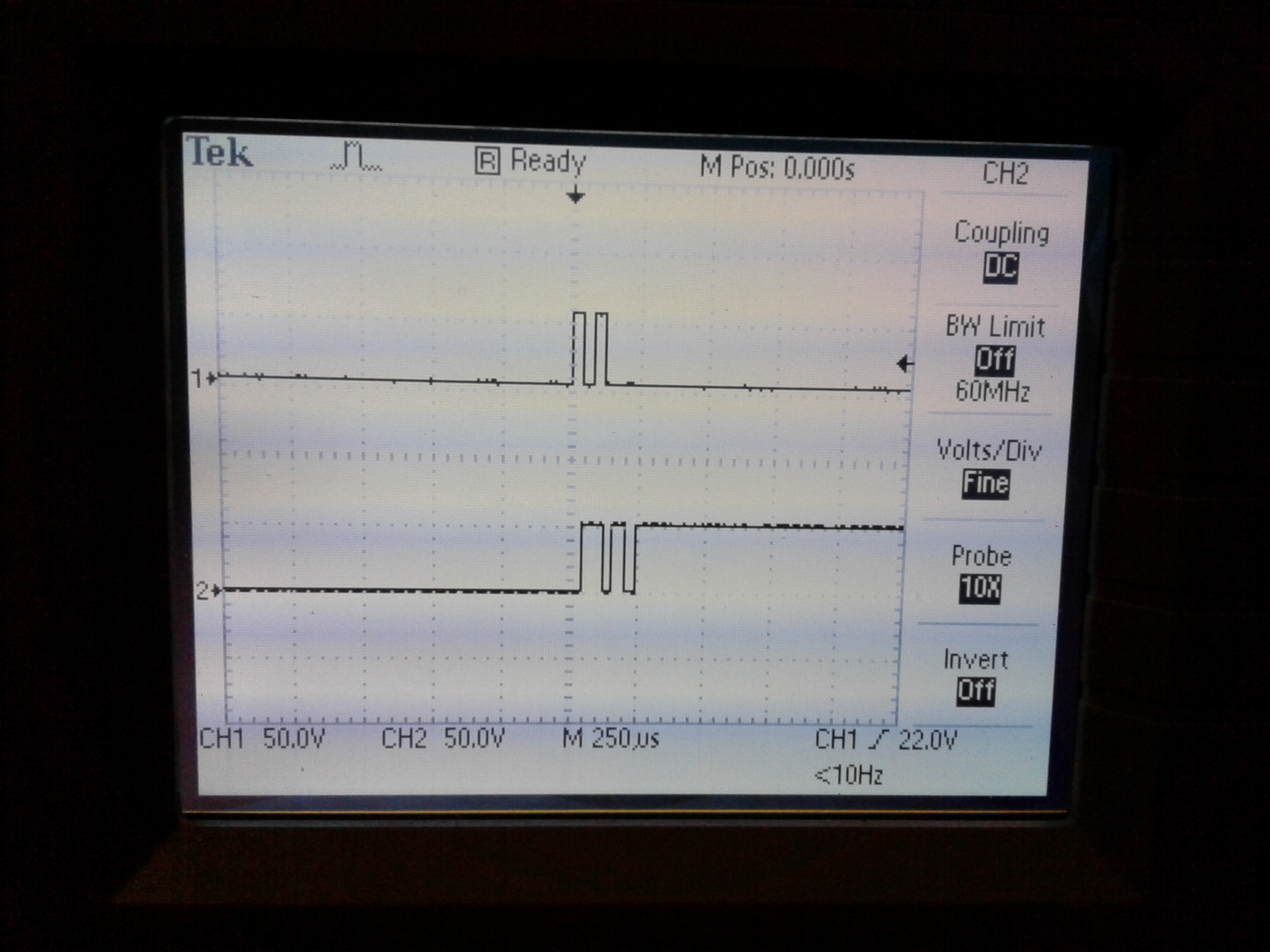

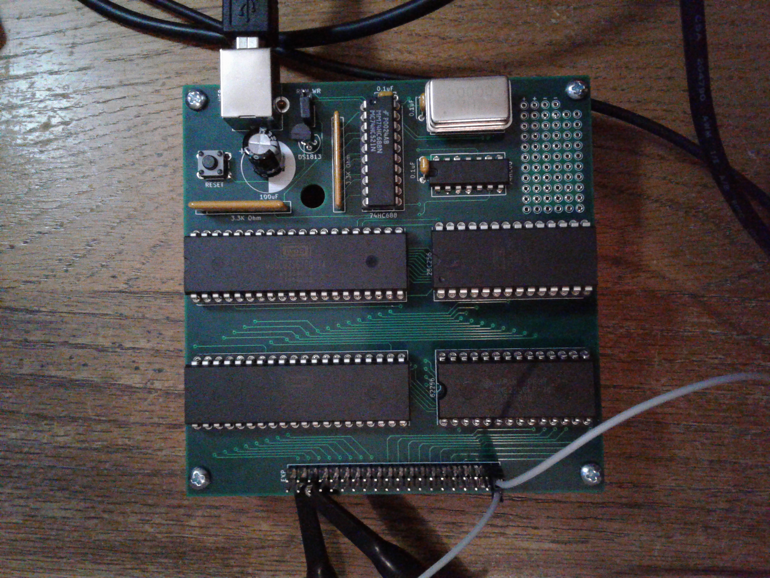

It's been a long time coming, but here is an update on this board.
Attached are two pictures. I *finally* soldered it all today (had to get a new soldering iron even!) and then put the probes on some VIA port lines. As you can see from the scope, it's doing something!
I can't do anything else with this board right now, I don't have a working EEPROM programmer. I just put one I had from my previous board onto this one. It's original function was to put some stuff on a 16x2 LCD through PA and PB lines. I cannot tell you if this is all working properly, but:
1) It did not blow up.
2) It shows activity.
3) Looks much cleaner, tighter, and better than my mess o' wires :) Further, these traces and vias were done by hand, so they look *ultra* pretty :)
Well, there ya go! Worked the first try, as long as I print the board.
Just and update, and perhaps the last one for this particular board. My next project is found here: viewtopic.php?f=12&t=6914
Thanks everyone! I really could not have done this without your help, support, knowledge, and patience. Have a wonderful night, Happy New Years!

Very nice! That hand routed traces do look nice, but routing by hand is such a chore! Is the 2x20 connector compatible with your current VGA_RAM project? Your scope traces look wonderful. Are you using the Amazon probes?
 Post subject: Re: Single 6522 V2
PostPosted: Sun Jan 02, 2022 1:10 am
Posts: 713
It was a chore. And I can't nearly fit as many chips on a board that way. Every board going forward is computer traced.
It is a 2x20 connector, but it's not designed with my VGA board in mind. It's primarily VIA PA and PB ports, along with other things needed for additional VIA's. I *could* attach it to an earlier version of my VGA board, but at this point I'm going to just directly write to it instead of going through a VIA because it's much faster.
Yep! Using the new probes :) These have little hooks on them which make it easier to clip onto things. Also they have this 1x / 10x setting on the side, which is weird. I was getting really small bumps at first, then I saw I didn't have the probe set correctly. Learning!

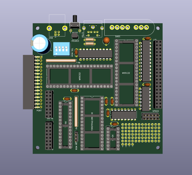

Attached is a picture of the next 6502 board I'm working on. It's almost a copy of this board, but with additional features:
1) PS/2 Keyboard connector.
2) Super Nintendo Controller port.
3) Using a 74HC154 for better I/O control.
4) Using a 74HC163 for variable speed (starting at 4 MHz this time).
5) Ability to use either the SST39SF040 Flash ROM or the 28C256 EEPROM with 3 simple solder-jumpers on the back side.
This will plug into the VGA board on the left side.

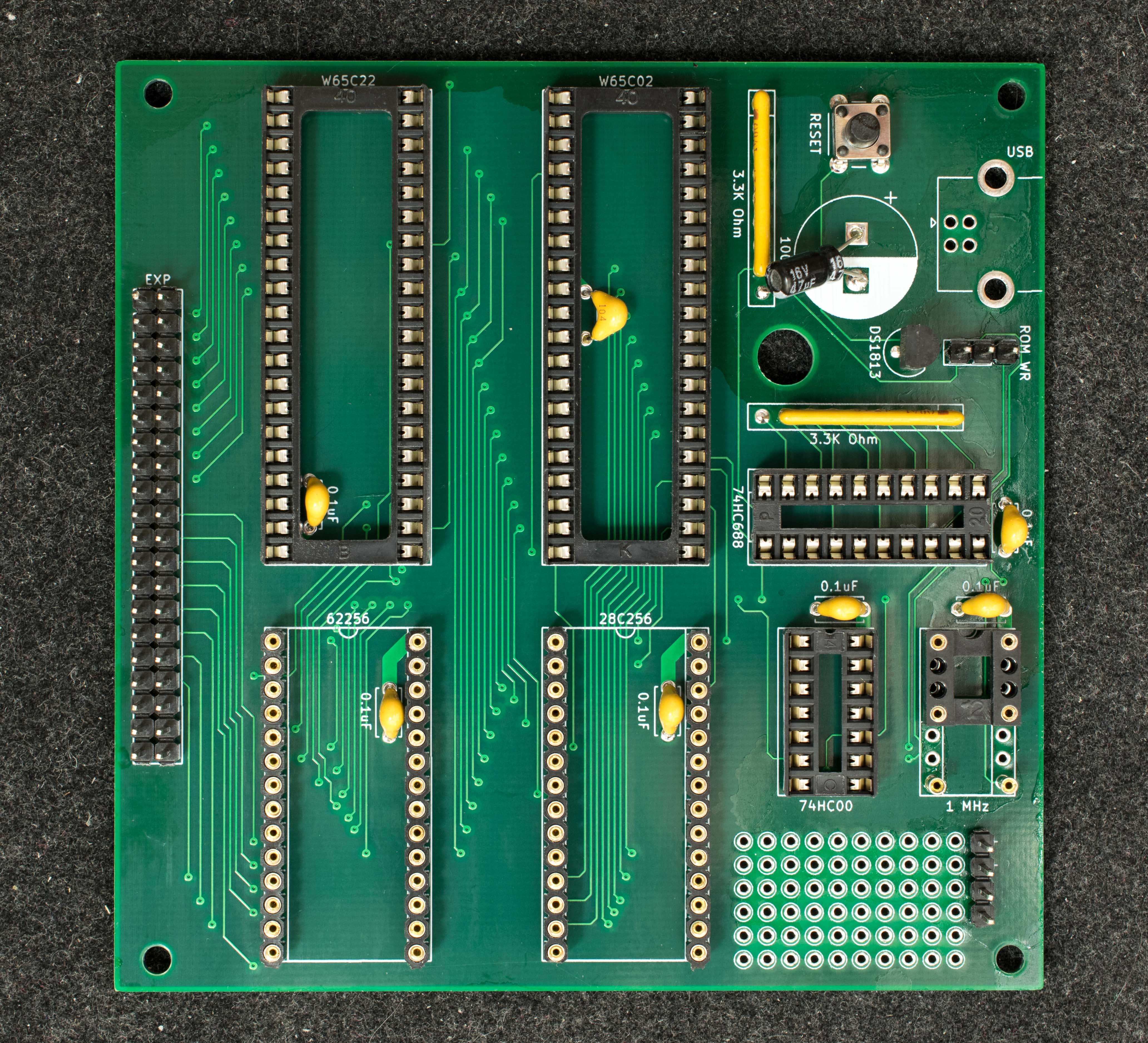

Posts: 1110
Chad,
Received your board in the mail, it looks great! Manual routing sure is pretty even though it is labor intensive. I like having power/ground pins by the prototype area. Instrumentation grounds for scope probes are always nice to have. A square pad for pin 1 would be nice to have, especially during trouble shooting session. I see DS1813 footprint is not right for MCP130 so I have to adjust the pin to fit. These are small nits, overall the board is well done.
It is quite easy to assemble. I assembled it in about an hour. I have all the parts except 62256, but I'll replace it with something faster. This board should run 8MHz, possibly 10, even 12MHz.
Update: When in doubt do the NOP test. populate the 74HC00, 74HCT688, 1.84 oscillator, W65C02 and fill a W27C512 with all '$EA', power up!
Current consumption is 27mA, address A0 is toggling with a period of 2.18uS (460Khz) and A15 is toggling with a period of 71mS (14Hz). Looking good!
Haha, well thank you Bill :)
Yes, I have learned to have extra GND and VCC pins in all kinds of places. Definitely helps when probing.
On this particular board I did away with the square pads because they were getting "in the way" of my manual routing. Well, a couple were, and I am picky about uniformity.
The DS1813 footprint is wrong for DS1813 as well! I had flipped it.
Oh, and I way over-did the polarized capacitor footprint. I was expecting a big boy, but obviously a little one works too :)
8 MHz, wow! The next one coming in I'll be attempting 4 MHz.
When I get the EPROM programmer, I will check out that NOP test.
Thanks for that Bill, looks great!
