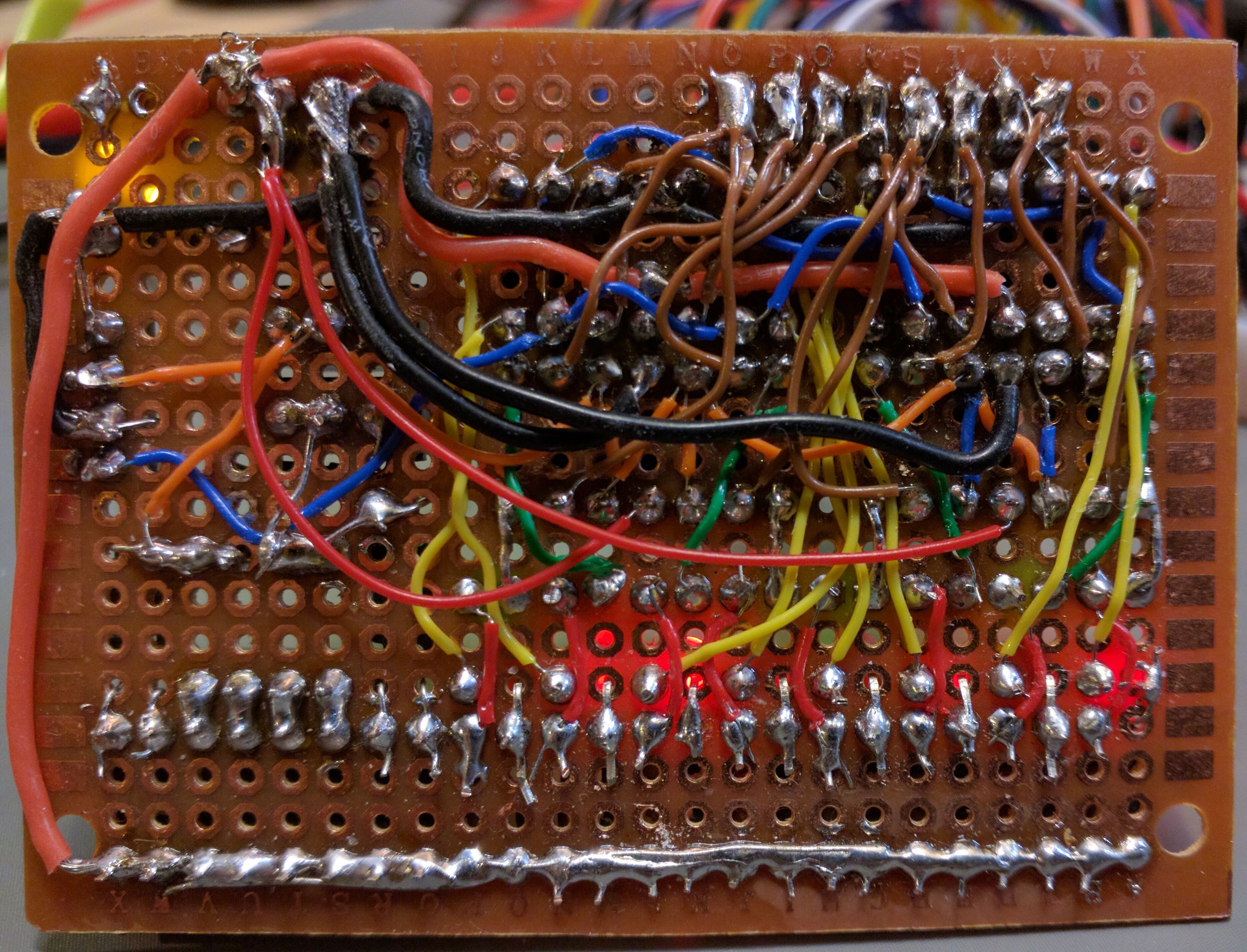

The RC6502 bus is essentially just the (non-expanded, i.e., first 40 pins) RC2014 bus with
a few signal assignments changed to account for the differences between Intel and Motorola signalling. (E.g., the /RD line becomes R/W, and the now unnecessary /WR and /IORQ lines are repurposed for READY and SYNC.) Pins 37-40 are all essentially user-assigned anyway (though there are some conventions that can be useful to follow), and if there were ever to be an "expanded" RC6502 bus it would obviously just follow along in a similar way from RC2014's expansion to a second row.
So since the physical layout, a series of .1" female headers at least 36 pins wide, wired straight through, is exactly the same, you can just buy any RC2014 backplane and use that. In fact, that's exactly what the designer of RC2014 first did.
There are at least three different people selling RC2014 backplanes, both bare board and assembled, on Tindie, and happily for you all three are in the U.K. (Sadly, you have to pick through a longish set of search results to find them all.)
I've never bought from any of them myself, but I'm rather partial to Stephen Cousins' modular backplanes because his SC112/SC113 design offers some extra flexability in the use of lines 36-40, and it's very well documented. (He sells boards and kits on Tindie.)
I notice that there's also a guy selling prototyping cards which might save a little bit of soldering when building boards for the system.
I myself went for the "official" RC6502 design, which is not quite so nice, but was easily available here in Japan from seller, fumi_i2 here on Yahoo Auctions Japan. He sells both backplane PCBs and SBC kits that include the SBC board and all parts. I've bought both and I'm very happy with them. I suppose others are too; I see he's sold 5 SBC kits and two backplace PCBs in the last half year, and that seems to be about the same rate I saw when I looked a year ago, too. I've attached images of the backplane PCB he's selling.
But of course the wiring is so simple that you don't even need to bother with a PCB; just stick some headers in a protoboard and solder them up and bingo, you have a backplane.
Or you can get even more creative:

Also keep in mind that you need not use the backplane and board system for everything just because you're using it for part of the system. I needed to examine a ROM the other day, and the fastest and easiest way was to drop it into my RC6502 system with a smidgen of decoding:
For simple expansion there's not even any need for a backplane board; you can just attach directly to the bus pins on your SBC. Here's a second 6821 PIA attached to my RC6502 SBC, along with a hex display on a few pins of one of its output ports:
I actually used that configuration to develop and test my octal logic probe, seen here on another breadboard below it:
When you do get to doing boards, if you're impatient or just find hours in a CAD program to be tedious, you also have a couple of other options for techniques. Traditional hand-wired protoboard has worked well enough for me, though I discovered the hard way that making it very compact can drastically increase the difficulty of soldering it. (The example below is the bottom side of the octal logic probe prototyped on breadboard above.) One hint to make things easier: use 30 AWG wire-wrap wire, not the more common 24 AWG wire used in breadboards.
Wire wrap is a great technique, and very easy to learn: I was pretty easily getting decent WW connections within a couple of hours of starting out, with no help from anyone; soldering took much longer and I had lots of help. While the tool and wire are dirt cheap, the expensive sockets did put me off, though, but I discovered a trick from JuanGg in this forum of combining protoboard and wire wrap. Basically, you solder standard pin headers adjacent to standard sockets (done pretty easily by dropping a little cutting of component lead between the socket and header pin on the solder side of the board), solder power and ground leads too if you like, and then flip the board over and wire-wrap between the header pins. This not only gives pretty much instant gratification, but also makes it easy to make changes. (So, e.g., rewiring a socket to replace a 27128 EPROM with a 28128 EEPROM should be a few minutes work.)
You can see some examples of this used for a pretty large project in the thread I've linked above, but here's a close-up of a small test example I made, both powering a small chip and bringing its pins out to nearby straight and right-angle headers. Here I was experimenting with bringing power up on headers on the side and using jumpers to bring power and ground to the standard pins for a 74xxx part. If the power/ground pins were not right at the end, I could substitute short wires with crimped female dupont header at each end for the side-by-side jumpers you see there.
